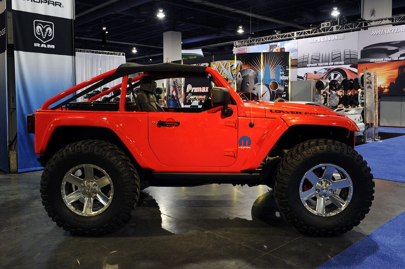

    Rake the windshield and paint it orange?
