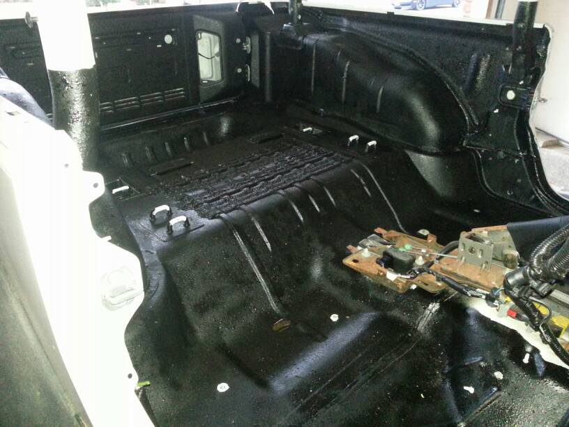

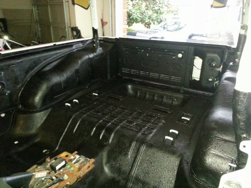

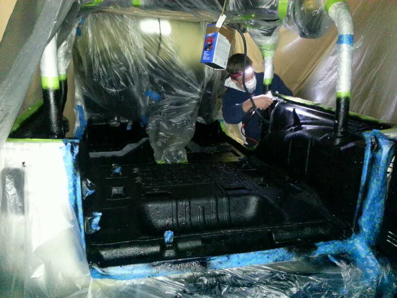

    Two coats on. Were gonna finish in the morning. Its coming along great! This is a lot more work than I thought it would be and I have learned that my compressor isn't up to snuff as far as running 80psi constantly. Lots of spray then wait.
    My Night Shift crew...
  3. huck271 started this Subscriber
    #284 Jan 2013, 6:51 PM
    "BKGM Jeepers" wrote: It looks great!!!
    Don't you need to pull the tape off before it sets? Is the second coat right afterwards?
    Can't pull the tape till we are done spraying.

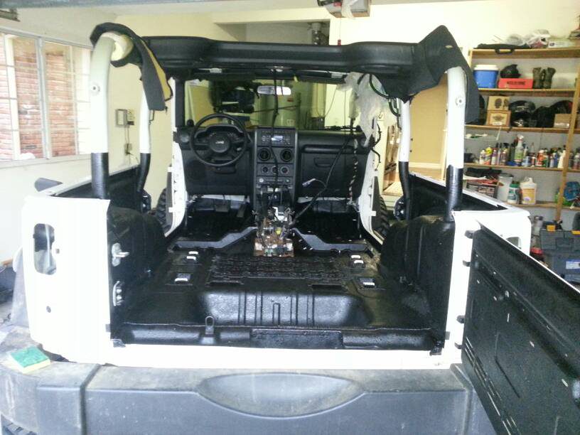

    Tape came off today. We will need to touch up some spots with a brush but all in all looks great. Nice lines the tape did a good job.

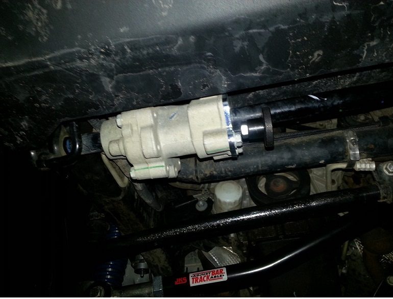

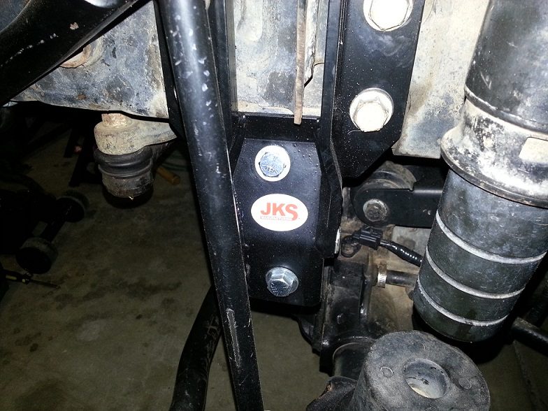

    I installed the JKS trackbar and sector shaft brace setup right before winterfest. Glad I did too, I heard of another JK that broke thier sector shaft and basically spent thier day on the trail being dragged.
    I also decided on manual for the front swaybar setup. Pulled the electronics and installed the swaybar with a turn style knob in its place. Super easy to operate and works like a champ.

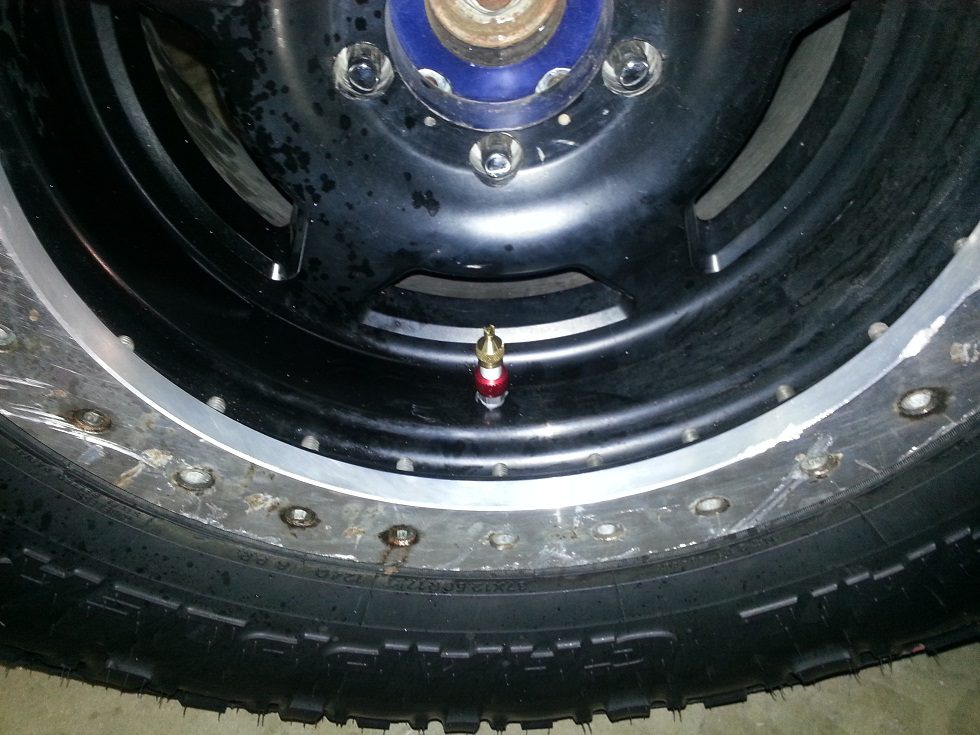

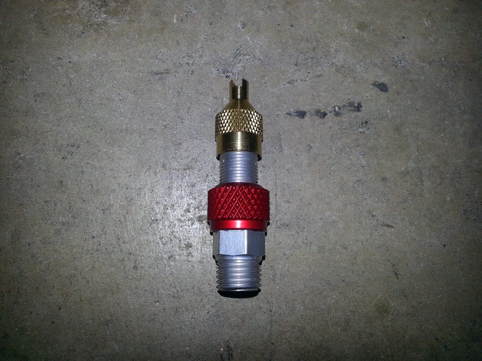

    This week I installed some Monster Valves in the rims to get ready for Moab. With the monster valve installed I can air down the 37s in 20 seconds and air back up in less than 30 seconds. Since you air down and up at least once a day and often twice a day these will be a huge time saver.
