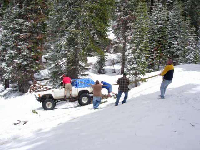

    #3016 Feb 2013, 4:27 PM
    "JohnDF" wrote: I've driven lunchbox lockers in the snow and the tendency is for the rig to follow the slope, right over the edge of a cliff or right into a tree.
    You're making that up. 😀
    Remember this? That's with a longish wheelbase (110+), locked front a rear, and a reasonably light rig - especially since I was rocking my soft top on that run. 😂 😂 I learned how to work with it over time but for my money there's no competition in the snow.
    #3116 Feb 2013, 5:23 PM
    Another fun day on Strawberry
