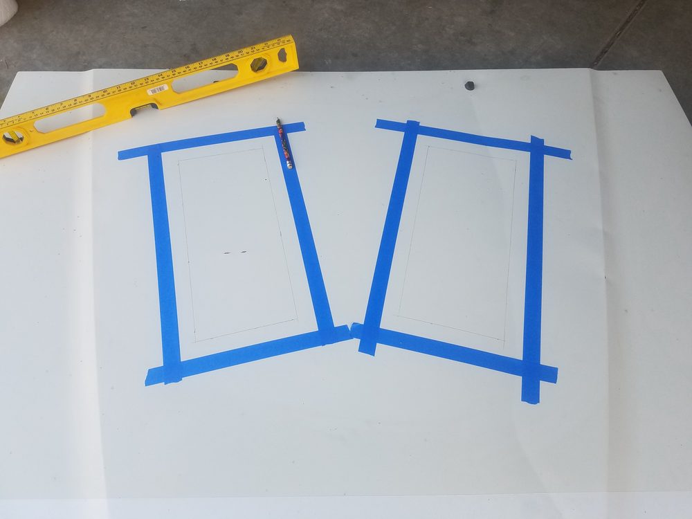

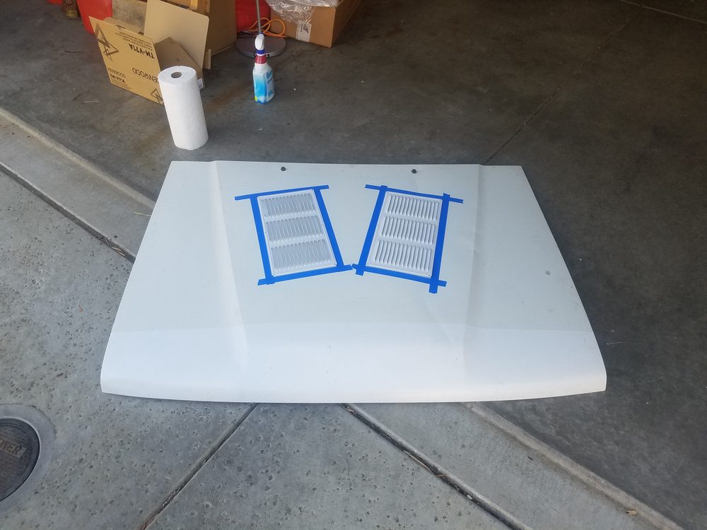

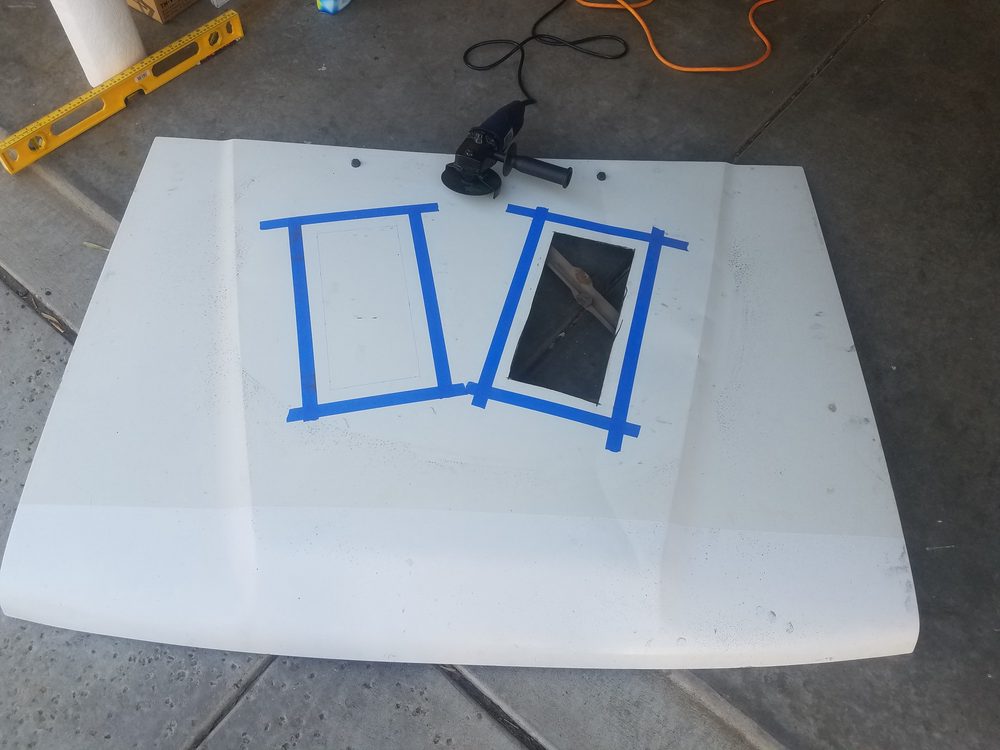

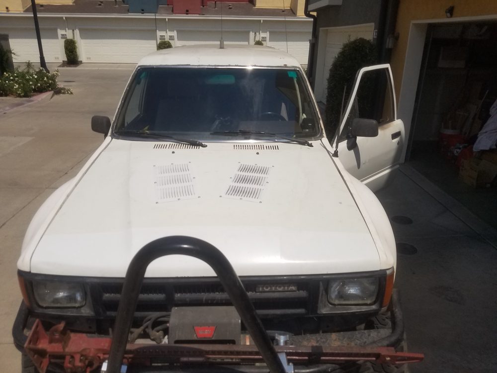

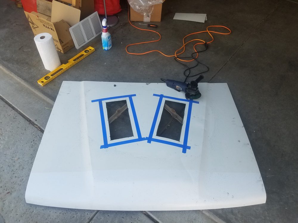

    Tyler - K6TLR said Added hood cowls this morning. First time ever playing with an angle grinder.... it's addicting haha I'm not 100% satisfied with the outcome, but for about $35 I am thrilled (that includes the price on the harbor freight grinder haha). If I ever get around to painting the truck my dream neon green, the screws will blend in much better and give it more of a finished look. For now, it will stay the way it is. 20170803_091743.jpg Laid out the cowls and taped around where I wanted them. 20170803_092232.jpg Measured in 1 inch from all sides 20170803_093651.jpg It's now holy! 20170803_094124.jpg Double the holiness 20170803_121815.jpg Fully installed and back on. Now, the electric fan should be able to easily push the hot air through the engine bay while crawling and steep inclines.

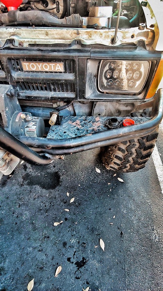

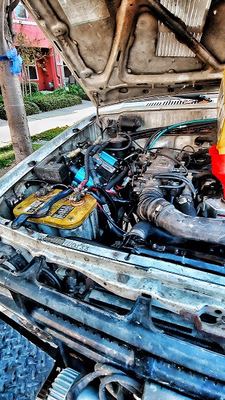

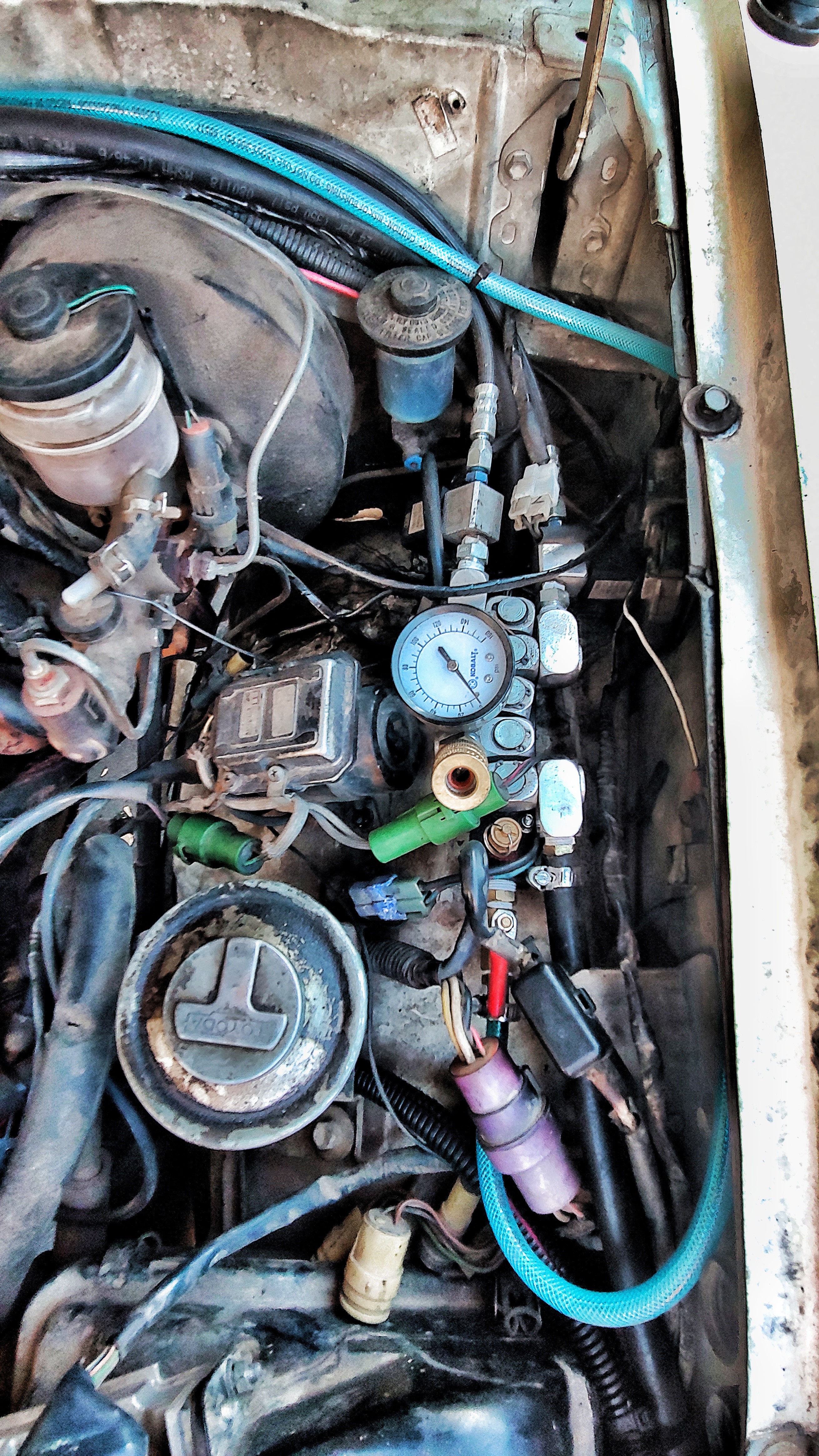

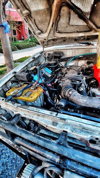

    Just realized I haven't updated this in a while...Heres a list of things I have done, and some pictures of the Twin ARB setup!
    - Twin ARB OBA system with 5 gallon tank, air couplers at front bumper, rear bumper, and driver fender (Oct 201😎
    - Air Conditioning (May 201😎
    - New Alternator, 96 Jaguar XJ6 120amp, and Big 3 Upgrade (Oct 201😎
    - New 185 degree thermostat (Sept 201😎
    - 3 Row radiator (Sept 201😎
    - H4 headlight Wiring Harness (June 201😎
    - 5x7 X Light LED headlights (June 201😎
    - Pinion Brake (Sept 201😎
    - FK Steering Heims (April 201😎
    - New Toyota MAF (Jan 201😎
    - New exhaust manifold gaskets (Jan 201😎
    - New OEM 2.5ohm injectors (August 201😎
