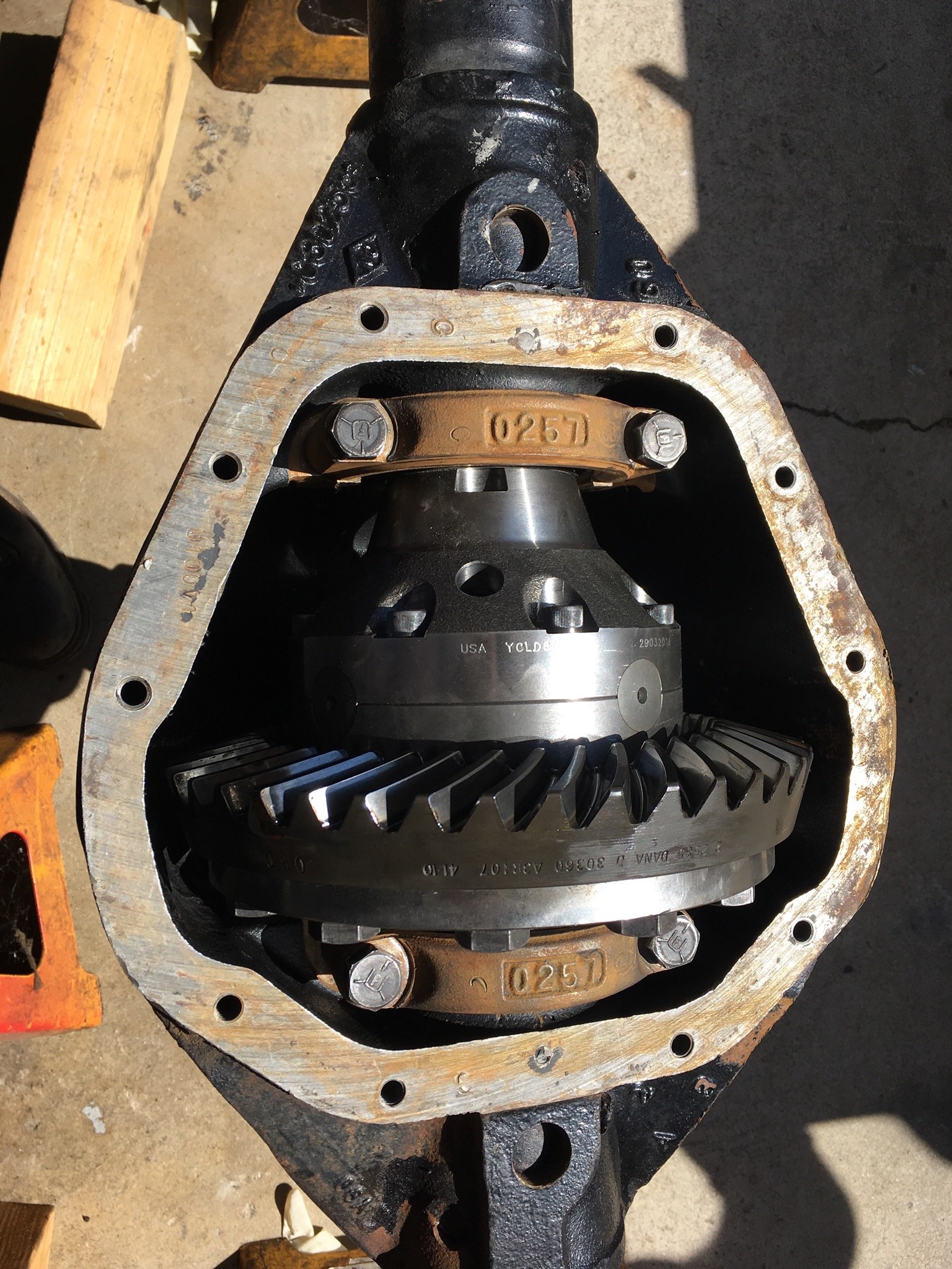

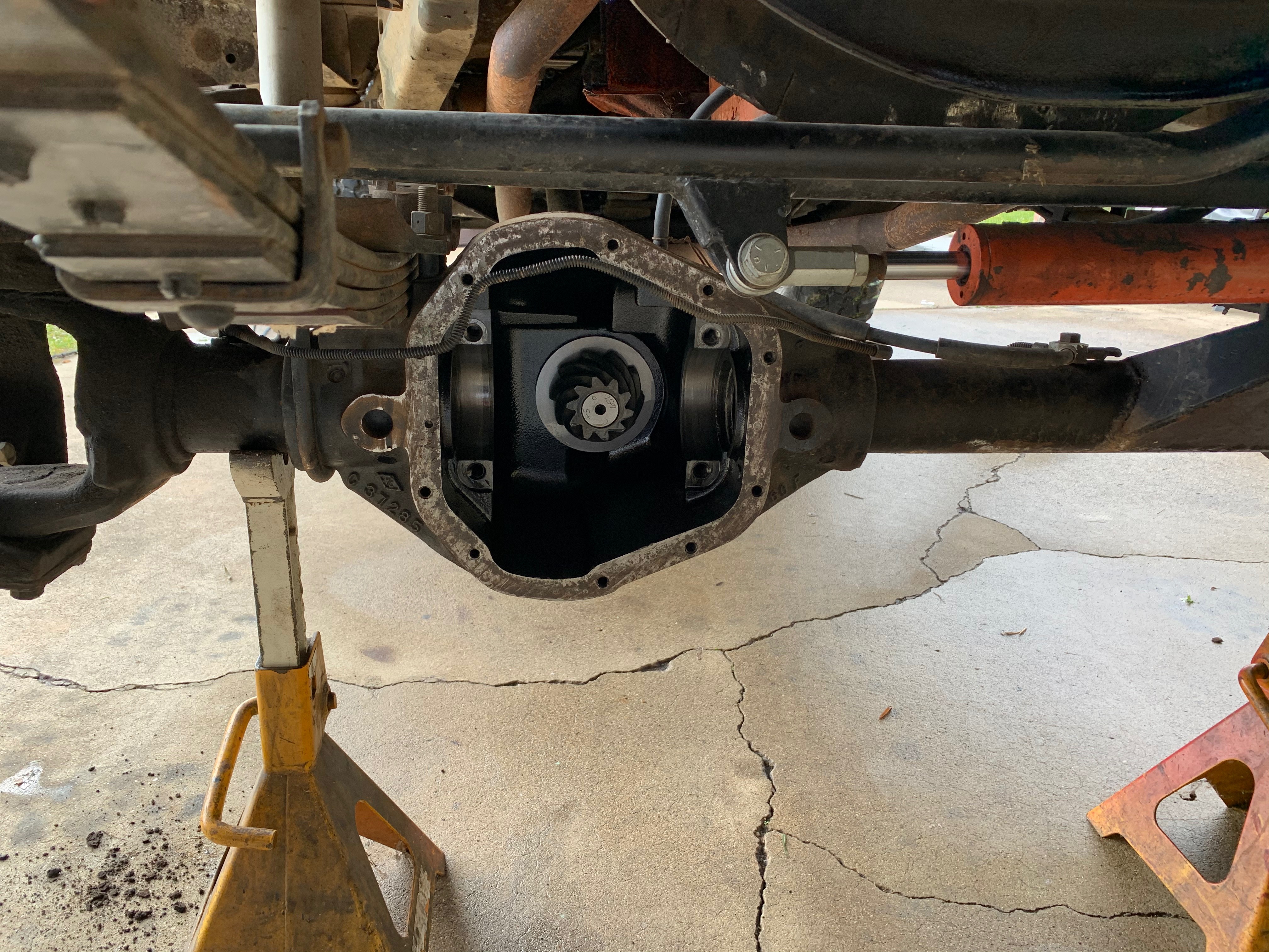

    Here’s another update on my Power Wagon.
    1. Eaton Elocker.

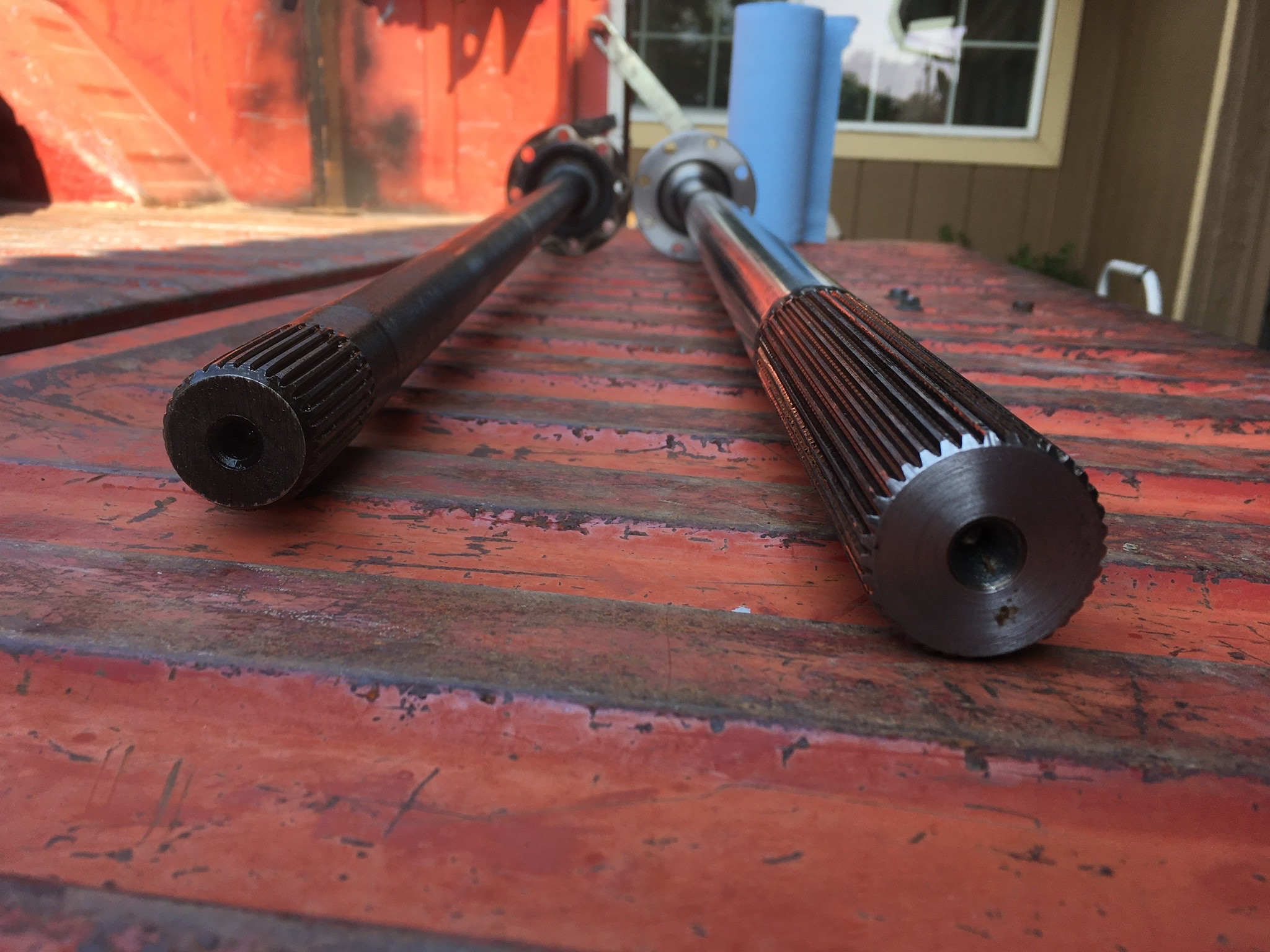

    2. 35 spline Yukon 4340 chrome moly inner axle shafts & Ten Factory 35 spline 4340 chrome moly outer axle shafts & internal hubs with Mile Marker 35 spline lock outs.

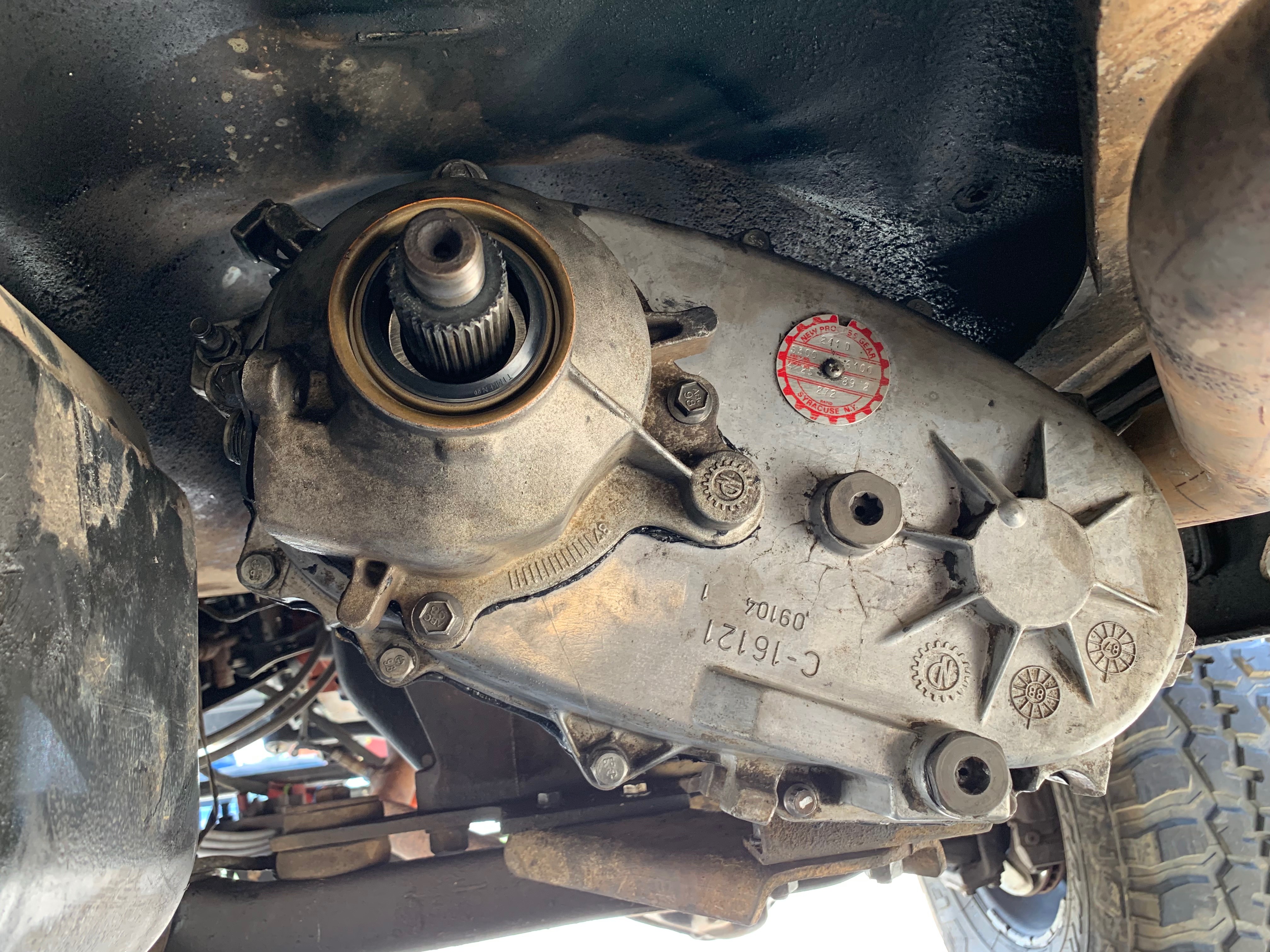

    3. Swapped out the NP 205 for a NP 241 transfer case which increased my final crawl ratio 50 to1 to 74 to 1.

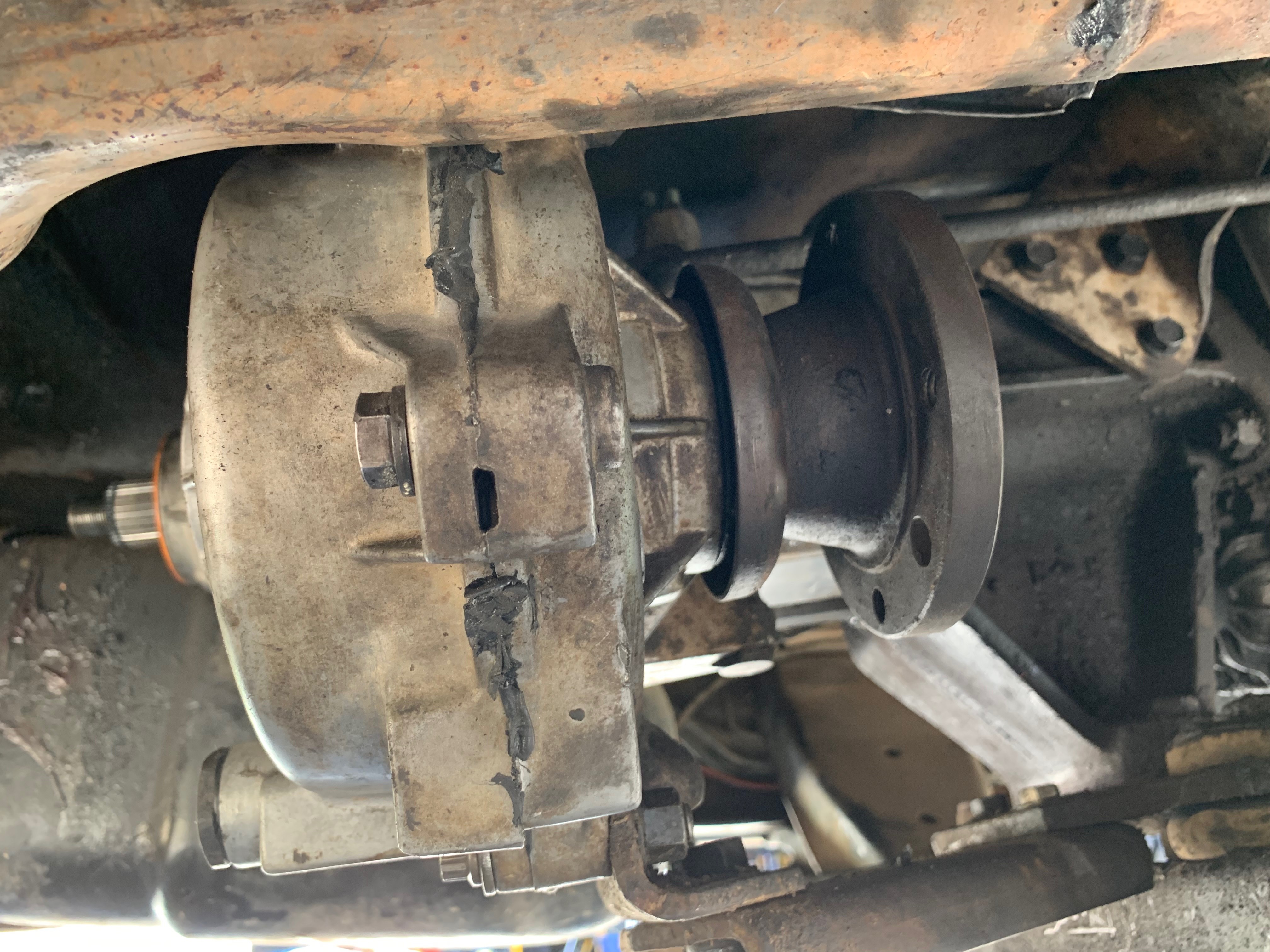

    4. Installed a double cardigan rear drive shaft & raised the pinion angle on the rear axle.959AEA7F-719B-477A-97BD-7281FB5E6603.jpegA462850E-5264-45F6-80AF-7945FCAF13CB.jpeg96D1E0F1-03A7-4E2D-8C9F-0E9CA54BAB56.jpegCA9B58DF-3A64-4DF0-AA3D-B1942FBA8C45.jpegB1C1EAB5-A91D-460D-BC47-E54B090C5050.jpeg

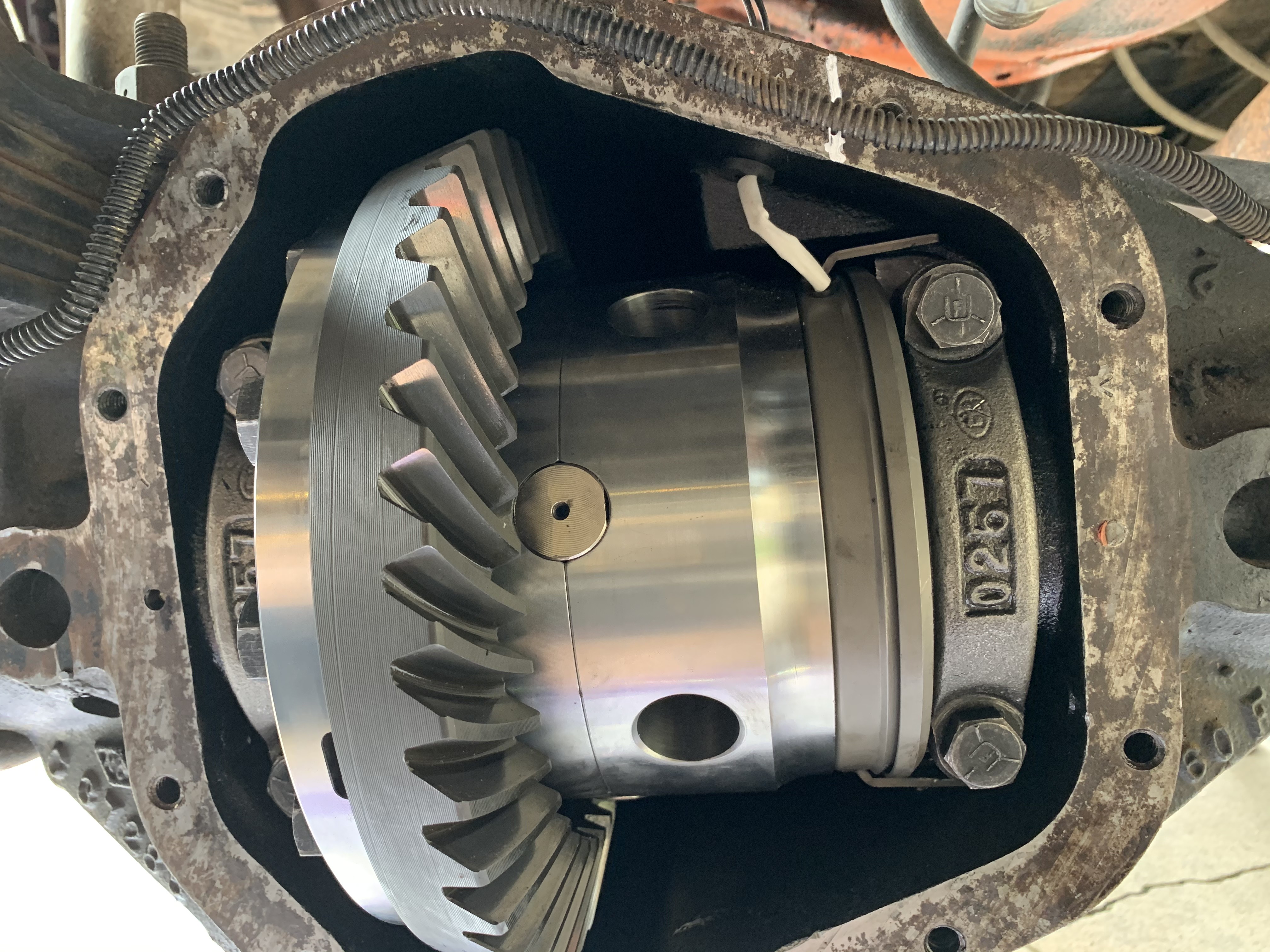

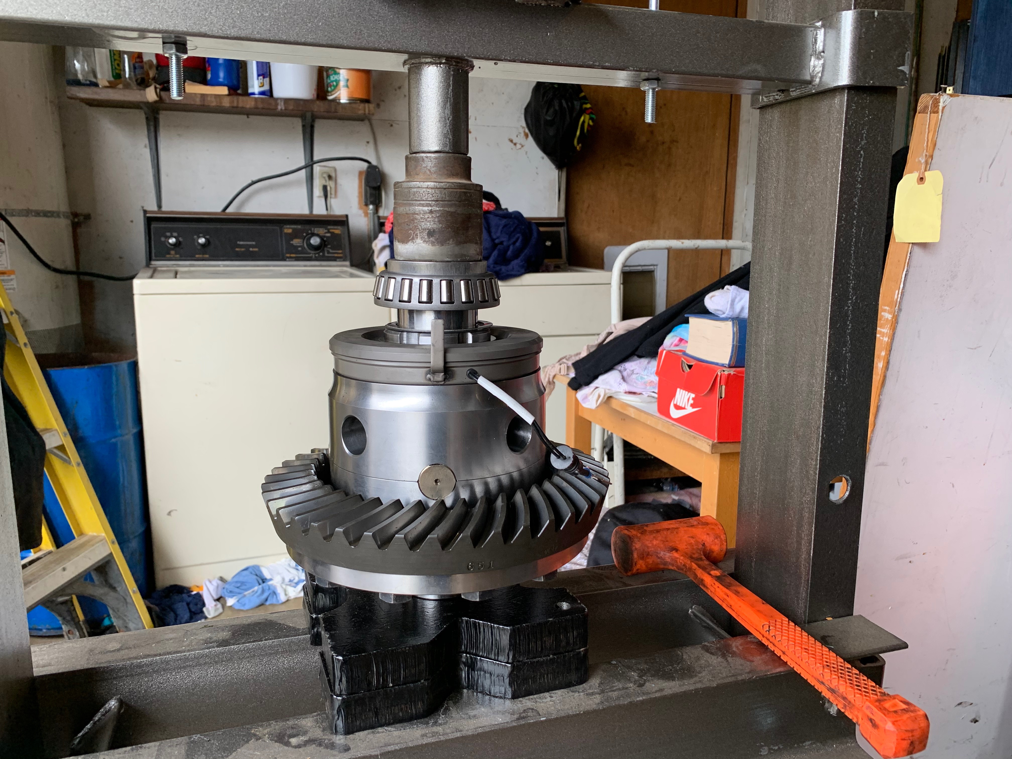

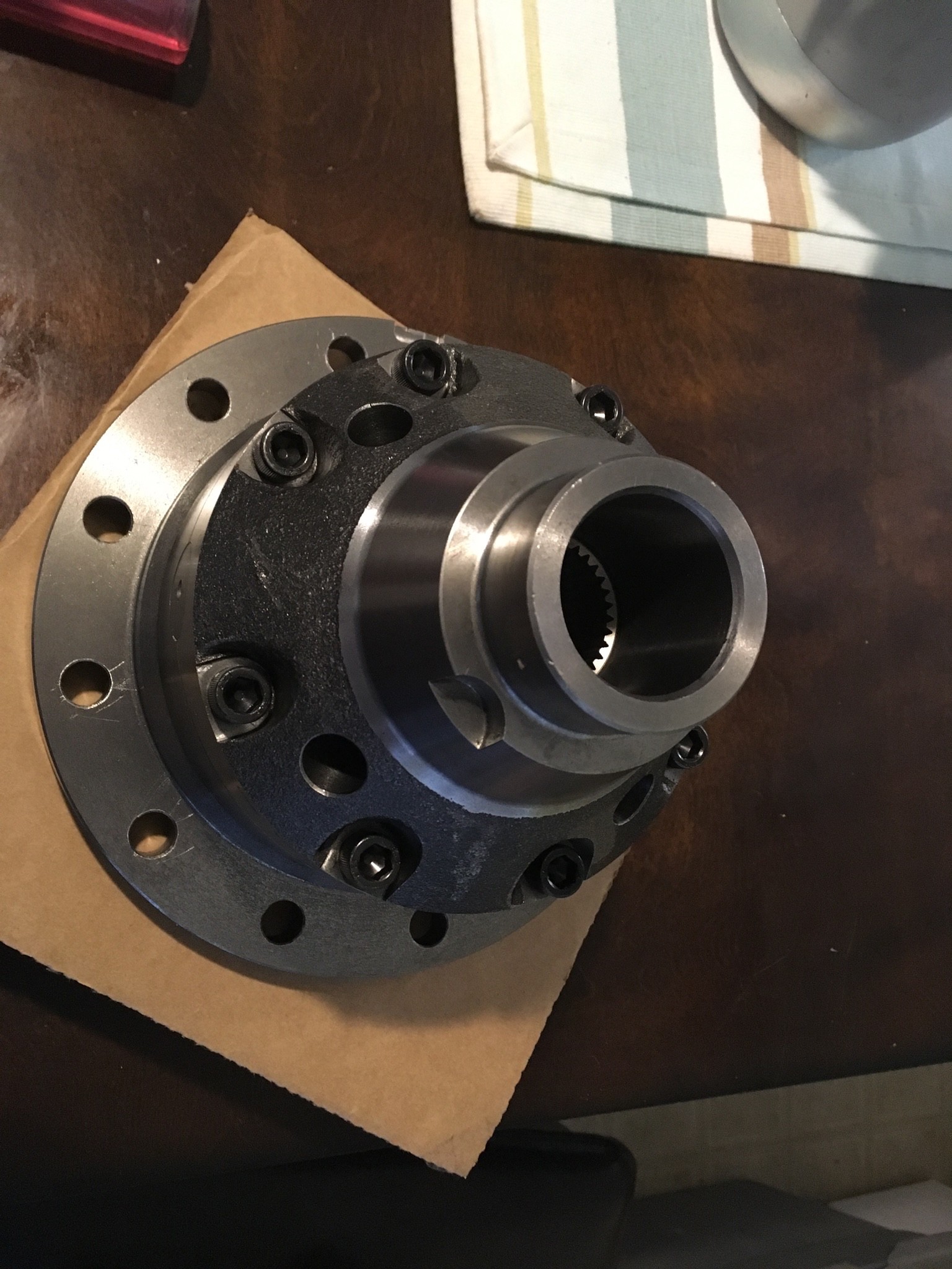

    2ABD8C1D-0791-4980-B295-6F6AB079C0FE.jpegAACCD277-0745-4255-9435-3544F3E7756C.jpeg493E4952-089F-4CCD-8244-C858248450F0.jpegI almost forgot, that I installed a Yukon Grizzly locker & 35 spline Yukon 4340 chrome moly axles in the rear Dana 60

    #2823 Jan 2020, 3:32 AM
    Nice.  Was that the Tom Woods tailshaft conversion or did you find a factory fixed yoke unit?
    #2923 Jan 2020, 3:32 AM
    Dale Clement said 2ABD8C1D-0791-4980-B295-6F6AB079C0FE.jpegAACCD277-0745-4255-9435-3544F3E7756C.jpeg493E4952-089F-4CCD-8244-C858248450F0.jpegI almost forgot, that I installed a Yukon Grizzly locker & 35 spline Yukon 4340 chrome moly axles in the rear Dana 60

    kris_olof said Nice.  Was that the Tom Woods tailshaft conversion or did you find a factory fixed yoke unit?
    It is a factory fixed yoke 241, Dodge trucks used them from around1989 to 1993

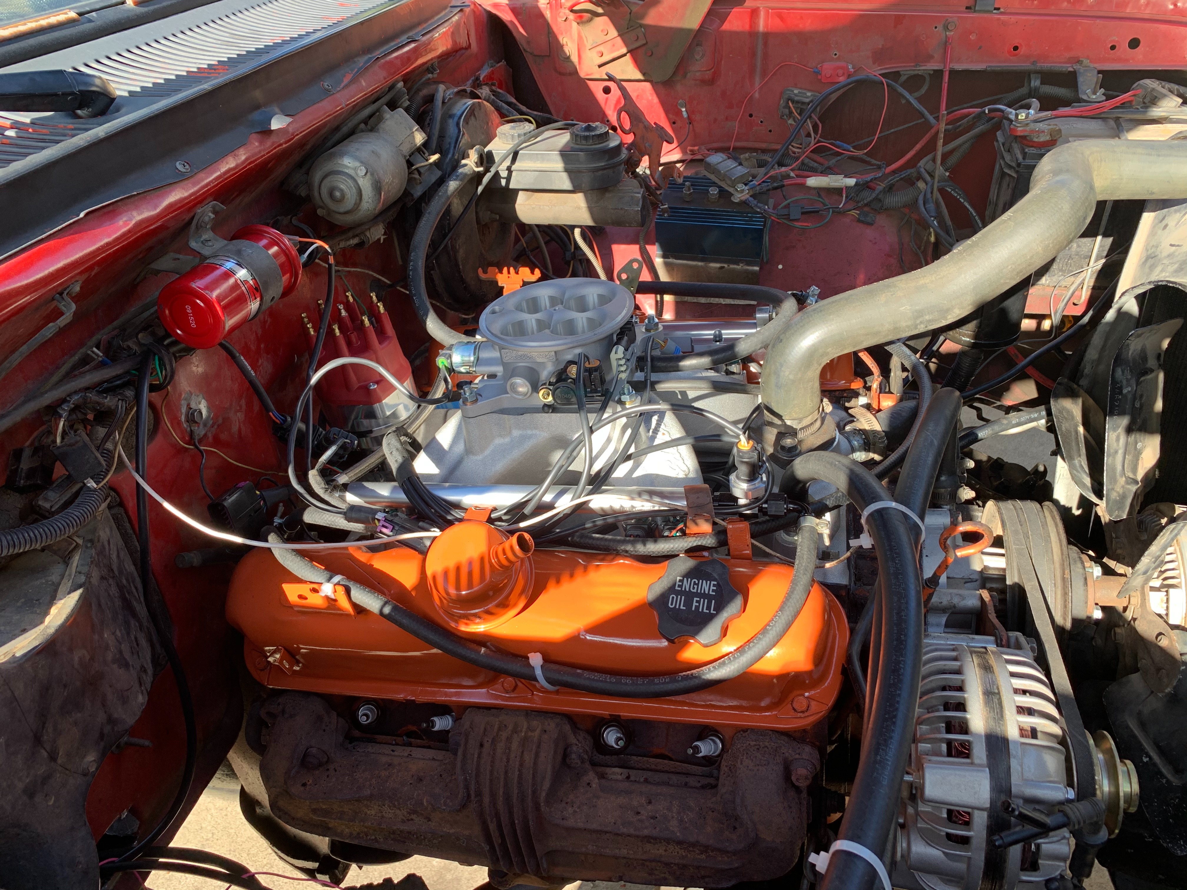

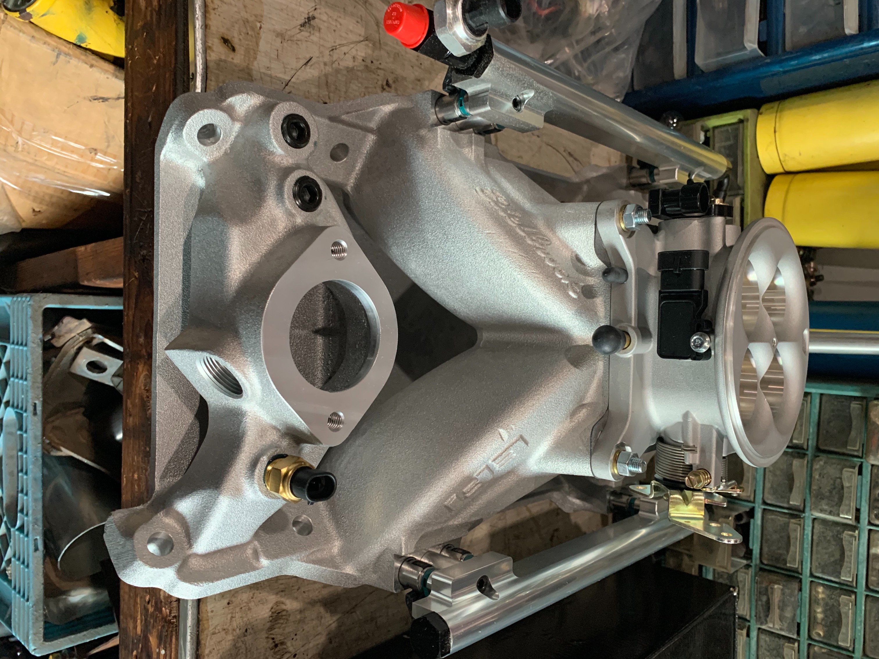

    0DBDC286-2F64-45E9-991C-0467365B095A.jpeg20C762A4-3BE1-4F33-B4C5-C4FB5F1446D2.jpeg3646F8BB-C9FF-456C-B831-D5E3EF5B66F6.jpegHey guys here’s another update on my 1985 Dodge power wagon I ditched the FiTech throttlebody fuel injection and have moved on with a Edelbrock proflo 4multi point fuel injection system which I absolutely love
