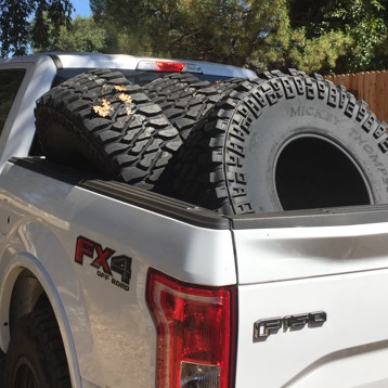

    JohnDF said  So in preparation for my 40s, that are on the UPS truck right now,
    Nice! This will be cool! What tire did you decide upon John?
    #2537 Aug 2017, 3:00 PM
    Same as Greg's, the Mickey Thompson MTZ P3.
    #2548 Aug 2017, 4:51 AM
    Sweet!!  Was it hard to make the cuts?
    #2558 Aug 2017, 5:04 AM
    Gregulator said Sweet!!  Was it hard to make the cuts?
    Nope. New blade in the Sawzall and it cut like butter. I was a little nervous at first, but after the first cut it was "game on".

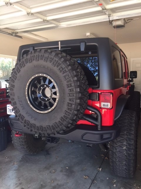

    #26010 Aug 2017, 5:04 AM
    Everything fits, but I do have some frame rub at full lock.
    #26110 Aug 2017, 6:44 AM
    Make wider turns 😂but seriously it looks great👍

    #26510 Aug 2017, 2:42 PM
    Looks like I need to get some adjustable lower front control arms and push my front axle forward a couple of inches to alleviate the rubbing on the frame.

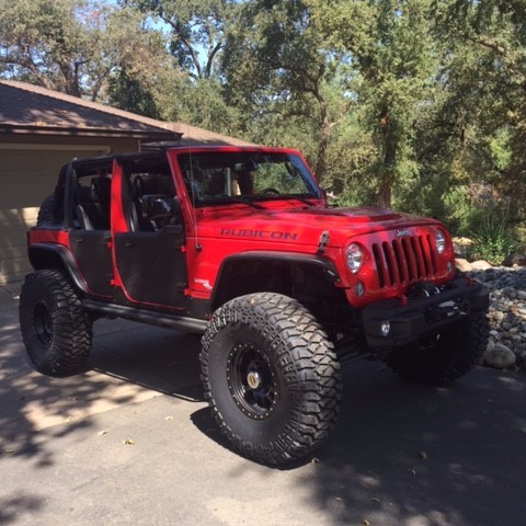

  16. Tyler - K6TLR Subscriber
    #26611 Aug 2017, 4:01 AM
    The rig looked awesome last night, John! those mickeys are beefffyyyyyyyyy. Makes me want to look into 40s, but I don't think the squirrels in my engine would appreciate it on the highway haha. I will have to stick to 37/38s until I green sticker it and turn it into a trailer queen. Very nice choice!
    #26724 Aug 2017, 12:58 PM
    I put in my new front adjustable lower control arms. I adjusted the lowers to 24" and the uppers to 19-1/2" (Tera's suggested measurements). Zero rubbing at full turn now. I'll take it in for an alignment on Saturday.

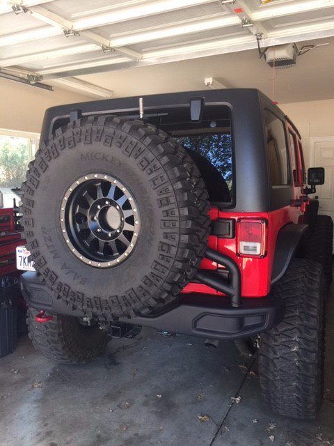

    #27030 Aug 2017, 11:07 AM
    I got the Jeep aligned and everything is great. No rubbing issues and it tracks perfectly straight.
    I also got the matching spare tire mounted. And yes, it still fits in the garage 😎
  21. davesjk Subscriber
    #27130 Aug 2017, 11:53 AM
    JohnDF said I got the Jeep aligned and everything is great. No rubbing issues and it tracks perfectly straight. I also got the matching spare tire mounted. And yes, it still fits in the garage 😎   IMG_1185.jpg
    that spare looks MASSIVE on the back of there!
    #27230 Aug 2017, 1:28 PM
    It was the cause of the recent solar eclipse.😎

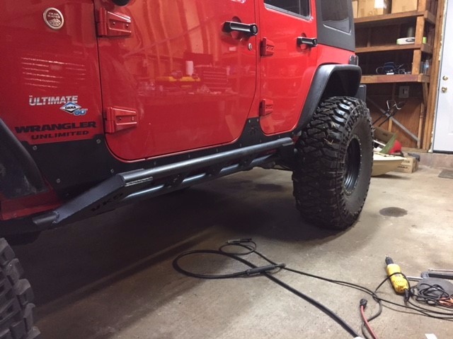

    #2733 Nov 2017, 11:59 AM
    Sliders installed...
    Thanks to Brian (Jeff's son).

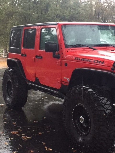

    #2754 Nov 2017, 1:51 AM
