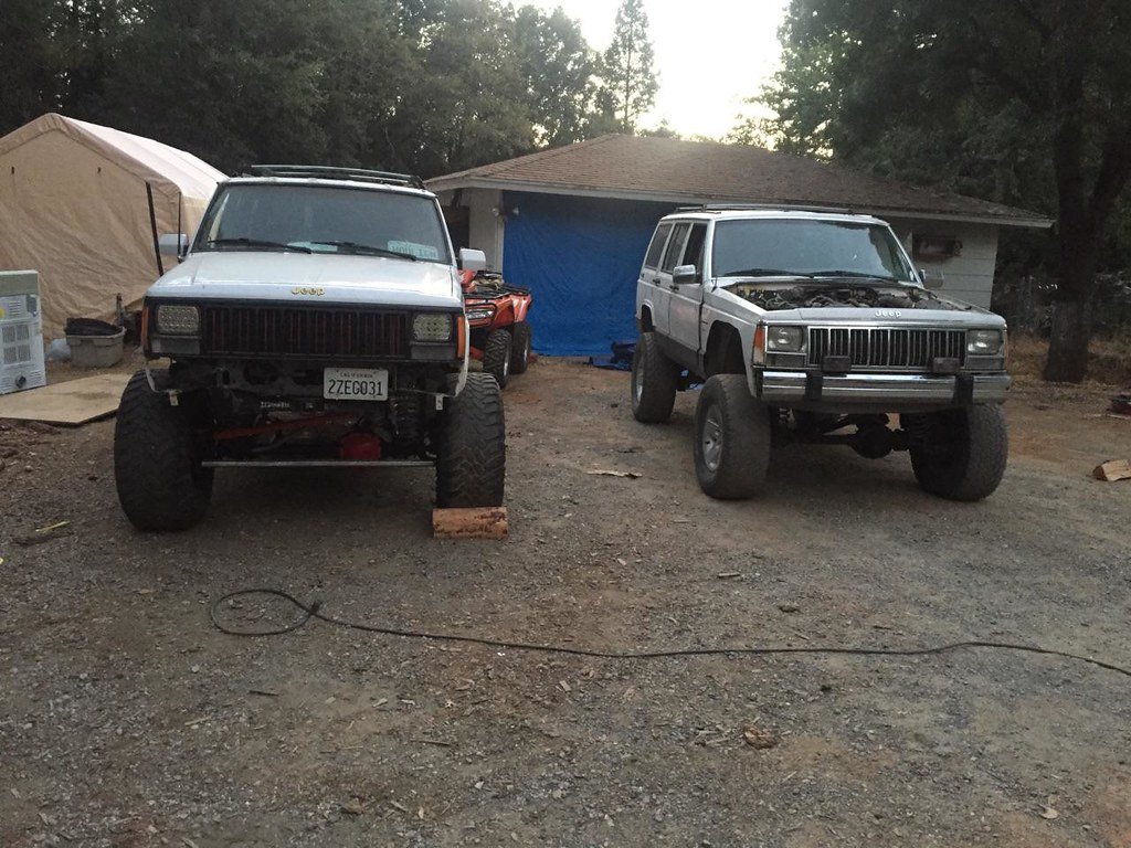

    #6425 Jul 2017, 7:36 AM
    Lots of progress on Cherokee Ranch. Here is a shot of Logan and Casey's Jeeps:
    https://farm5.staticflickr.com/4317/35996732432_772ed2dc01_b.jpg
    Logan's is on the left. Finally got the front end all together, installed, and OUT OF MY GARAGE. Now it is time for the engine swap.
    Casey is currently cutting holes in his hood for the louvered panels he has. He has been up to the Rubicon several time already and is enjoying his ride.
