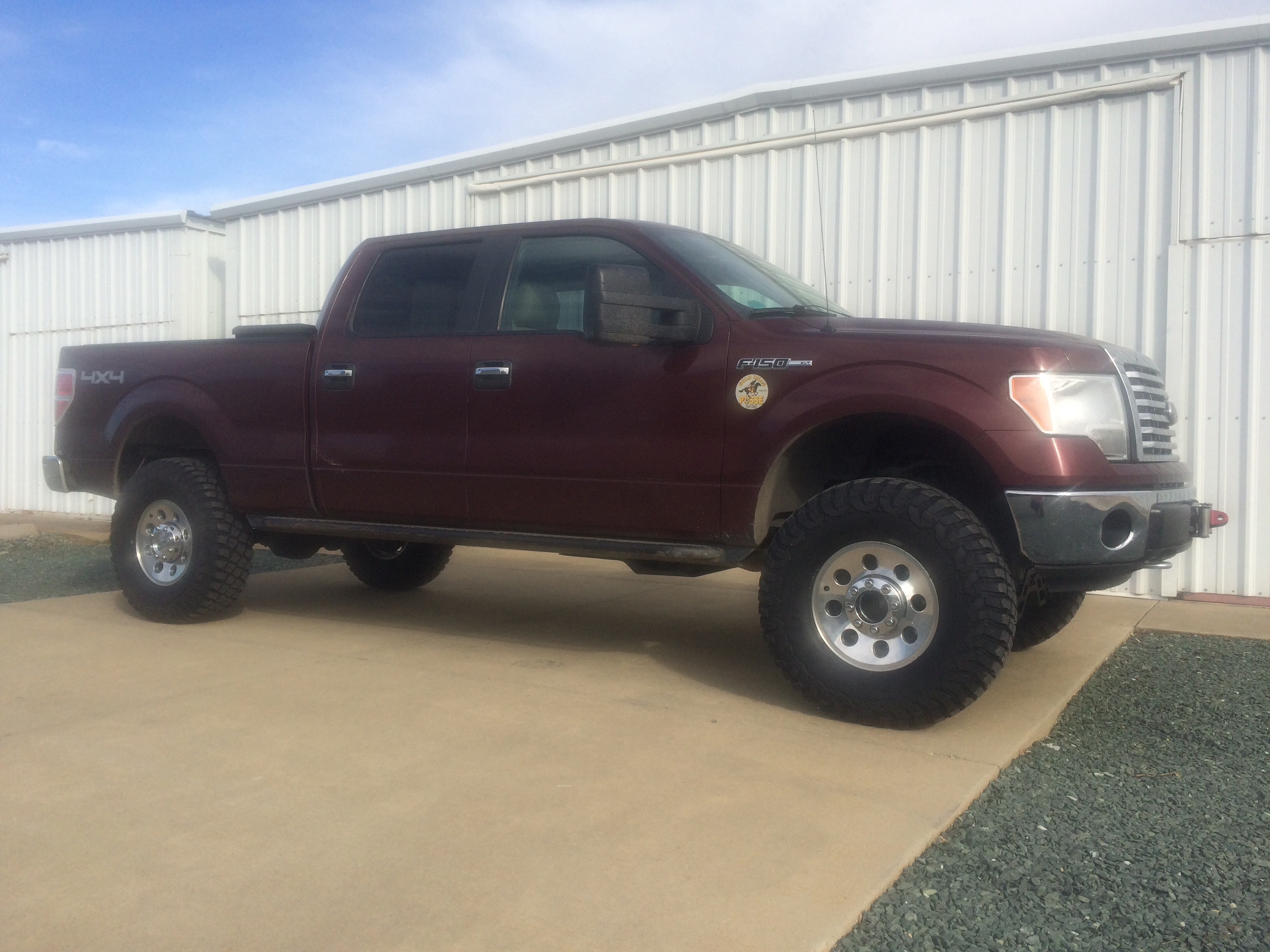

    #8621 Feb 2020, 10:36 AM
    My ride has new shoes! 37x12.50x17 BFG Mud Terrain KM3.

    #8721 Feb 2020, 11:37 PM
    Looks good Rich!
  13. Josh Subscriber
    #8821 Feb 2020, 11:48 PM
    Congrats Rich!
    Good choice.
    #8922 Feb 2020, 12:17 AM
    Looks great Rich, good move
    #9022 Feb 2020, 12:46 AM
    Nice!
  16. Dale Clement Member Joined: June 2015
    #9122 Feb 2020, 7:07 AM
    They look great Rich!
    #9222 Feb 2020, 11:27 AM
    Very nice Rich
    #9323 Feb 2020, 1:23 AM
    Looks purdy.
