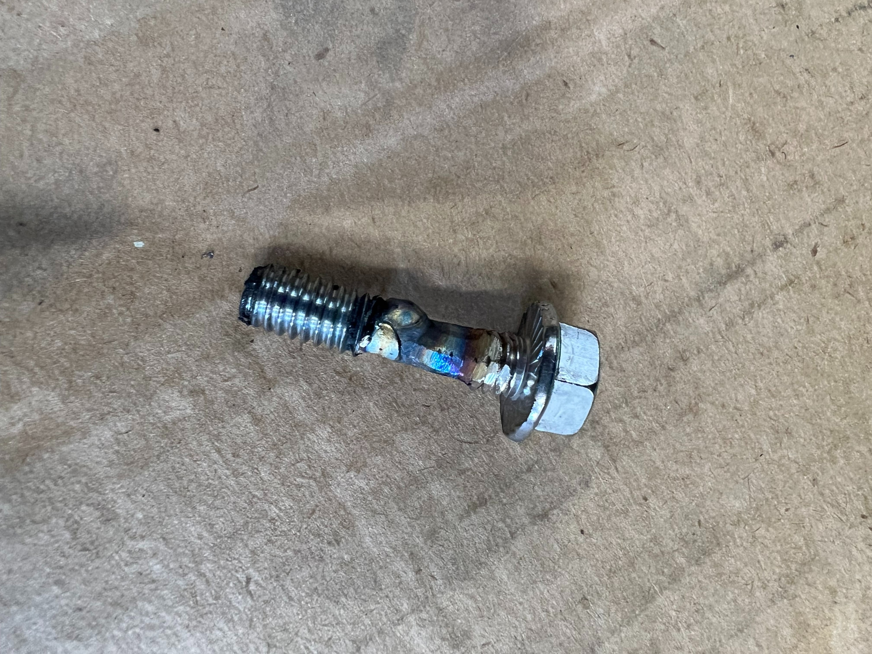

    Well, I drilled a hole into the broken diff cover bolt and tried to use an extractor on it. Of course, the extractor broke. I have tried drilling the extractor out but I don't see any metal shavings. Any recommendations on how to get the bolt out? If I can't get it out I will put it back together and see if I can run it without the bolt for the Rubicon run. It's the lowest bolt and was sheared off by a rock. There is no par of the bolt that extends beyond the face of the diff, so no way to weld something on to it.
    #496 Jul 2023, 12:50 PM
    Got it fixed. I ground down the thread end of a bolt and my son, who is a very talented pipe welder by trade, was able to weld it on and remove the sheared off end of the bolt.

    Wow. Lucky. Very talented fix Jeff. Well done.
