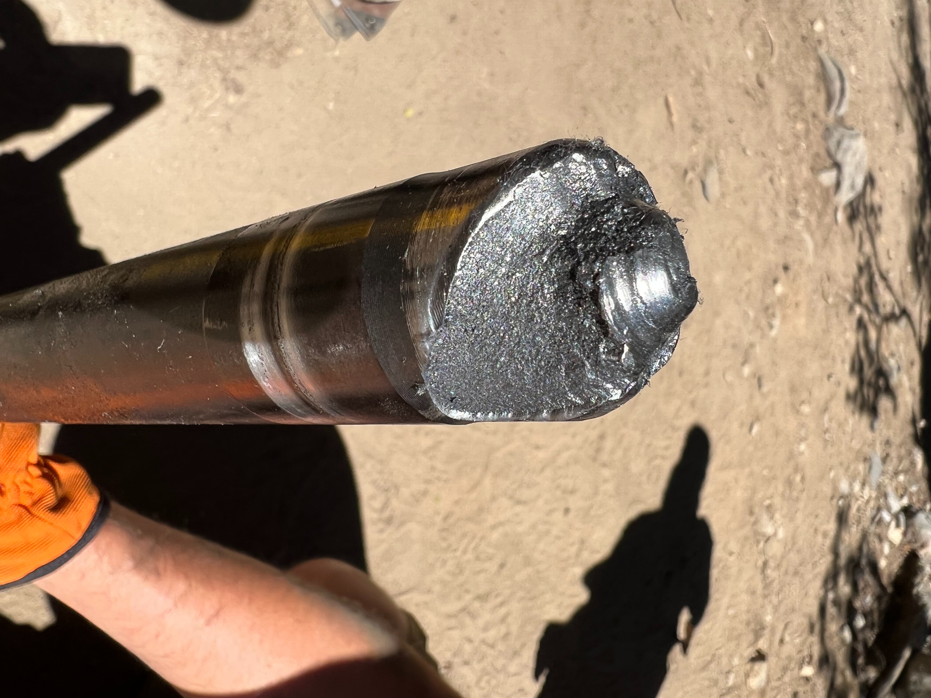

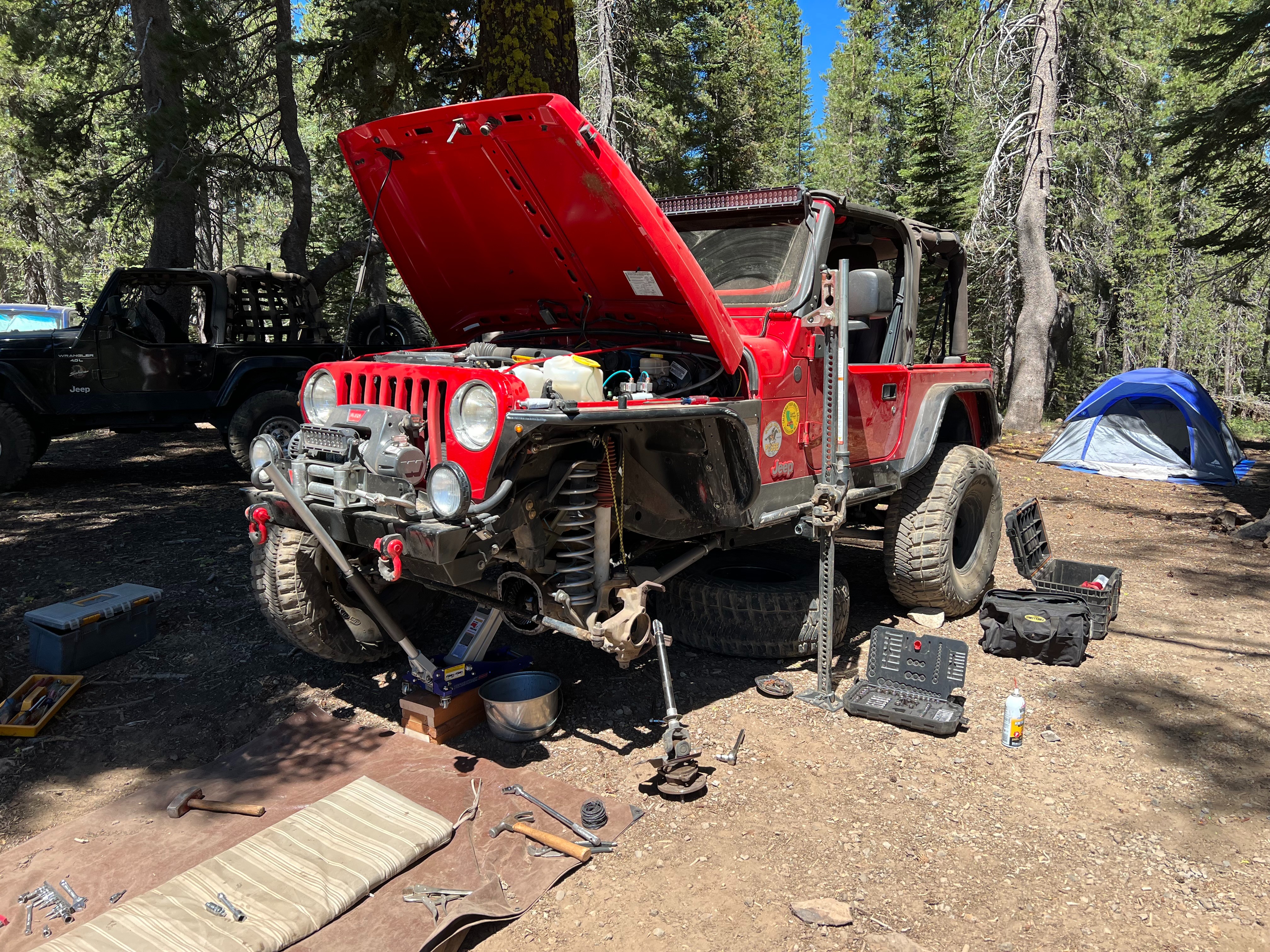

    #616 Aug 2022, 2:08 AM
    Jeff_R said Hi Gerald. It was nice meeting you at Sierra Trek. Thanks for all the help and advice from your group in regard to fixing my TJ. I'm sorry that Rob and Brian were so loud late Saturday night. 😀 Hope to see you at a meeting soon.
    Jeff - what broke?
    #716 Aug 2022, 2:43 AM
    It appears that my rear locker was not working probably due to an air leak in the diff or a solenoid problem. After I crossed the river at committee crossing on the way out I broke the front passenger side G2 chromoly axel shaft right at the neck of the splines while climbing a ledge. We didn't know what the problem was at the time other than the fact that I had no front wheel drive but my front driveshaft was still spinning when I engaged the front atlas shifter. Some thought it was a ring and pinion issue but there was no noise or grinding sound when moving. Spoke to Rob on the phone that day to see if he could bring parts. He thought, based on all the symptoms, that I sheared the pinion shaft. Seemed very logical as I have a Dana 30 and the shaft could be the weak link. After a lot more diagnostic work and talking to people we decided to open up the diff and take a look. Found the brass air line for the locker broken at both ends but no other damage. Pulled the short (drivers side) axel shaft and that was fine. Pulled the long (passenger side) shaft and it was broken at the neck at the splines. It was twisted as were some of the splines. So in order to fix it now, I need the lockers serviced and need a new shaft and seal on the passenger side. Or upgrade or both (fix it for now and upgrade to a front Dana 44 or front and rear axel upgrades. Decisions, decisions.
    I pulled my records and I have had that shaft for 12 years. I believe the warranty is 10 years on that shaft. I will confirm with WFO who did the original work to see if I can get a free replacement.

    #816 Aug 2022, 3:48 AM
    Jeff_R said It appears that my rear locker was not working probably due to an air leak in the diff or a solenoid problem. After I crossed the river at committee crossing on the way out I broke the front passenger side G2 chromoly axel shaft right at the neck of the splines while climbing a ledge. We didn't know what the problem was at the time other than the fact that I had no front wheel drive but my front driveshaft was still spinning when I engaged the front atlas shifter. Some thought it was a ring and pinion issue but there was no noise or grinding sound when moving. Spoke to Rob on the phone that day to see if he could bring parts. He thought, based on all the symptoms, that I sheared the pinion shaft. Seemed very logical as I have a Dana 30 and the shaft could be the weak link. After a lot more diagnostic work and talking to people we decided to open up the diff and take a look. Found the brass air line for the locker broken at both ends but no other damage. Pulled the short (drivers side) axel shaft and that was fine. Pulled the long (passenger side) shaft and it was broken at the neck at the splines. It was twisted as were some of the splines. So in order to fix it now, I need the lockers serviced and need a new shaft and seal on the passenger side. Or upgrade or both (fix it for now and upgrade to a front Dana 44 or front and rear axel upgrades. Decisions, decisions.
    Wow, that a bummer. Did you get out ok using rear only?? Changing axles is a costly affair. I was fortunate given all the circumstances, & it was expensive at that! Hopefully, it'll work out. Keep us all informed.
    #916 Aug 2022, 7:19 AM
    I only had 2WD and was towed over many of the obstacles by a buggy. He also came very close to pulling my Jeep over on the driver's side because he kept pulling when I was way off camber. I was honking my horn and yelling at the top of my lungs and he didn't hear me. Fortunately he glanced back and hit the brakes when he saw how off camber I was.
