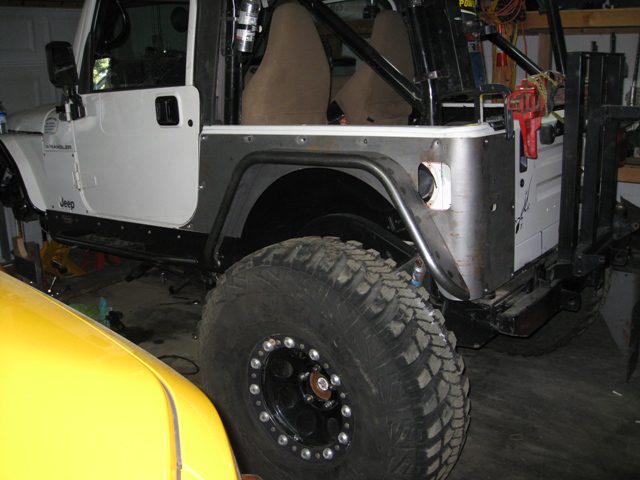

    #5413 Jul 2009, 6:30 PM
    Started on the rear fenders
    #5513 Jul 2009, 7:35 PM
    Looking good.

    #5816 Jul 2009, 2:07 PM
    The corners/flares look good. Are you going to trim more inside the flare?
  9. RobD started this Subscriber
    #5916 Jul 2009, 4:39 PM
    "JohnDF" wrote: The corners/flares look good. Are you going to trim more inside the flare?
    I am going to cut most of it out. I will leave just enough to weld the flares on the inside to the corners...
