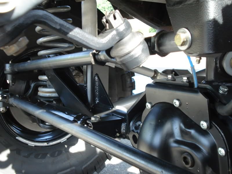

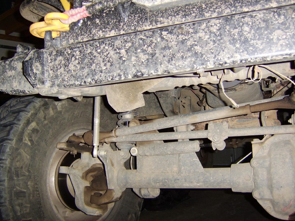

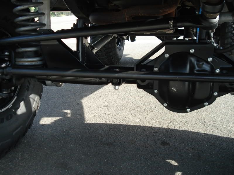

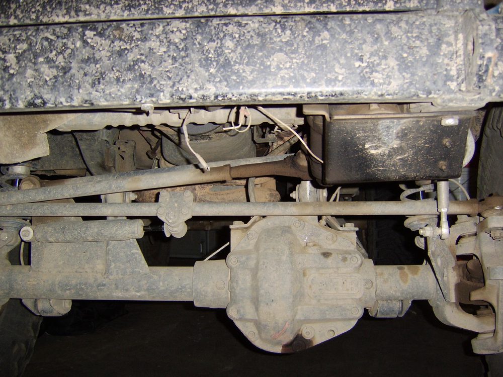

    If you get a chance, can you post me a photo of your axle mounted tracbar bracket? I am thinking of using the same thing. I am just curious as to where it sits on your axle in comparison to the coil spring, etc..

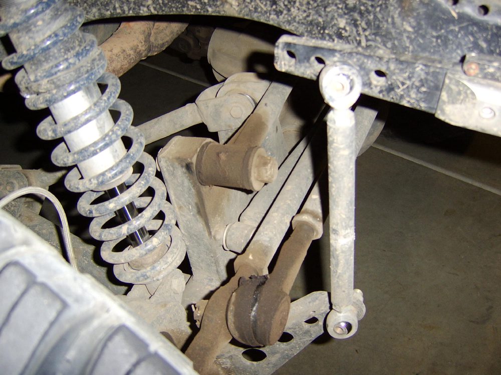

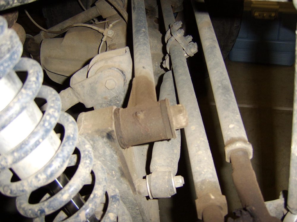

    Can I get you to post some photos of your passenger side steering set up on your high steer arm? Are you running crossover high steer or are your still running the high steer with the inverted Y set up (drag link connects into the tie rod ?) Can you also post some photos of your track bar set up on your axle?

    I will get some pics posted. I still run the inverted Y with my high steer. The track bar uses a Poly Performance lower control arm bushing with a 3/4" bolt that mounts to one side. I'll make sure you see it in the pictures.

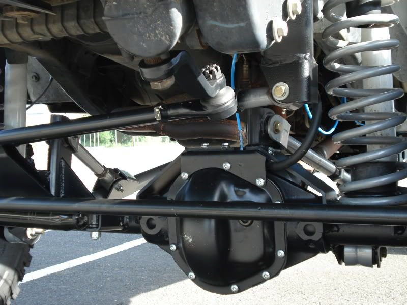

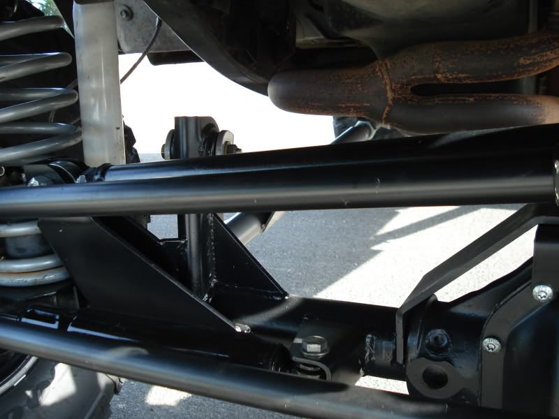

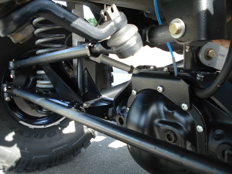

  15. Justin Subscriber
    #9011 Aug 2009, 7:29 PM
    "RobD" wrote: Justin,
    Thanks!!!
    Here are some pictures from when it was all new. If you need any different pictures, let me know.
    #9111 Aug 2009, 11:08 PM
    Here are pics of my 60. Let me know if you need other angles.

    #9312 Aug 2009, 7:00 AM
    Rob, let me know if you want some pictures of my axle. It's cleaner than Brads. πŸ˜€

    I wonder if some of my steering problems come from the fact that my trackbar doesn't line up perfectly with my draglink? Both Brad's and Justin's are almost perfectly aligned, while mine is off by sveral degrees. Could that cause the steering to pull?

    No, it may cause bump steer, but your steering issue is probably related to the fact your camber on the driver side is like 20 degrees 😲

    I think the extra lift makes a difference in the angles (and clearance). I do run the RE upper track bar mount. The only binding I had was I rub on the upper control arm on the driver side, and my zirk had to be removed on my drag link because it hit my ORO arm. Also, I had to limit my ORO to the second mounting hole, when the farthest back would have been ideal.
    On the turning side, my turning radius is within 12in of a D30. Don't let anyone tell you that D60's dramatically increase your turning radius. If this happens, there is something wrong with the build. My axle originally sucked turning becuase it was built incorrectly.
