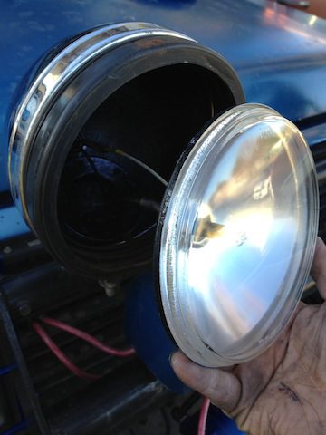

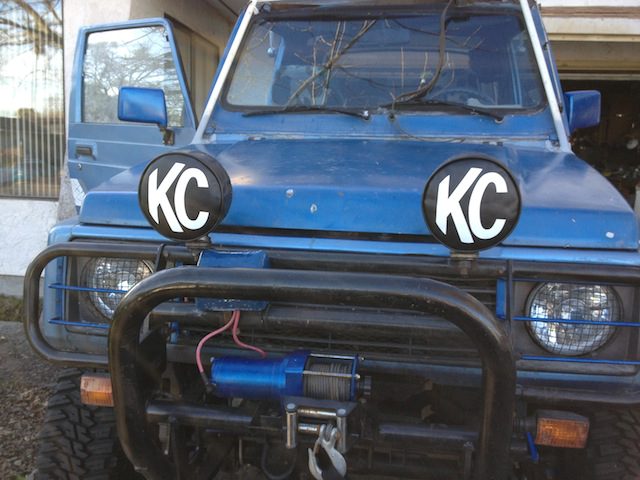

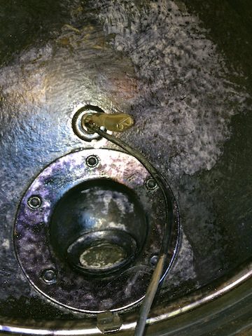

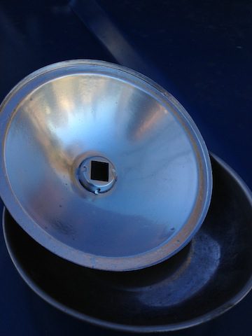

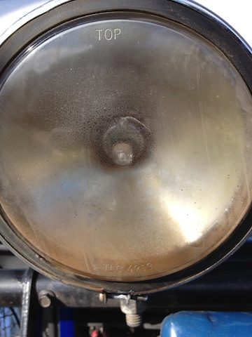

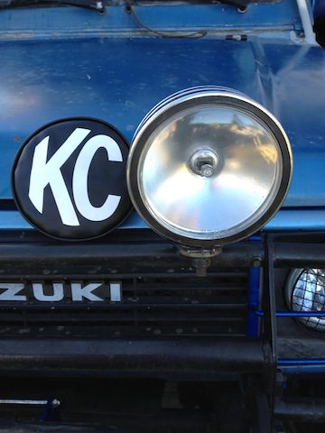

    My KC Daylighters on my Suzuki Samurai are over 25 years old, Friday on the way home I stopped by 4 Wheel Parts and bought new covers. They looked so nice today I decided to give the actual lights a make-over. The old covers were cracked, brittle, and had holes in them. The lenses were dirty and there was moisture inside. I took the lights apart, found a lot of rust inside. I cleaned the loose rust inside the light housing and used Corroseal to stop the rust. It actually changes the rust and acts like a primer. I took off the chrome on the reflector and buffed it with a wire wheel used chrome paint to resurface the reflector. cleaned the lens and reassembled the light. I think they turned out real good. may not last for 25 more years, but at least "today" I don't have to buy a new set.

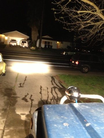

    #618 Mar 2013, 8:24 PM

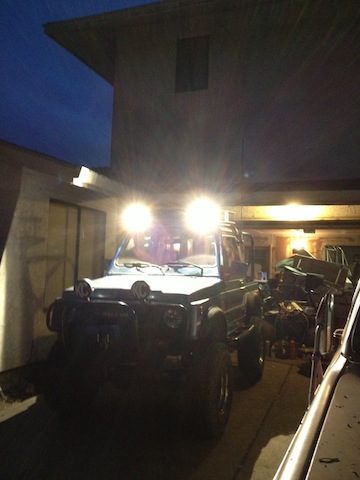

    Josh gave me a set of KC Budget Daylighters. I found where I could get the oringinal bulbs for them. At the march madness sale at 4 Wheel Parts I bought a duel wiring set. So Josh.... They are lighting it up once more. Thank you sir !!
    My opinion there is nothing like the look of "classic" KC Daylighters.
    I have to get a new bulb for the lower set and then I'll post a pic with them all on.

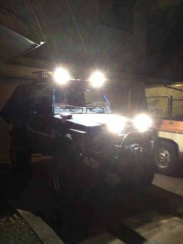

  9. Specialsoundman started this Member Joined: January 2013
    #921 Mar 2013, 9:22 PM

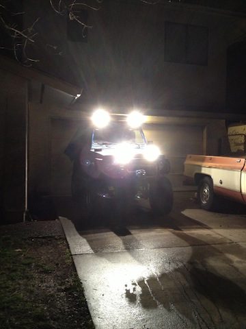

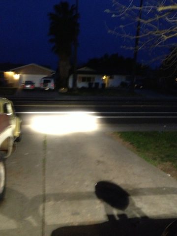

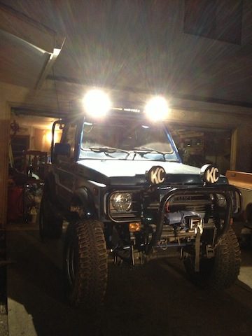

    OK stopped by 4 Wheel parts and picked up news bulbs for the lower KC's. And here's what they look like all lit up. I'll have the rock lights running in a couple days.

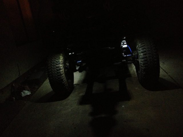

  13. Specialsoundman started this Member Joined: January 2013
    #1323 Mar 2013, 8:36 PM

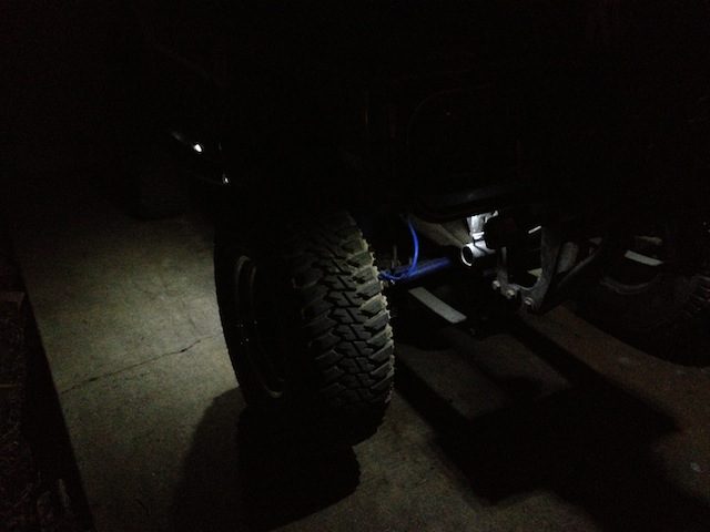

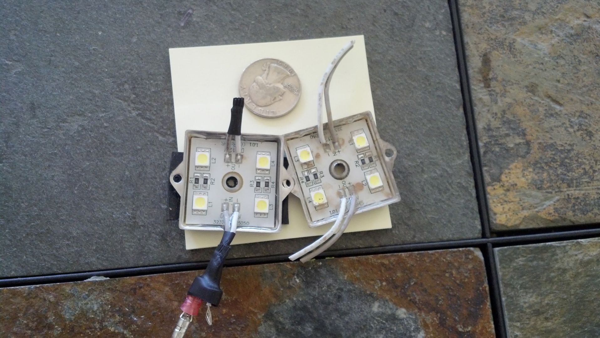

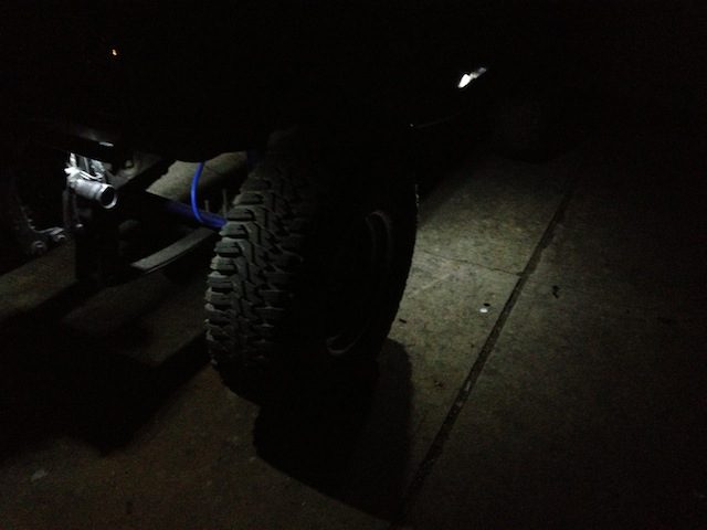

    And the lighting saga continues........... Rock on, well some of them.

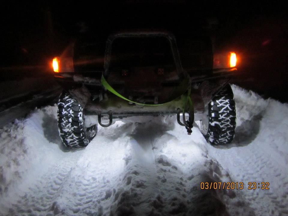

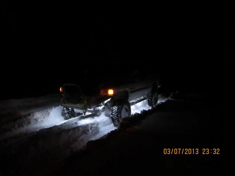

    #1424 Mar 2013, 7:55 AM
    Looking great David!
    Hopefully you can get some up under the bumper area.

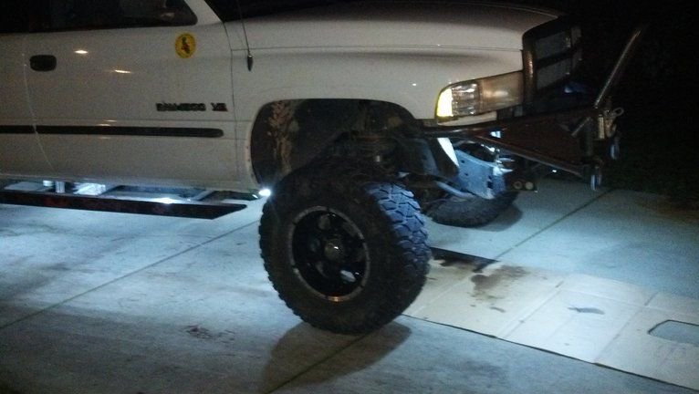

    I've still got a few more to add, but hopefully/maybe/maybe not gives some ideas.

  16. Specialsoundman started this Member Joined: January 2013
    #1624 Mar 2013, 11:47 AM
    "Wh1t3Nukle" wrote: Looking great David!
    Yes I am planning on adding some more in the front. I also will have some in back also. Adding, just a few at a time. Don't want to "go over the top"......... ya right - Light it up !!!
  17. Josh Subscriber
    #1724 Mar 2013, 12:38 PM
    That is cool Carl. Looks like daylight under your truck. Are those LED lights?
    #1824 Mar 2013, 1:40 PM
    Yes they are. I'll put a picture up shortly.
