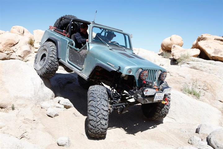

    Fred has done some hoodvents and he's been quite happy with the mod. I'm changing my hood which adds hood vents as well.

    Yeah your hood is awesome.. Wish there was a TJ like that.. Thanks for the input.

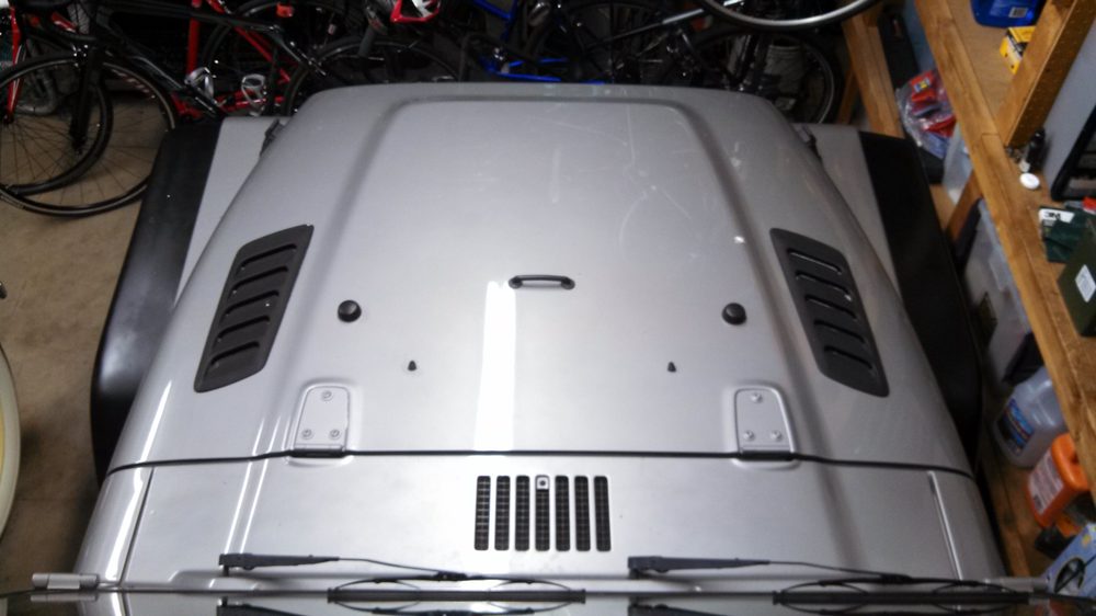

    Here's a picture of my Grand Am vents.
    As far as water goes, I've got a "cold" air intake and the filter is almost under the passenger side vent. I've got an Outerwear filter cover that's supposed to be water resistant. I haven't had any problems with it.
    Edit) Looks like I need to repaint the vents again, unpainted they're white. 😳

    Looks like a clean install. Looks factory. I'll be getting the poison spyder louvers in May, I'll do a small write up when I do it.
    Thanks again for the pic.
