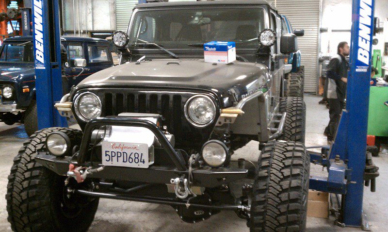

    What WMS did you go with on the front and rear axle? Are you staying with springs in the front or going coil overs?

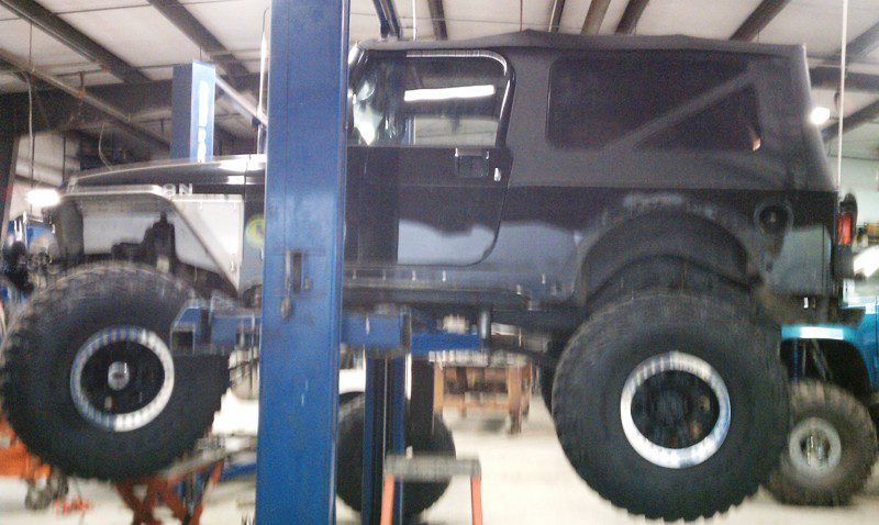

    got all 4 tires mounted yesterday. these things are freeking huge ๐Ÿ˜ ๐Ÿ˜
    going to head to WFO this afternoon for a mock up....bringing the air cutoff wheel :hack:

    After much debating I decided to stick with full width in the front 69โ€ and rear 67โ€. If it doesnโ€™t rub my lowers I might shave the front 2โ€ down the line but I will have to wait to see. I still want to do coilovers in the front however donโ€™t have the funds quite yes so Iโ€™m sticking with springs on all 4 corners for now.

    "RobD" wrote: What WMS did you go with on the front and rear axle? Are you staying with springs in the front or going coil overs?
    #6027 Dec 2010, 7:13 AM
    Out of curiosity, why a 14 bolt vs. a Sterling 10.25/10.5?
    #6127 Dec 2010, 7:24 AM
    "Bender" wrote: Out of curiosity, why a 14 bolt vs. a Sterling 10.25/10.5?
    14 bolt was way cheep. 150 for the axle assembly and couple more $$$ to replace some on the bearings etc..

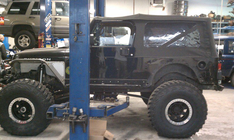

    Almost ready to come home. ๐Ÿ˜ then time to start :hack:
    #6328 Dec 2010, 7:21 AM
    That's going to look freakin' SWEET. But ya, you are going to have to do a lot of trimming to get those monsters to stuff.

    What brand of front tube fenders are those? what size springs are you going with? 3, 4, 5 inch ? Looks very good!!! Trevor and his crew do very good work and they are always very helpful to answer questions even if you want to do the work yourself. Did you have the 14 bolt shaved?

    The front fenders are the Metal Cloke High lines. From some preliminary fitting it looks like the tires will not rub in the front. Right now Iโ€™m running a 6" spring, however I will try and lower it when I get it back to keep the CG as low as possible while allowing some up travel... Shooting for 5" of up travel but we'll see.
    i did have the 14 bolt shaved but did not cut into the shell, just the bottom 1.5" of metal came off.

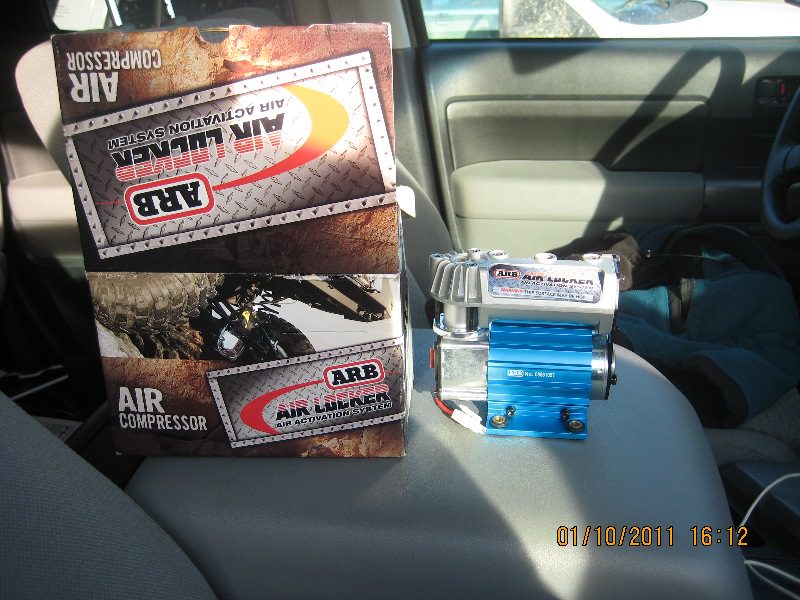

    Just got the new mini ARB pumpโ€ฆ. so I should have the lockers working this weekend.
    Some fender trimming and master cylinder swap on Sunday hopefully

    Update: got a MIni ARB and proceeded to crack the housing inserting the pressure shut off valve 3 threads into the housing. Trevor at WFO laughed at me but he did warranty it. Got everything else wired in and switches mounted. Going to put the compressor in tonight and see if the lockers work.
    Will take some more pictures but probably wonโ€™t have them up before Thursday.
