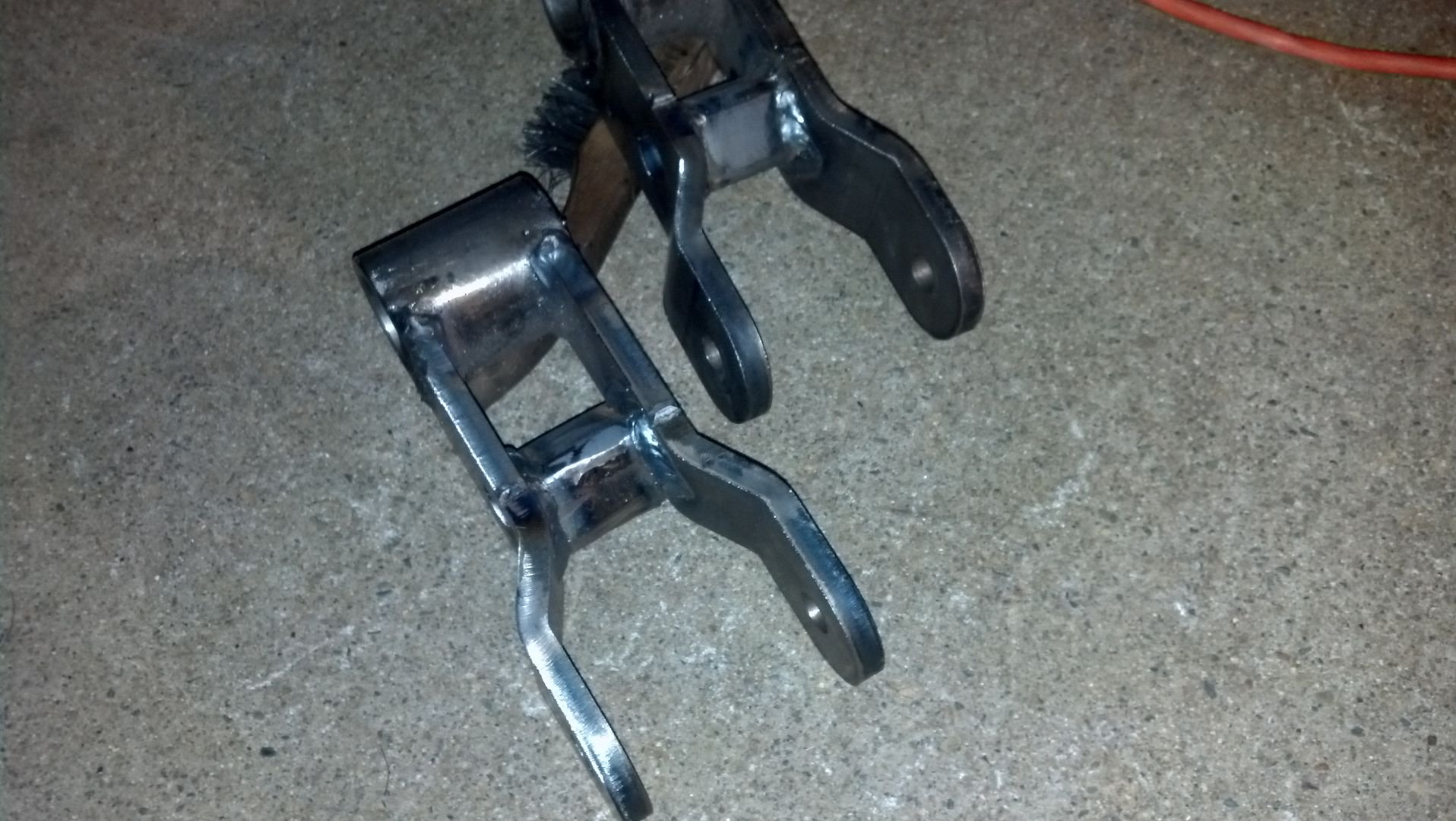

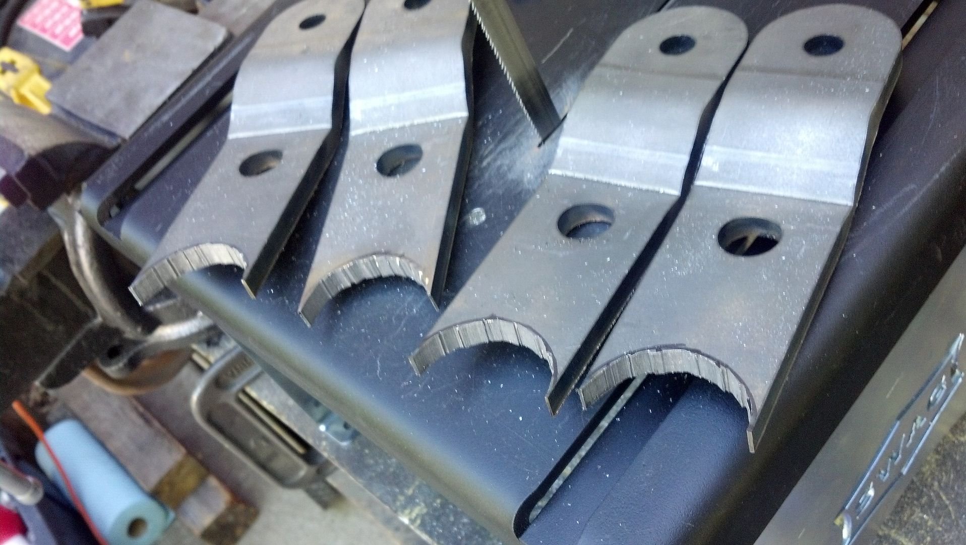

Leaf Spring Shackle
    #16 Jun 2013, 5:06 AM

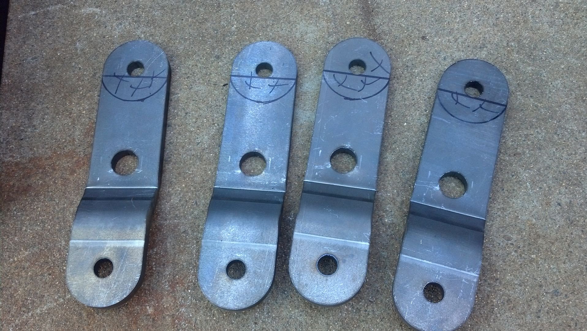

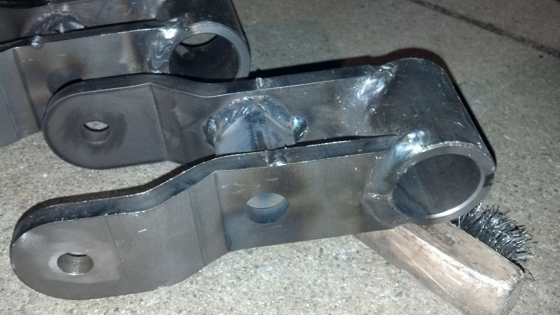

    3/8"x6" with 5/8" offset; 1/2" hole drilled out to 9/16"
    Ends beveled on DOM side
