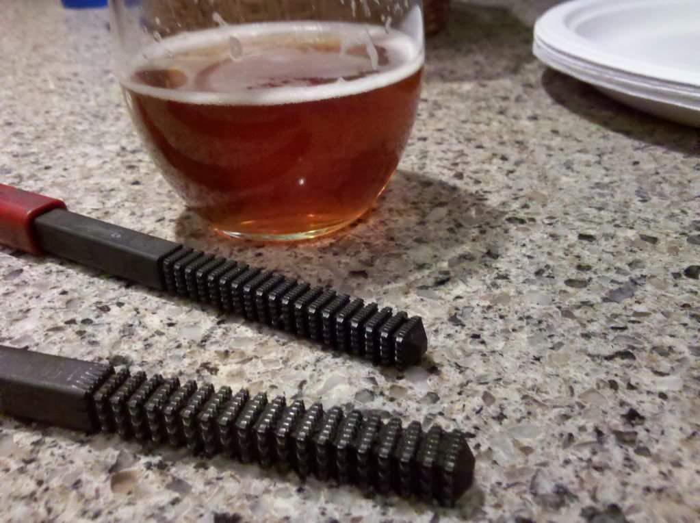

    All great suggestions. Fortunately, it was only 2 threads and I used a thread file to end the annoyance in 5 minutes.
    The tap and die were my close reserve for the remedy as well. Only like 5 blocks away from Sir RockinCrawler!! Thanks so much and glad I didn't have to use it anyways.
    #82 Oct 2011, 10:09 PM
    Glad everything worked out.
    Now the important question: Was that Sierra Nevada on the counter?
    #93 Oct 2011, 8:13 AM
    No sir. Grand Teton Sweetwater IPA. My BILs.
    We did have a Sierra Nevada Saison earlier though. Perfectly refreshing after track bar installation.
