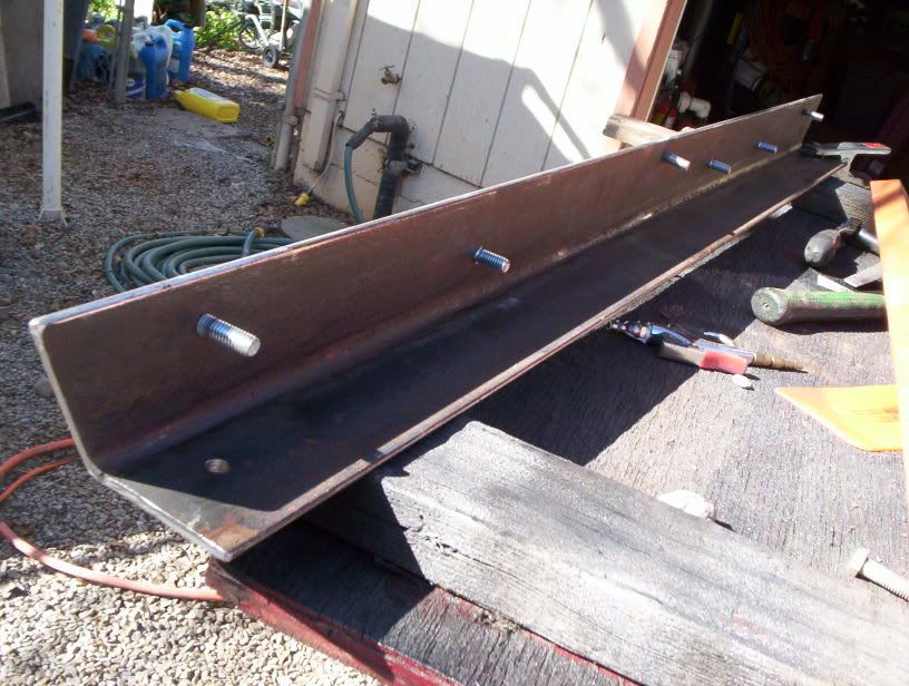

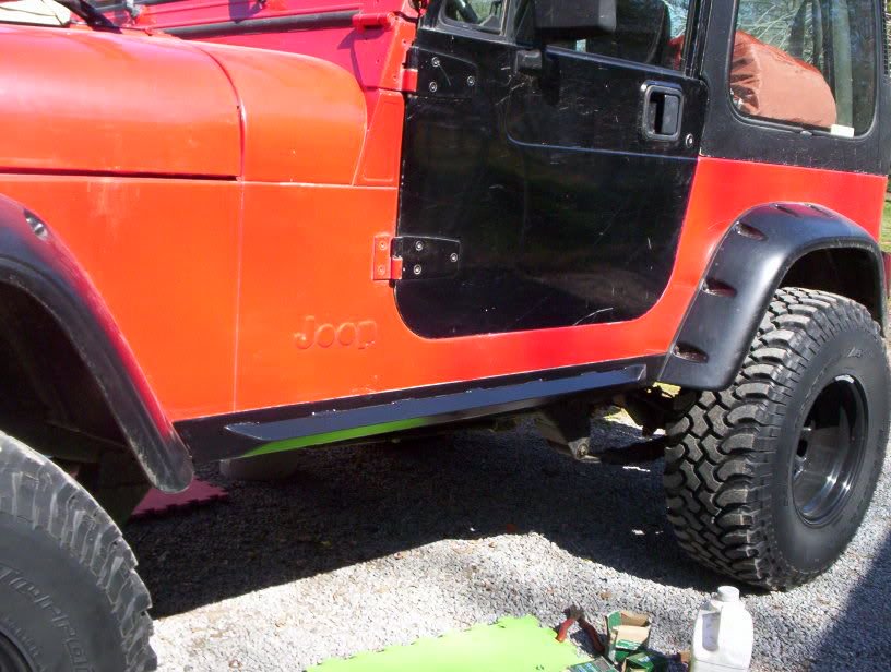

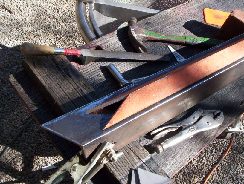

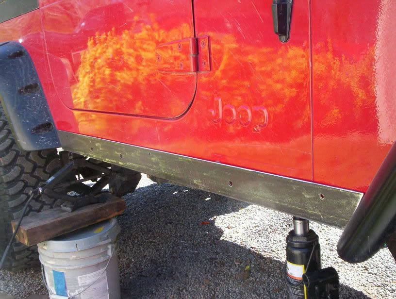

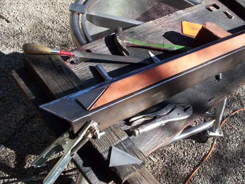

    i finaly got around to making some sliders, i had some rusty old angle iron laying around and made ues of it. i diidnt want metal to metal contact ,so i used ome rv strip sealer on one side. it was kind of a pain to get the part that ozzed out off. one the other side i used 2" wide black pipe wrap. it was way better. when building the sliders i didnt want the bolts to show so i was able to hide 3 behind the bump out angle . the other 3 i just tapped and then welded a stud in. there are only 2 bolts on the bottom under the jeep.

    thanks, i didnt attach them to the frame, is that going to be a problem.?

    "bobf777" wrote: thanks, i didnt attach them to the frame, is that going to be a problem.?
    Typically, body mounted rocker guards aren't attached to the frame because of flex between the body and frame.
    #619 Mar 2009, 11:48 AM
    Looks great!
    My rockers are only attached to the frame. I have problems with body flex and they have bent the body in the area. I don't think I'd attach them to the frame AND the body. Sounds like trouble to me.
    #719 Mar 2009, 1:45 PM
    I like the way you created the "nerf bar" portion. Creative and practical. Nice job!
    #820 Mar 2009, 10:58 AM
    Looks great. My psc sliders are sandwiched between the body mounds but aren't attached to the frame. Yours should work great. I like the angel iron on the out side.
