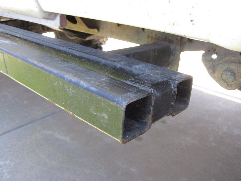

    I built mine from 2" square steel from Blue Collar Supply, it came in a 20ft length. I'll post a picture if your interested.

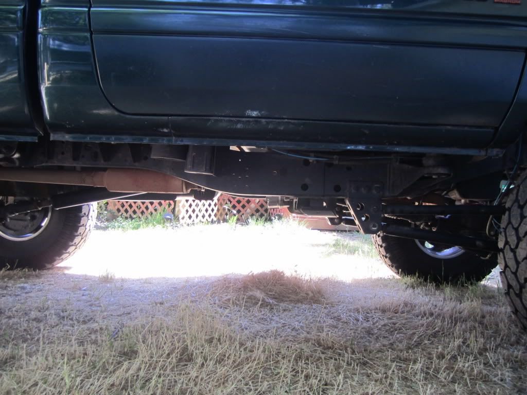

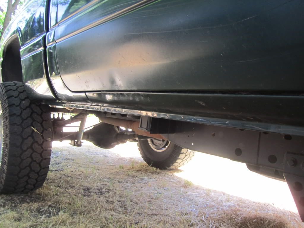

    Here is a picture of my Toyota rock sliders. You can see the plate welded to the frame in the background. I only attached it in two places, but its still strong enough to hi-jack it in the middle and change two tires at once. Your rig might need at least 3 attachment points to the frame.

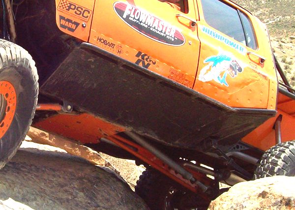

    Or you could try this-

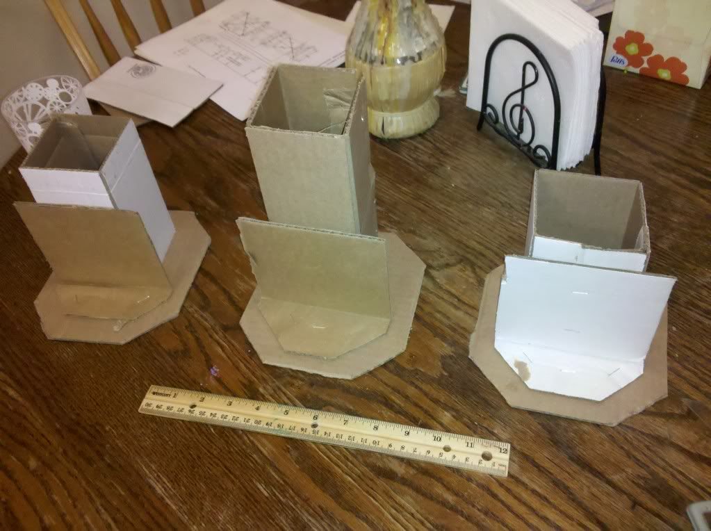

    Some of you may remember that I picked up some 3x3x.188 square tube for by bday last December.
    Picked up some material to start getting these things on finally. Here's my current mockup pictures. Going for similar frame plating like Jeff. Adding a 3rd mount and angle for support. These will not be removable. lol
    I welcome any input as today I'm mocking up and cutting. I'll be slow enough that I can check out any suggestions. Thanks! Come by if you like too! Home all day with this.

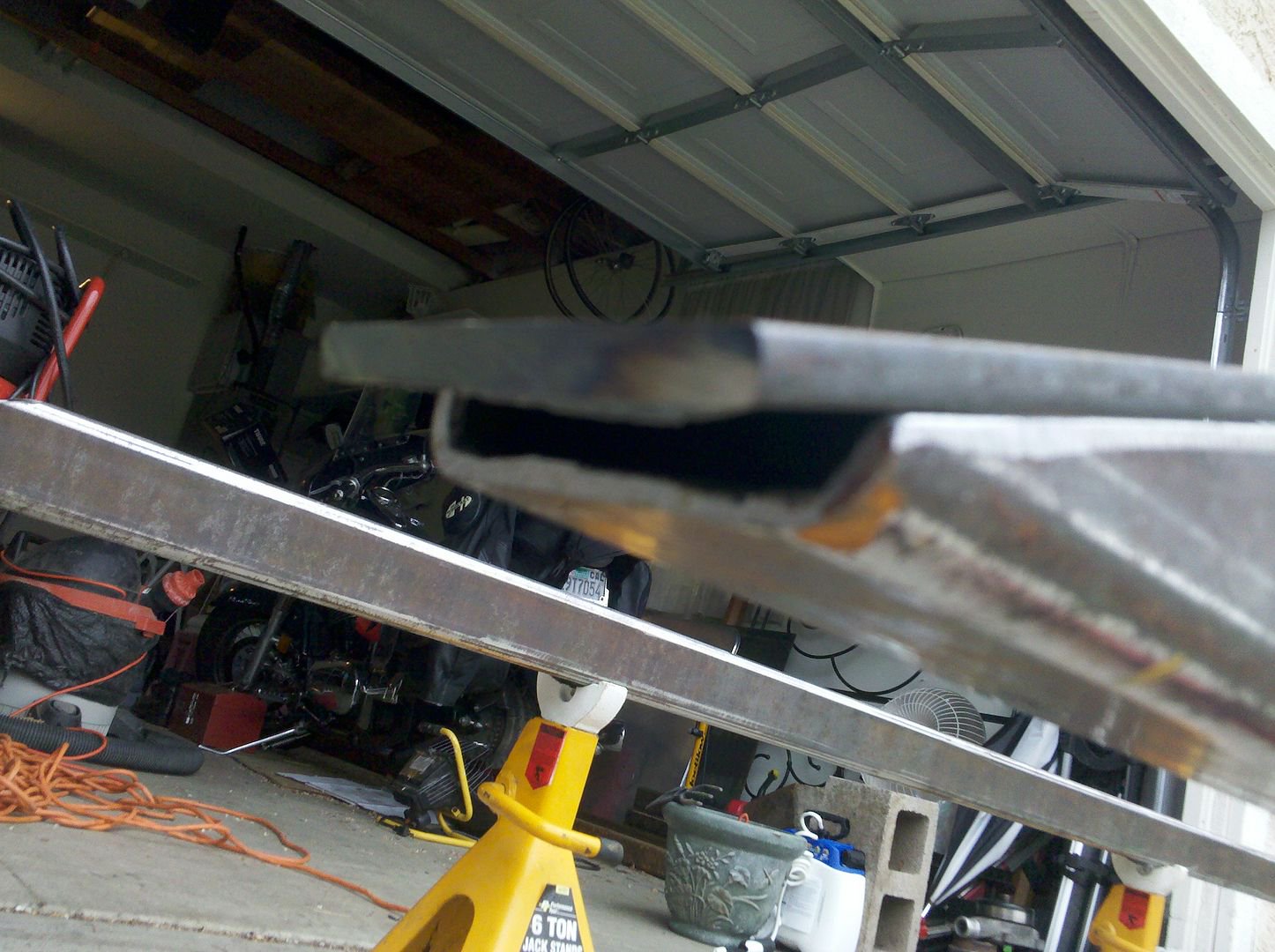

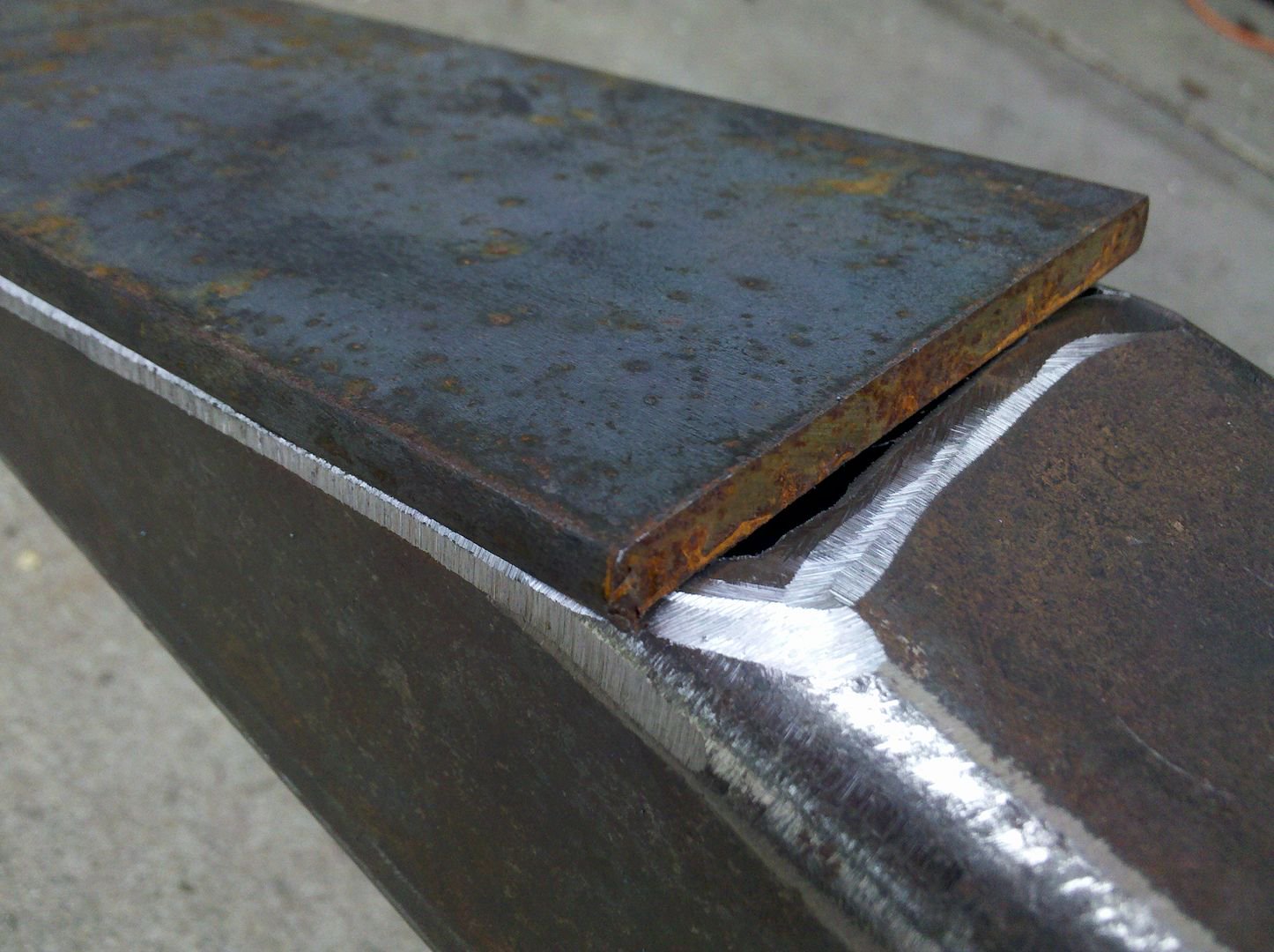

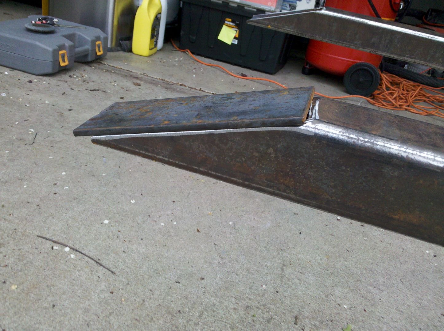

    #1822 Mar 2012, 4:59 PM

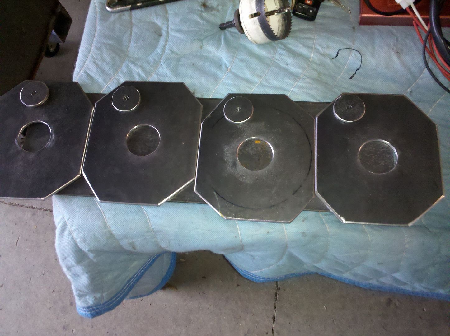

    I've got my frame plating cut and mostly prepped.

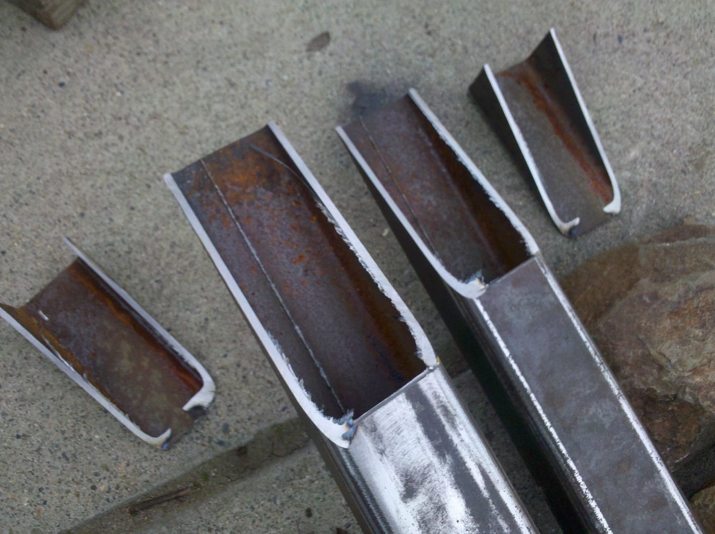

    Beveled the ends of the sliders.

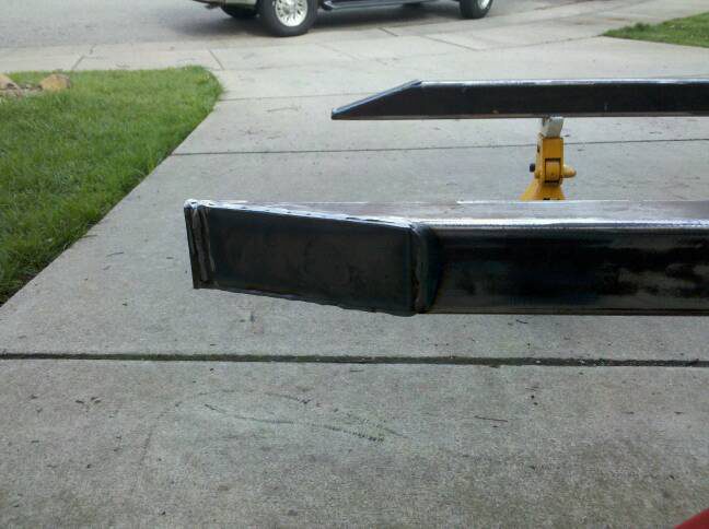

    Test fitting a plate to cap the ends.
    #1922 Mar 2012, 7:17 PM
    Looking good.
    #2022 Mar 2012, 7:24 PM
    Those things are huge! They look like the world's beefiest car ramps! Awesome sliders!

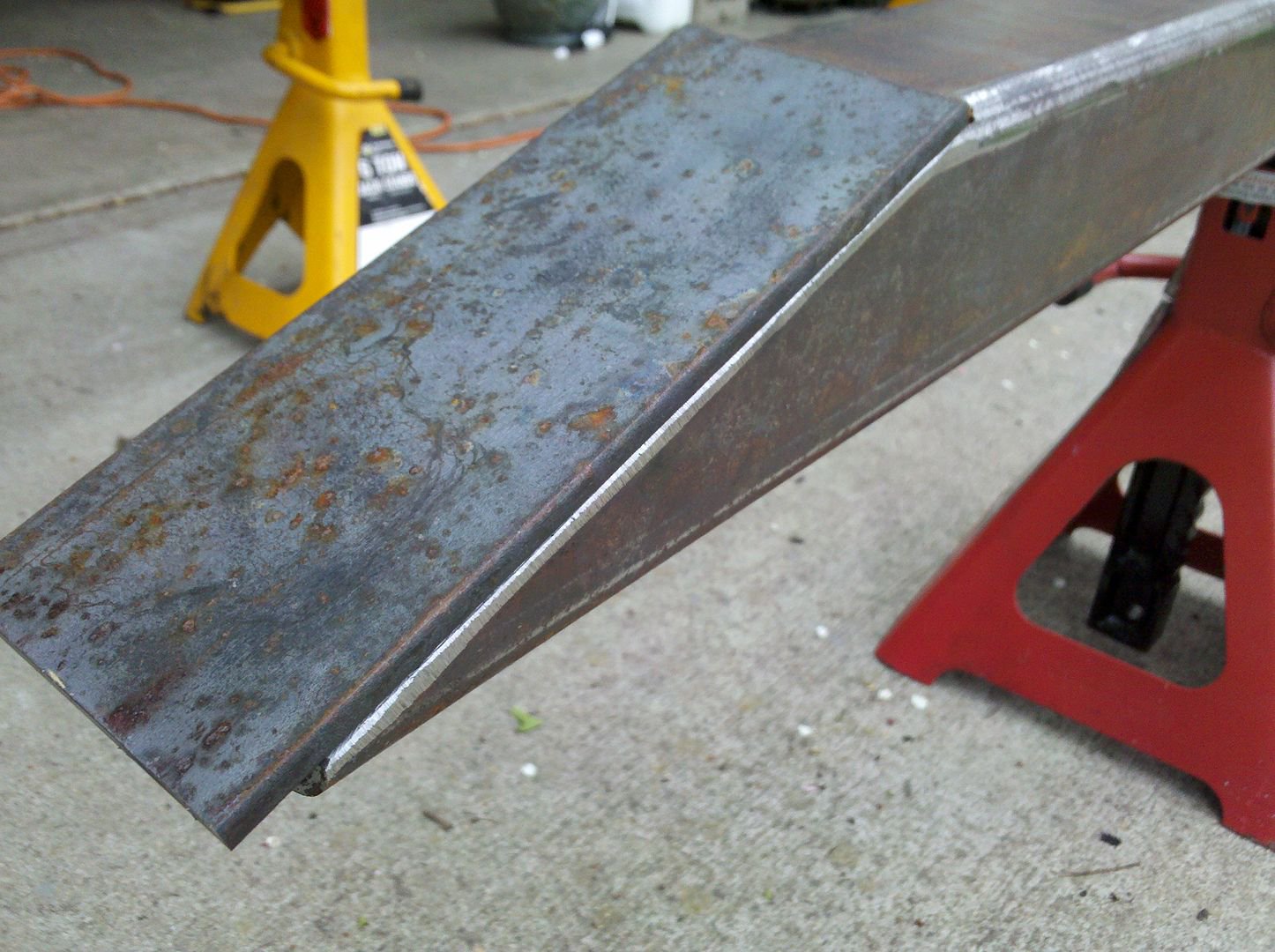

    Capped the sliders with my uber weld goop skills. πŸ˜€
    Clean them up later with the flap disk o magic.
