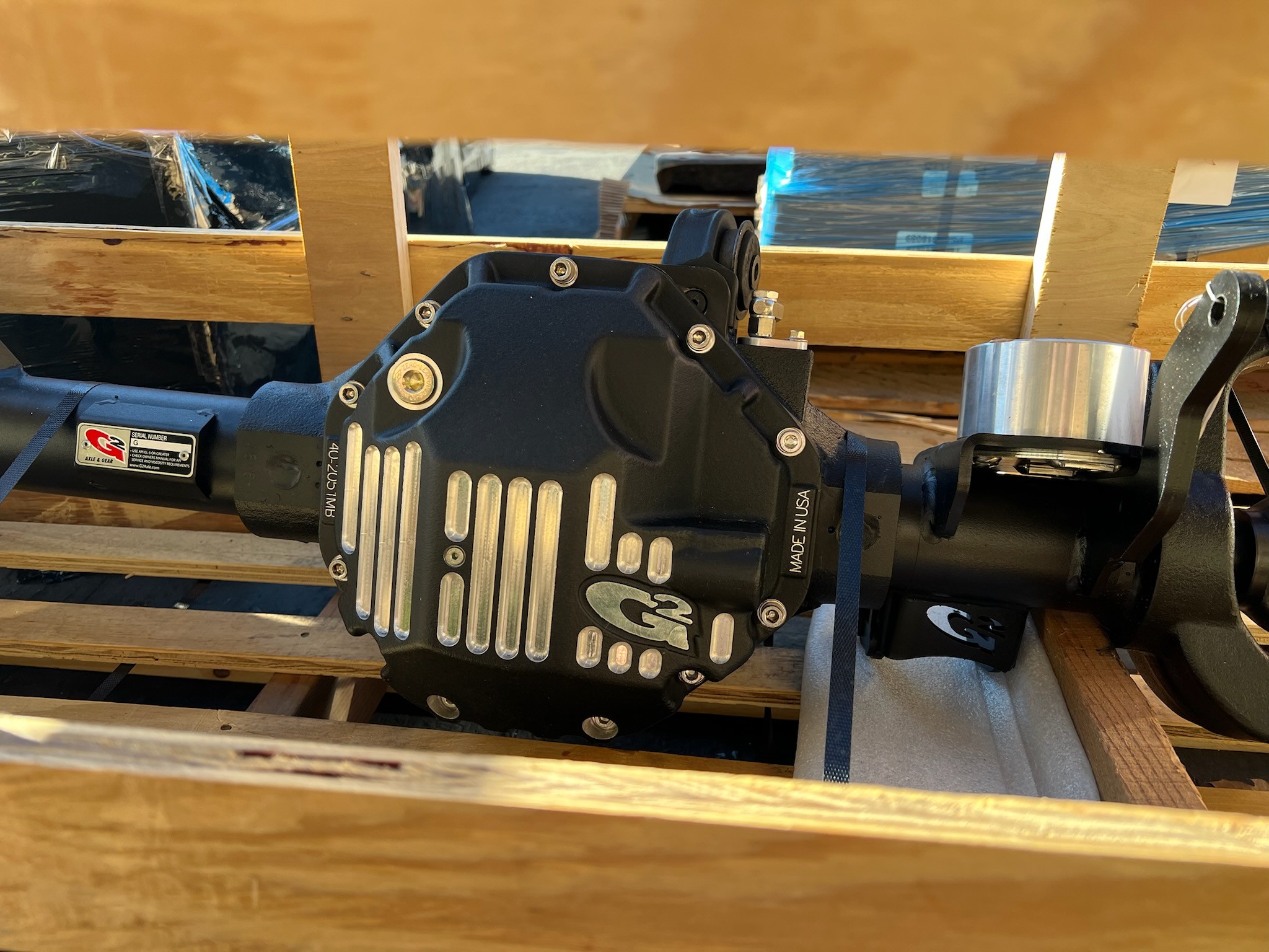

    #1926 Sep 2022, 2:17 AM
    New axle arrived and the install should start later today according to WFO.
    #2026 Sep 2022, 3:54 AM
    Looks Sweet!
    #2126 Sep 2022, 5:44 AM
    Jeff_R said New axle arrived and the install should start later today according to WFO. IMG_1420.jpg
    👍looking good you'll like the up grade
