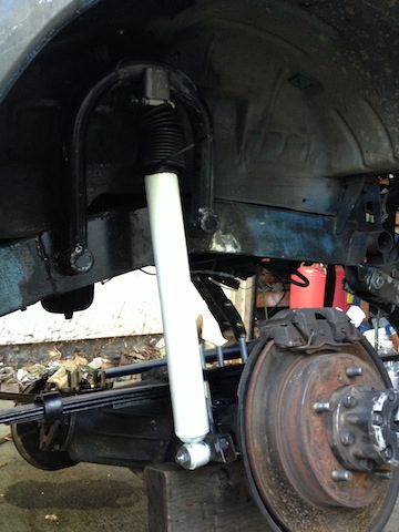

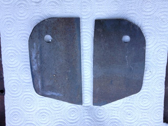

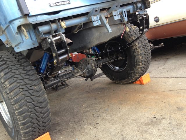

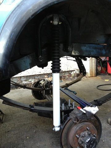

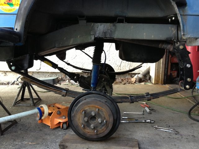

    After bending my springs at PC I decided to go ahead and do the YJ spring conversion. A made the mounting brackets, and modified my current shackles to fit YJ shackles so I have a drop shackle system.

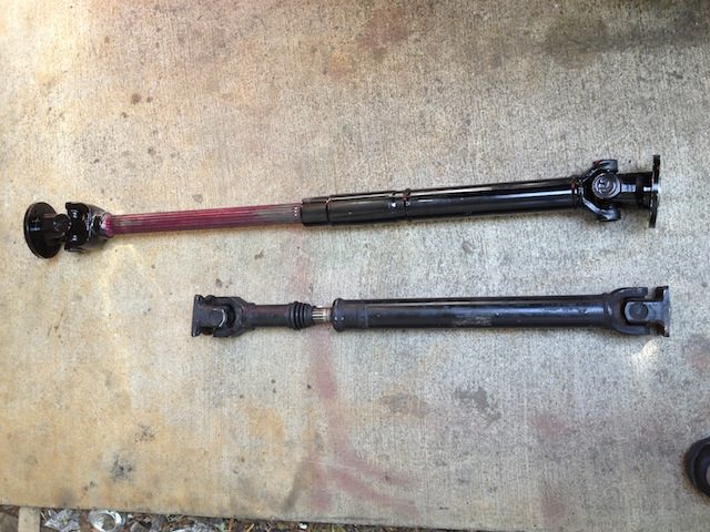

    For the Fronts I relocated shock mounts so I'll have about 13"s of wheel travel. Had Sacramento Driveline make me a front driveline with 14" of spline travel. Modifying the transmission cross member to let the front axle fully drop with out the driveline hitting it.
