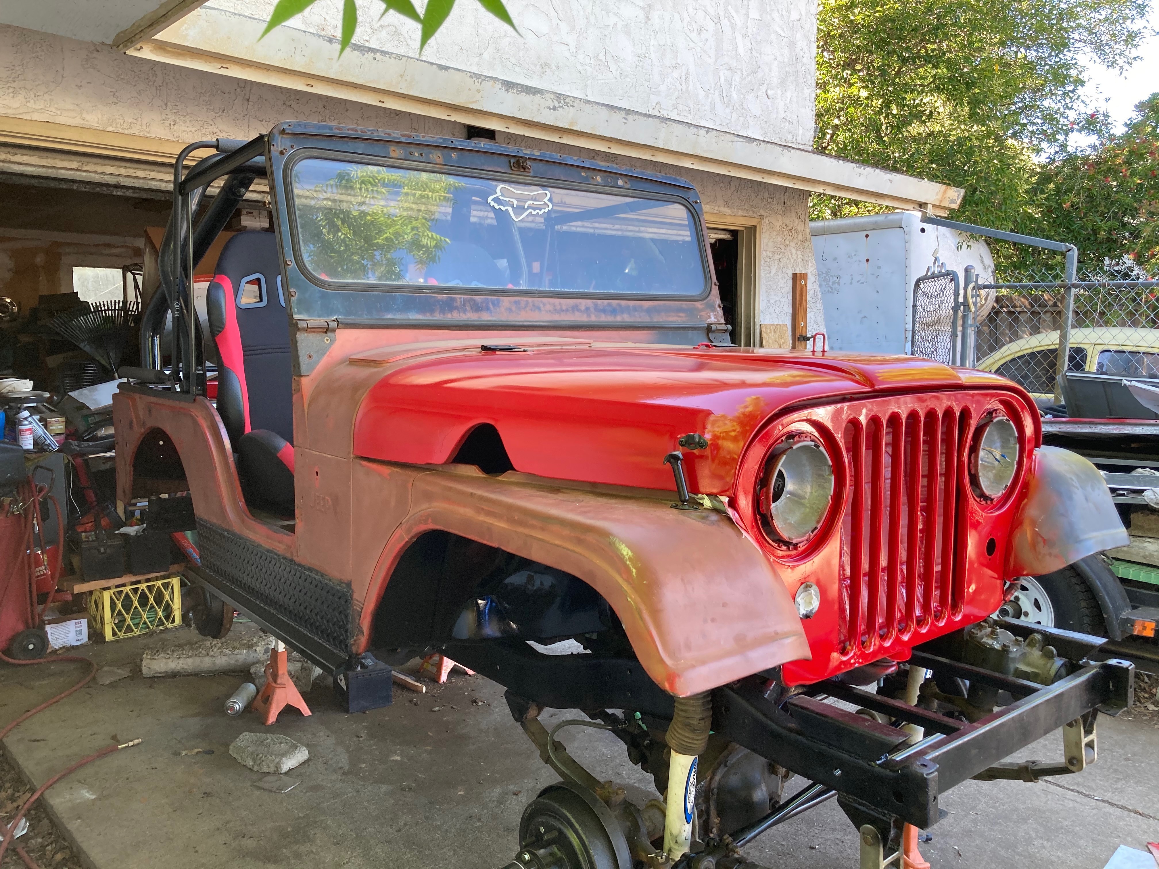

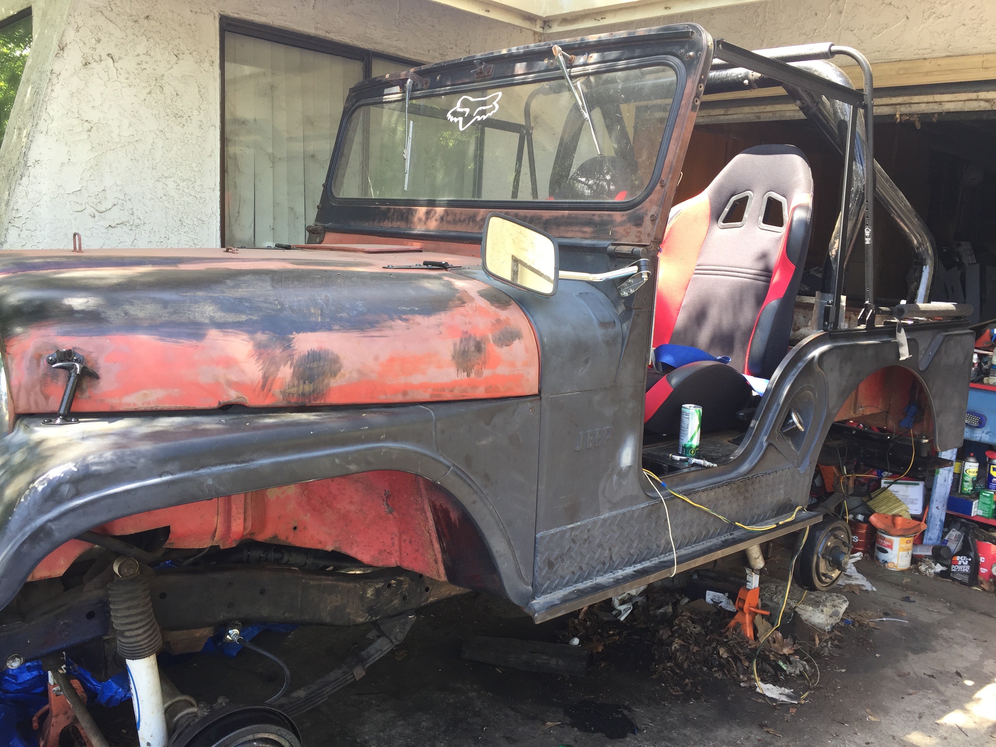

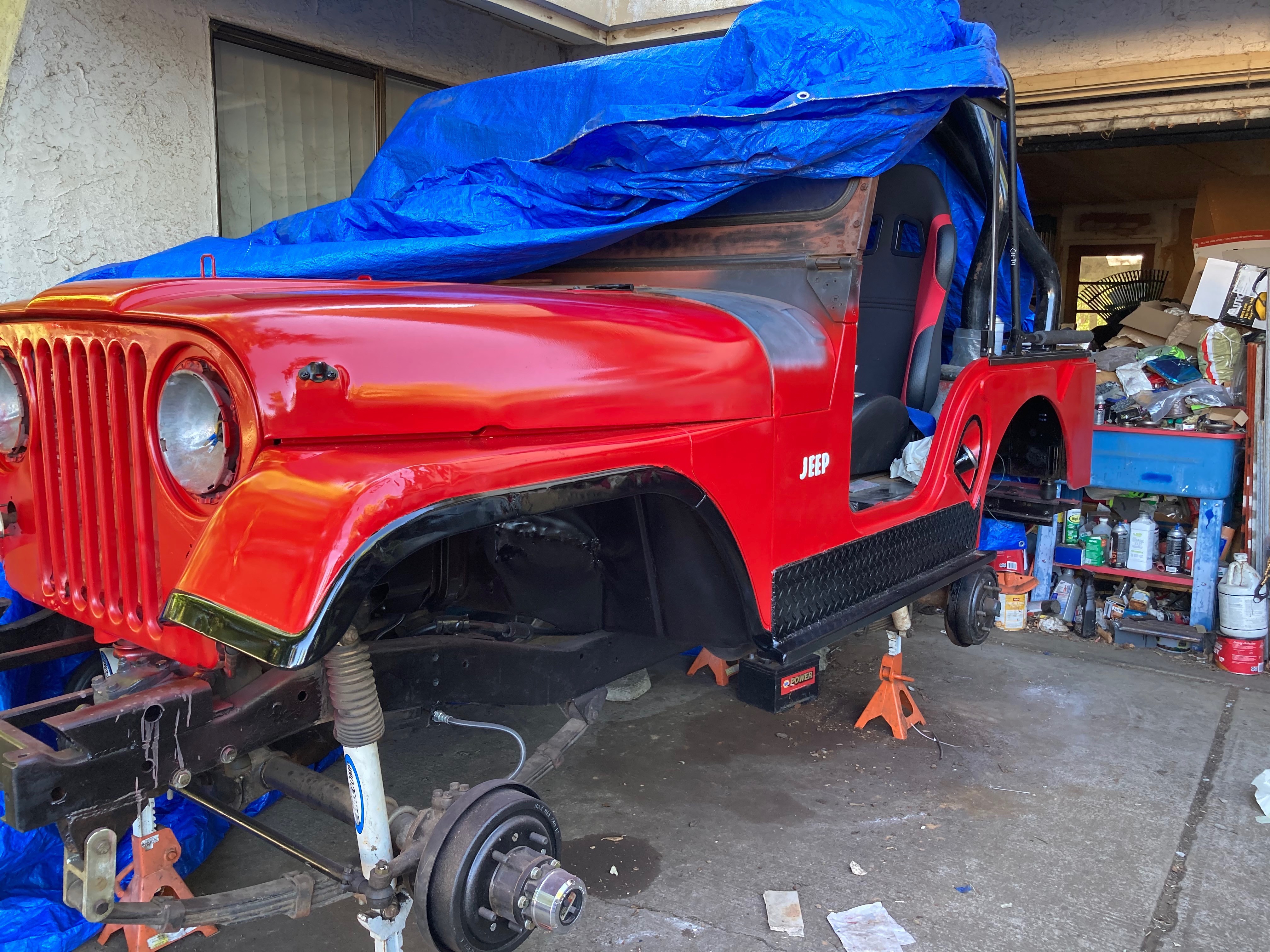

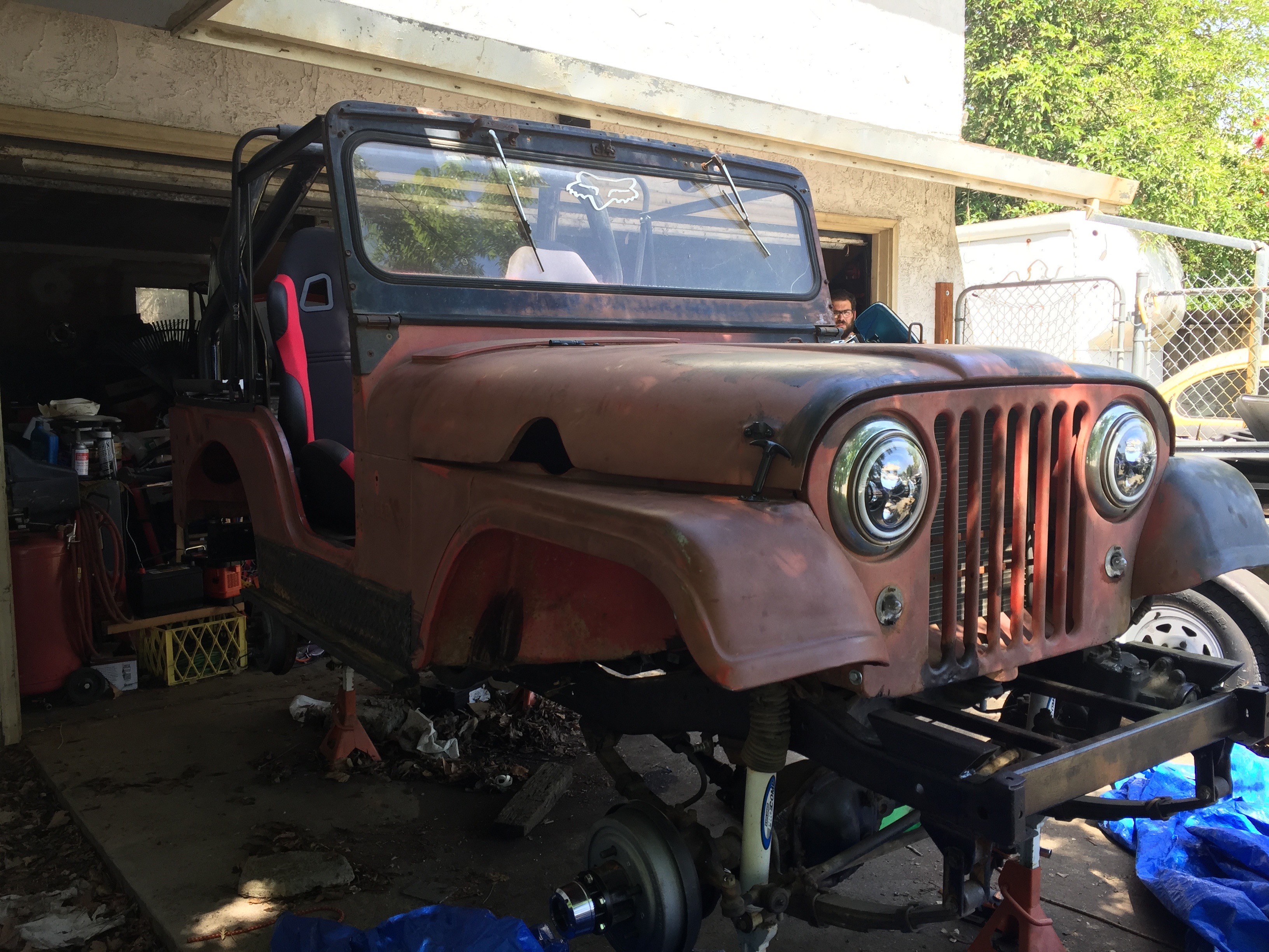

    So being a partner in the Restore of the '64 Willy's I was asked By Timothy to start a thread with pics.
    These are starting from the Quarantine thread.

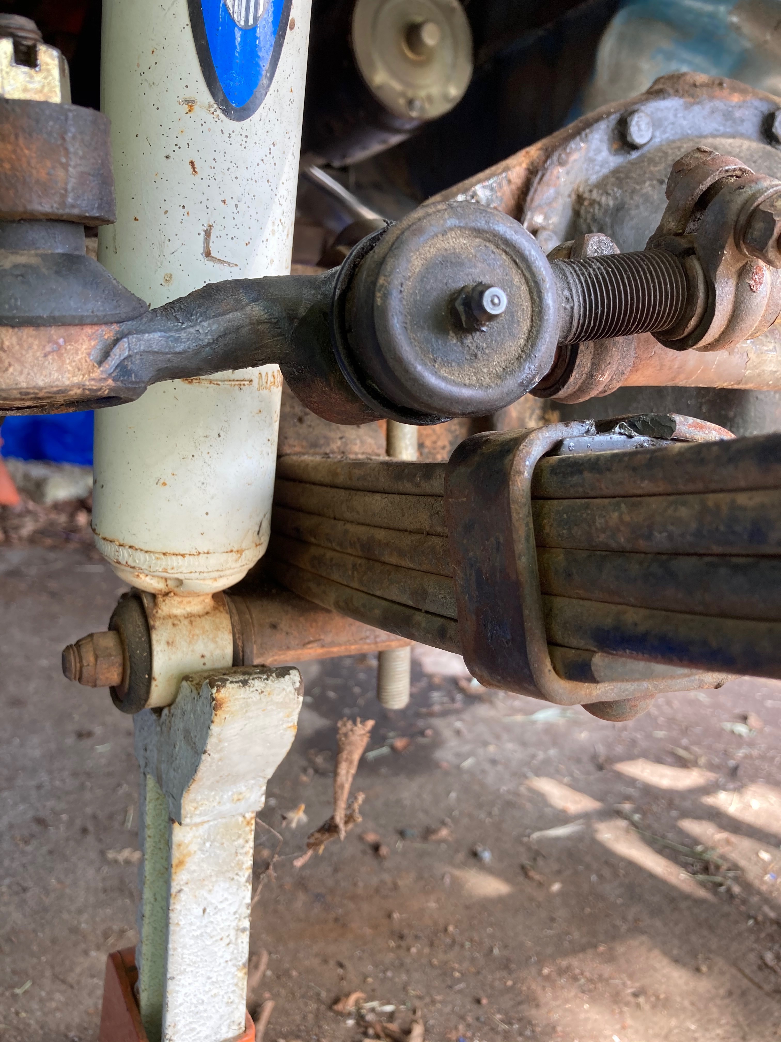

    Fixed the tie rod rubbing on the passenger spring.
    Got the Transmission shifting system hooked up correctly.

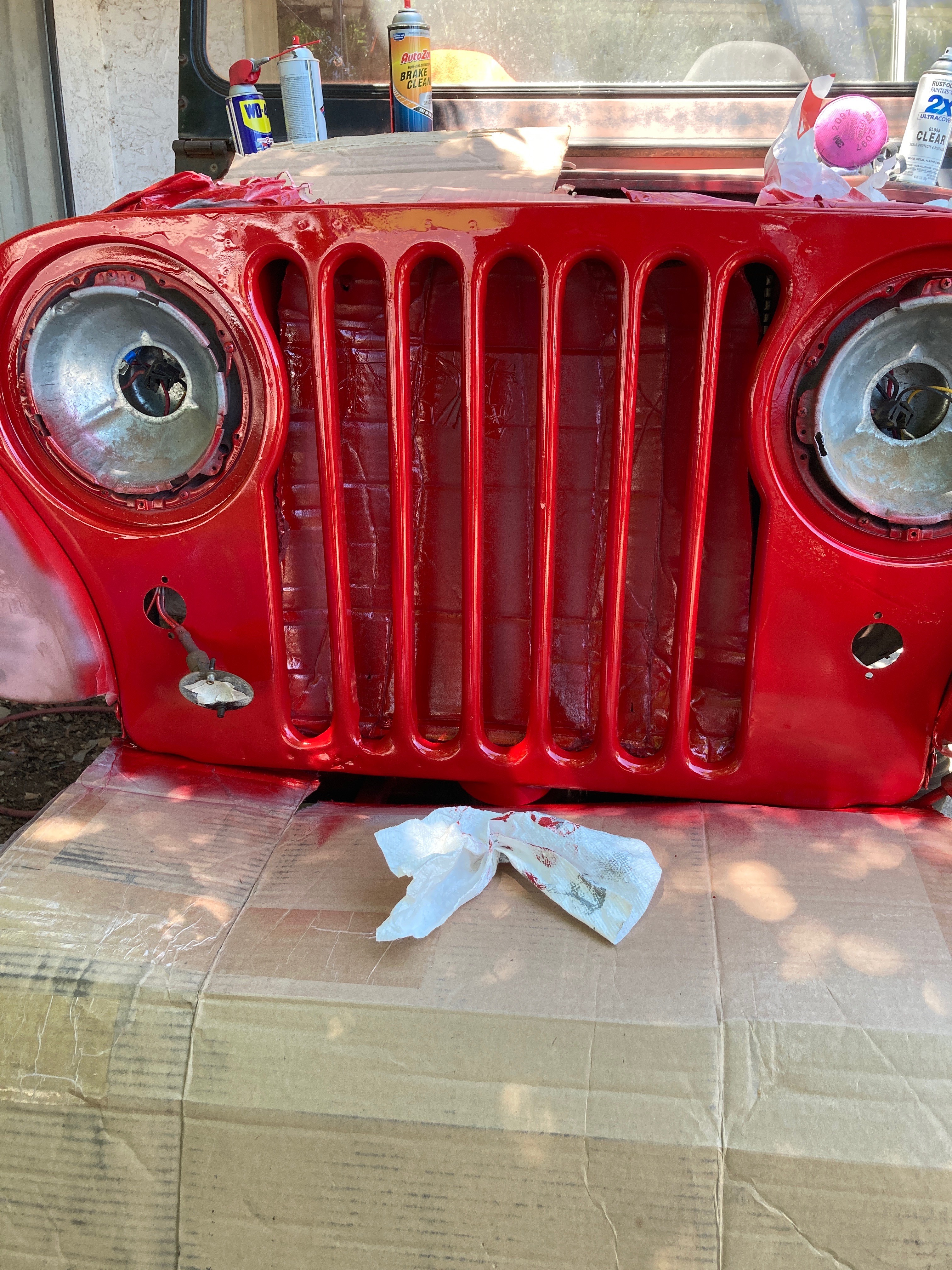

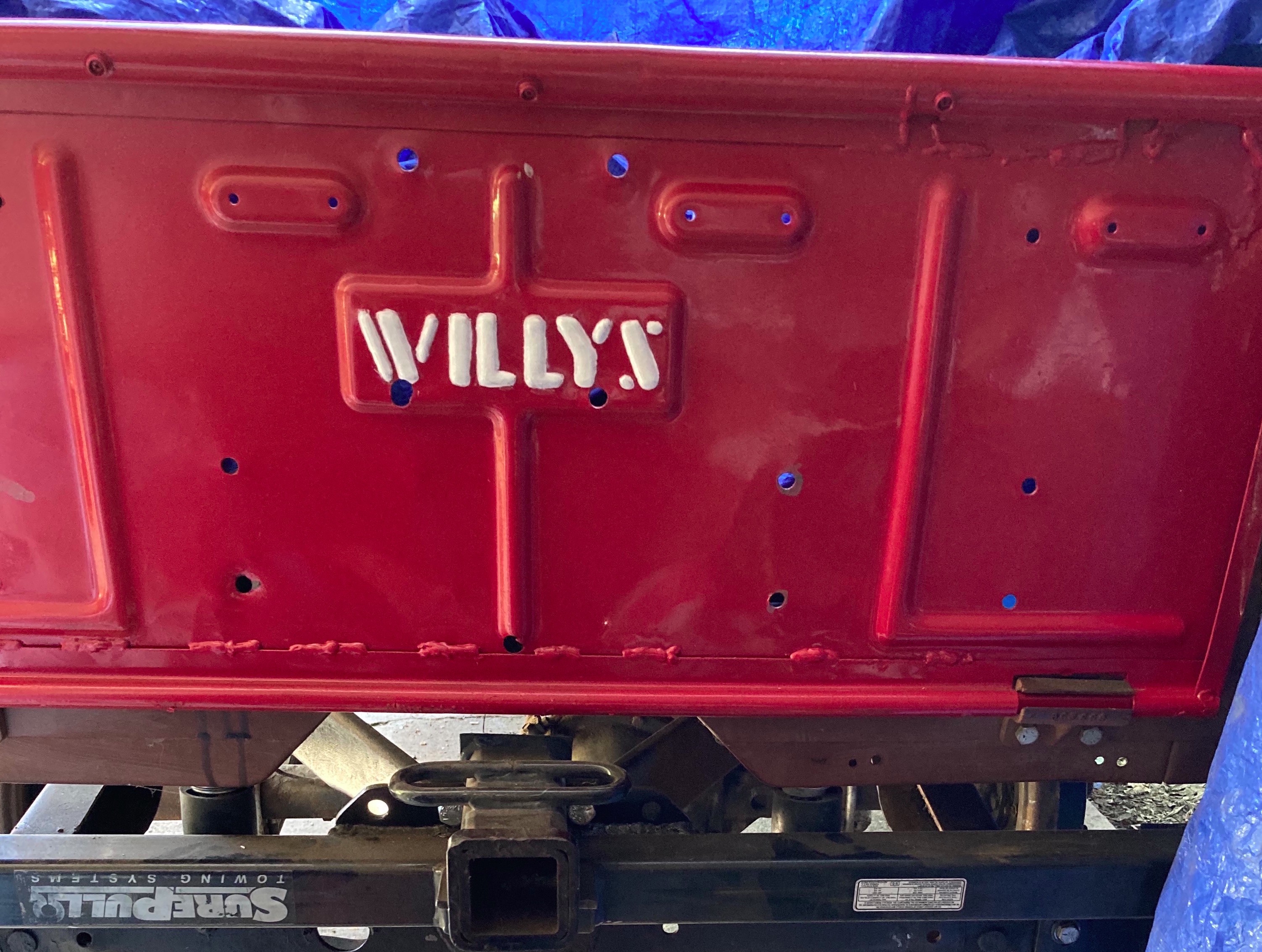

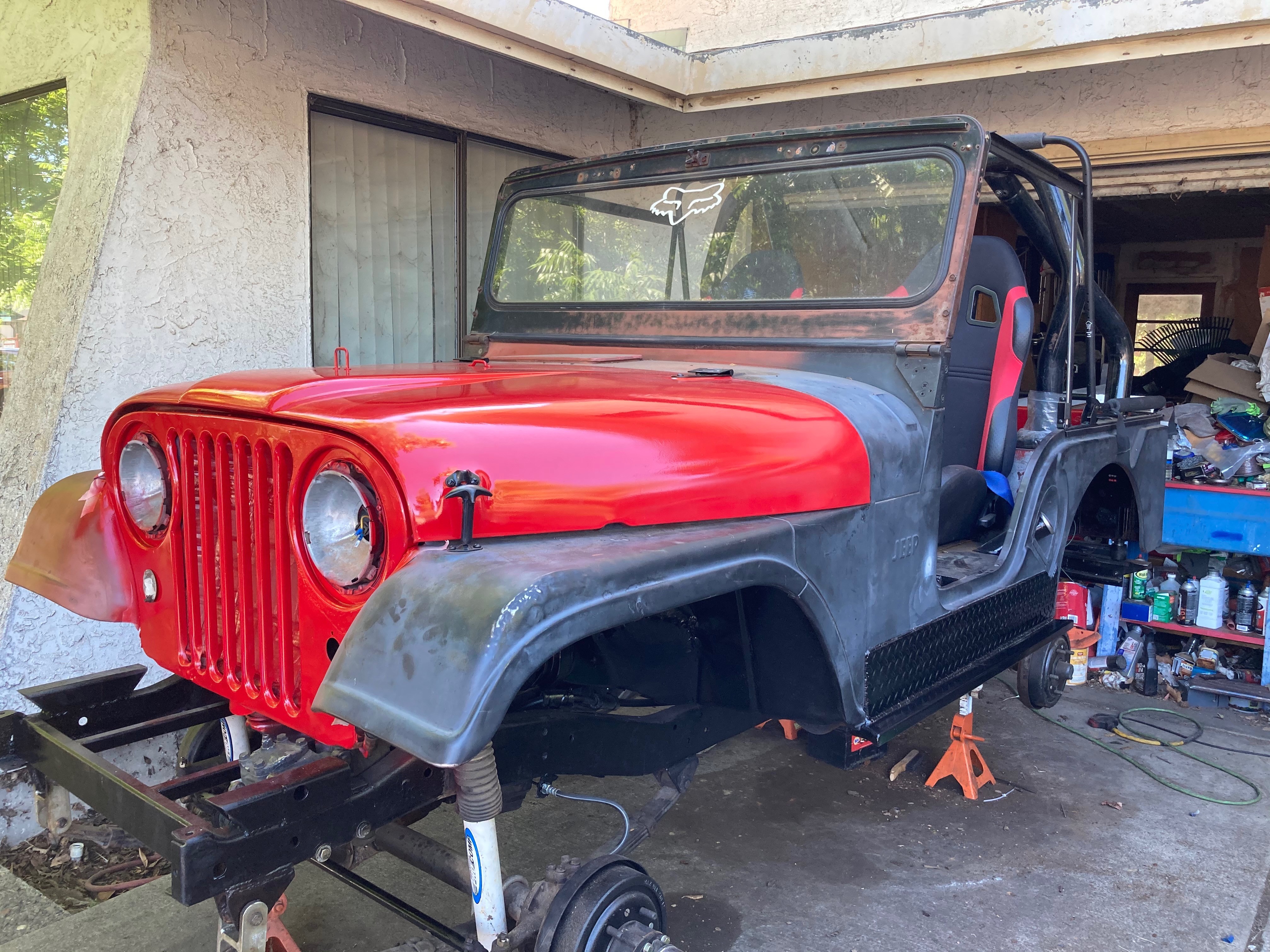

    We are doing a Rattle Can paint job "FOR NOW" to get color on it and on the road.
    Tailgate, Hood, Rock slider, and Grill (one coat more) are done.
    Will be painting one section at a time, Front fenders are next.
    We were able to get a Dana 30. The plan is to build it with a ARB.IMG_0023.jpgIMG_0021.jpgIMG_0022.jpgIMG_0111.jpgIMG_0132.jpgPODG7973.jpgIMG_0141.jpgIMG_0142.jpgIMG_0079.jpg

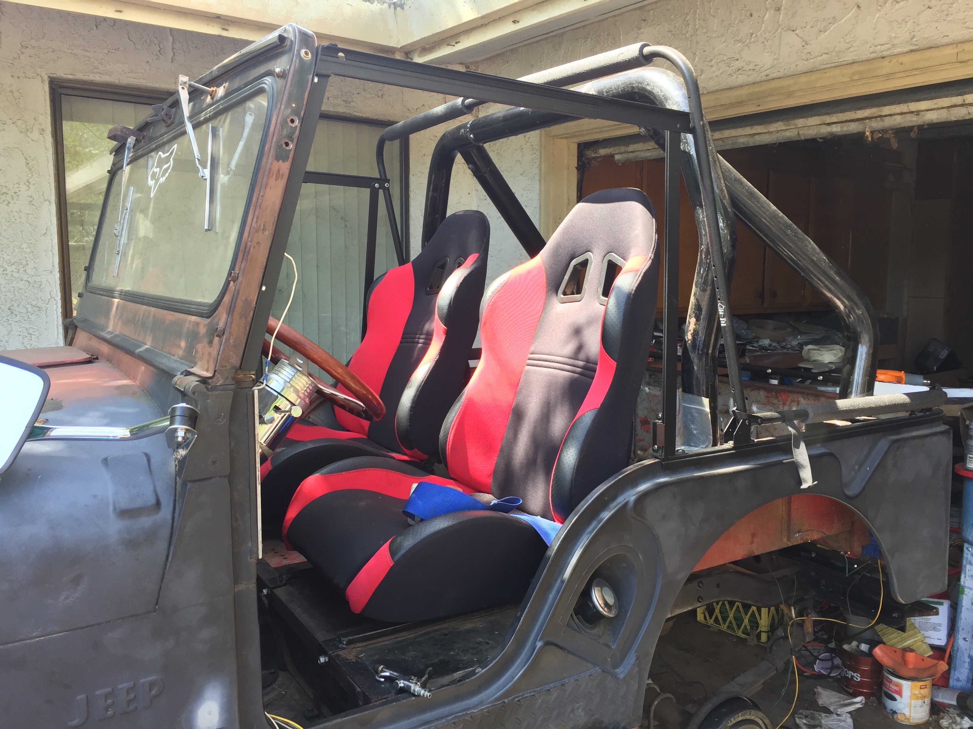

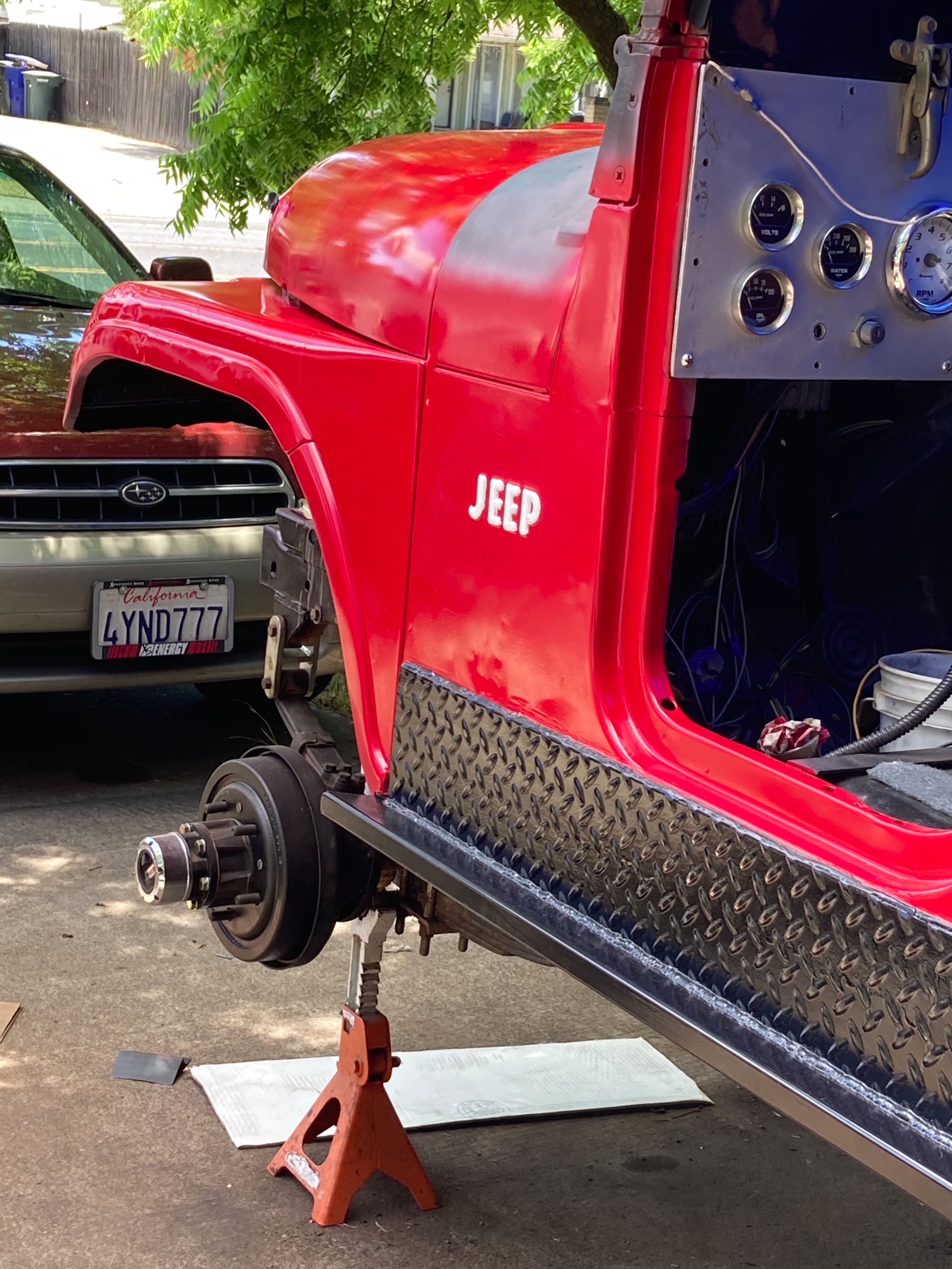

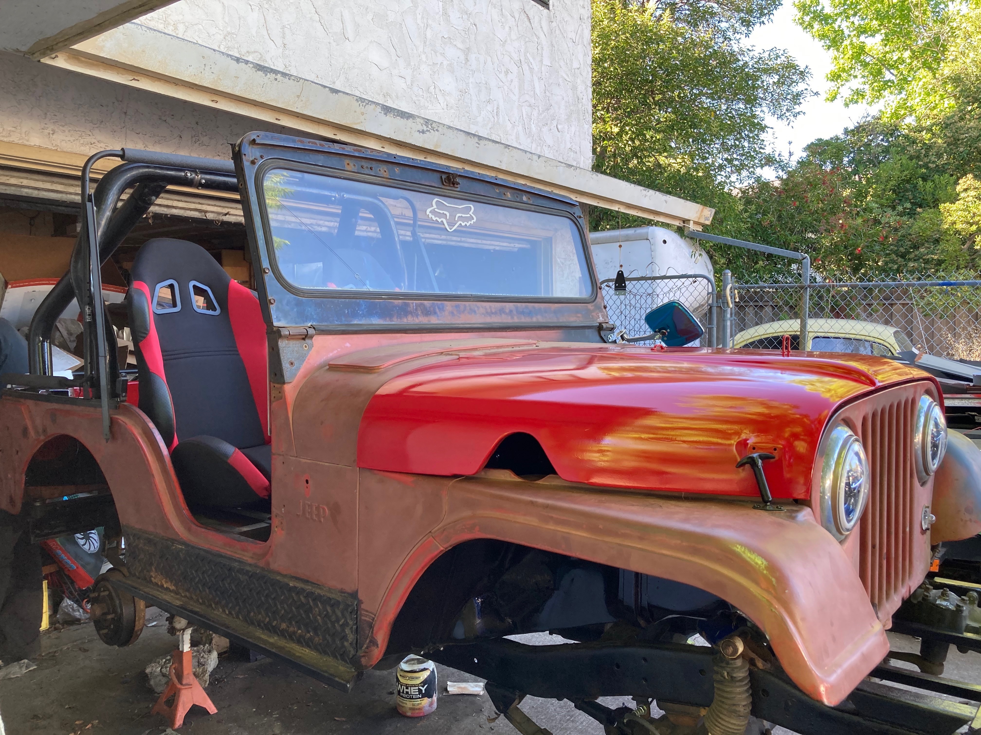

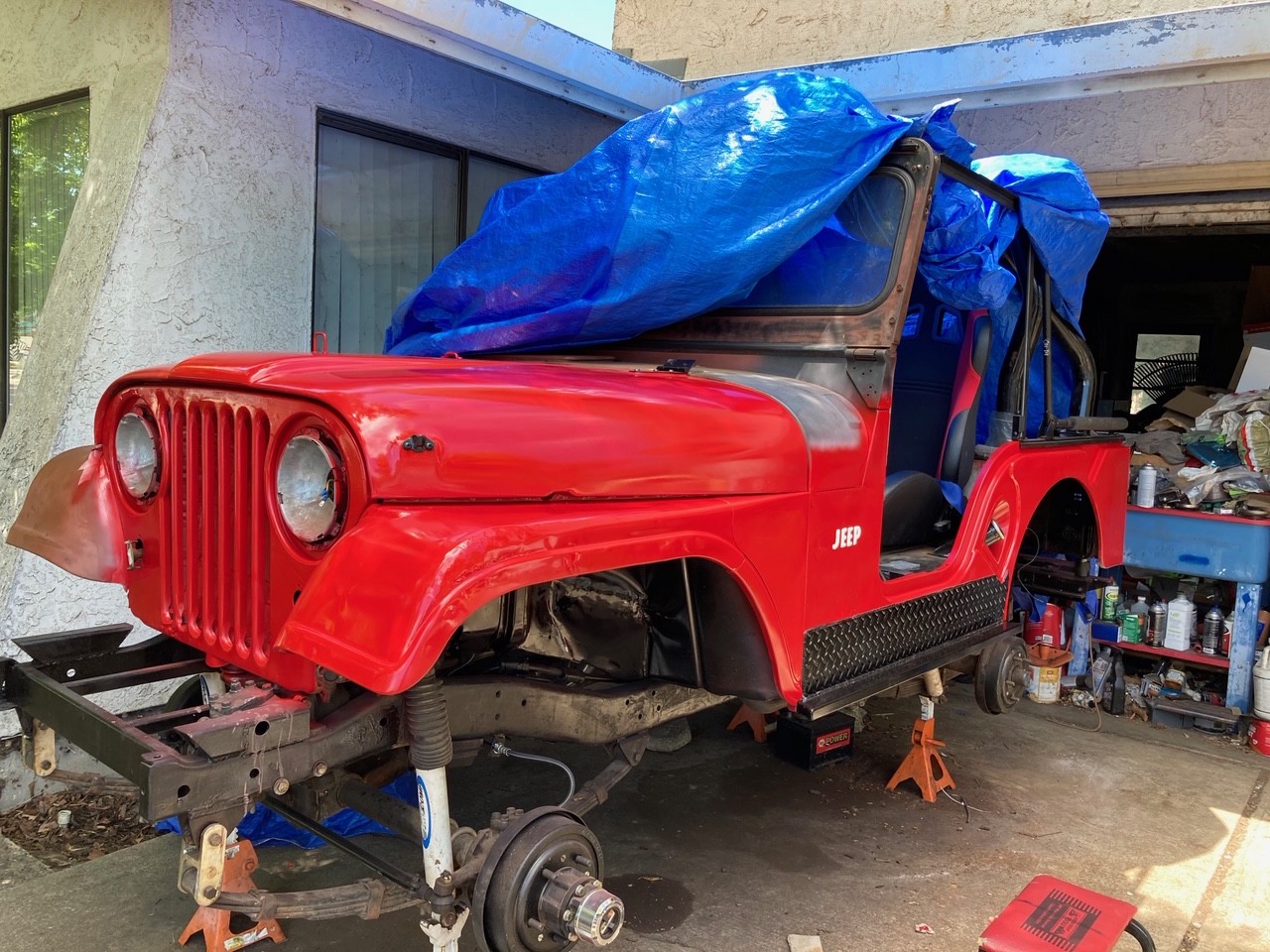

    #427 May 2020, 11:58 AM
    More Painting pics, Next Passenger side. Will Work on getting a new windshield glass. Will paint the frame when we pull it to replace glass.  IMG_0160.jpgIMG_0159.jpgIMG_0158.jpgIMG_01611.jpg

    #528 May 2020, 2:39 AM
    Looking good brother
    #628 May 2020, 3:48 AM
    Wow, you all know how to use a rattle can well! When I did m inner fenders I was so tired of shaking those things!

    #928 May 2020, 11:39 AM

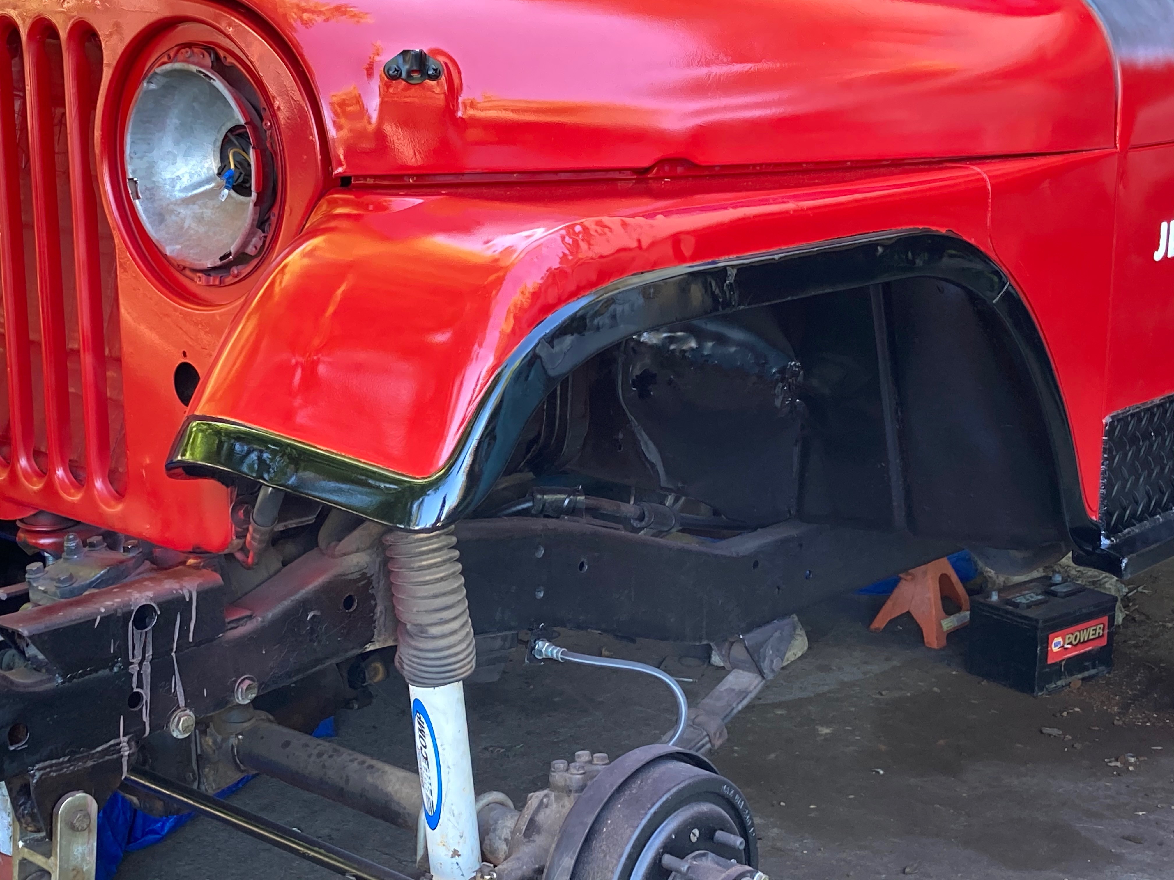

    Accents add to fuel Filler and Front Fender.IMG_0167-1.jpgIMG_0165-1.jpgIMG_0167-2.jpg

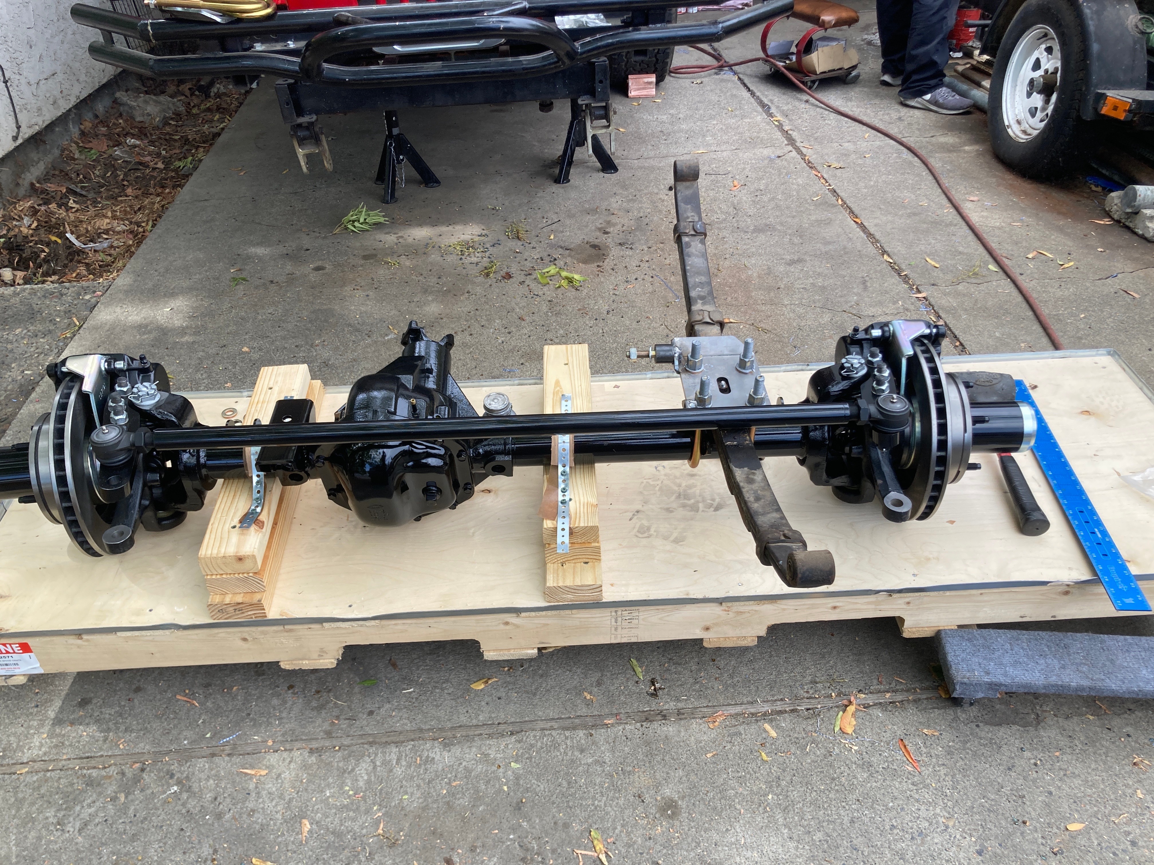

    #1116 Sep 2022, 9:58 AM

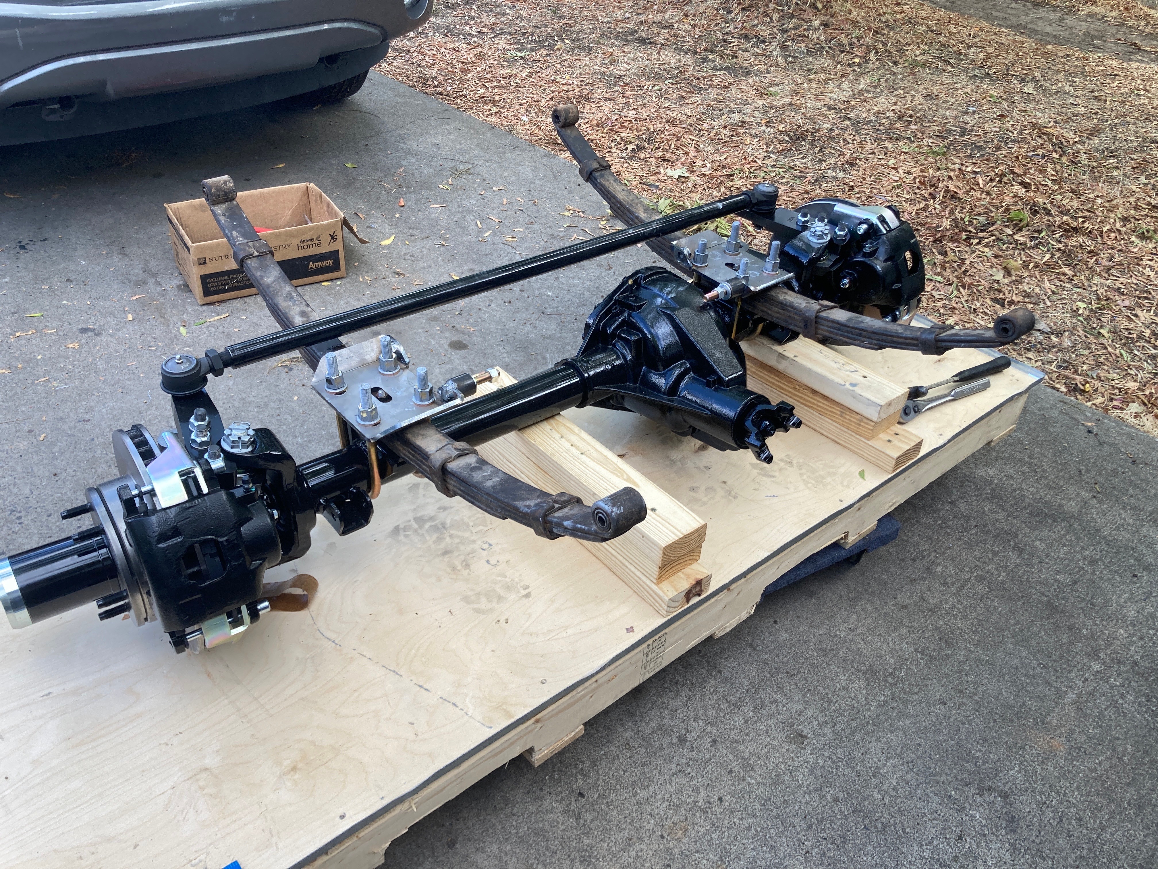

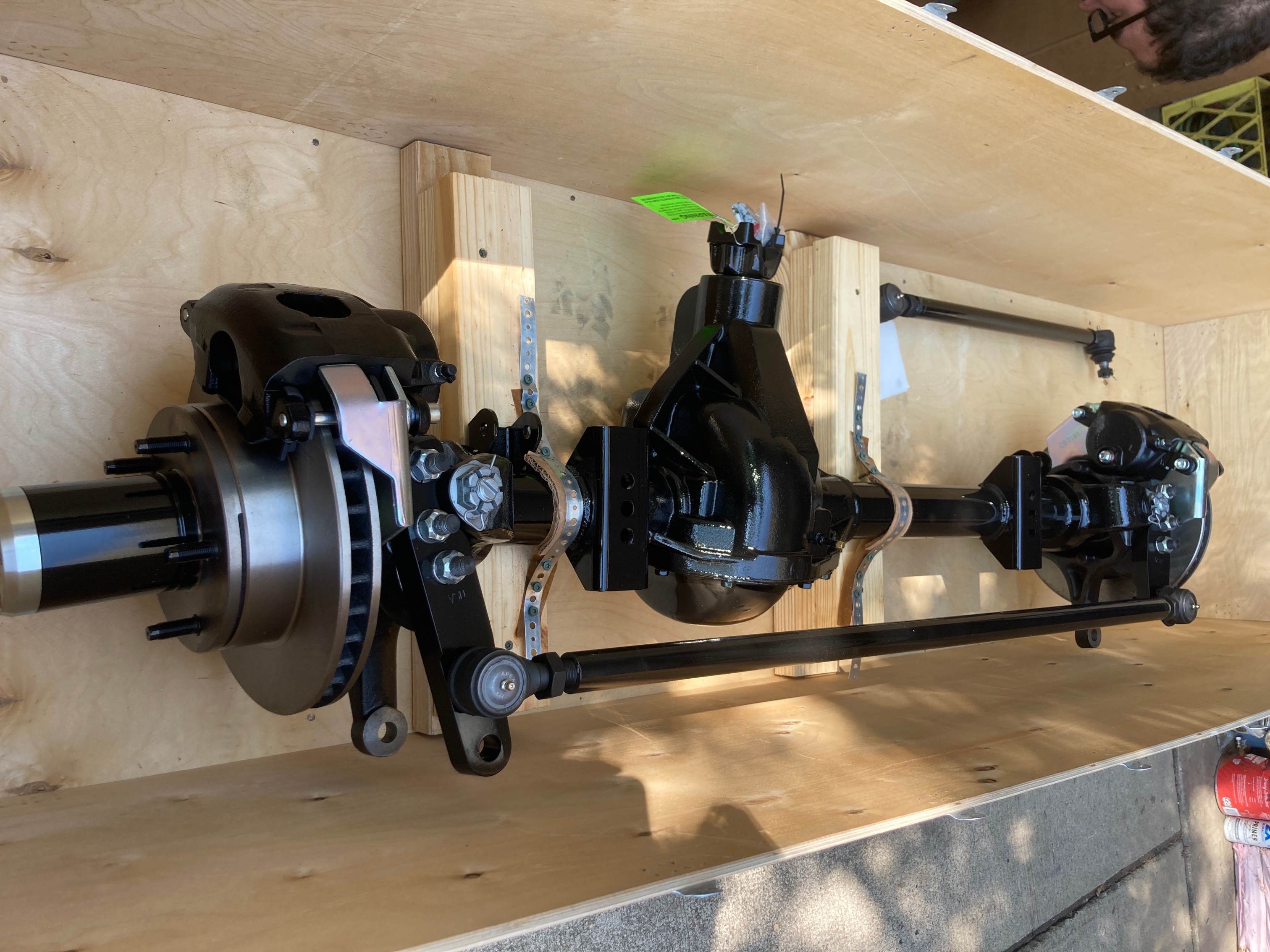

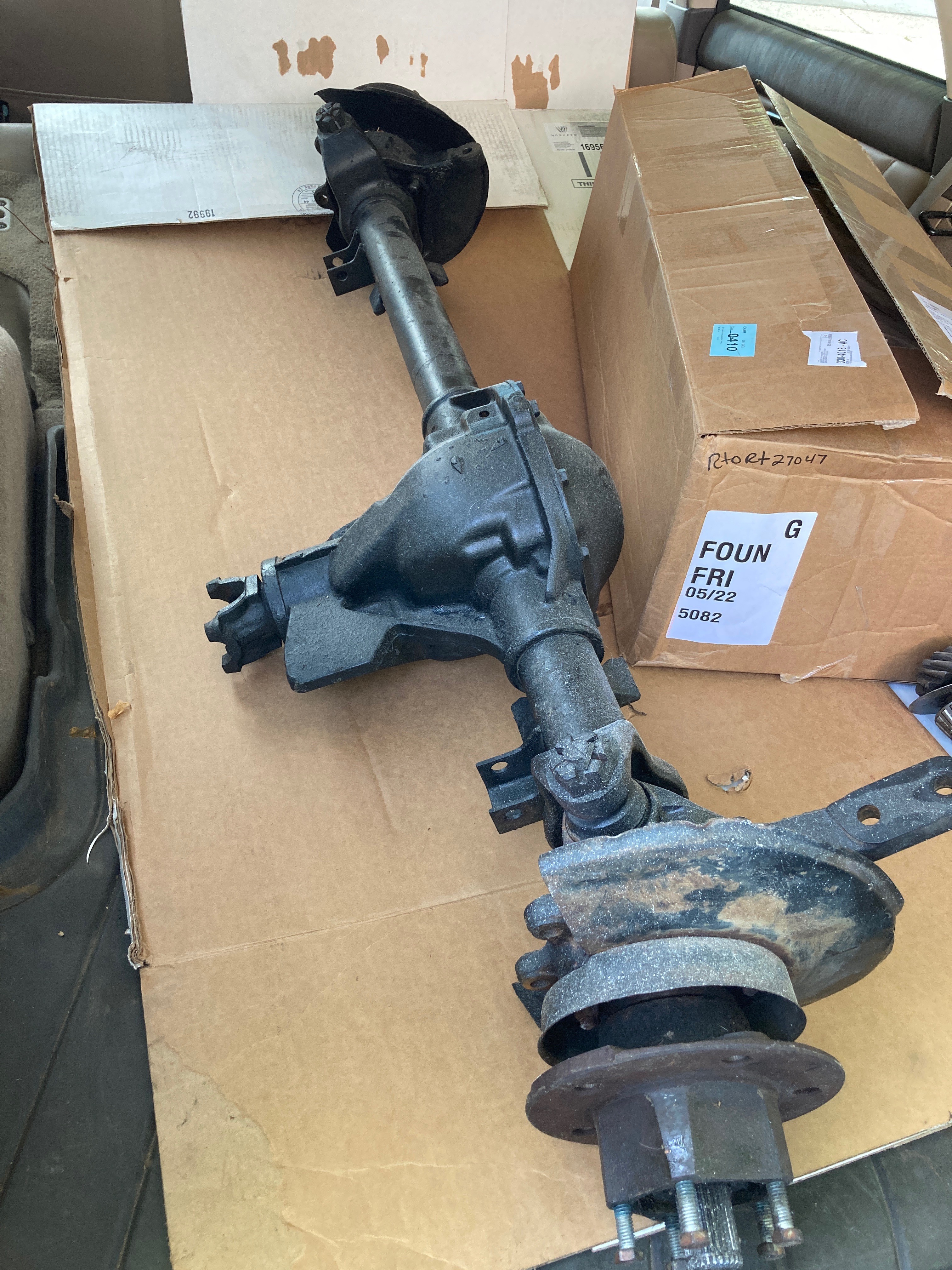

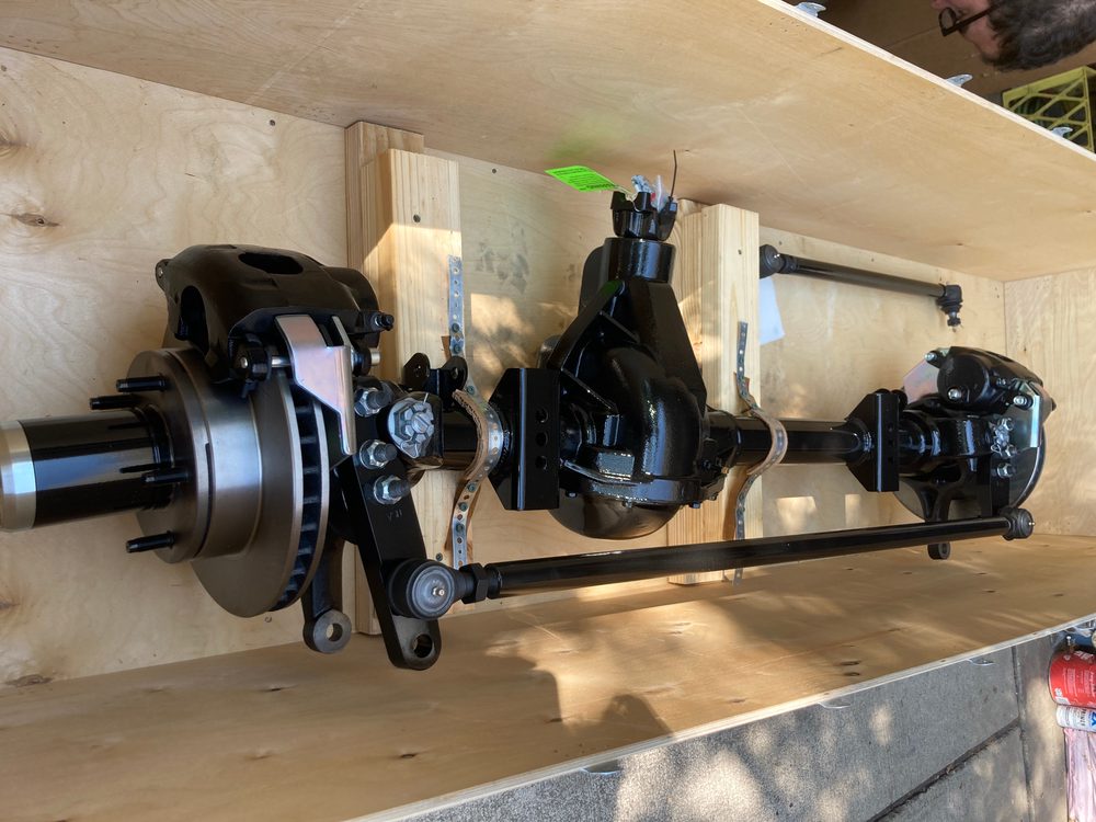

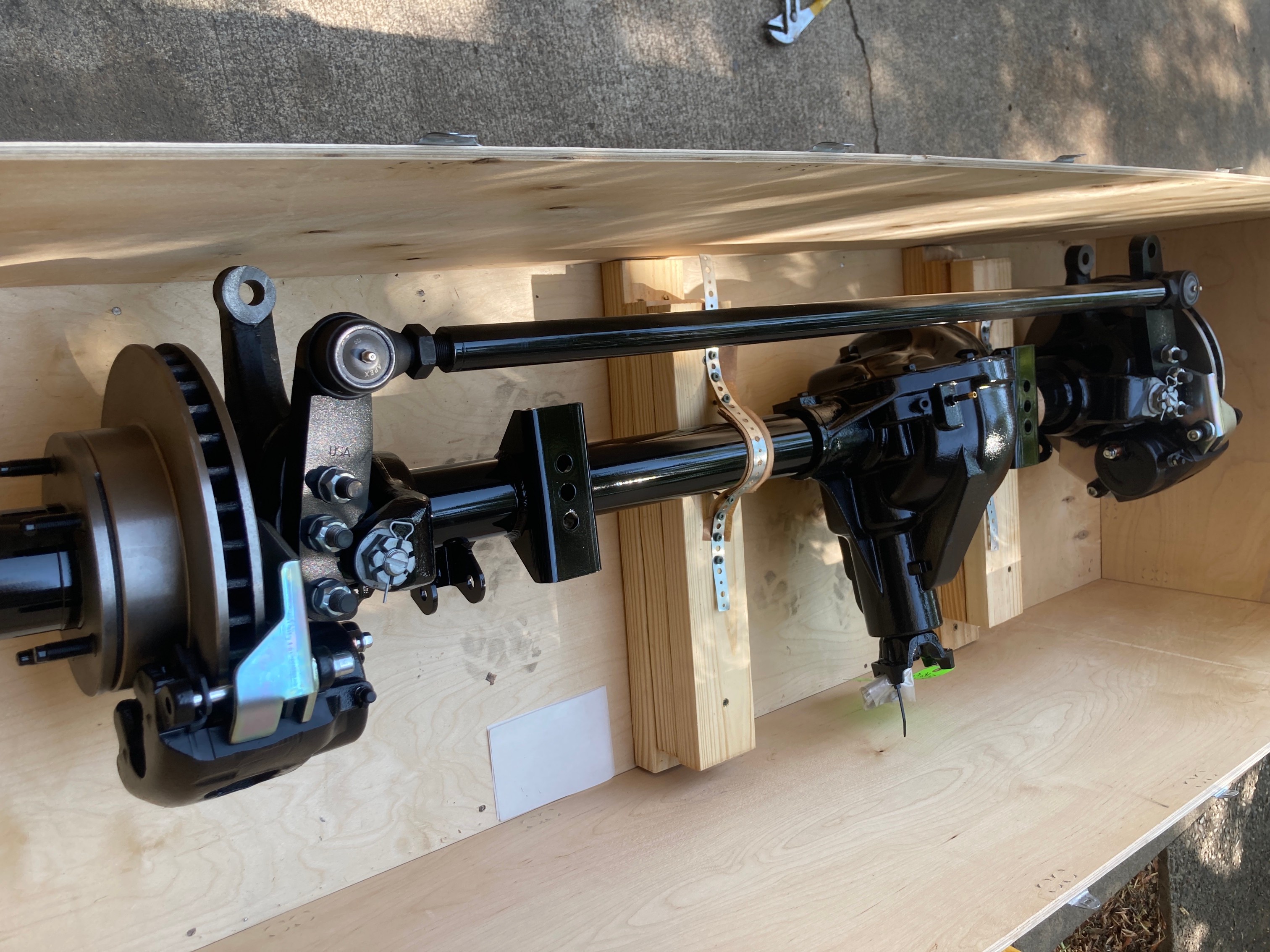

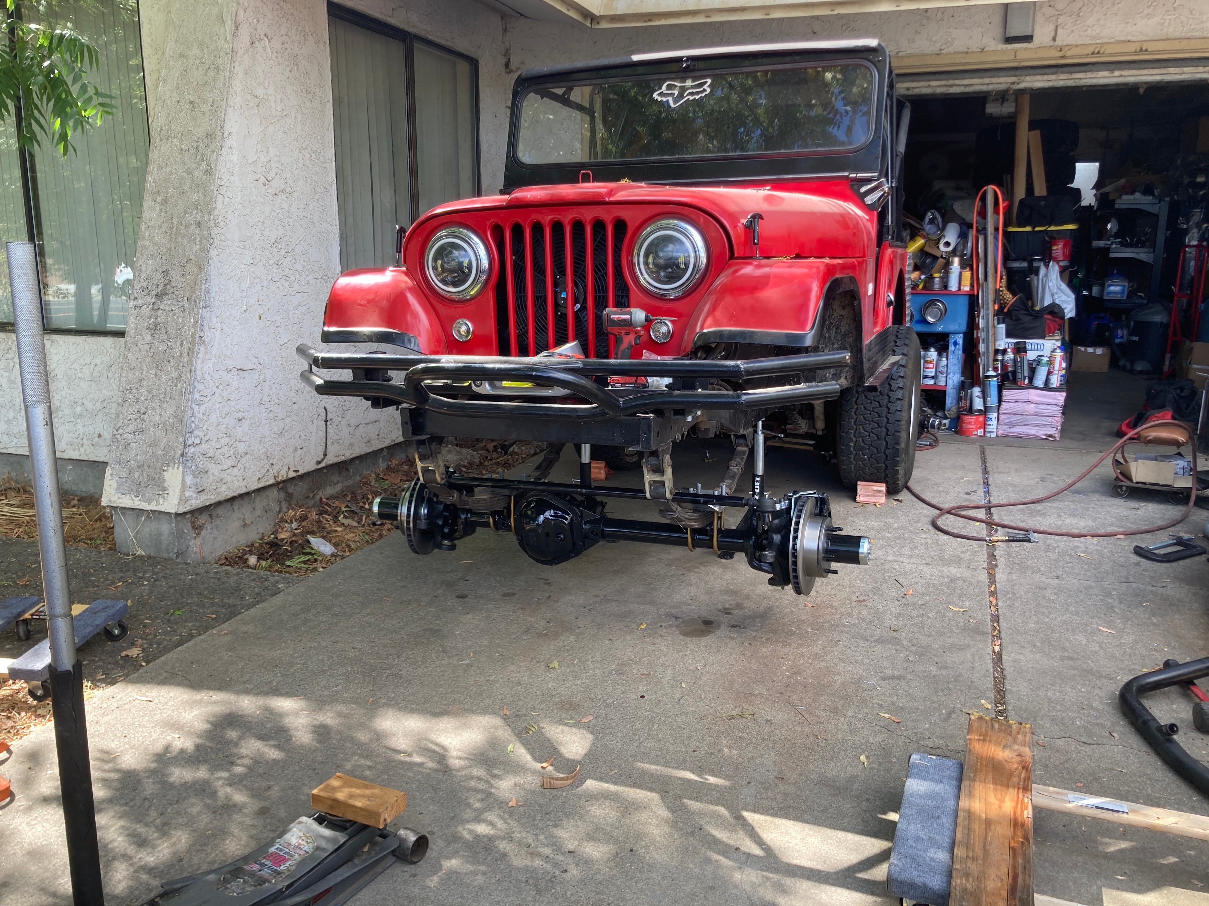

    Yesterday We got the Rear Motor Seal replacement done and the CJ5 is able to drive now.
    The Dana 44 that Timothy had built by East Coast Gear arrived today. Tomorrow we will install it in the Willy's

    #1216 Sep 2022, 11:31 AM
    Wow that's pretty.

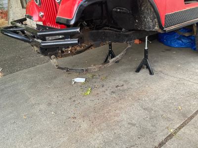

  13. Specialsoundman started this Member Joined: January 2013

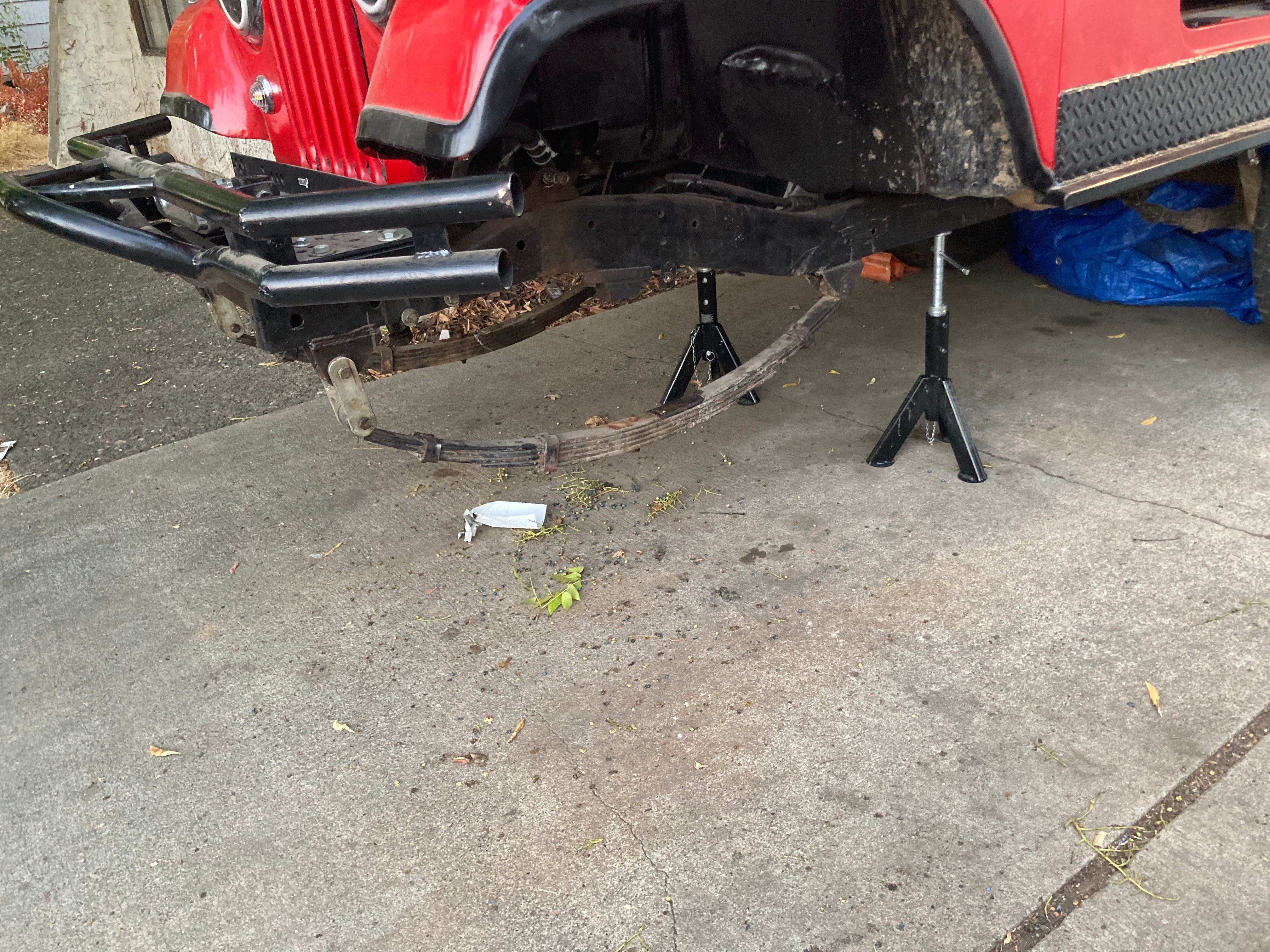

    #1316 Sep 2022, 12:31 PM

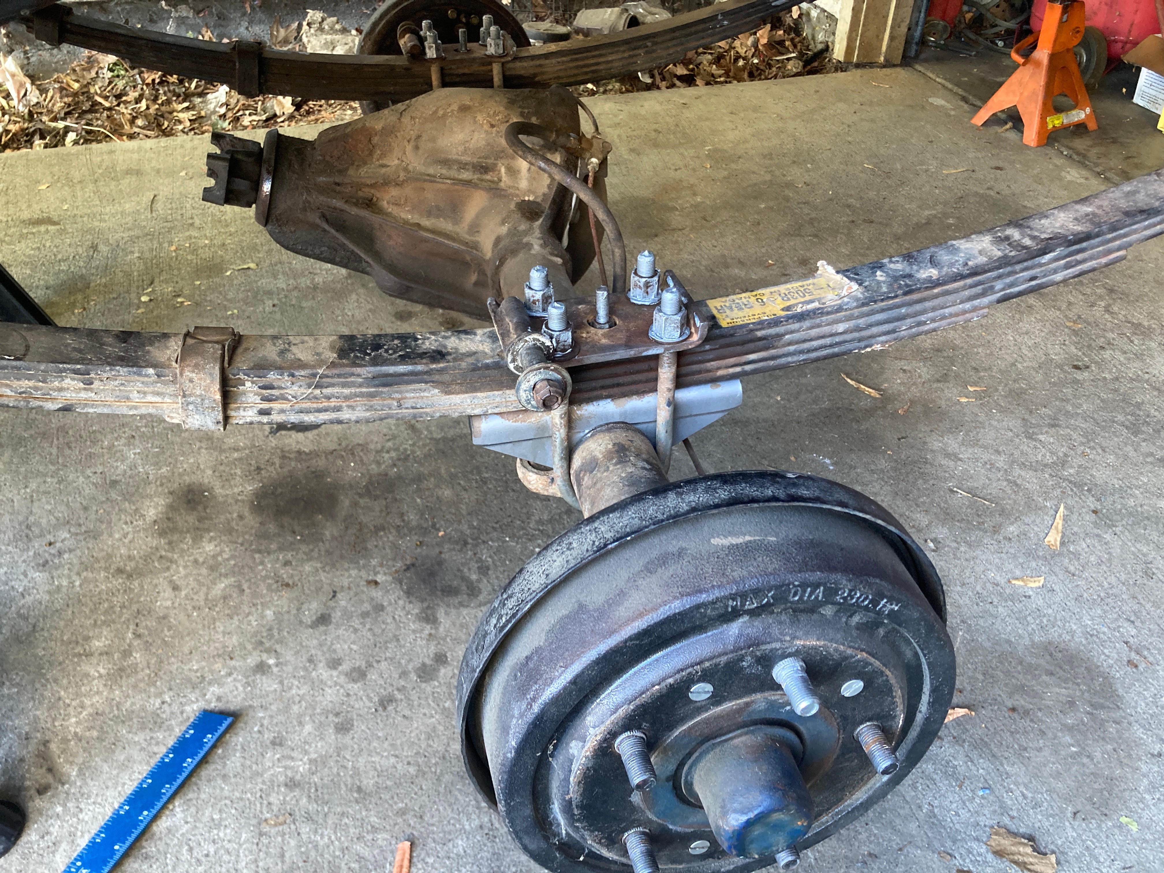

    The original Dana 25 is out. Tomorrow the 44 is going under.
    Anyone know someone restoring a classic CJ5 that wants a "back up" Dana 25?

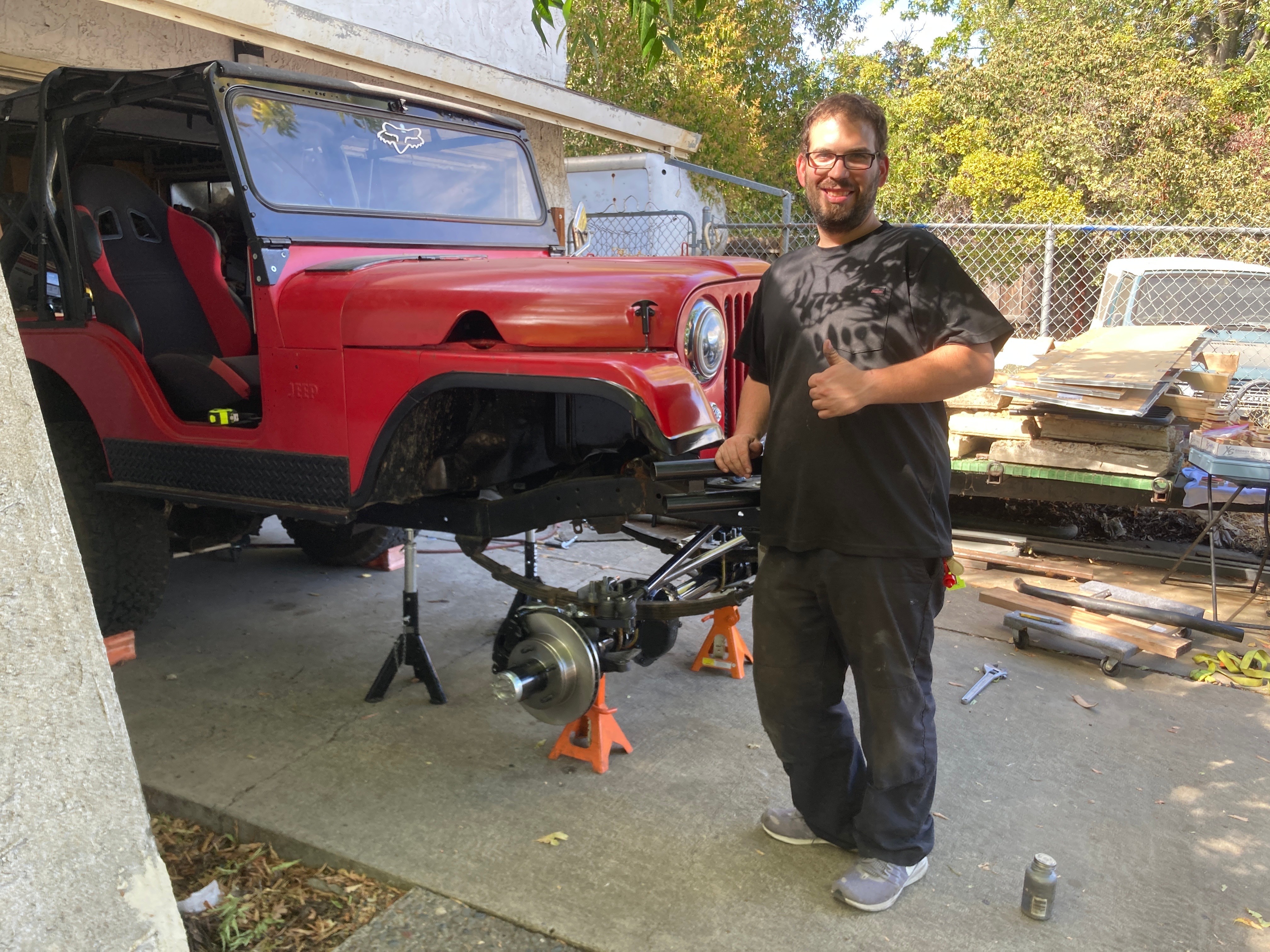

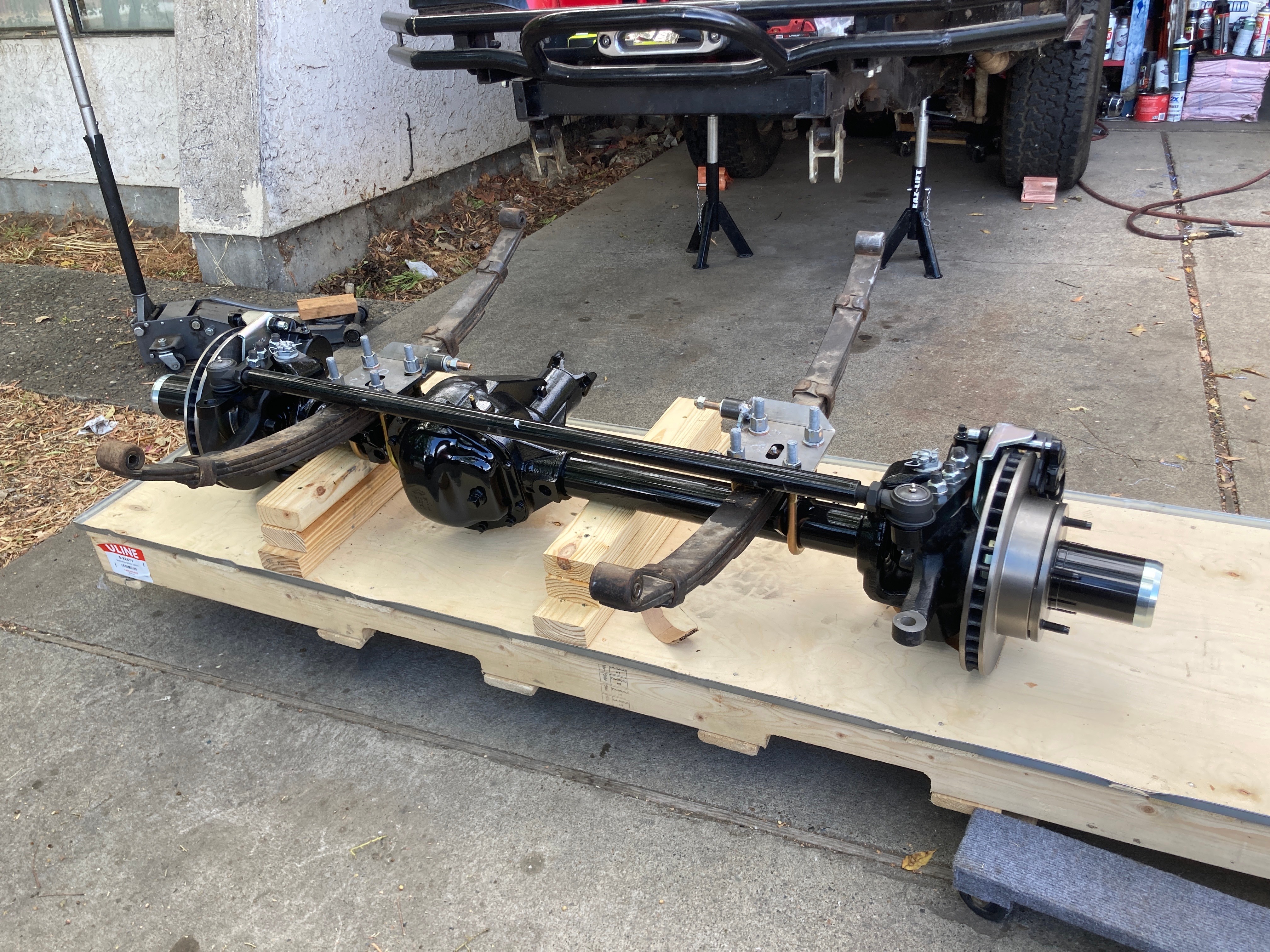

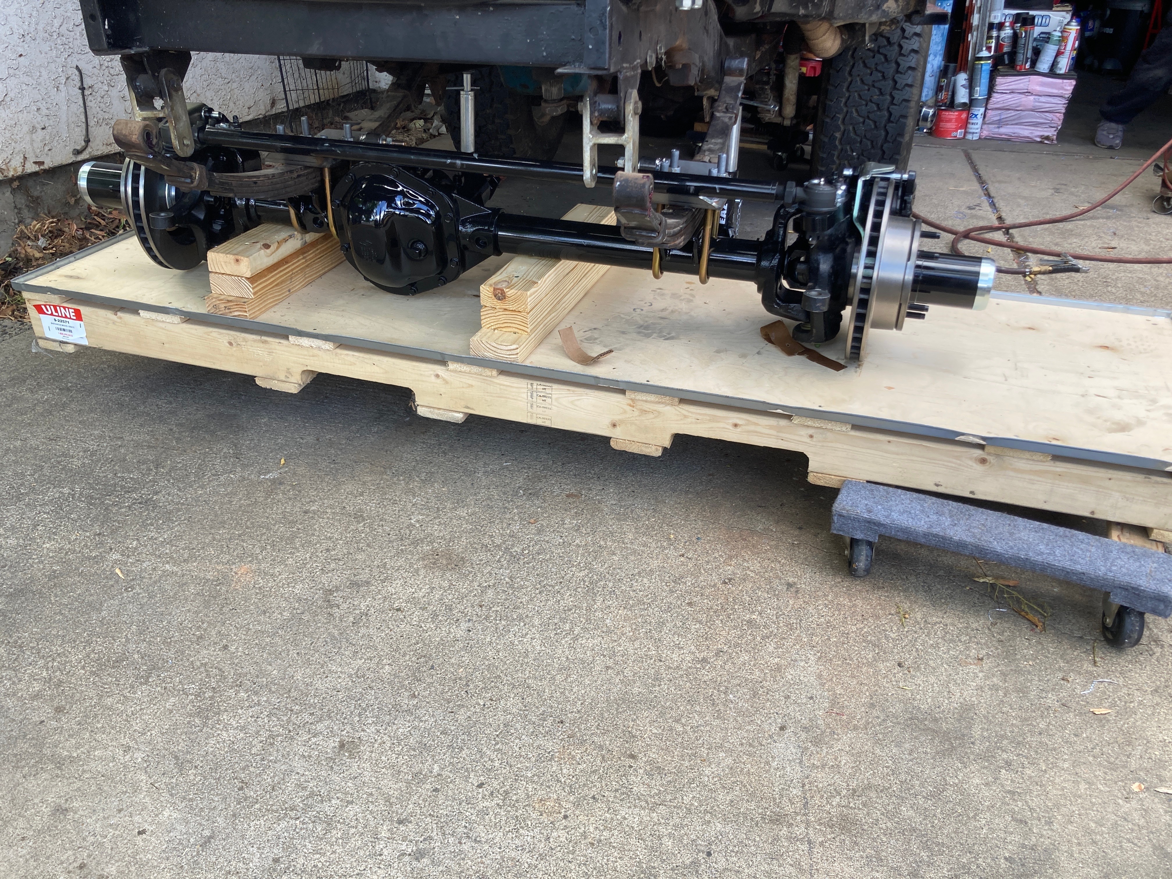

  14. Specialsoundman started this Member Joined: January 2013

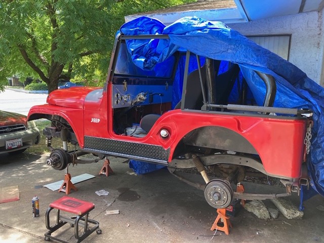

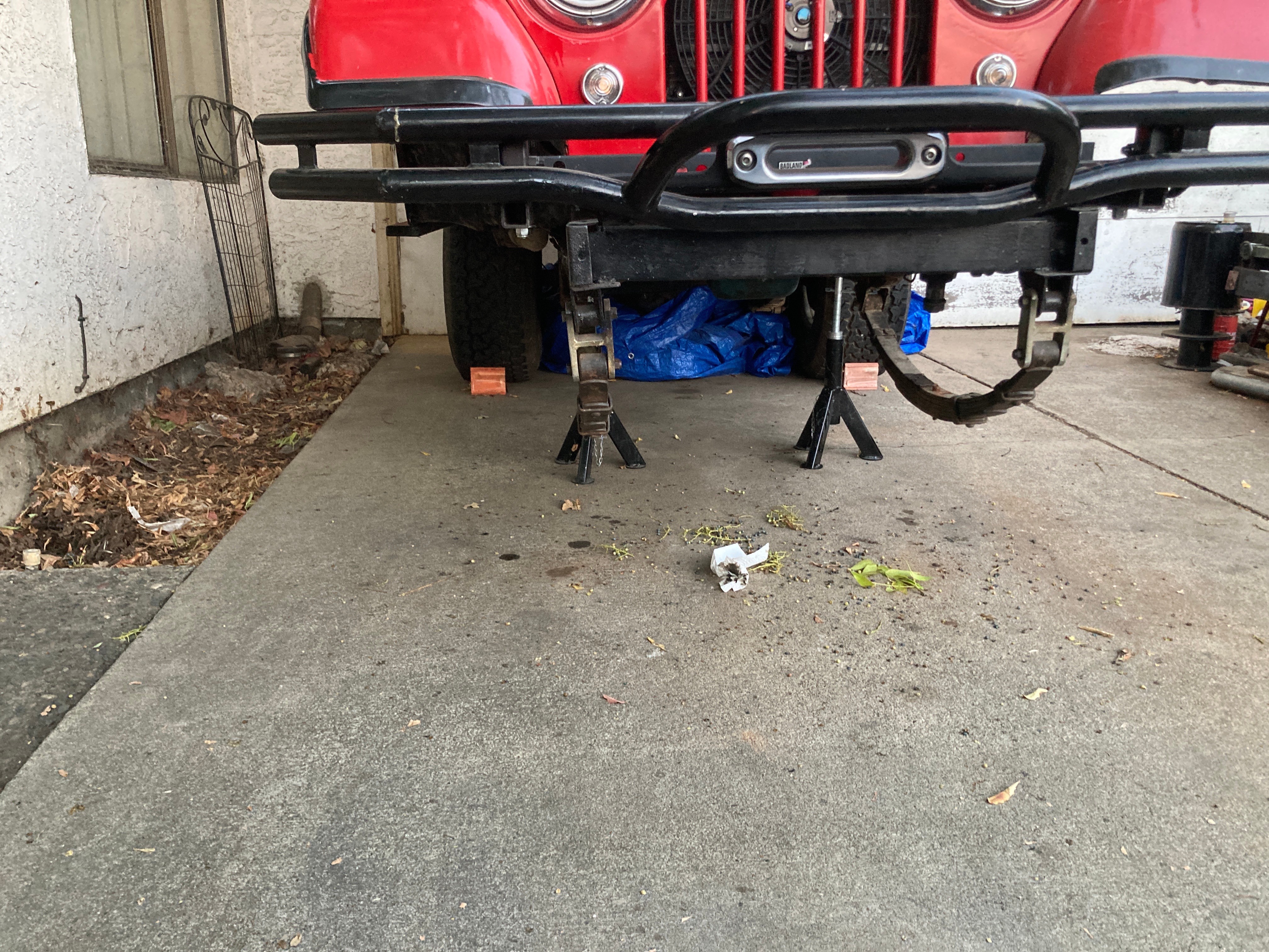

    #1417 Sep 2022, 9:20 AM
    Dana 44 is in and looks great. Got new brake lines ordered, install those. Then Timothy can drive it to Sac Drive line to get a front drive line built.

    #1517 Sep 2022, 10:51 AM
    Looks like you have invisible tires and wheels holding the front end up.
    https://posse4x4.org/wp-content/sp-resources/forum-image-uploads/specialsoundman/2022/09/IMG_3816.JPG

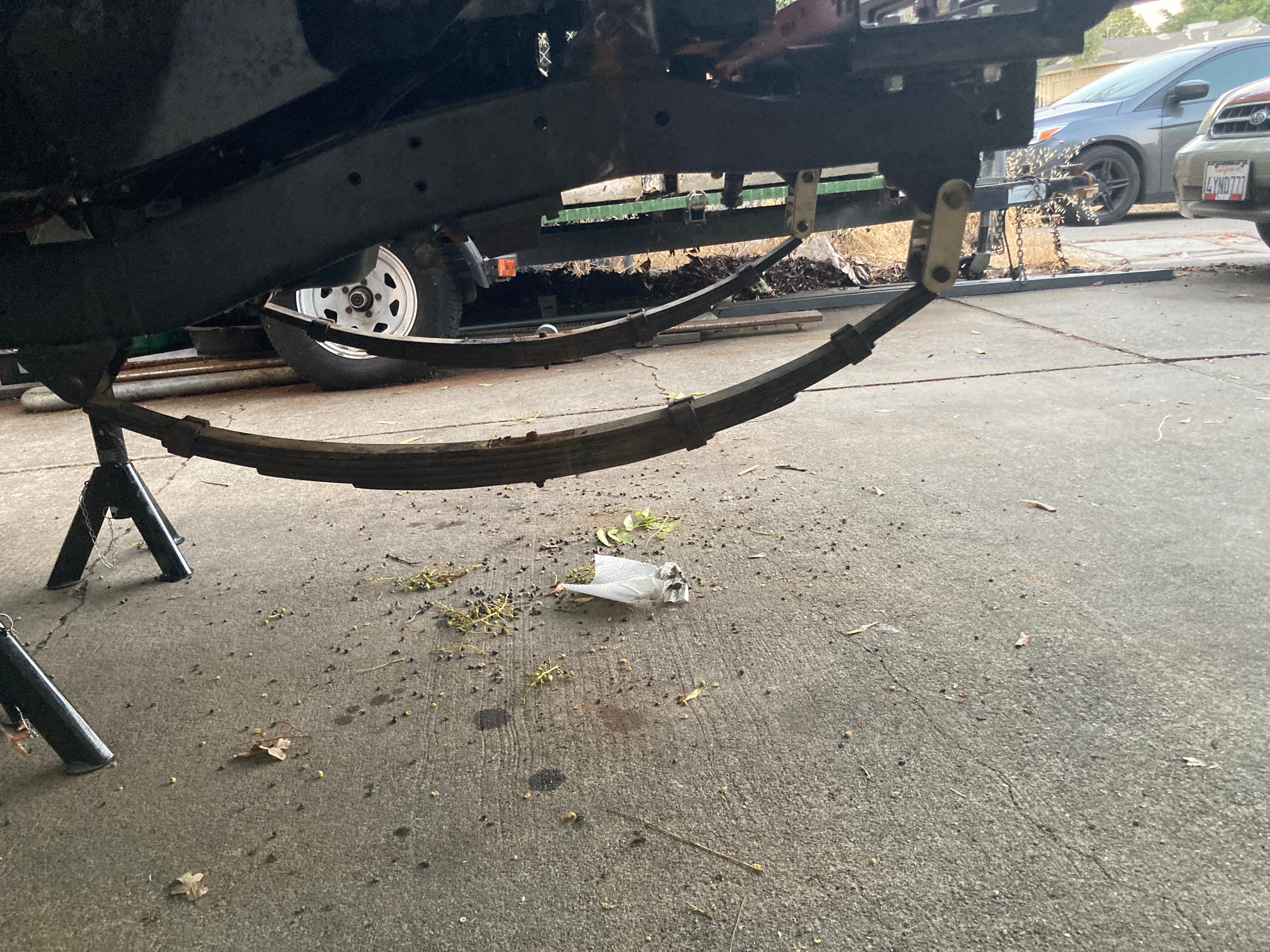

    And today we moved the rear axle to spring over. A little bit at a time, it's getting there. And yes the rear is a Dana 44.IMG_3844.JPG

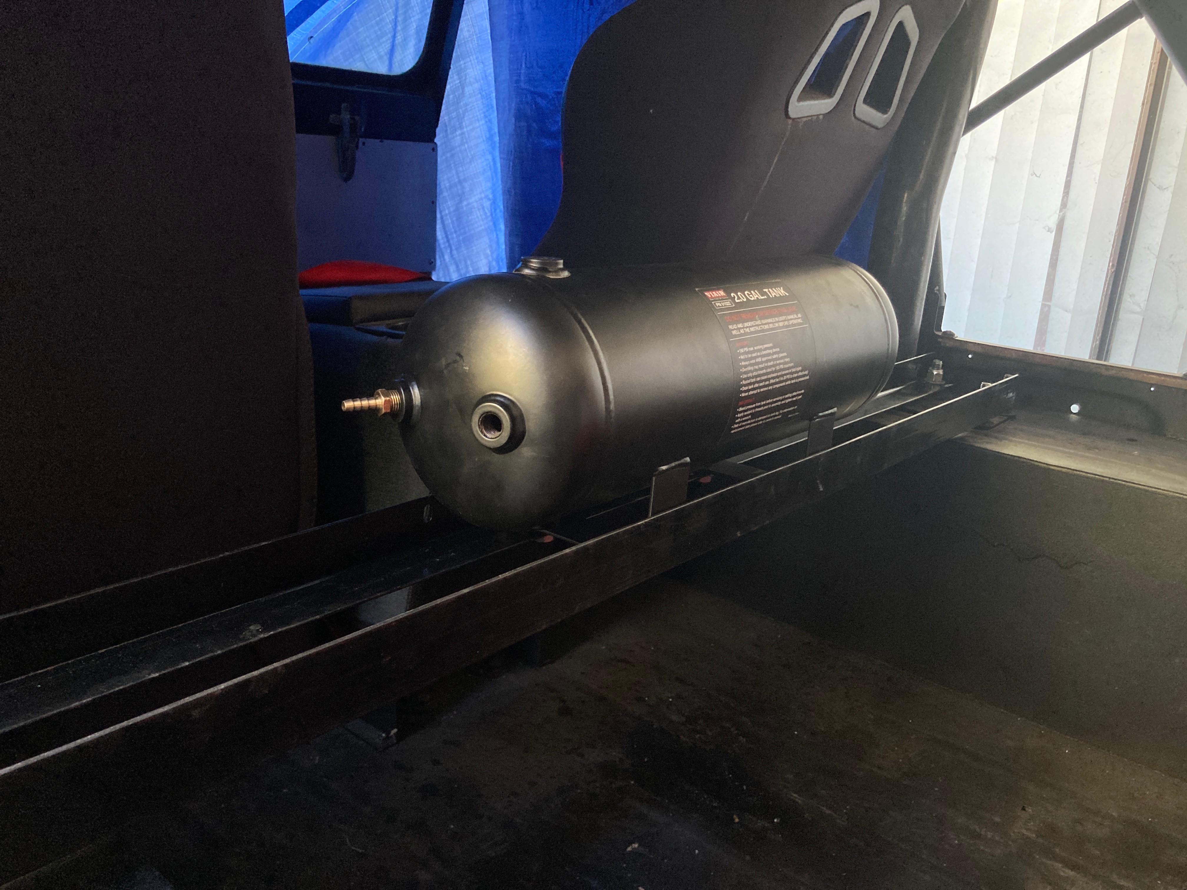

    Today we installed the air tank for the on board air system.

    #2230 Sep 2022, 1:28 AM
    Specialsoundman said Today we installed the air tank for the on board air system. IMG_3862.JPG
    Nice. Some tank I have. Are you installing a pressure relief valve for safety purposes since it is in the cab? Mine is under the cab but I think I installed the relief valve. Mine has taken some rock damage but it is in the only place I could put it that is not in the cab.
  23. Specialsoundman started this Member Joined: January 2013
    #2330 Sep 2022, 3:40 AM
    The system will be regulated to 120psi, and the bottom fitting will be a relief/drain valve vented to the outside. We looked at mounting it under the body and there really was not enough room. We will be able to also mount the compressor on the frame. And maybe future duel compressors.
    By mounting the air tank this way the frame can be used for possible storage platform/deck front mounting point.

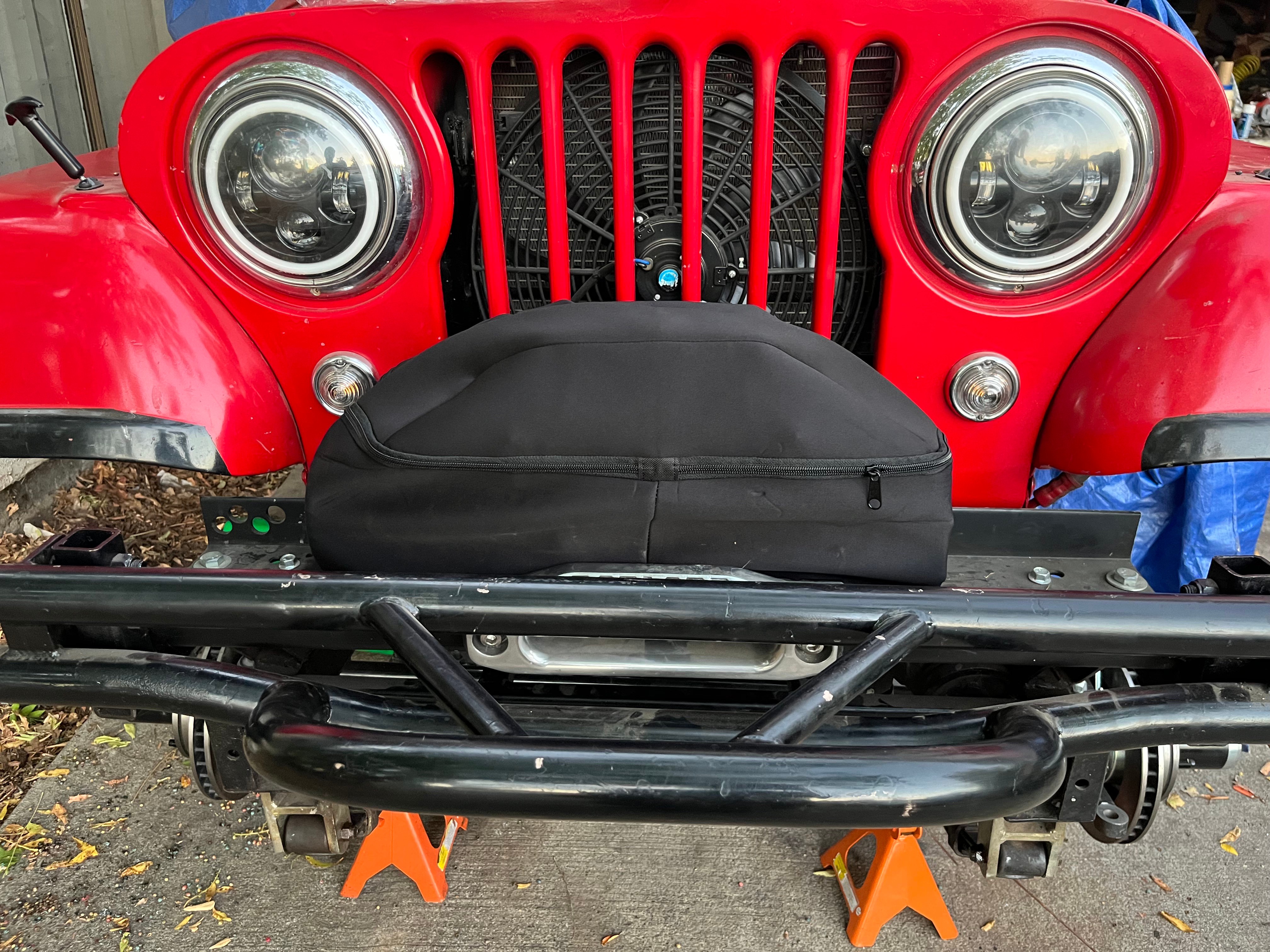

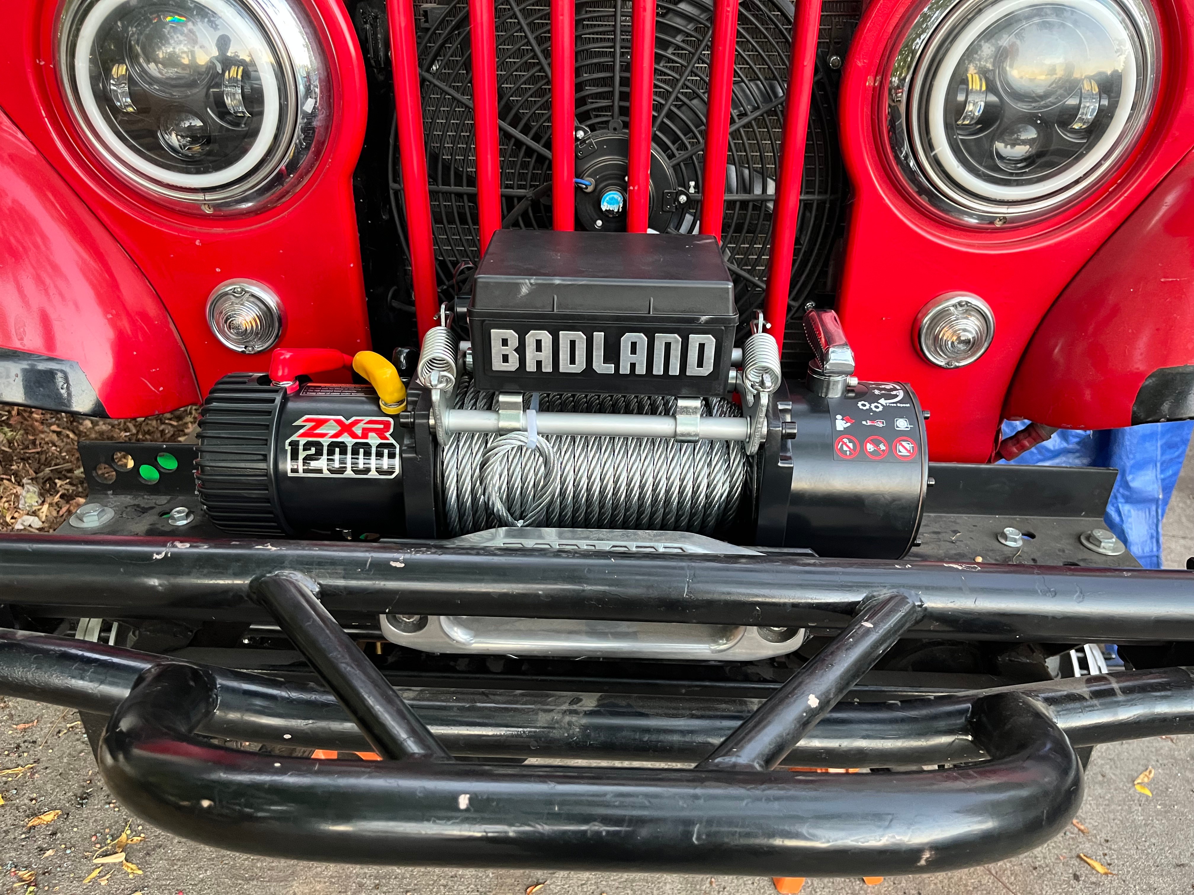

    #242 Oct 2022, 6:47 AM
    Mounted the 12,000lb winch. We have rope cable to replace the metal cable.
