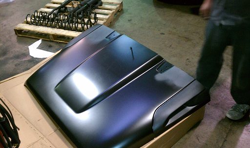

    I've seen that hood before. What made you choose it over the AEV option?
    #2914 Mar 2012, 12:53 PM
    Couple of reasons..
    1) In talking with others that own the two various hoods and BOR who has installed both with thier kit, the TMD hood actually draws air in to the engine via the working induction and funnels it to the air intake keeping it noticably cooler than the AEV hood which has vents that only allows hot air to rise out of the hood. The TMD hood allows hot air to rise out the side vents. BOR has done 500+ hemi installs and they said they won't even sale the AEV hood anymore. So i ordered it from them when I ordered the kit.
    2) The AEV hood tends to gather water in the dip in the hood (several commented on frustration with this) and via the mesh in wet weather drips water all over the engine and in the engine compartments. If water comes up over the hood it is going into the engine compartment.
    3) It is made of an extremely durable composite (not fiberglass) which resists dents & dings unlike the metal hood of the AEV. I plan to use the Jeep and wanted something strong.
    4) It just looks cool and with the functional induction should push cold air toward my intake and provide more power...
    the plan is for the hood to be black and the side vents and hood scoop to have a carbon fiber look it should look pretty sick!

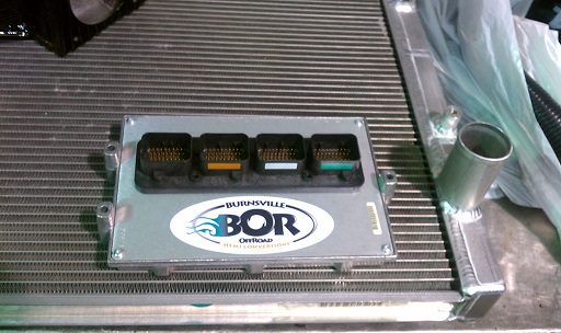

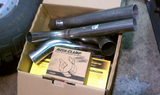

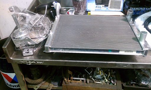

    Some more pics of the kit.
    New Radiator
    New Motor Mount
    New ECU

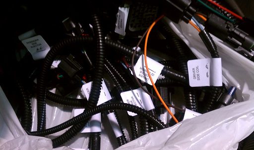

    #3114 Mar 2012, 10:03 PM
    Wiring Harness
    Exhaust System

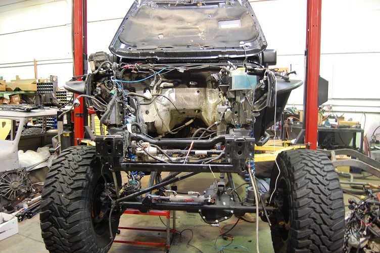

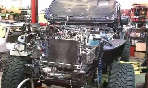

    What a day. I just came from the shop where lots is going on. With a little luck by the end of tomorrow there will be a hemi in that Jeep. Not done but a hemi sitting on the motor mounts with the transmission and transfercase all in place.
    Here is what was done today pictures to follow. Front of the Jeep taken apart, removed PSC steering pump from 3.8 and installed on Hemi, removed air lines to make way for new Stainless Steel air lines for lockers, replaced valve body in transmission replaced exhaust manifolds, replaced wiring harness on Hemi with Kit Harness, removed skid plates, drive shafts, transfer case, & exhaust. I know I left some stuff out it a lot to see.
    Plan for tomorrow pull v6, cut motor mounts, weld new mounts drop hemi. We will see how it goes.

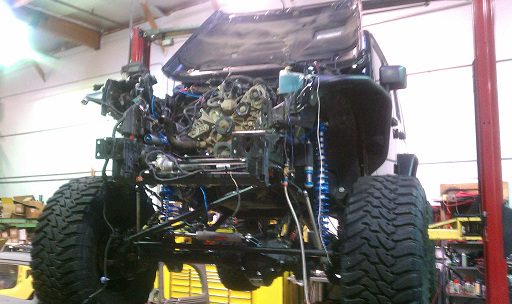

    Front Being Torn Apart- Air Conditioning Cooler Still in Place
    Front After everything removed
    On the lift, removing Rock Hard skid plates, Drive Shafts, Exhaust, Transfer Case and unbolting Trans from Crossmember and Loosing Motor Mount Bolts

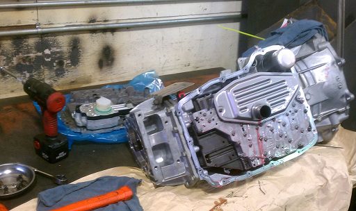

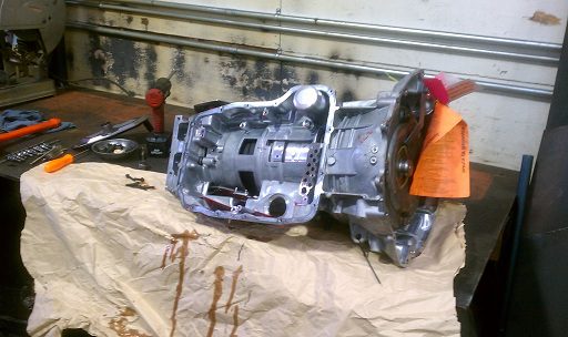

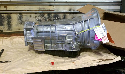

    The transmission I picked up was a 2011 545RFE, aparently the transmission to have is a 2010 545RFE. The original transmission that was bolted to the motor was a 6 speed and none of the kits work with a 6 speed yet. The place I picked up the motor had a 545RFE from a 2011 with 20 miles on it so that is what they swapped my 2012 6 speed for. In order to get the 2011 to work like the 2010 the valve body needs to be replace. I saw this happen and it took about an hour start to finish was pretty straight forward, but I was glad the person doing it was a mopar mechanic who had done this before.
    Original Transmission
    Transmission Open with New Valve Body sitting on the counter
    Transmission on Bench with Valve Body Removed
    *** Big Tip Here - Order Valve Body and Mopar Parts from www.factorymoparparts.com The Valve Body was almost $200 cheaper than the dealer, every part we ordered was cheaper and they are factory OEM. *** Complete List of what I had to get on top of the complete motor to come once we quit buying stuff...🙂

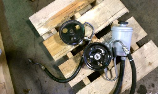

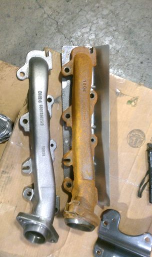

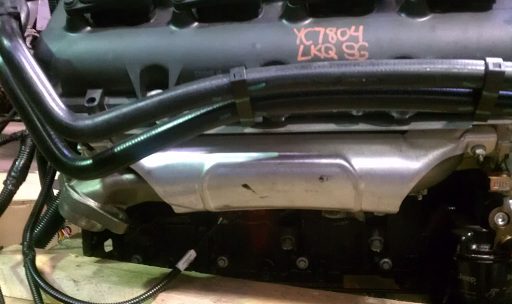

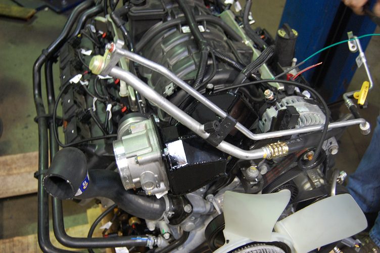

    To make the Truck motor ready for install we had to prep it and this is where having a 5.7L out of a cherokee would have been an advantage. Had to replace the wiring harness with the BOR wiring harness. Everything plugged in nicely and was labeled extremely well only one plug didn't match. So we had to cut one plug off the Truck harness to finish out the BOR harness. Next it was on to the steering pump. Have a PSC Hydralic steering system I have a PSC steering pump on my 3.8L motor that was removed and placed on the truck motor. It was not an exact match and we had to drill out the threads as the truck mount had bolts that went through the pump and screwed into the mounting plate and Jeep motor had a hollowed mounting plate and the bolts screwed into the pump. In any event a drill, drill bit and about 5 min and we had the PSC steering pump mounted like it was made for that Hemi. The truck exhaust manifolds shoot straight back and on the Jeep would point right at the fire wall. The cherokee manifolds angle down and therefore the truck ones had to go and the new cherokee version was installed. The throttle body points straight up on the truck motor and BOR kit comes with an adapter to point it toward the Jeep air box location. Lastly, the fuel filter on the truck points straight down and on lower lifter vehicles can come into contact with the control arms. A fuel filter adapter (cherokee) was used to angle this up and out of the way of harm. I guess its worth mentioning the motor mounts for the truck don't fit the BOR kit and Cherokee mounts had to be ordered. (I see why AEV recommends the Cherokee motor, sure hope those extra ponys are worth all this trouble)
    PSC steering Pump vs. Hemi Steering Pump
    Cherokee manifold vs. Truck manifold
    Cherokee manifolds installed.

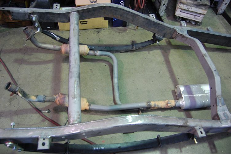

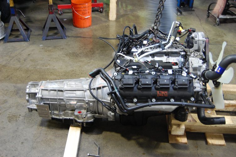

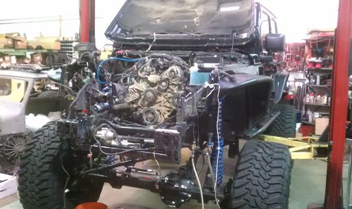

    Today was a very productive day. We started the day with the V6 motor removed and hoped by the end of the day to have the Hemi sitting on the motor mounts. I spent the day at the shop helping out as I could and learning about the process. It was immensly beneficial to be there to see all the details that had to be tended to to make a hemi swap come together. We started the day by attaching the transmission to the motor so they could be dropped as a single unit. We also test fit the Rubicon transfer case to see if the wires from the harness would fit and working out where the fuel lines would run as the Jk motor has them on the passenger side and the Truck Hemi has them on the right. We installed the new Oil Dip Stick (not included with the transmission) and neatly zip-tied all the wires along the transmission and transfer case so they would be neat when in the vehicle. You want to do this before they are in as you have access when out. To prepare for the motor we had to cut off the factory motor mounts, install the BOR motor mounts (which required trimming because of my coil over shock towers) this includes welding. They were indexed to only fit one way. We had to install the new steering adapter that moves the steering shaft down and to the driver side more to allow more room for the motor to fit. We also had to take a BFH and beat the firewall back in specific areas to allow for better fitment of the hemi engine. While everything is apart it was a good time to rewire some of my switches to go through the firewall so when I install a cage down the road no wires are in the way. I know there is something I am forgetting as I upload pictures and video I will be sure to add more detail.
    This is what we started with
    This is the old exhaust (for sale in case your interested)

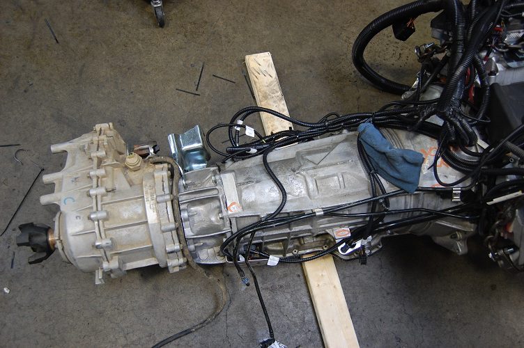

    Burnsville Offroad had been very helpful everytime I have called. They need to improve thier Truck VVT Hemi instructions and they recognize that. I was told today that at Easter Jeep Safari Mopar is going to announce that this kit is available for sale through Mopar Performance at all Mopar Dealerships. I think that is saying something.
    Here is a picture of the motor mated to the transmission.
    Here is a picture of the wires to the transmission tied down to the transmission. There are ends that are not plugged in that go to O2 sensors. BTW You have to order 6-8 O2 sensors for install into the exhaust system unless you have the truck exhaust system to take the O2 sensors from ($35 a piece)

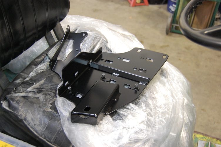

    We had the battery tray powdercoated. I ordered a dual battery tray, the single was the only in stock. BOR sent me the single to get me to MOAB with a Double on the way at no additional charge. I will have to do another writeup on the dual battery setup when it comes in.

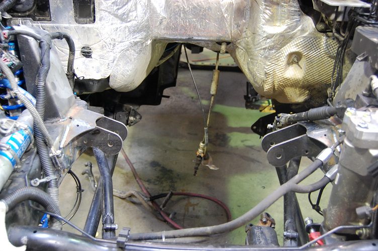

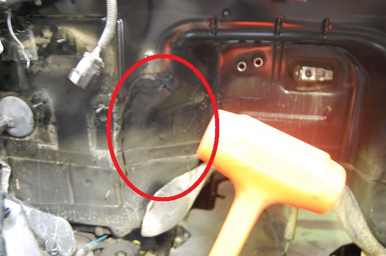

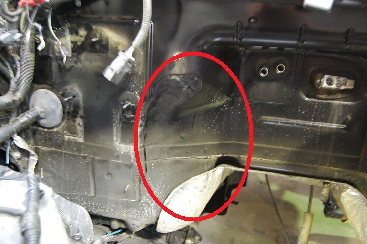

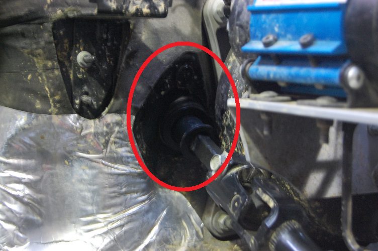

    To make room for that big Hemi we had to beat the firewall back about an inch on both sides. The instructions call for cutting the heat shield beating it back and placing a new heat shield on the body. We removed the heat shield beat the fire wall back and replace the heat shield intack. This made more sense to us. Also to make room we had to uninstall the steering rod and cut the opening wider than it is currently. Then use an adapter plate from the kit to shift that steering rod toward the tire and down away from the new Hemi.
    Passenger Side Firewall Beat Back about an inch
    Passenger Side Firewall Beat Back about an inch with the BFH that did it.
    Pic of the Steering Rod Adapter. It barely clears the ARB air compressor mount I have but it does clear.

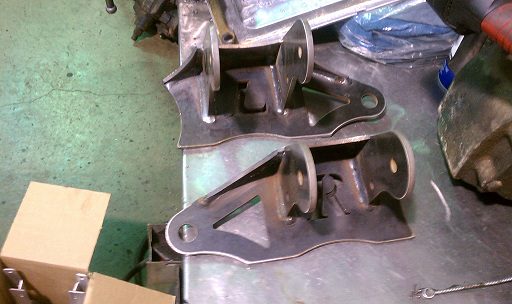

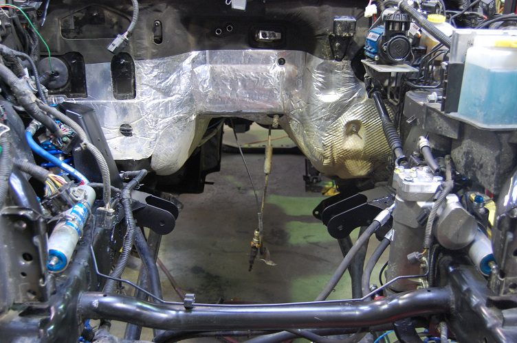

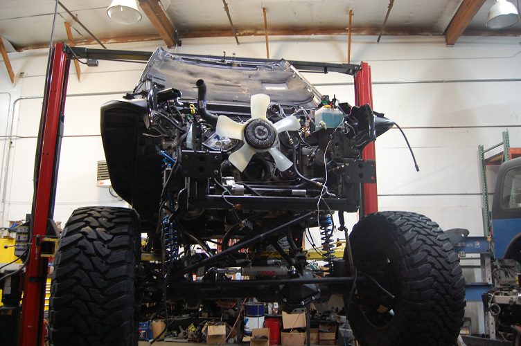

    To install the motor mounts we had to cut out the factory motor mounts. We then had to prep the frame rail for a good weld. The BOR Motor Mounts are much larger than the JK mounts. They index off a hold cut in the frame and a tab on the mount that rests on top of the frame. We had to shave the tab down as it came in contact with my coilover towers. It was nice to weld these in as they had much more edge to weld to than the JK mounts. We cleaned everything for grease and then painted both the back of the coilover tower and the motor mounts with Black paint.
    Here is the motor mounts welded in place
    Here are the motor mounts painted black
    Here is a picture of the Hemi Sitting on the motor mounts.
    Challenges for today: When installing the motor mounts we called and were told the yellow stickers(UPS) go up and the "long" side is obvious. (one of the motor mounts is longer than the other) The issue is both motor mounts use the same bolt configuration so we actually put the mounts on the wrong sides and had to take them off and switch them with the motor simi-inplace. Also we found that the ARB compressor was in the way and uninstalled it to get the motor in place. The Alternator plug didn't match the harness so we had to cut off the Truck Harness plug and put it on the BOR harness to complete the harness install. Additionally the fuel lines on the JK are Passenger while the Truck connections are Driver and therefore we had to cut the JK lines and adapt them to fit the Driver side. The JK Transmission connection isn't a match for the Truck transmission shifter so it looks like that will be another misc part to be picked up. When picking up the motor we had to remove the air intake to find bolts to attach to. We will have to reinstall after it is in the truck.
    What is left: Finish plumbing all hoses and fittings. Put front end together and install new radiator, new trans cooler, new pusher fan, and motor fan shroud (also powder coated) install battery box, connect transfer case, drive lines, weld transmission mount to cross member and install cross member, skid plates, fill all fluids, finish all wiring and take a test drive.
