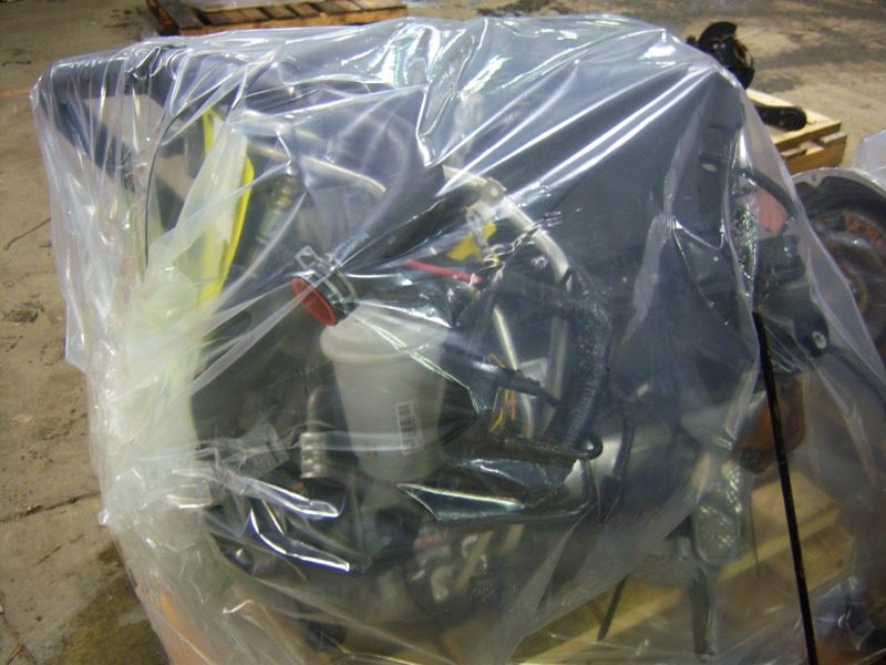

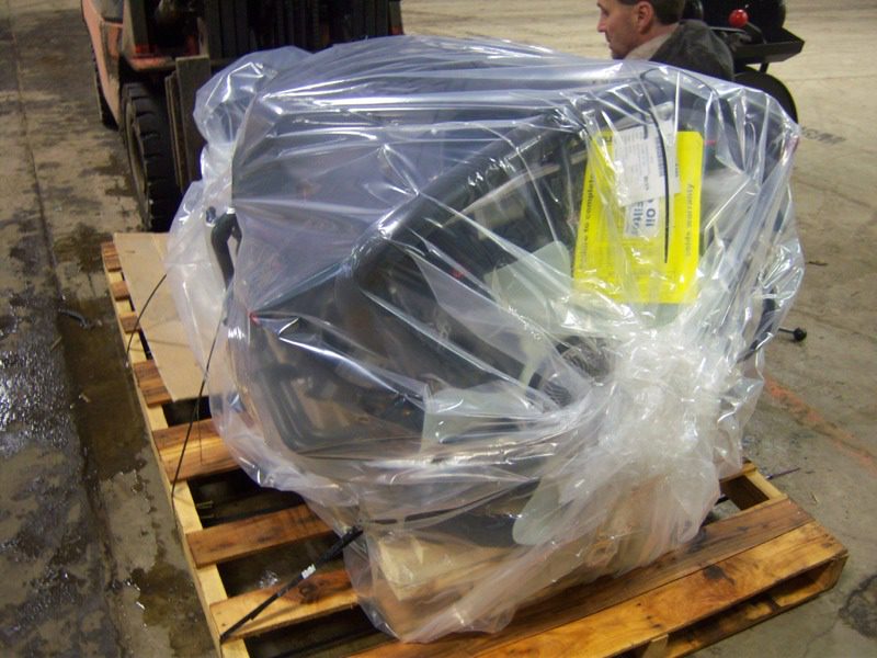

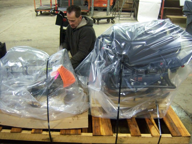

    #2024 Feb 2012, 12:01 PM
    First pics of the beast getting packaged for shipment. Should be here next week!
