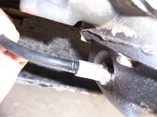

    "Justin" wrote: He was in a black Unlimited on 33's. OX locker went out in the middle of winch hill #1.
    Yeah that was my rookie Fordyce run.. 😲 Fun!
    Took a toll on my rig.
    I must have came down hard on a rock right where the OX cable enters. (the downside of OX. I know πŸ™„ ARB)
    I had to readjust the cable. I works now, but I'm leaking a little oil out the cable where its split. I'll be getting a new cable eventually.
