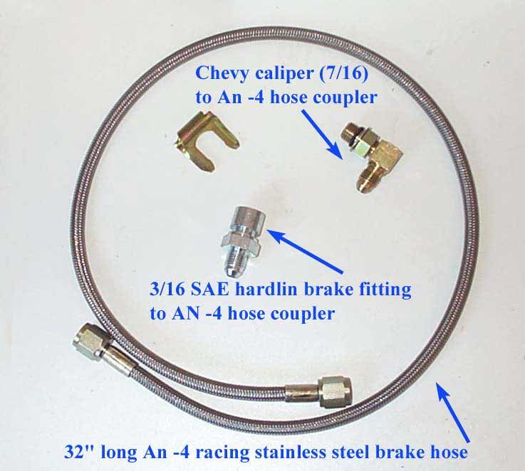

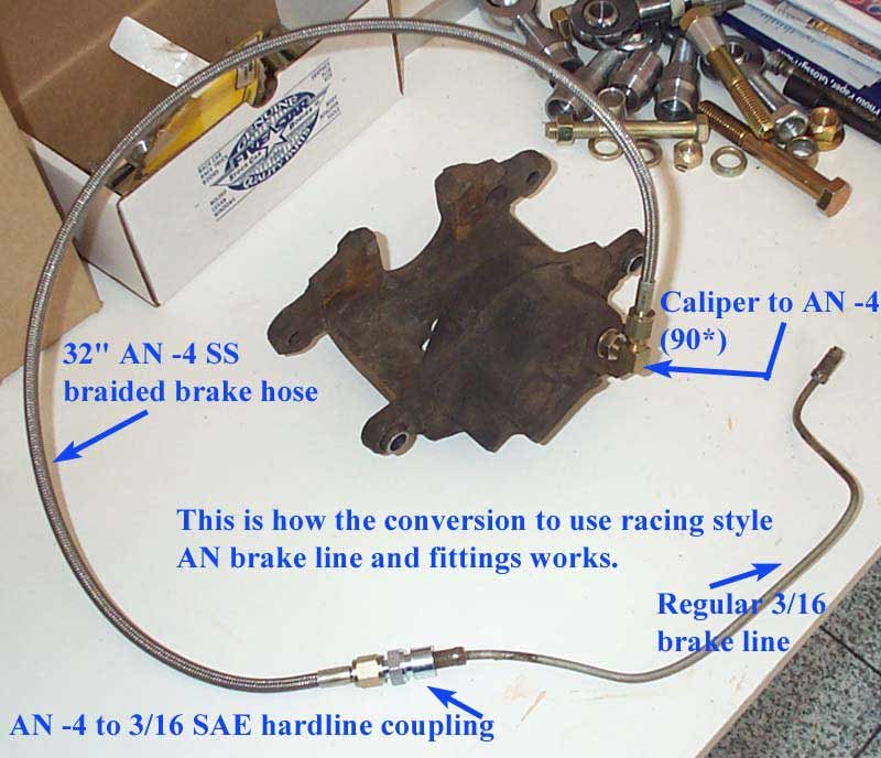

    Cheaper to buy them already built.http://www.speedwaymotors.com/Goodridge ... 31417.html I run -4 on my front brakes rear brakes , clutch master cylinder, and steering ram. 1 spare hose fits 5 positions. Just use an adapters on the calipers. Mark

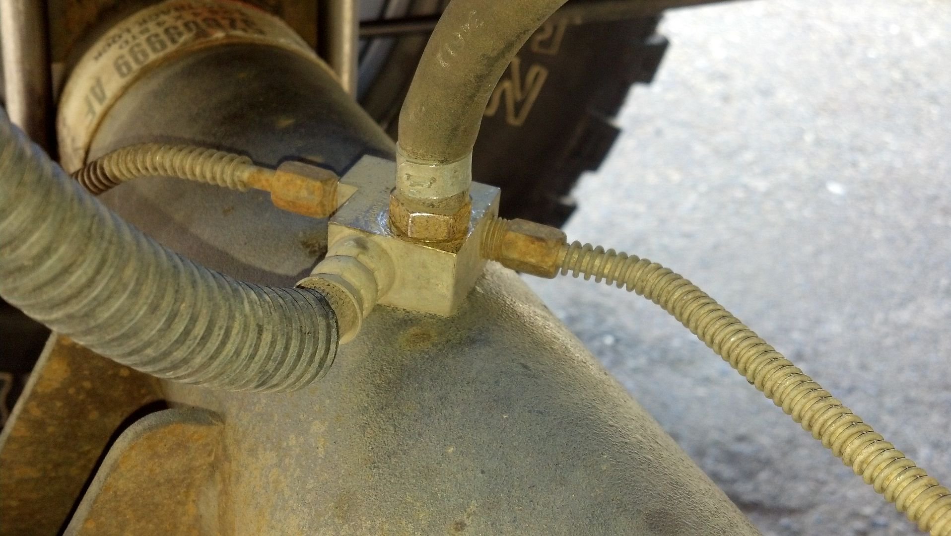

    I don't work with hydraulics at all. Can one of these put in to extend my current stock line rather than replace? Issue here is that on the rear axle the hose goes to a t-block, where it's swaged on.
    I did receive a quote from Artistic Tubing that covered all 3 lines (20" long) and adapters/fittings for little over $100. The fitting to the caliper remains a banjo and a new rear t-block will be used. I do like those Kevlar ones above much better though....

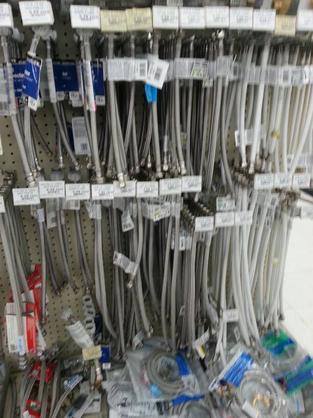

    #132 Apr 2013, 4:17 PM
    I found them cheap at osh....
