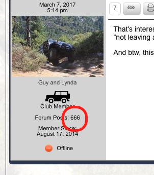

    #97 Mar 2017, 10:32 AM
    You go first on the next run!
    You will forgive me if I dont trust your post.

    #128 Mar 2017, 9:43 AM
    kris_olof said
    Guy and Lynda said   You go first on the next run!
    Holy moly!  Well this is the counter to the jinx  😇😀🍺🍺🎁🌸👧🍺🕺🤗😂😍😉👏🍺🍺🍺
