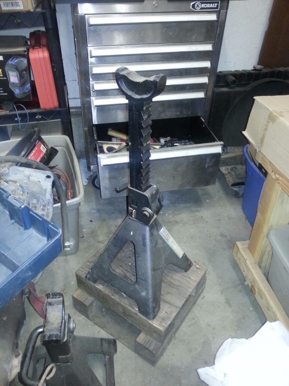

  10. 70dustpan Member Joined: June 2015
    #1031 Aug 2017, 1:39 PM
    I have a set of 12 ton stands with spacers to sit the stands on. They go up to 38" all together. You can use them if you want.
  11. 70dustpan Member Joined: June 2015
    #1131 Aug 2017, 1:43 PM

    #131 Sep 2017, 12:11 AM
    70dustpan said I have a set of 12 ton stands with spacers to sit the stands on.
    That's exactly what I do too.
