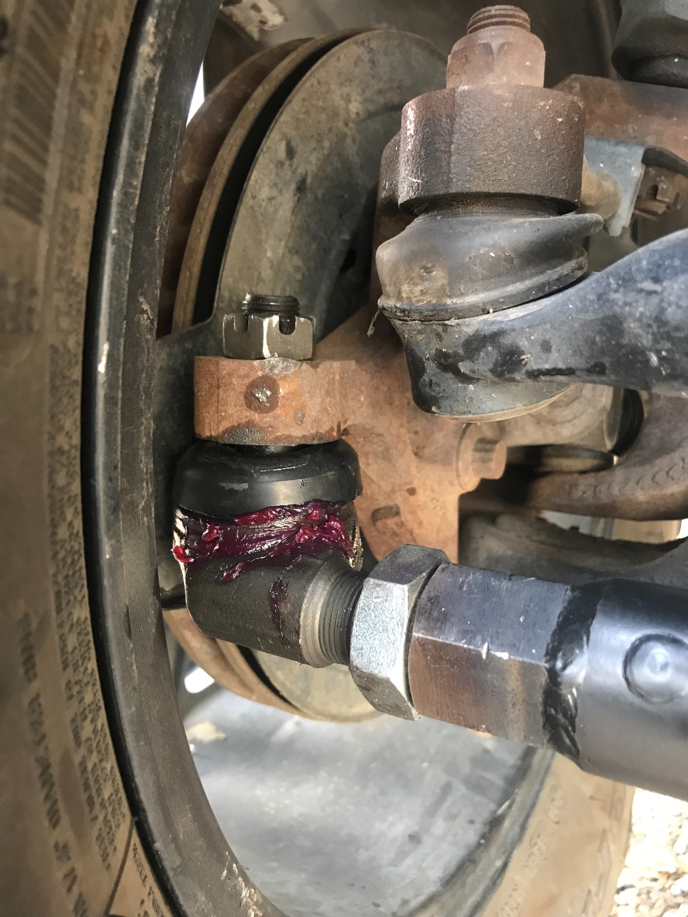

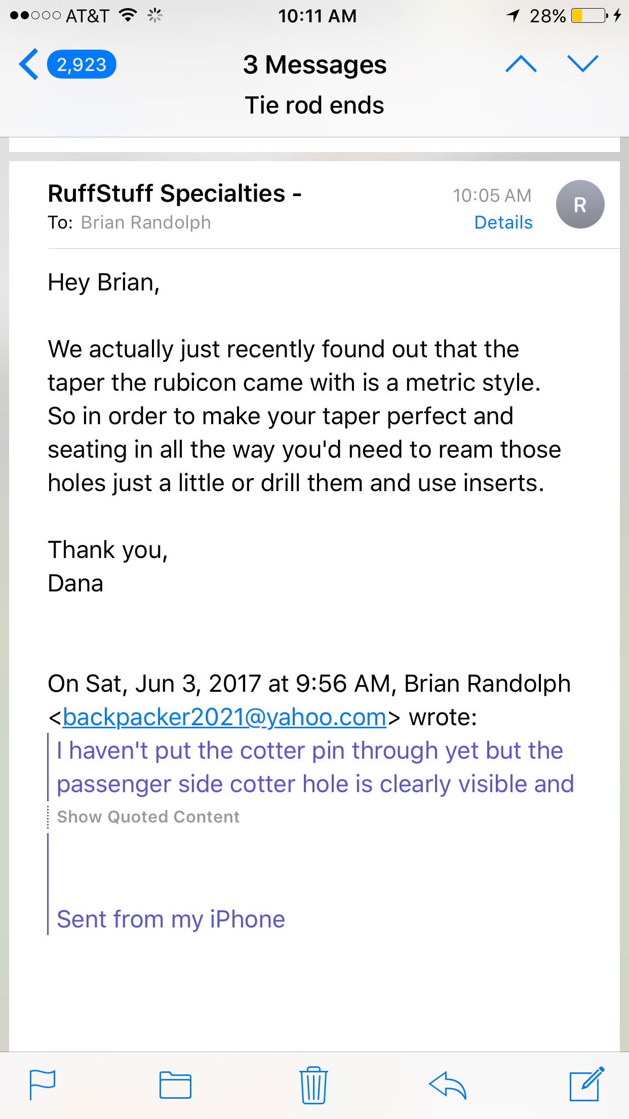

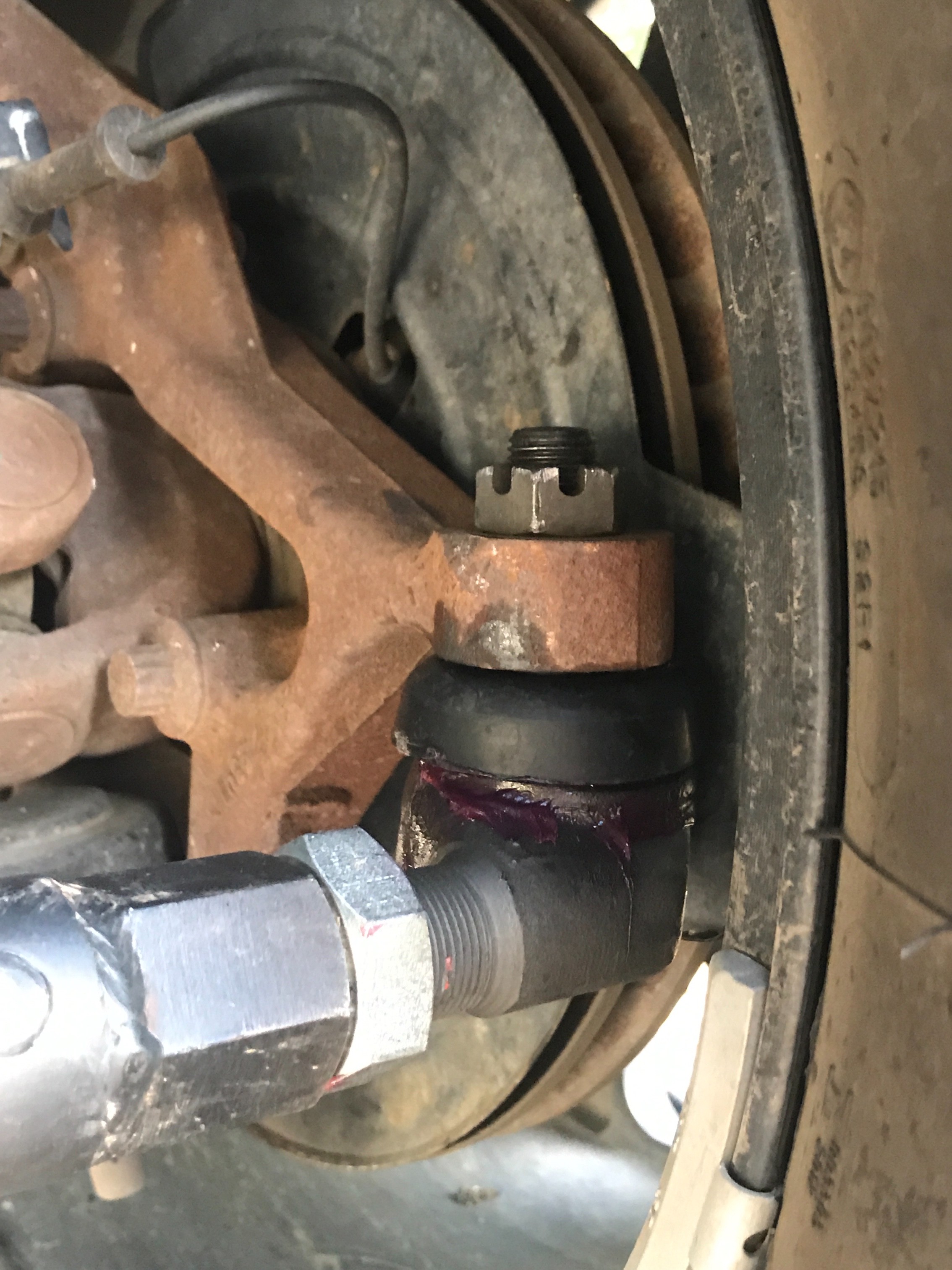

    What are your guys thoughts? Ream? Drill? Or ditch it and get another brand
    they are currently installed but not fitting the best

    Brian said IMG_1269.JPGIMG_1270.JPGIMG_1272.PNG What are your guys thoughts? Ream? Drill? Or ditch it and get another brand  they are currently installed but not fitting the best
    I very well might be the least qualified to give advice here but... I would return them to Ruff Stuff and find some that fit.  The idea of taking more metal out of the joint does not sound good to me.

    #93 Jun 2017, 5:48 AM
    what about flipping the tie rod I think they make a kit for that haha

  11. Brian started this Member Joined: February 2020
    #113 Jun 2017, 12:43 PM
    I went to rock and road performance. Super awesome deal. Did not need much of a ream. Also his welds are legit. So could definitely be another place to consider for any welding work!

    #124 Jun 2017, 3:35 AM
    Brian said I went to rock and road performance. Super awesome deal. Did not need much of a ream. Also his welds are legit. So could definitely be another place to consider for any welding work!   I have not decided about the skid yet!
    Sorry I didn't see this sooner. I have a reemer and I'm pretty sure Jeff does as well.
    Best part is now you use a standard 1-ton taper TRE so much easier to find spares on the trail.
