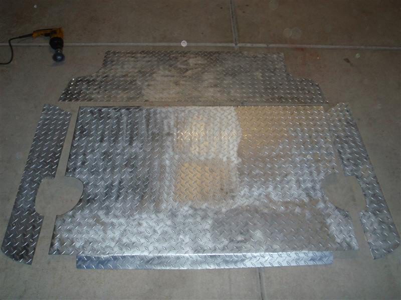

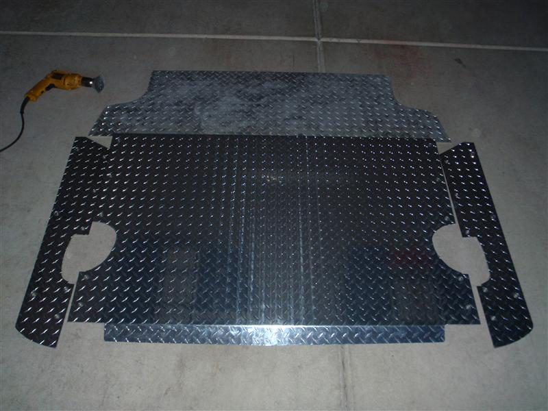

    Received my trunk for the JKU. This trunk mounts where the hard top mounts and covers the entire rear deck. The first picture shows most of it in polished aluminum. The second picture shows it de-blinged. Remaining items are to clean it with mineral spirits, prime it with self-etching primer, paint it black, and then install. πŸ˜€

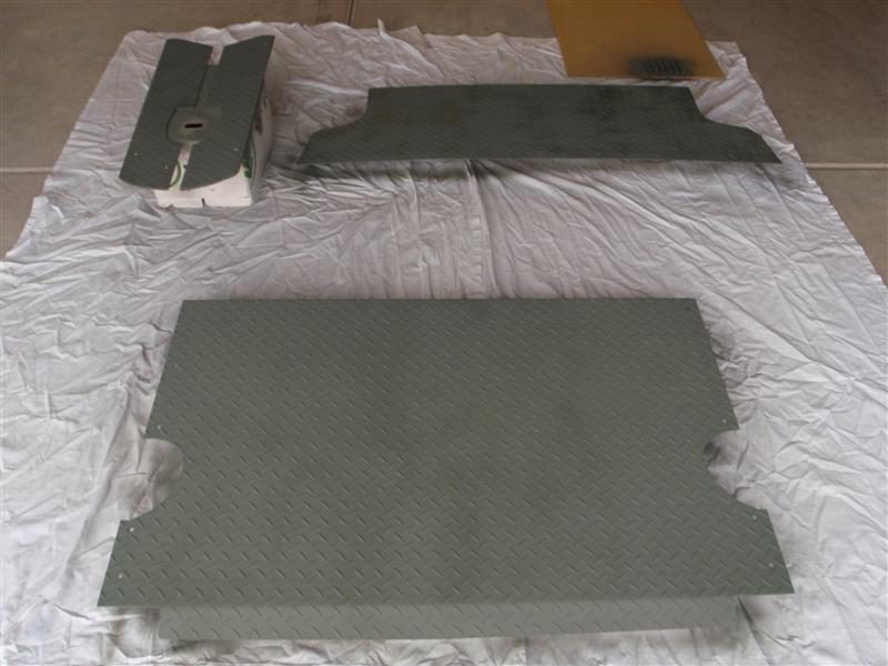

    Primed!

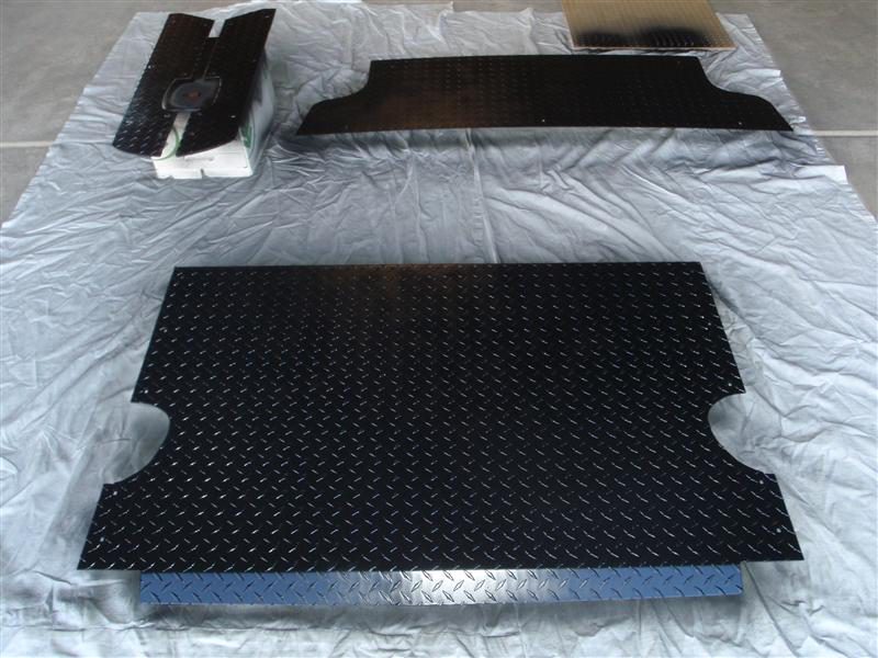

    Painted!
  9. Fred Subscriber
    #96 Sep 2012, 7:36 PM
    "kevheb" wrote: Painted!
    Looks great
    #106 Sep 2012, 9:43 PM
    Family gear and/or 4x4 gear storage. 😎
    Will we get to see it on the 13th kevin?
    #117 Sep 2012, 5:06 AM
    Nice job on the prep and paint 😎

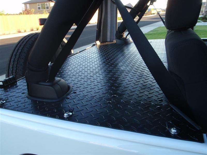

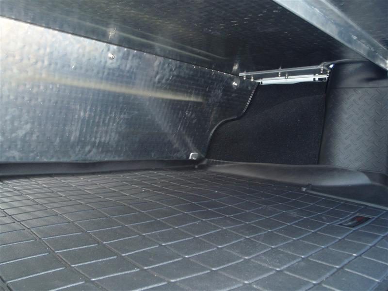

    #148 Sep 2012, 10:09 PM

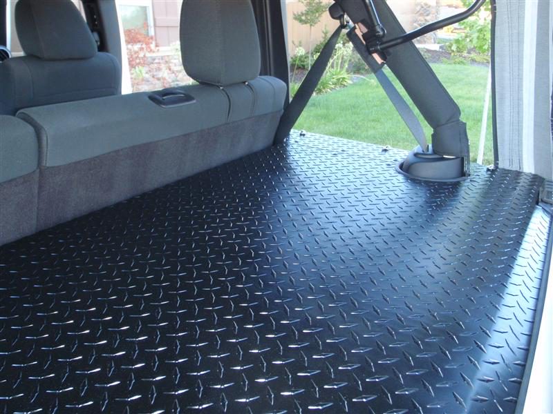

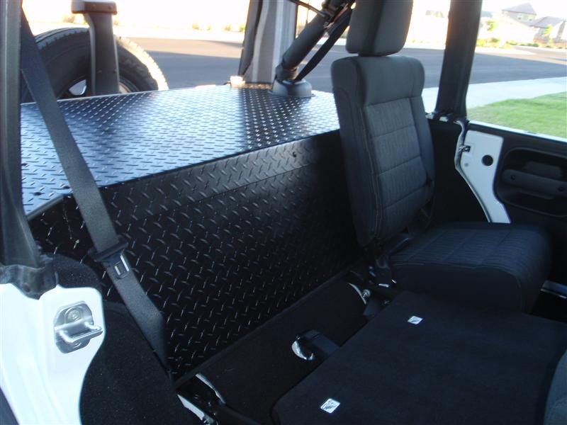

    Installed!

    Looks pretty awesome! Is there a load rating for it? Could you mount a rack on top for example?
    #178 Sep 2012, 10:19 PM
    That looks really, really cool 😎

    #188 Sep 2012, 11:52 PM
    looks pretty cool!

    "BKGM Jeepers" wrote: Looks pretty awesome! Is there a load rating for it? Could you mount a rack on top for example?
    I was thinking of mounting a rack at some point. I was told it can hold over 300lbs on top. Here's a pic with two guys standing on one...
    http://www.jkowners.com/forum/showthrea ... 645&page=4
    I highly recommend getting the hard top retainer nuts. They make the install much easier.
