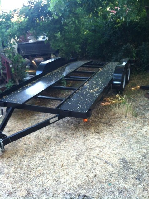

    Unfortunately, today I didn't get much pictures taken. I did manage to take a picture of my new trailer.

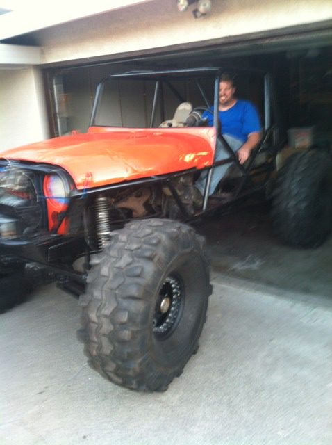

    I did get the tires mounted on the juggy. But before I could finish cleaning everything up my helper stole the key and took it for a spin.
    I ran around all day trying to find tie downs for my trailer. I had the worst time finding a place that had 4 of the same kind or even a place that had 2 of the same kind.
    Still need to do the skins on the sides and I plan to add a rock rail. But for now I'm going to focus on getting my trailer set up with drive over fenders. The new wheel and tire combo added some width to my rig that I didn't plan for. So now my trailer needs modding. I hope to get it all done for this weekend. I'm planning to be on the Rubicon Saturday and Sunday.

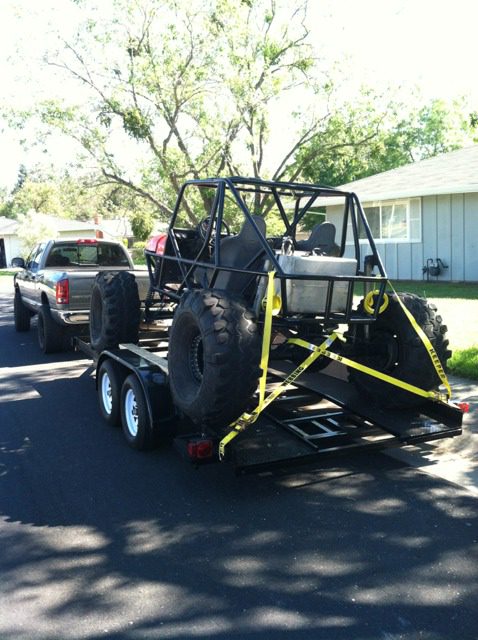

    Loaded and ready for its first real trip. I can't wait for the morning.
    #3420 Jul 2012, 8:15 PM
    I just came from up that way, fishing at Silver Fork. I must have seen about a hundred rigs headed up there. It's going to be a zoo.

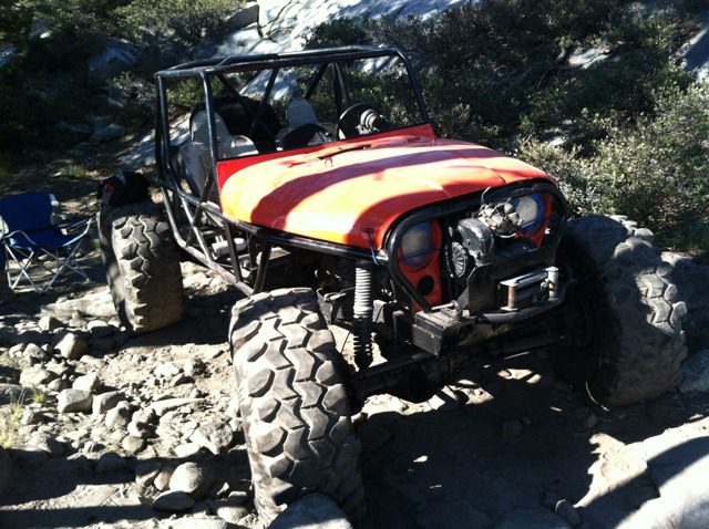

    Just got back from the weekend and there are some hiccups that need to be worked out.
    1. The juggy idles great here at home but when I got up to the trail I had to keep my foot on the pedal to keep it from dying.
    2. It starts great at home. Took a lot to get it started on the trail. I dreaded turning it off in fear of it not starting again.
    3. My gas tank pickup has issues. It has a 30 gallon tank and I ran out of gas on the way out. If I looked down the fill tube I could see fuel in the tank, but it wouldn't start. Added 5 gallons and it started up.
    4. I need some storage space. I need to build a rack or something.
    5. It needs a radio!!!
    #3822 Jul 2012, 7:35 PM
    We fixed the ideal problem and the air flow issue. It did look cool on the trail!!!

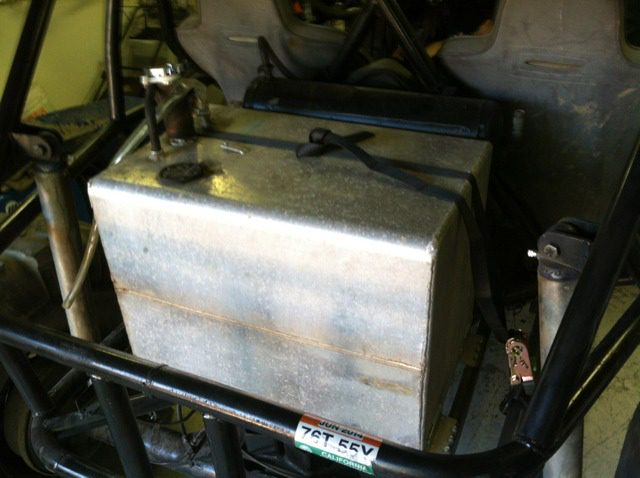

    I had to pry myself away from the olympics but I figured it was time to get some work done on the juggy. Summer is half way over and I still have a lot of places to go before winter sets in.
    I dragged the buggy over to my brothers house to try and figure out the issues with the fuel tank.
    I know you guys like pictures. We pulled the lines to the tank and we looked into the tank. It was about 3/4s full. So how do I run out if fuel with nearly a full tank? Well, laying at the bottom of the tank was a plastic pickup line. The kid that had it before used a rubber hose for a pickup and tried to weigh it down with a nut on the end but obviously it didn't work. Jeff was able to retrieve the plastic pickup line and was able to use that and house clamps to get the tank setup properly. No more fuel problems hopefully.
