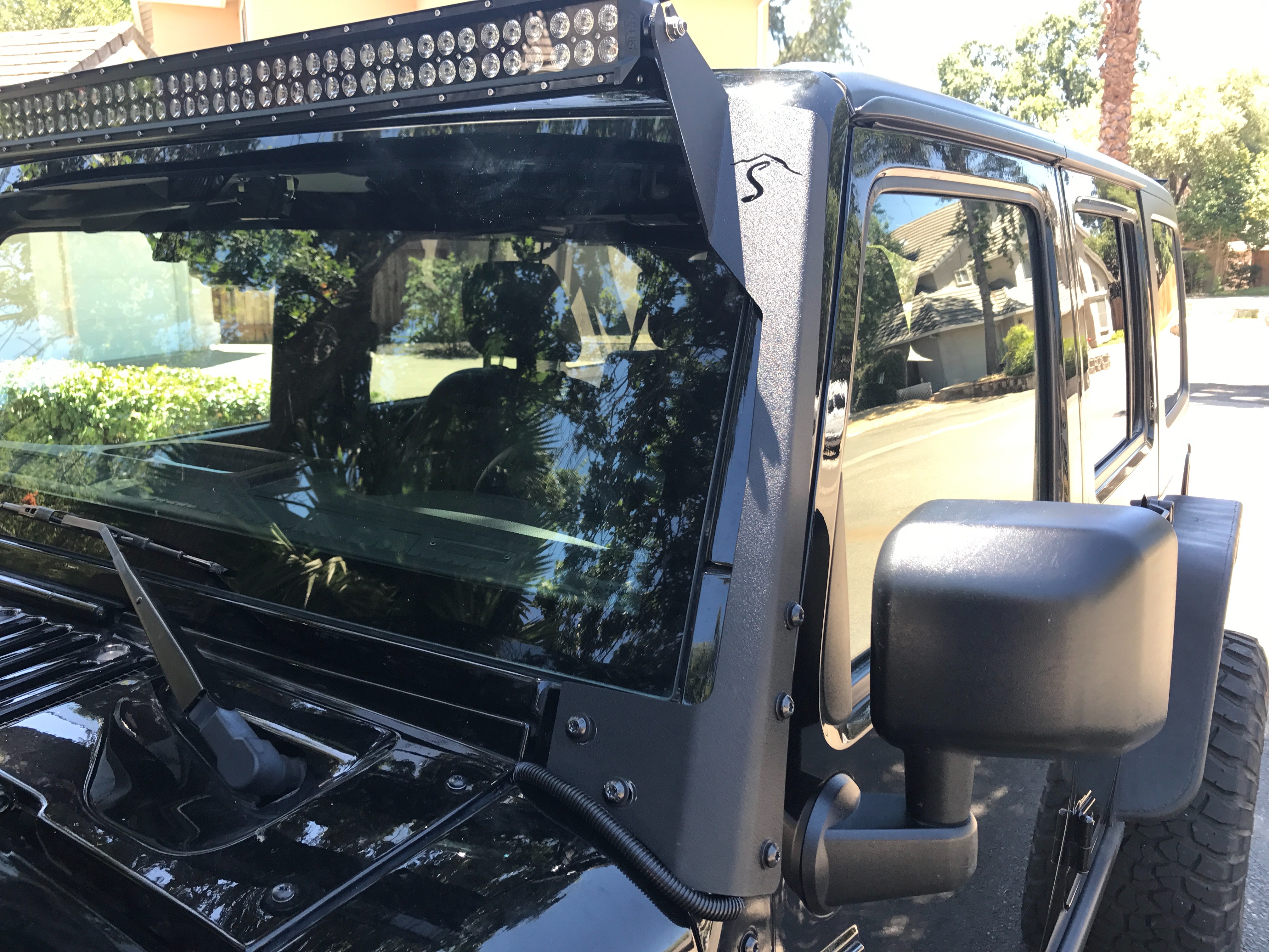

    On a TJ where/how do you run the electrical to the cab once it enters the bracket? Here is the mounting bracket I order. Where the heck does the cord go?

    Jeff_R said On a TJ where/how do you run the electrical to the cab once it enters the bracket? Here is the mounting bracket I order. Where the heck does the cord go?  https://www.hylineoffroad.com/jeep_parts/jeep_tj_led_light_bar_mounting_brackets
    looks like they might have drilled a hole either into the cab or engine compartment, or they found a gap and got it into one of those areaslight-bar.jpg.  i did not want to drill any holes into the body so this was my solution

    #1222 Aug 2017, 2:31 PM
    That looks clean.

    #1323 Aug 2017, 12:46 PM
    Dave, thanks for the picture. After looking things over on my TJ that is probably how I will run my electrical. Now my problem is I don't know where to install the rocker switch. I have 7 rocker switches in my Jeep and no open sockets. Does anybody have any suggestions as to where to mount an additional rocker switch?
