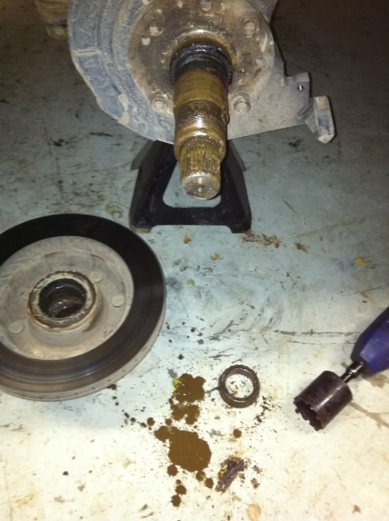

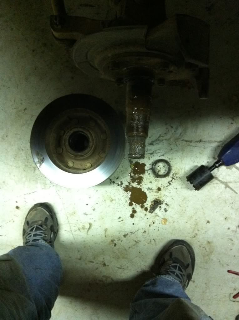

  18. RobD Subscriber
    #4330 Jan 2012, 1:07 PM
    You might want to pull your spindles and check the axle shaft spindle bearings to see if they need to be replaced or grease. They are a pain to punch out if they fry and heat weld in to the spindle. I know by experience!!
    "Path 88" wrote:
    You can take them home and rebuild them over and over and over........
