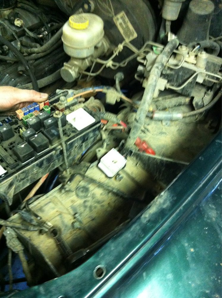

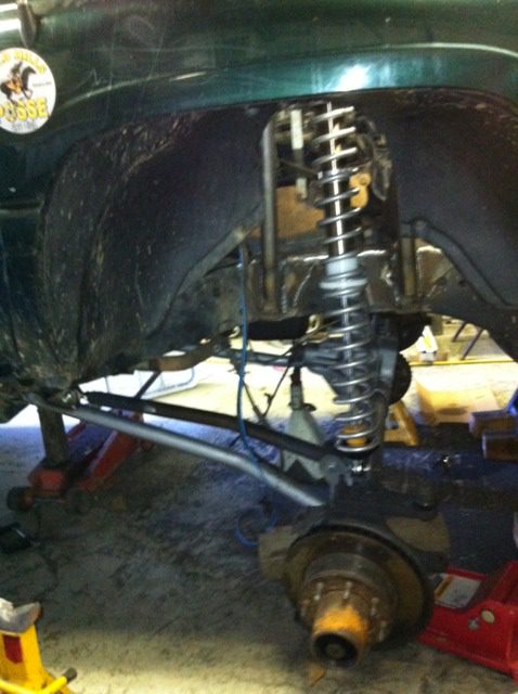

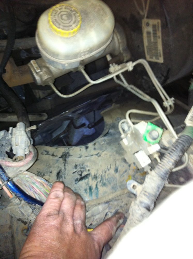

    #287 May 2012, 6:42 PM
    Working on making room for the coilovers. I have to move the fuse box over by the batterie.

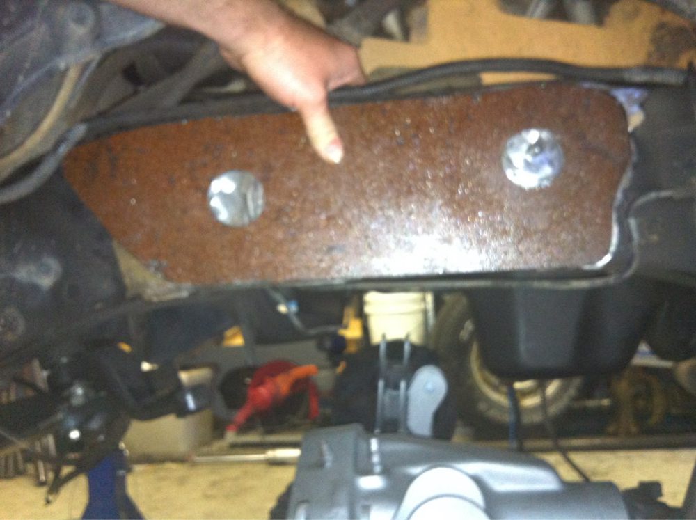

    #298 May 2012, 10:41 PM
    Some frame work and plating.
    #308 May 2012, 11:40 PM
    Looks good. :hack:

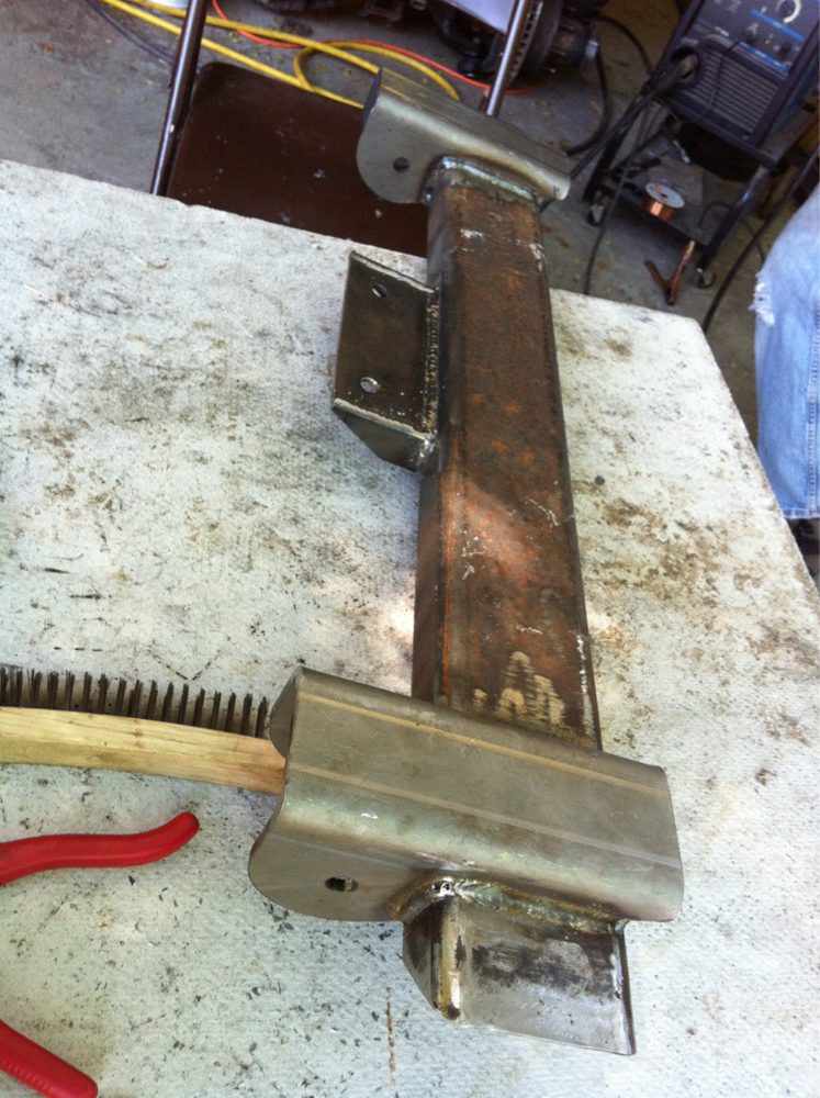

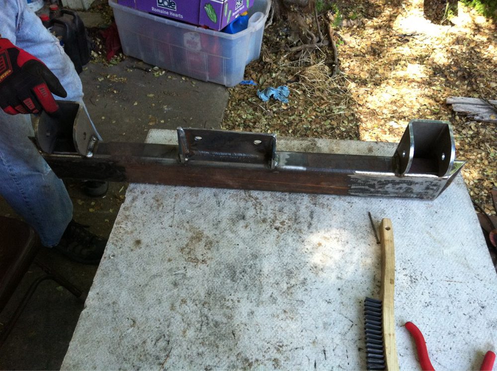

    #3129 May 2012, 11:59 AM
    Built a new crossmember and link mounts.
  7. Tom Subscriber
    #3229 May 2012, 1:59 PM
    Very impressive. Lots of engineering, design and fabrication. Nice work!!
    #3330 May 2012, 10:13 PM
    Jeff is kicking butt on this thing! I'm just the gopher and flap disker. I really like the clearance of the radius arms gained by doing the brackets on the cross member. True clearance test will be with the arrival of the 4-speed. 😀 I'm guess-ta-mating no clearance issues, but it's not like I've cycled suspension on a daily basis. 😲
    I'm betting that his ride height will be in the 8" range.
    So, in addition to that cross member, he was also able to get both lower links set and welded.
    Good job dude!

    #386 Jun 2012, 8:22 AM
    Hey, what do you think about making your cross member bolted to the under side? Make some brackets and drill 'em out.
    Box the inside of the frame, 1/4" plate and gusset to receive bolts, etc.??? This will provide more flexibility/access. Indeed would have to modify the tranny mount that is there already, but that's minor detail. 😀
  14. Jeff- that guy with the foolsize started this Subscriber
    #396 Jun 2012, 11:32 AM
    I thought about it but it's where my links hook up too so I am afraid of it moving to much.
    #406 Jun 2012, 1:59 PM
    "Path 88" wrote: I thought about it but it's where my links hook up too so I am afraid of it moving to much.
    My front cross member is also where my lower control arms mount up. It is bolted and seems to work ok.
  16. Jeff- that guy with the foolsize started this Subscriber
    #417 Jun 2012, 10:14 PM
    I will just weld it up. It does not need to come back out.

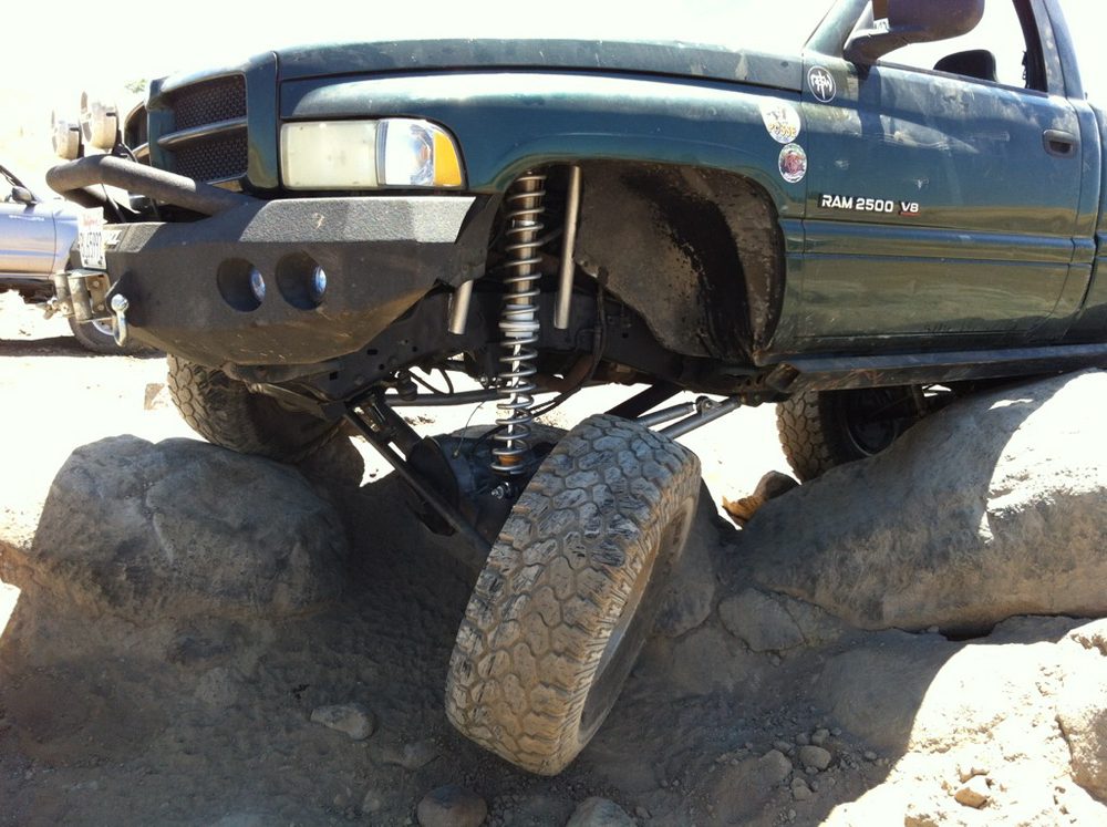

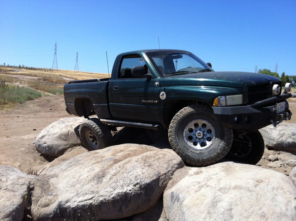

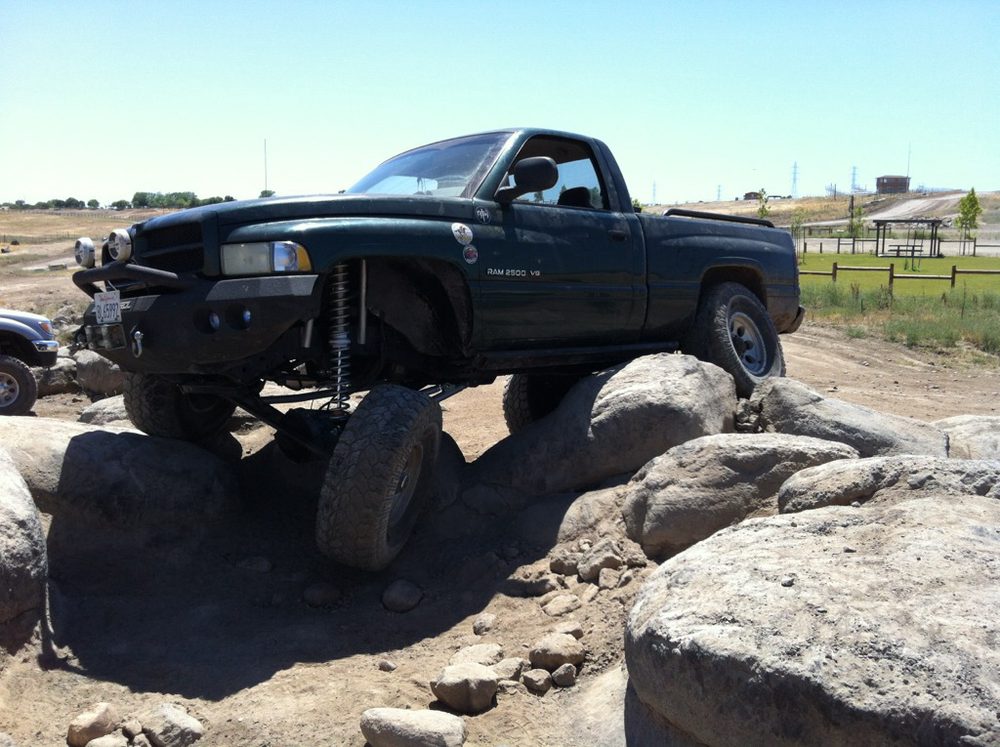

    #446 Jul 2012, 9:15 PM
    I did some testing. I have a few little things that need work.
  20. Tom Subscriber
    #457 Jul 2012, 8:30 AM
    Man, that looks soooooooo COOL!

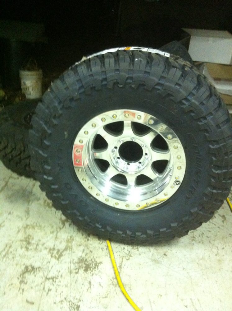

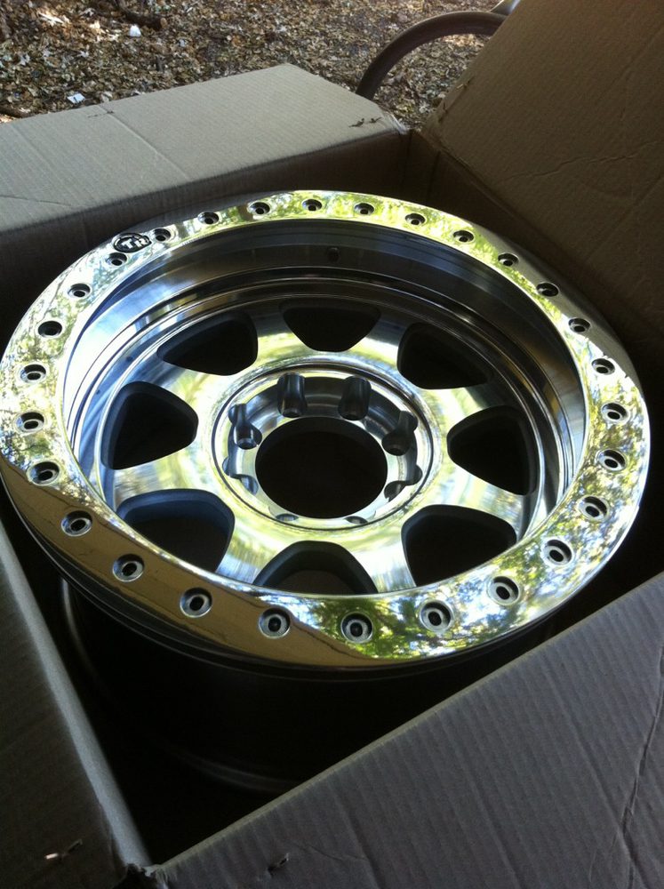

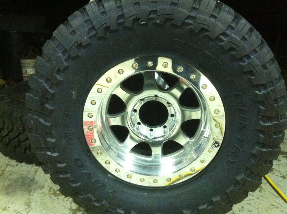

    #4629 Oct 2012, 9:56 PM
    I got my new rims today. It took me about 4 hours to get them all mounted and torqued to spec. I am very happy with the set up. We will have to see how they are on the truck.

  23. Tom Subscriber
    #4830 Oct 2012, 7:31 AM
    Man, those are BIG!
  24. Josh Subscriber
    #4930 Oct 2012, 9:12 PM
    Nice rims Jeff. What brand did you go with?
  25. Jeff- that guy with the foolsize started this Subscriber
    #5030 Oct 2012, 10:32 PM
    They are 40" toyos on 20" trailreadys
