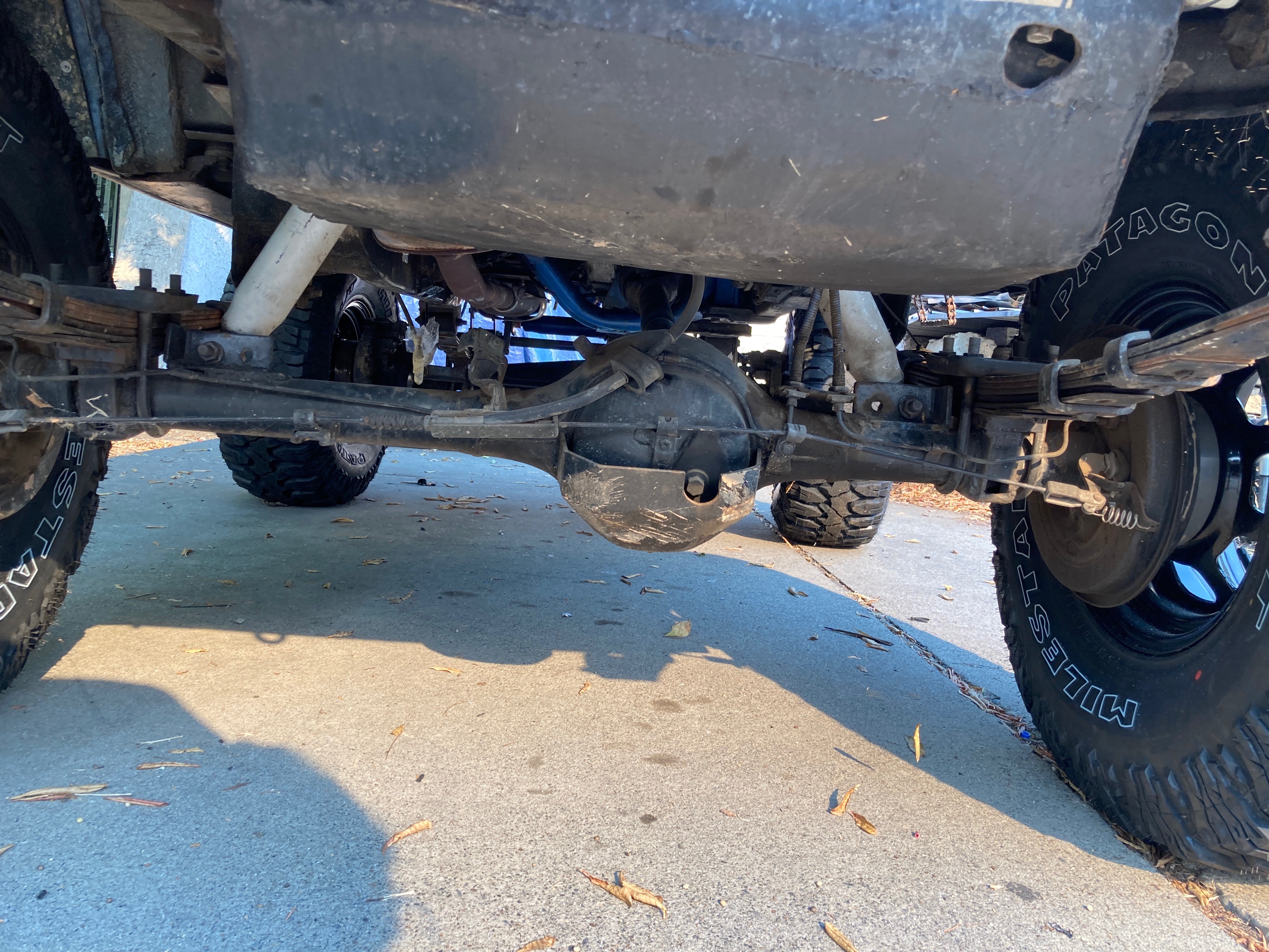

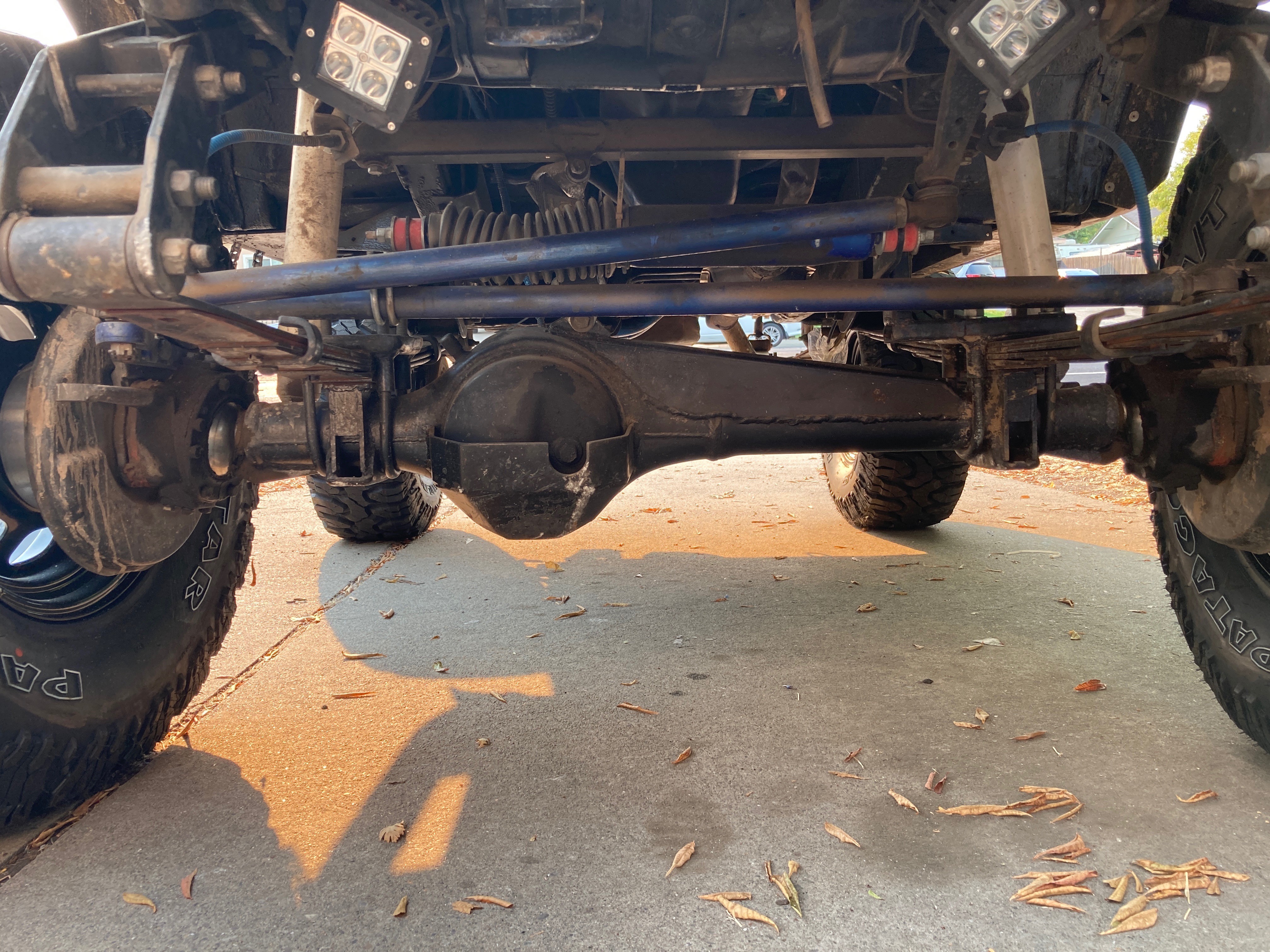

    The Samurai Axle is spring perch's are at 28" and front brake backing plate measures 48" looks like the face of the rotors are around 51".
    The one main of advantage of the Toyota axle is that the diff/carrier will come out as a unit so can take to shop to be set up and not have to take complete axle assembly.

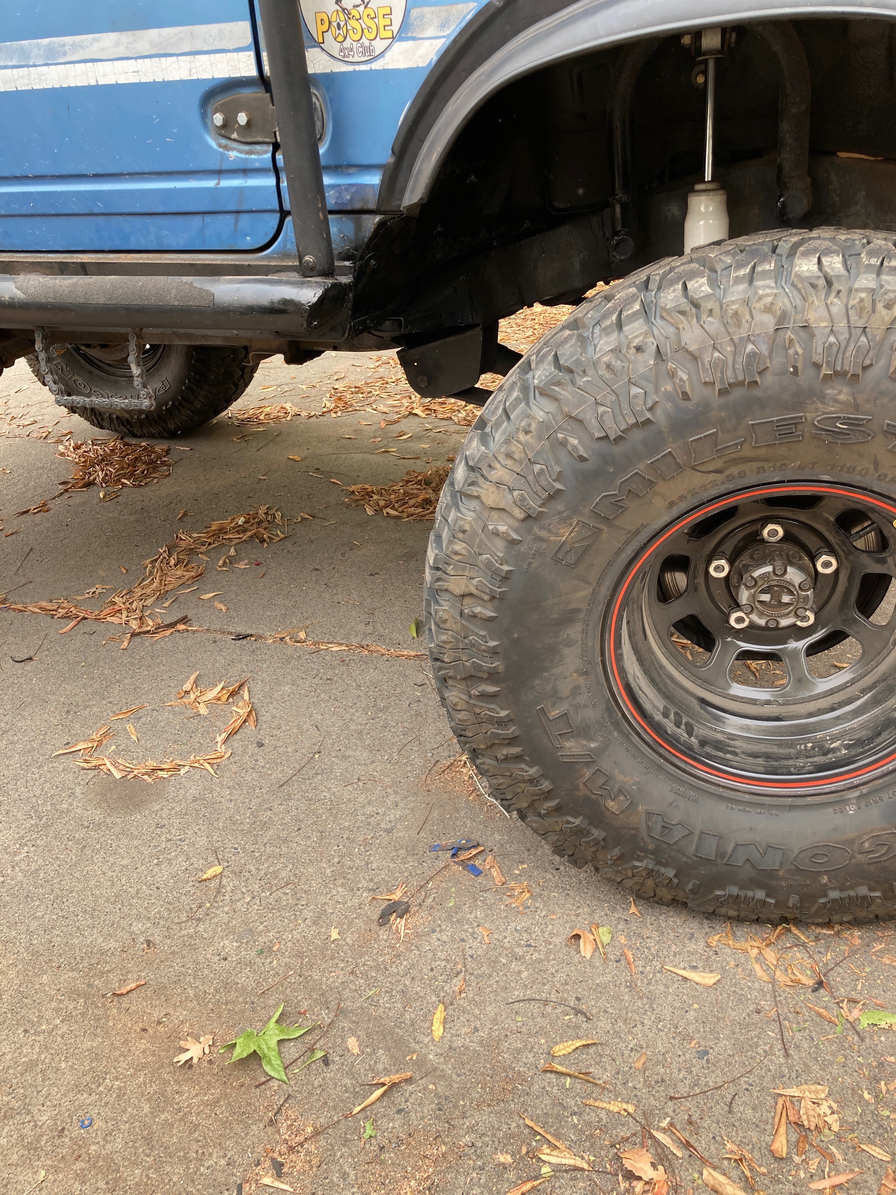

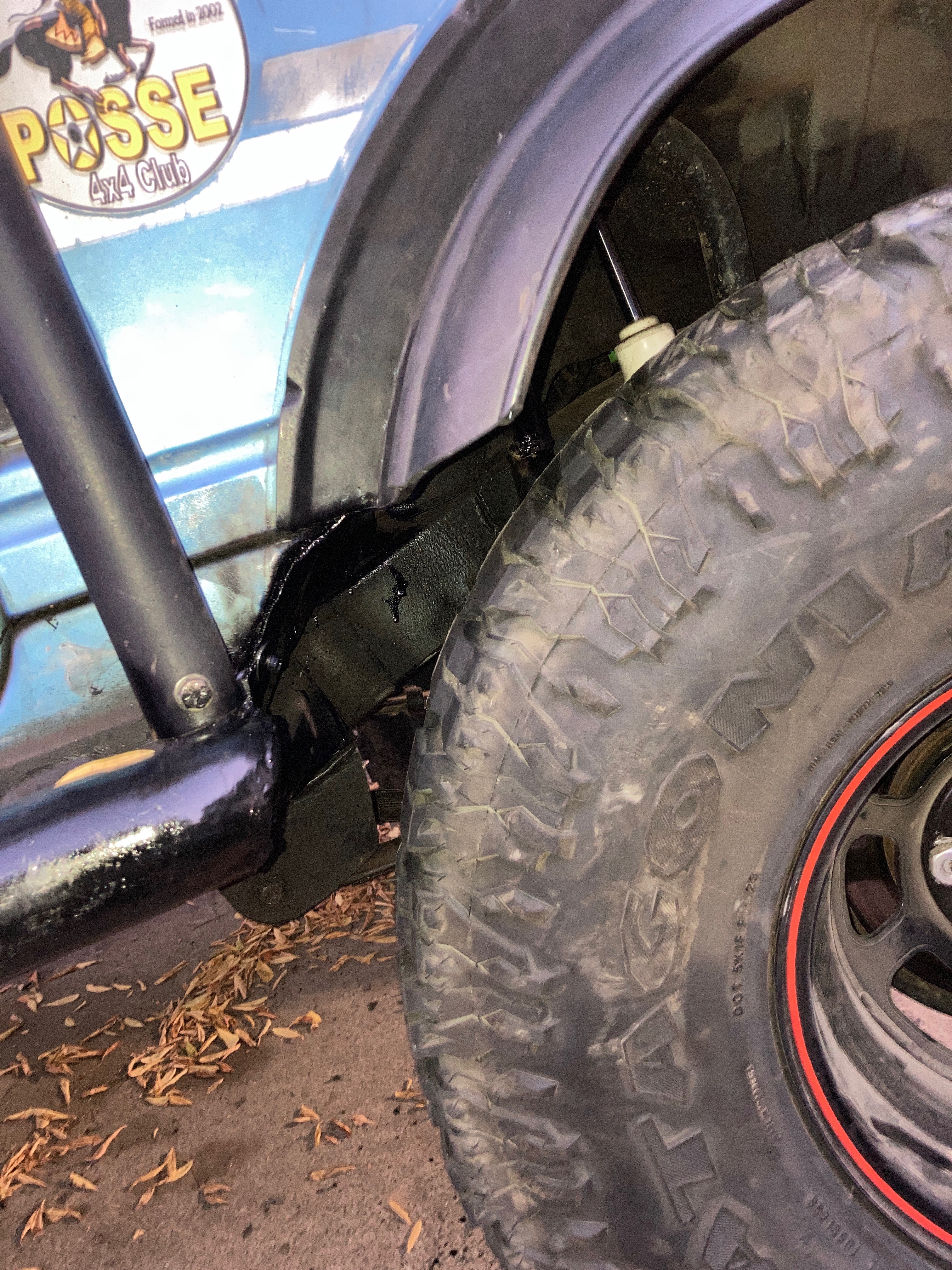

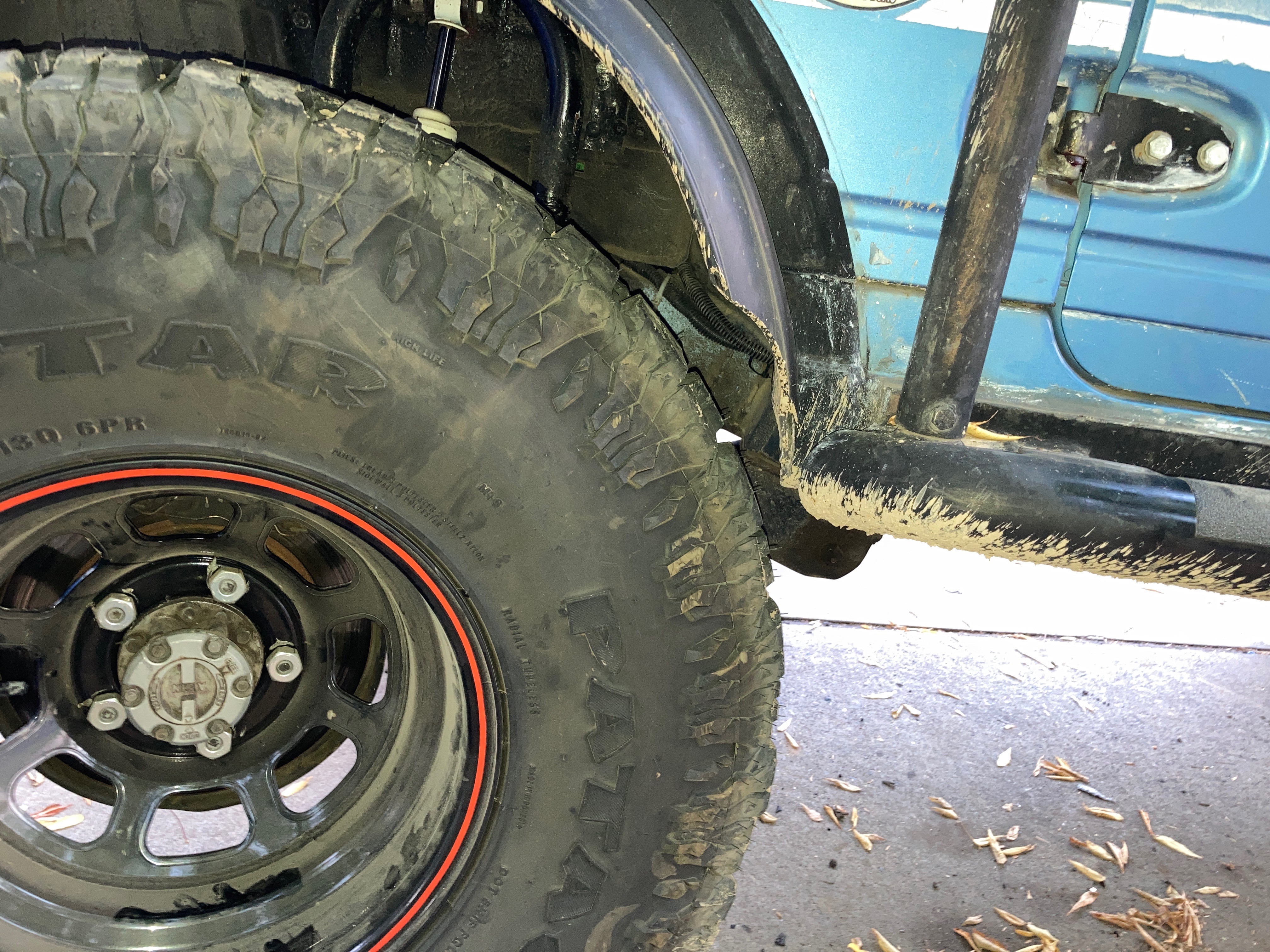

    Well after the Prairie City Tire test, Had some rubbing issues. When The front compressed in a turn the Tire corner rubbed the body. IMG_0857.jpgSo did a little mod and made clearance for the front tires. IMG_0865.jpgIMG_0896.jpgIMG_0895.jpgIMG_0894.jpg

    NICE!  What about simply adding a bumpstop in the rear right before body contact?

    I believe that when I trim the rock slider and the body there on the rear corners, that I will have the clearance so that a bumpstop won't be needed. But we'll see after the rear body trimming, will do another tire test at PC to see. Then if I do i can add it. If I don't then it's just a little more flex available. Also when I build the beefed axle I will put on saddles that move the axle back about 3/4"-1" that should center the tires right in the center of the fender hump.
    What I do need to do is get stiffer shocks on the compression stroke to slow down the body roll on off camber drop offs.
