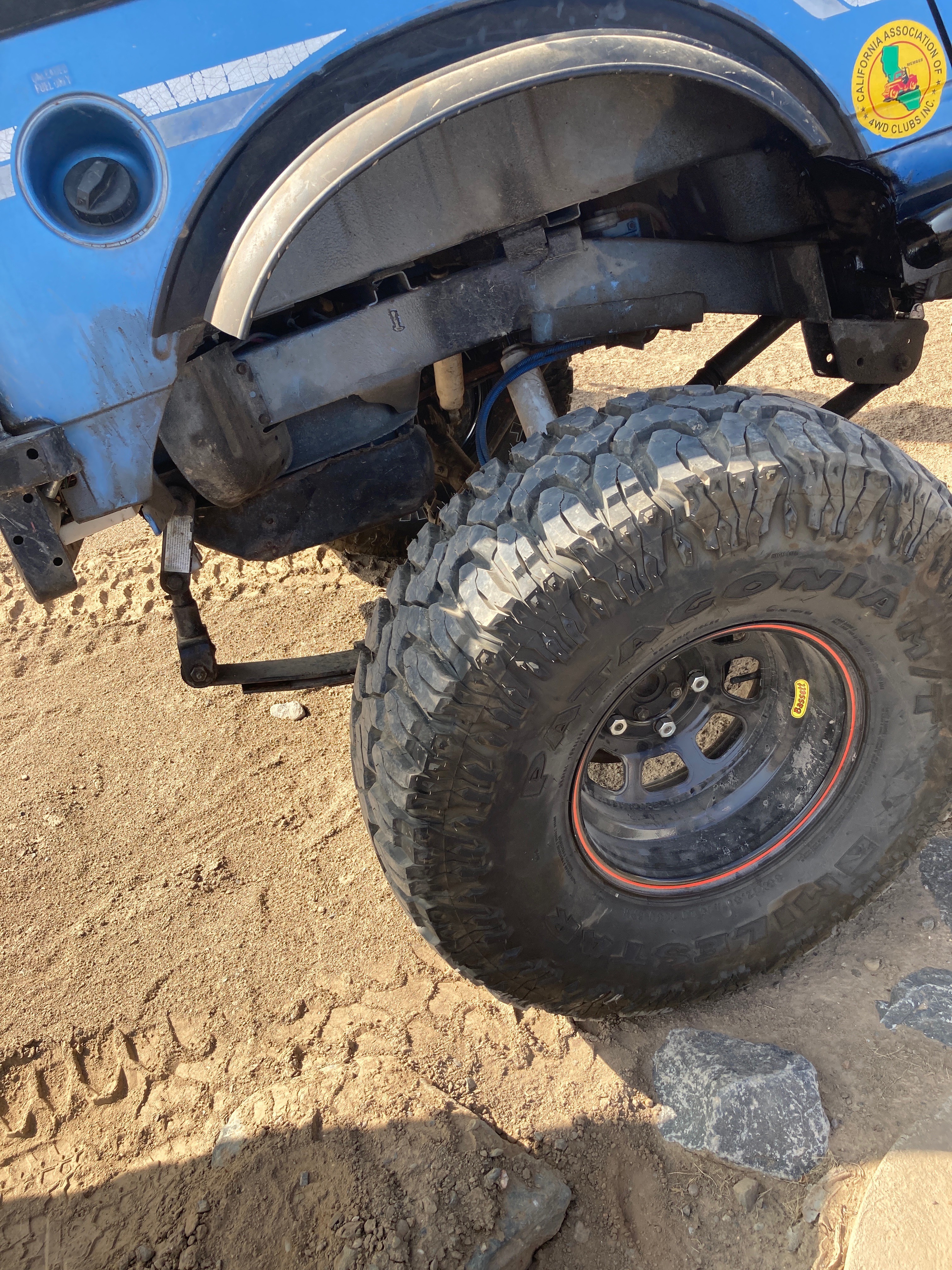

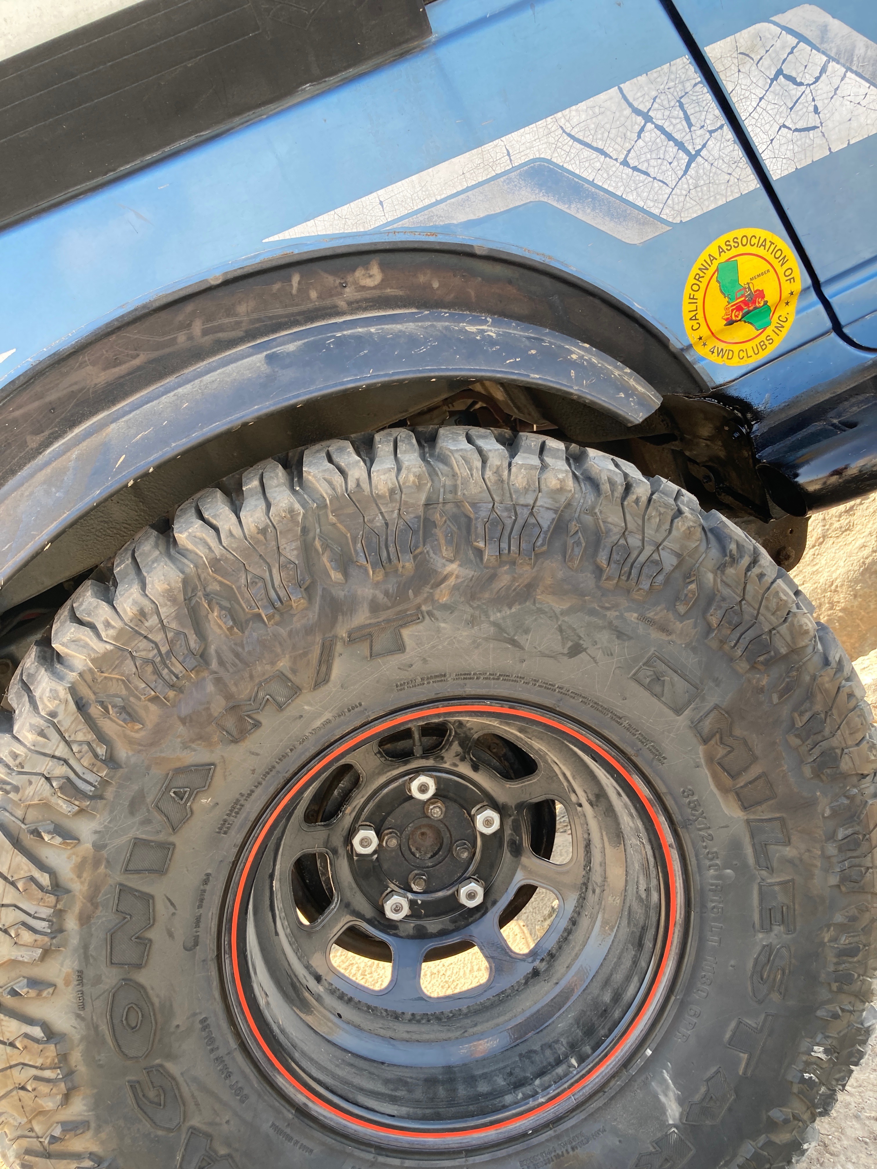

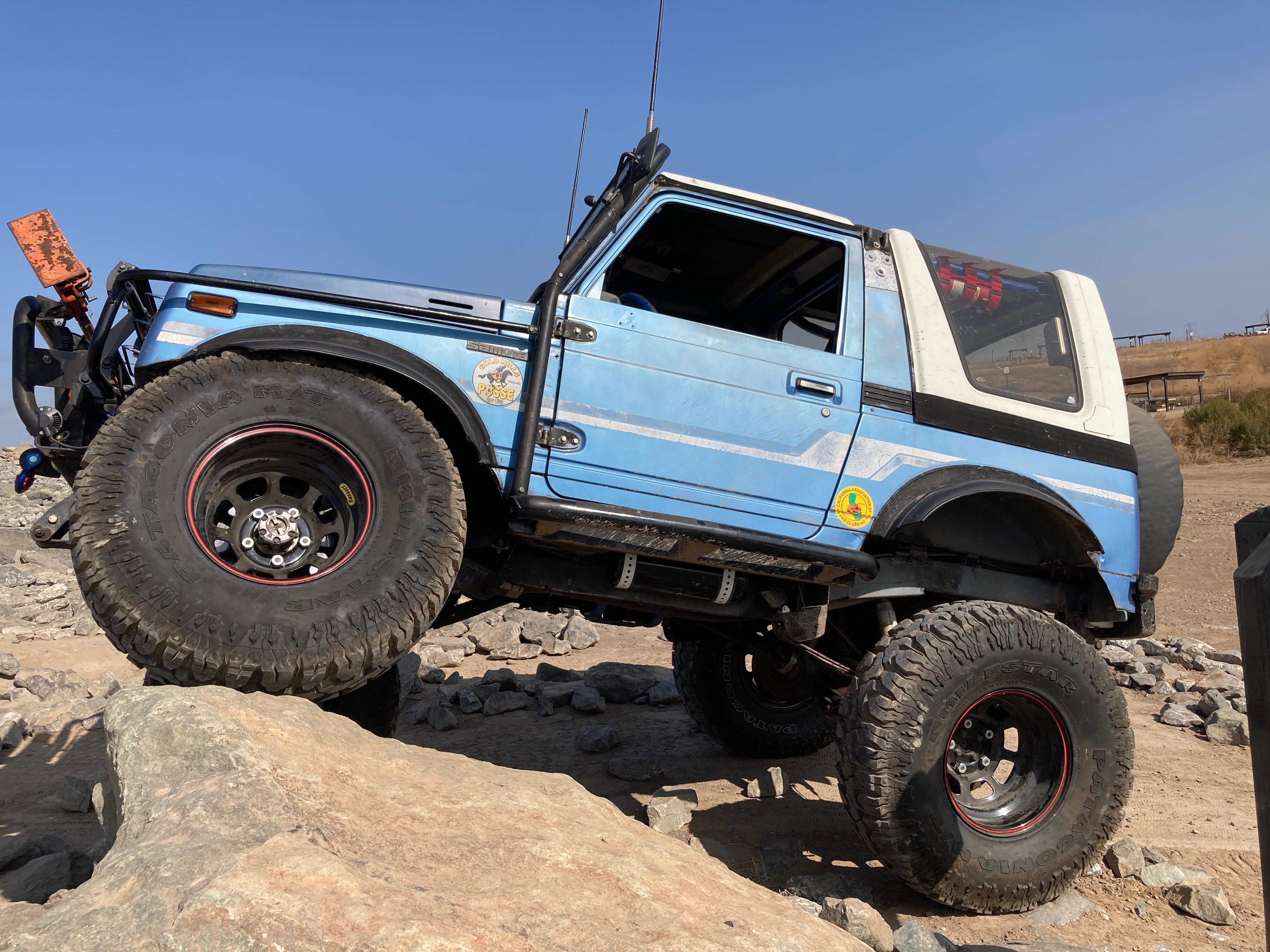

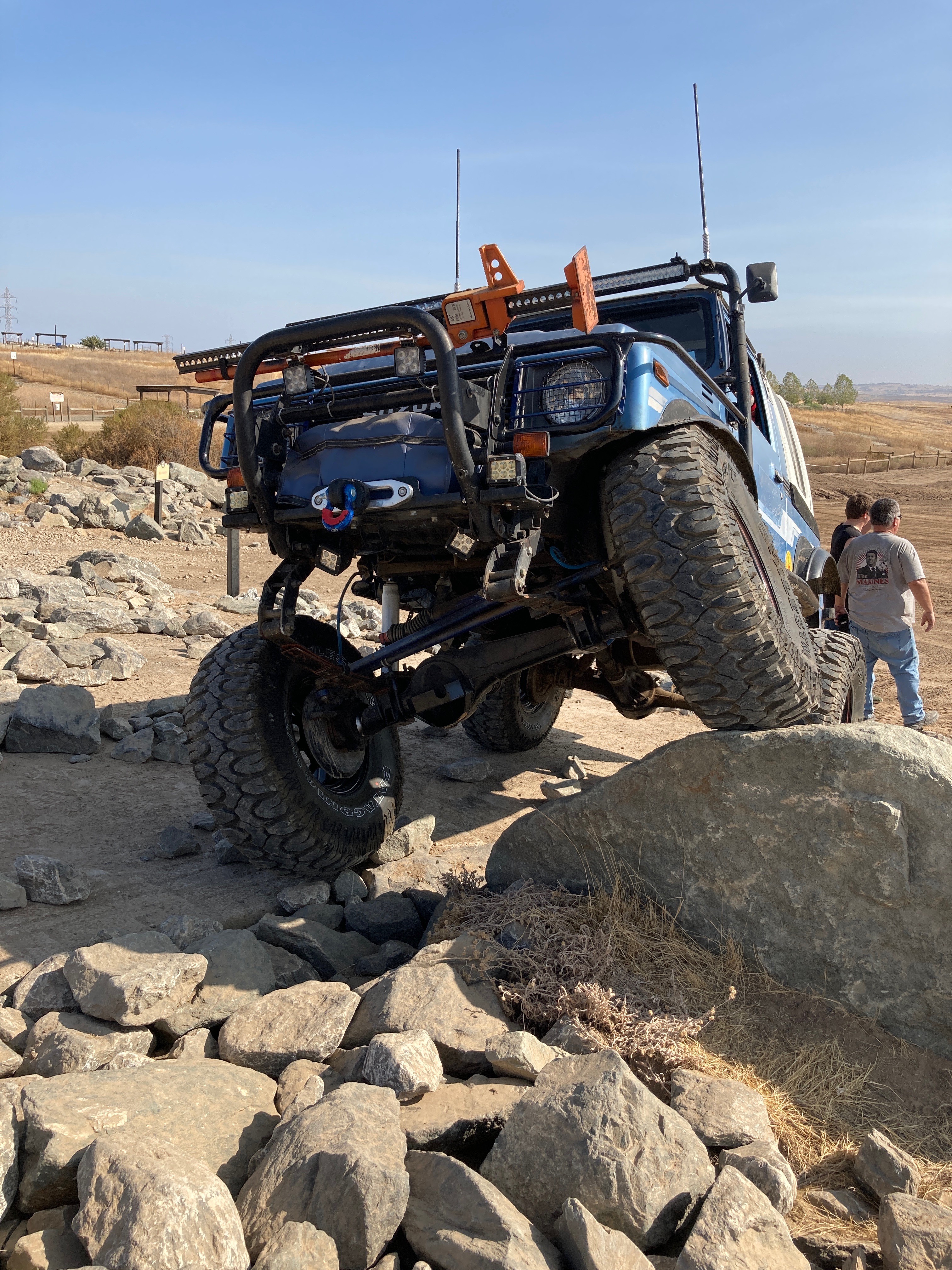

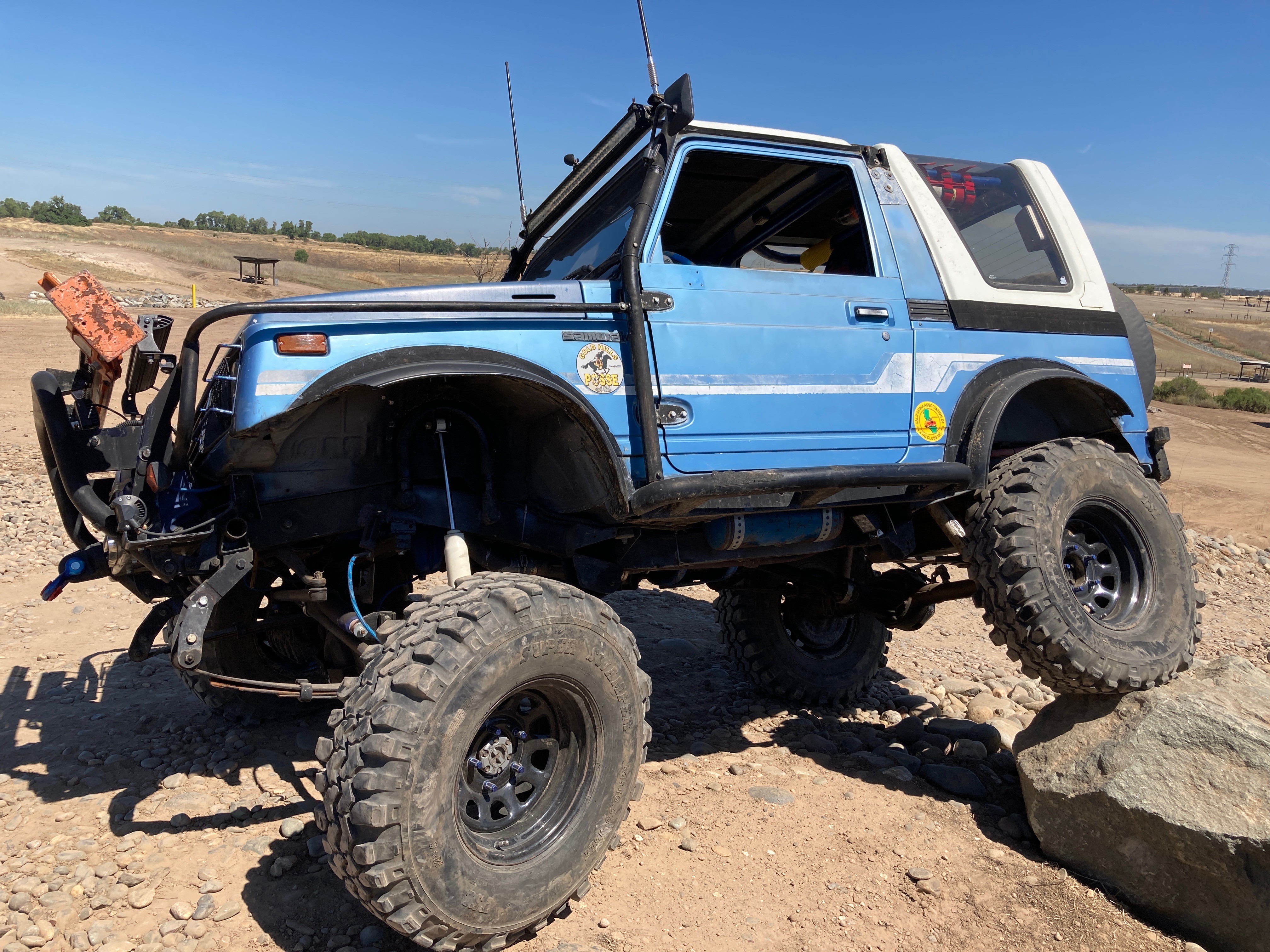

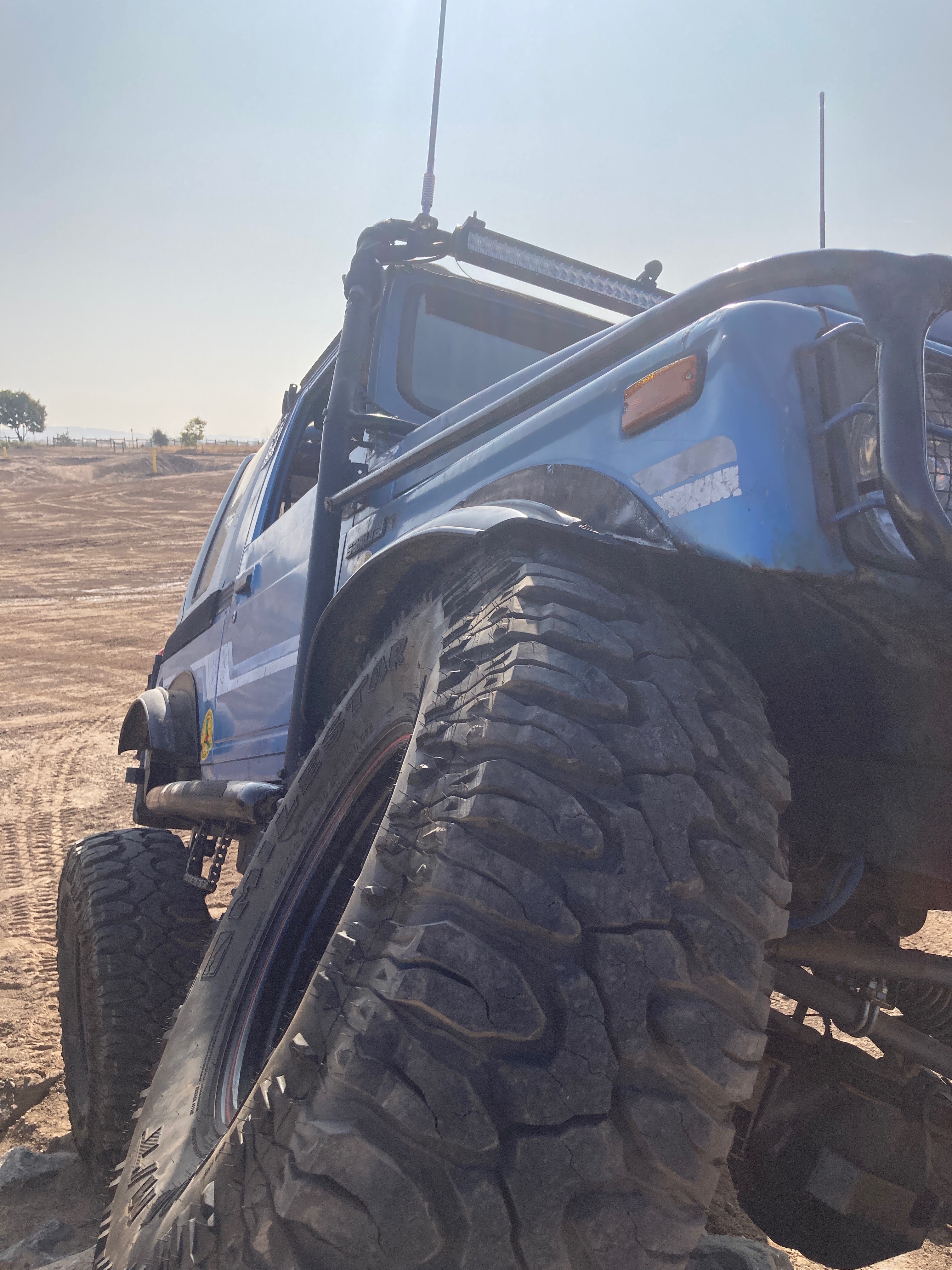

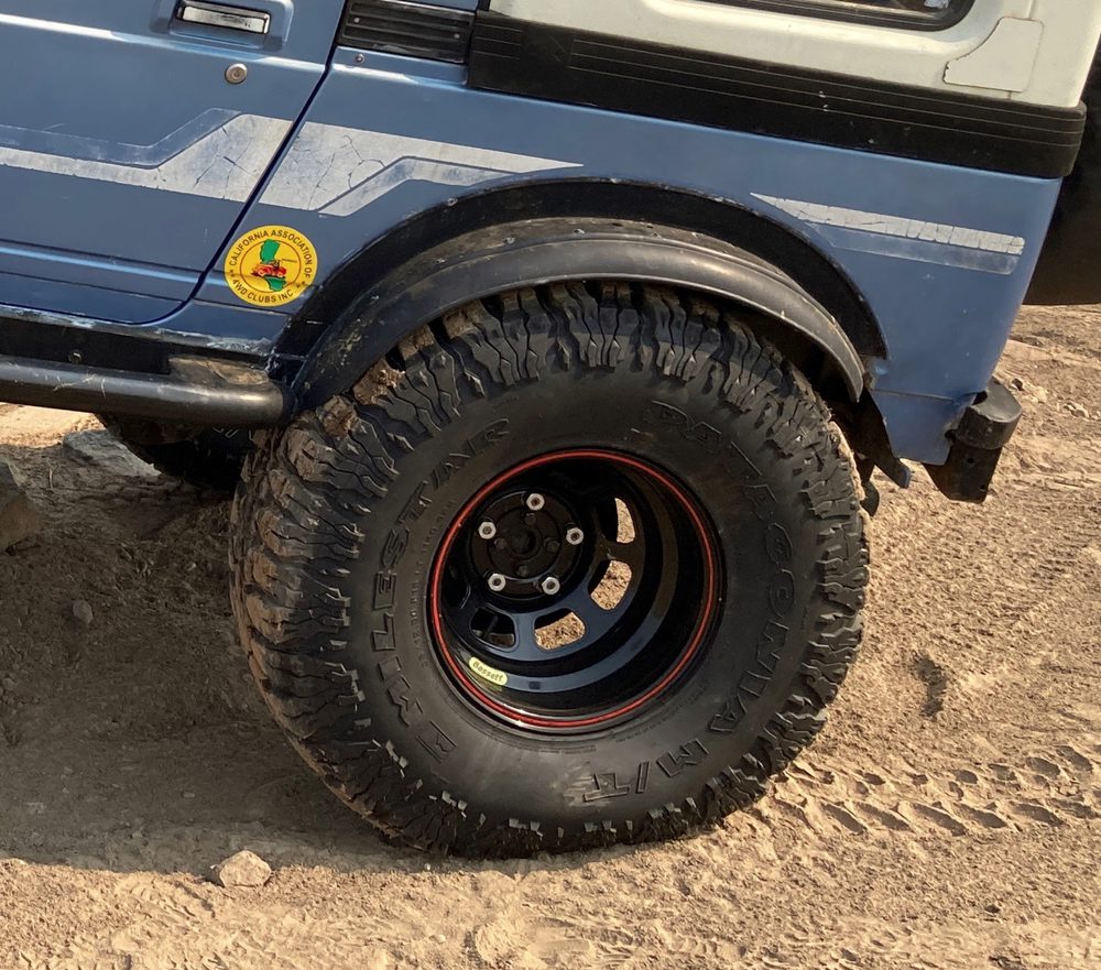

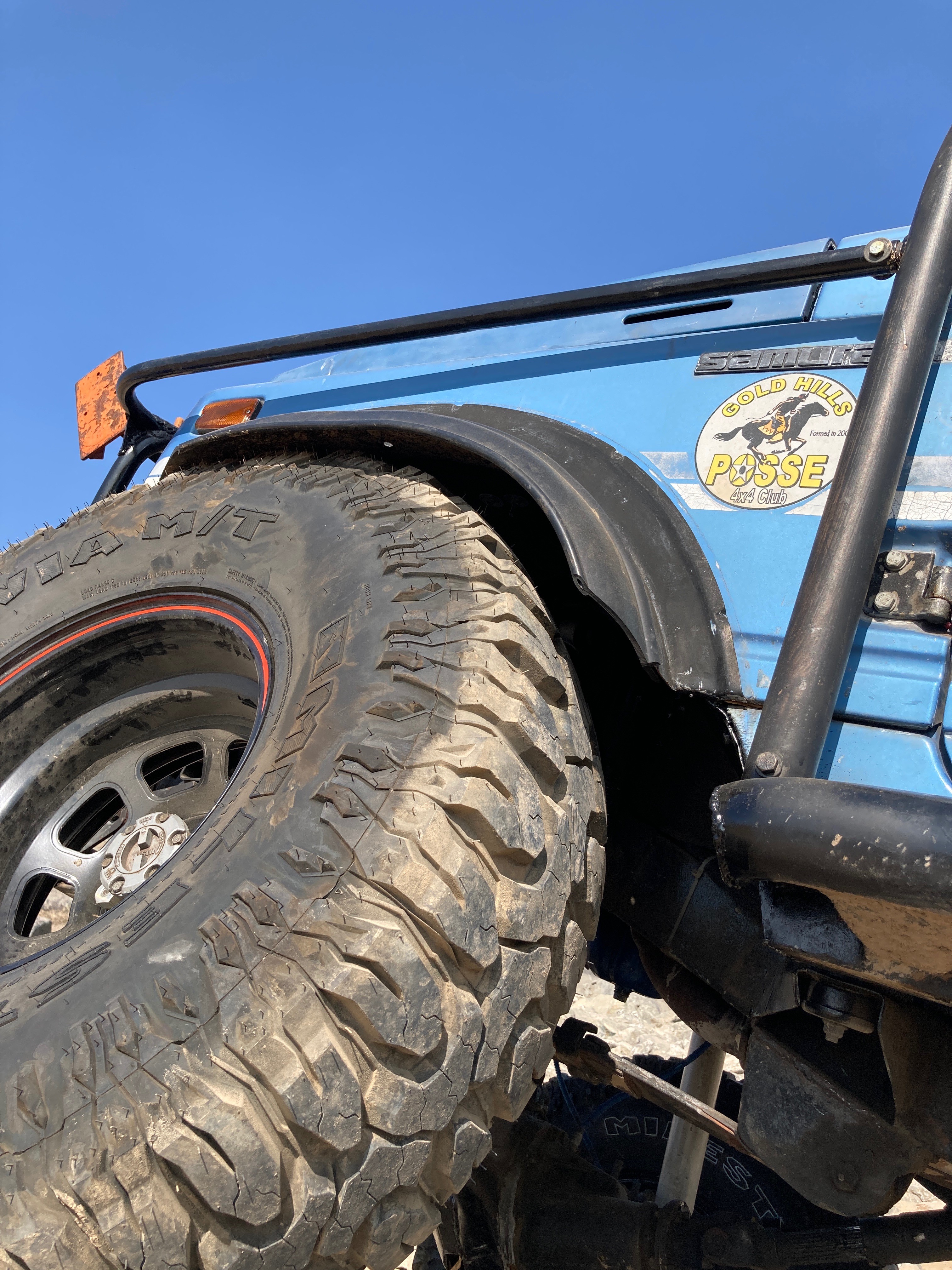

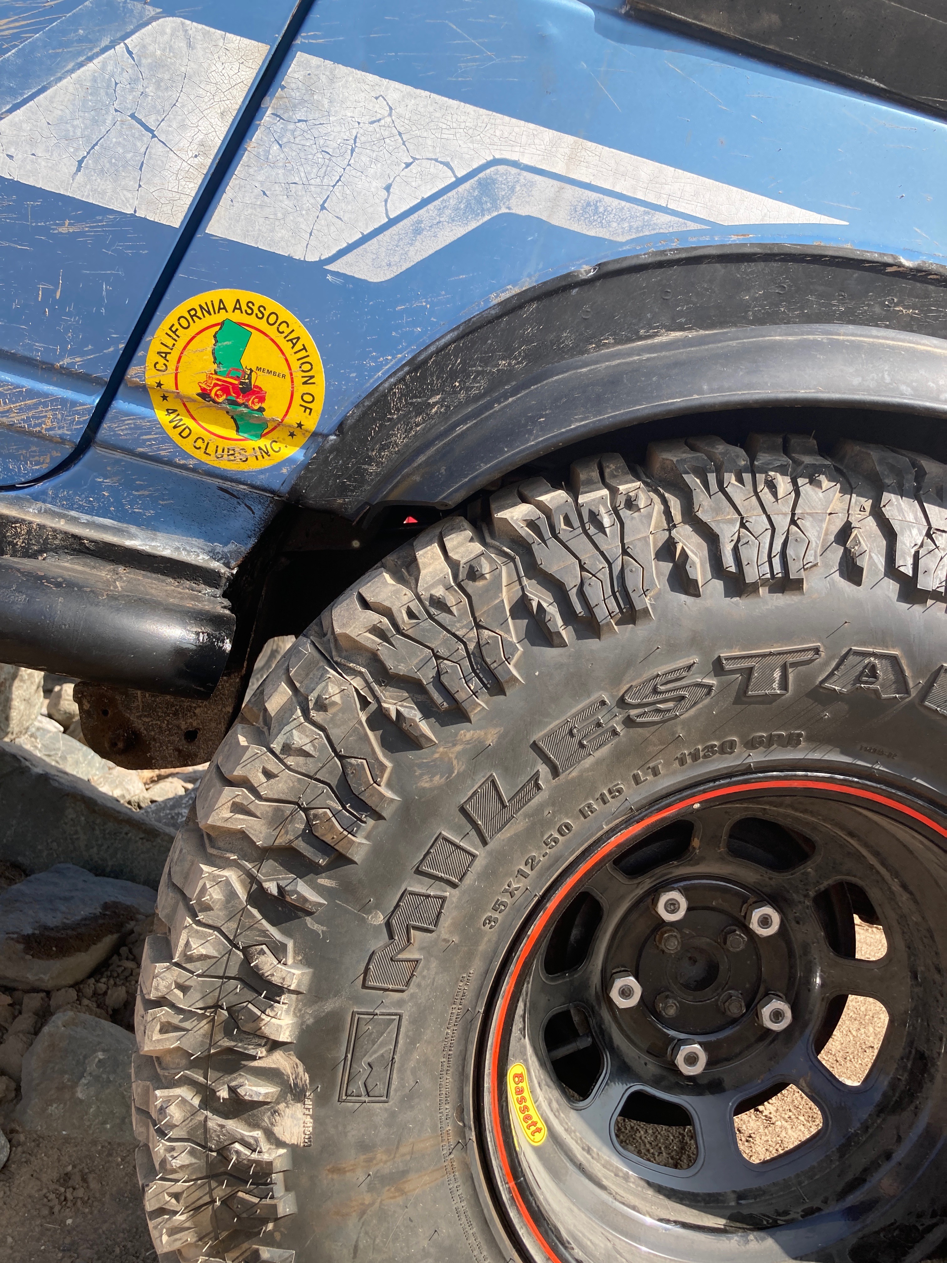

    Well the body/fender mods worked out great. The clearances with it really flexed out I am really pleased with. There is about 1" of clearance on the front with it flexed up. The rear has about 2 1/2" of clearance. IMG_0972.jpgIMG_0961.jpgIMG_0960.jpgIMG_0967.jpgIMG_0971.jpgIMG_0969.jpgIMG_0962.jpg

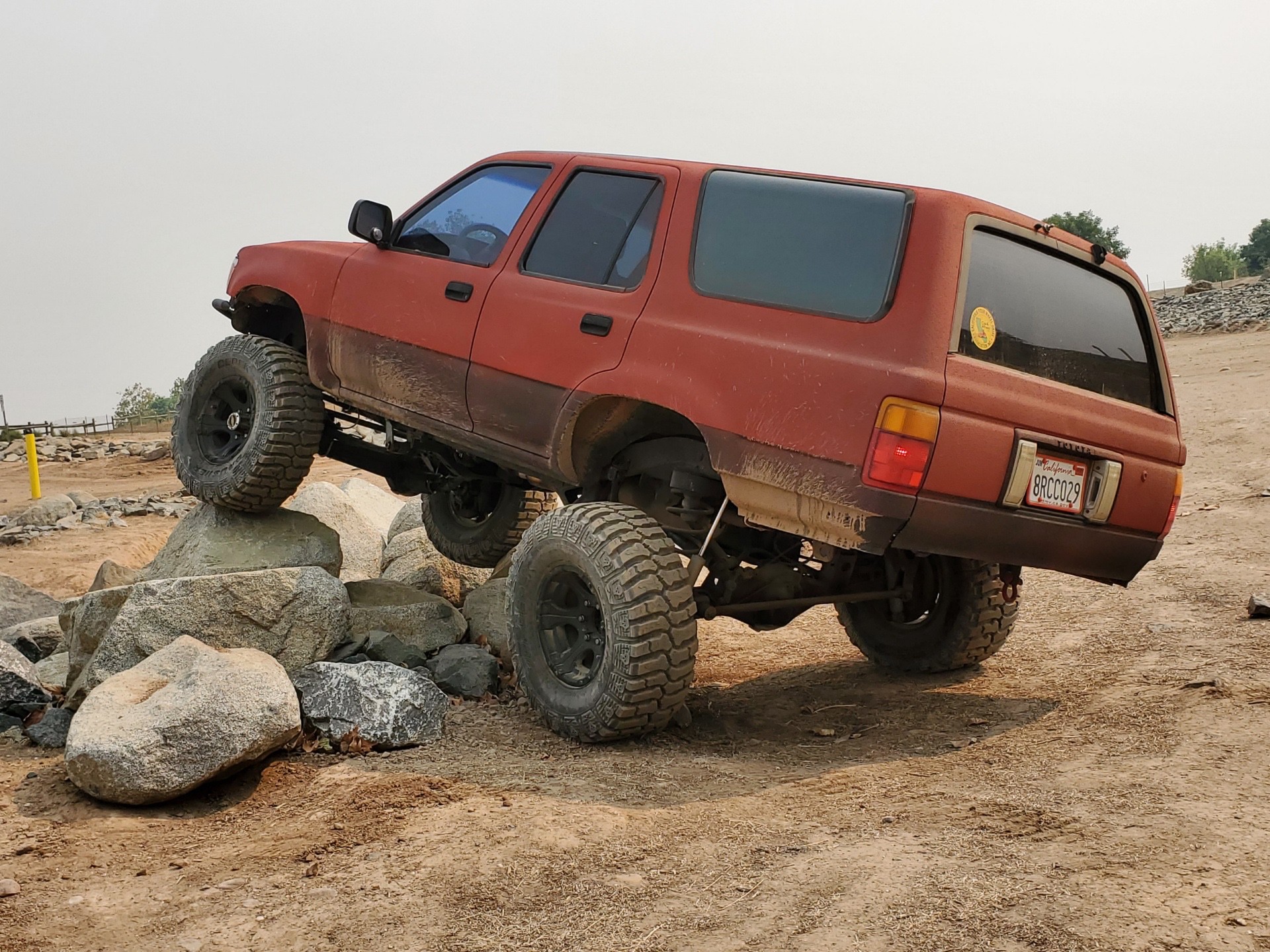

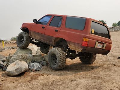

    I dont have any ramps big enough. After you left I did some flex tests like you. I found out the trac bars will make my axles swing back and forth rather than up and down. When I am at max up travel with my rear my front still has another 4-5” inches to go. Very big difference. Im not sure what to do with my rear. I do not think trimming my rear body will do much because my rear is so limited from the trac bars. picture below of what I am trying to explain lol , I am really
    considering doing leaf springs in the rear, but have no idea what to do.0EA64D78-C1BD-472D-AA47-3A9511C277CE.jpeg950C7E9E-F07F-4E1C-B39B-3A665AFAB87F.jpeg

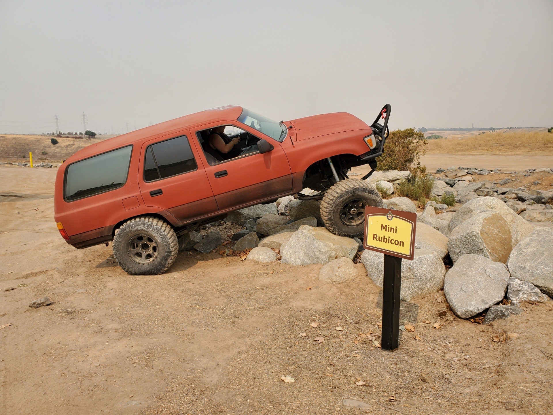

    Sean, With your new Tires just have to flex it out. In that pic look like the axle moves more to the center of the fender hump and away from the body. But are you totally flexed out?  Because your front Passenger is up on some rocks. Need to go to where the front is fully compressed or..... Could back up a rock "slowly" and compress the rear. IMG_0374.jpg Old pic, but like this, to see what it will look like.

    Yeah I was not fully flexed in that one with my older tires. I may get away with bigger spacers on the rear before I go out there to test it, I ordered them today so they should be here this week.

    JigglyJr said I dont have any ramps big enough. After you left I did some flex tests like you. I found out the trac bars will make my axles swing back and forth rather than up and down. When I am at max up travel with my rear my front still has another 4-5” inches to go. Very big difference. Im not sure what to do with my rear. I do not think trimming my rear body will do much because my rear is so limited from the trac bars. picture below of what I am trying to explain lol , I am really
    Adjustable track bar is your best option.  All TJs and JKs you see on the trail deal with the axle shifting from the track bars.  An adjustable one lets you center it.  While leaf springs are better about axle centering and flex-steer, there isn't a trail in the area that is more difficult for track bar equipped rigs.  Especially due to the more reliable flex from proper 4/5 link suspension geometry (and much better ride).  The ultimate fix is to do a double triangulated rear suspension but street manners go to hell.

    I will look into that For sure. I did not even consider that... with adjustable trac bars I  would want to relocate my shock mounts too. Im in no rush for that project, have to buy my wife a truck for our anniversary first before I upgrade my rear suspension LOL.
    thanks for the input!
