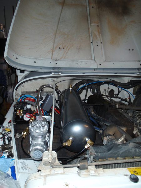

    I'm almost finished with my OBA system. Here's a picture of the pressure test. There were a few small leaks but a little bit of tightening with the wrench fixed that. I still need to trim the mounting plate a little more, give it a coat of paint, and then secure everything into place. When complete I'll be able to disconnect and then remove the compressor, tank, and mounting plate all together if I need to work on the engine. My ARBs will run off the tank as well. I have more pictures that I'll either post later or post a technical article when everything is complete.

    #417 Apr 2009, 11:32 AM
    now i now where to get my air!, nice job. i still have to build a permanent oba. i think ill be using a york. your tank looks like a pretty big one, it just fits.
    some closer pics would be good.

    What did you do with the air intake?
  7. Fred Subscriber
    #717 Apr 2009, 12:38 PM
    "JohnDF" wrote: What did you do with the air intake?
    YJ's air intake is on the driver's side.
    #817 Apr 2009, 1:49 PM
    That would explain it 😁 Thanks Fred

    #917 Apr 2009, 2:51 PM
    It sure would be nice to have all that space available on TJ's too. 😒

    #1121 Apr 2009, 7:40 AM
    is that the permanent position that the tank will be at? Is that a 7 gallon tank? if it is then theres a heck of a lot more room in there than i thought!!! You could fit bender in there and shut the hood with no problem it looks like!! πŸ˜‚ πŸ˜‚ πŸ˜‚

    #1521 Apr 2009, 2:06 PM
    "lowrider" wrote: is that the permanent position that the tank will be at? Is that a 7 gallon tank? if it is then theres a heck of a lot more room in there than i thought!!! You could fit bender in there and shut the hood with no problem it looks like!! πŸ˜‚ πŸ˜‚ πŸ˜‚
    It's the Viair Ultra Duty system and it comes with a 2.5 gallon 200psi tank.
    It's now complete and ready for it's first run on Saturday!
    I'll post more pics when I have some time.
