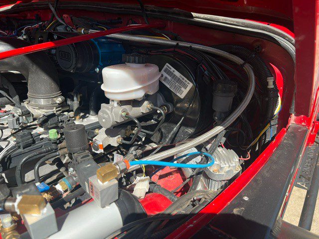

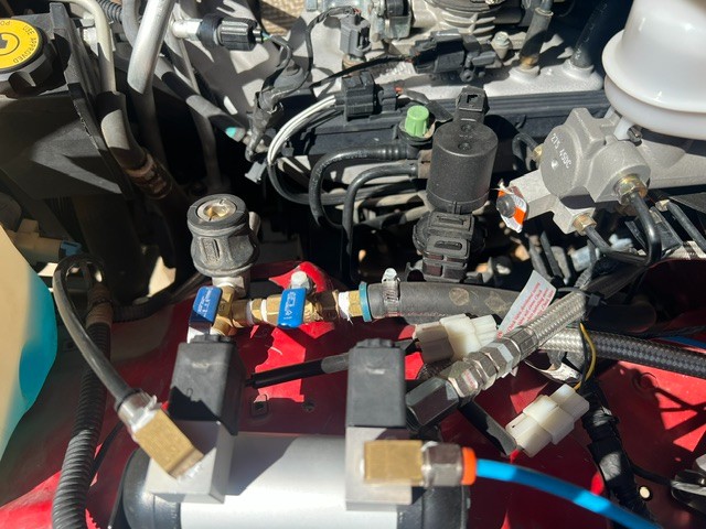

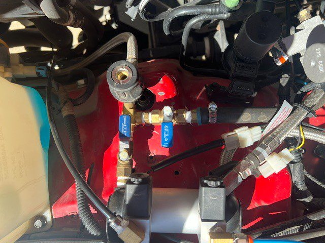

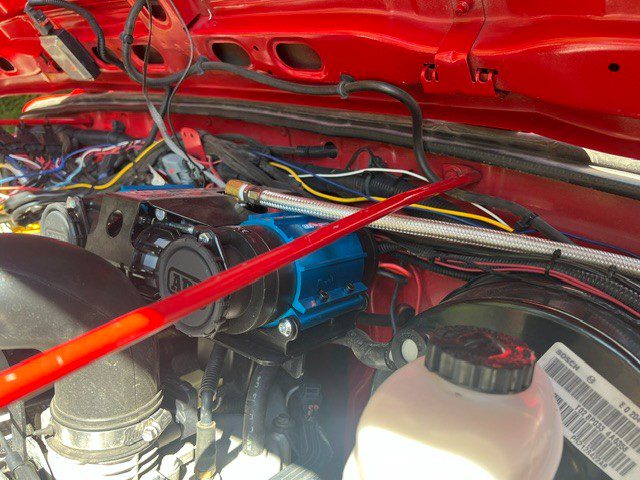

    I put a 2.5 (?) gallon air tank under my TJ. I found I never really needed it. It holds so little air it really isn't of much benefit. I plumbed it so that I could bypass it our use it when I wanted to. I used commercial truck air brake hose for the soft plumbing. I also mounted a quick connect in the hard plumbing in the engine compartment, right off the air compressor and a shutoff just past it, so in case a hose ever failed I could still air up. I also ran a braided line off a tee to the front bumper with a quick connect for airing up. I run my lockers off of the ARB twin and a small ARB manifold kit, which is what WFO recommended. Here is a link to the manifold (see pics in ad for hardware): ARB manifold
    #822 May, 9:01 AM
    Here are some pics:
