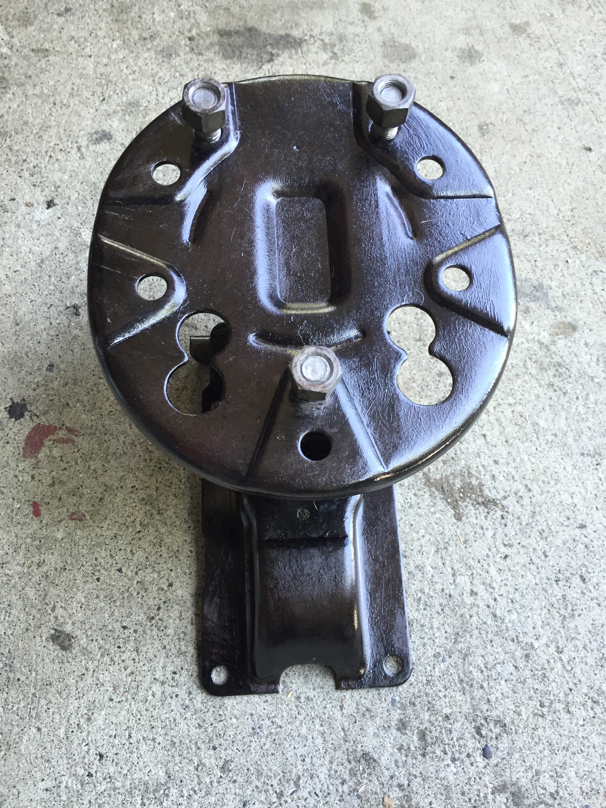

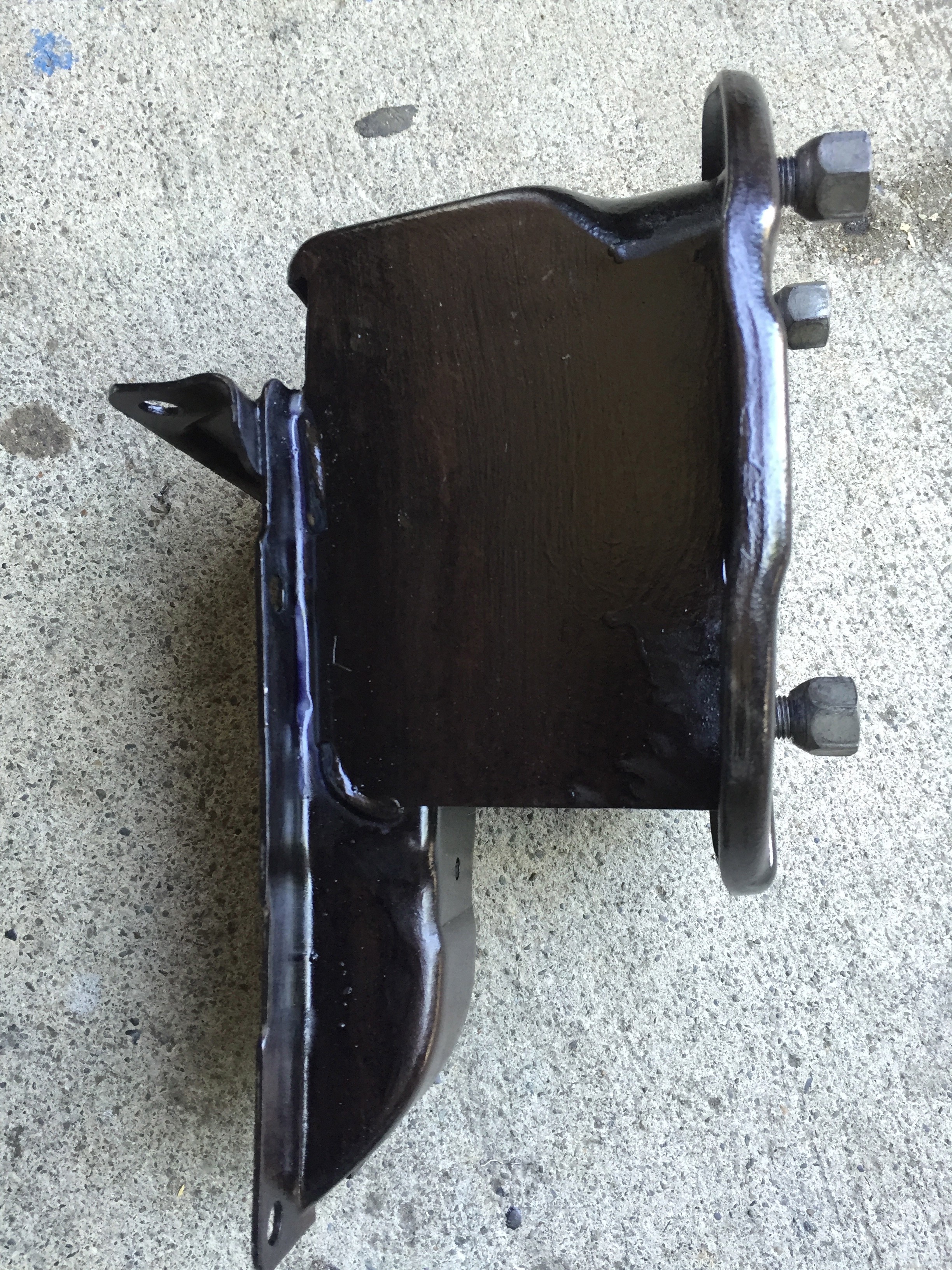

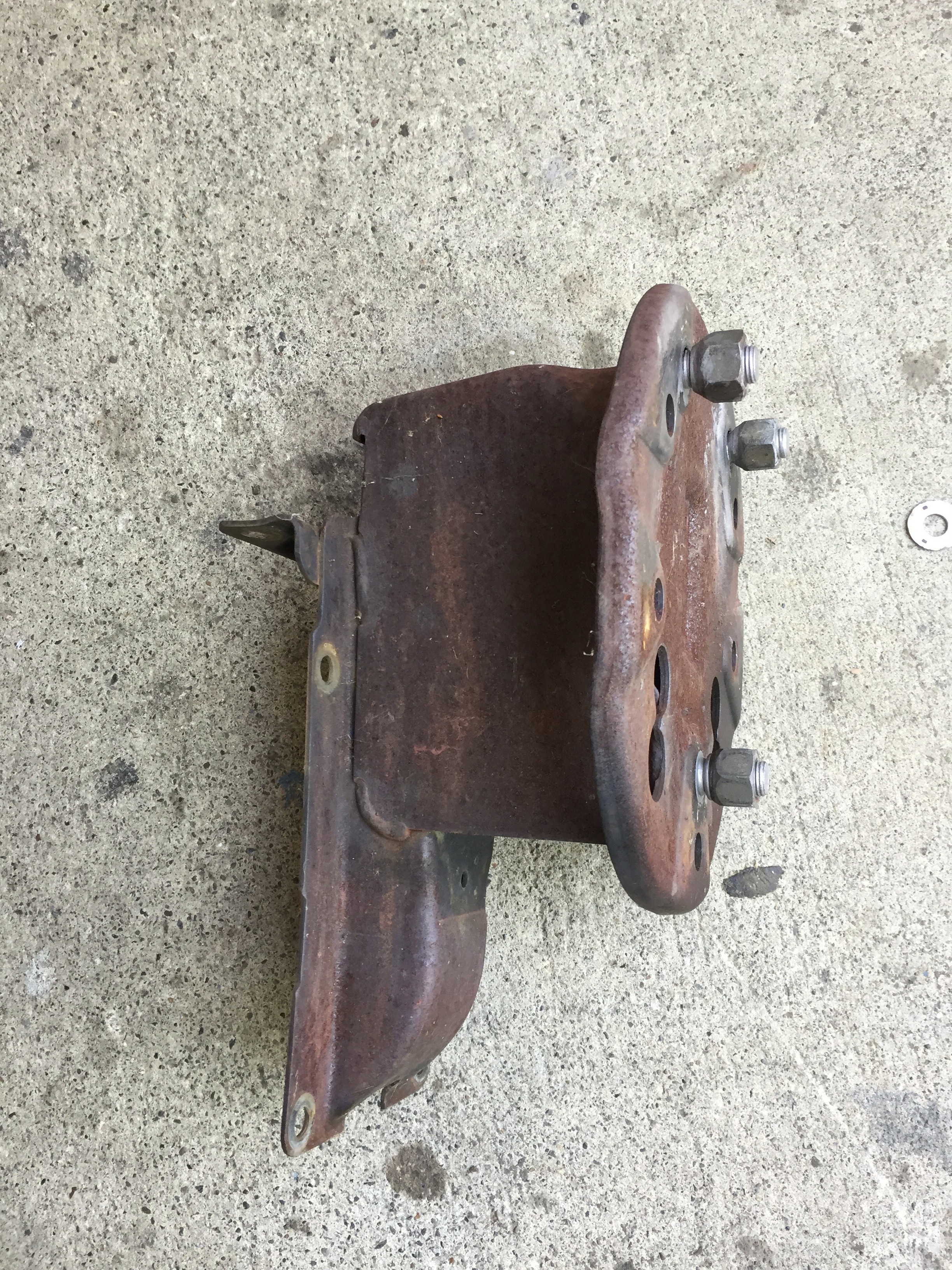

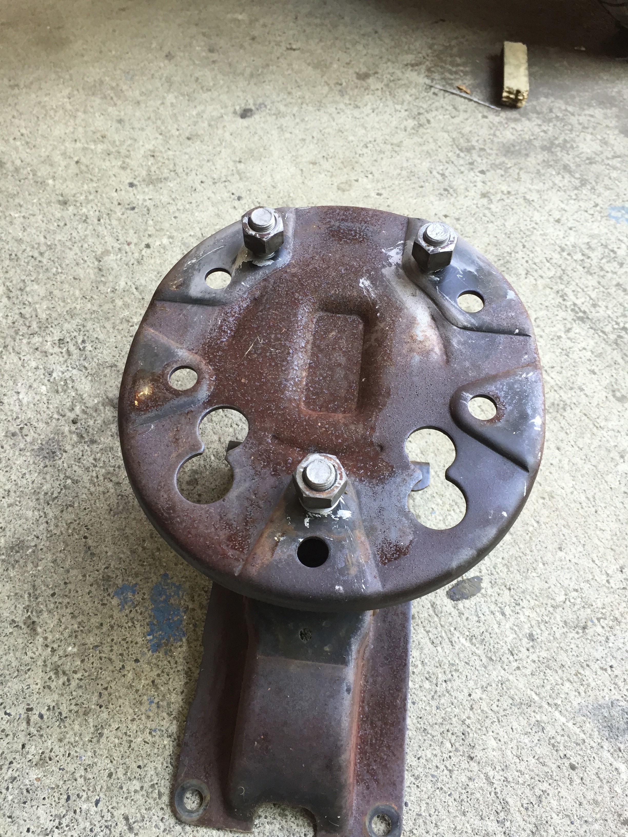

    The stuff I use is called Corroseal. IMG_4970.JPGIt turns rust into a primer, here is pics of the tire mount I just did. IMG_4964.jpgIMG_4966.jpgIMG_4967.jpgIMG_4969-1.jpg Just wire brush the loose rust off, blow it off, then brush the Corroseal on.
