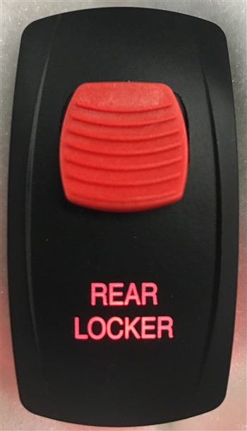

    I agree with having added safety.  I found a switch on the Spod website that might just do the trick.  You have to push the red tab down and then the rocker will activate similar to any other rocker switch.    Now I just have to figure out how to bypass my factory switch and get it wired into the Spod.  Not sure how to do that?

    I just ordered the front and rear locker switches.  Now i have to read through all the threads on the Web and figure out how to wire them into my Spod.  If there are any electrical experts in the club I could sure use some help with this...
