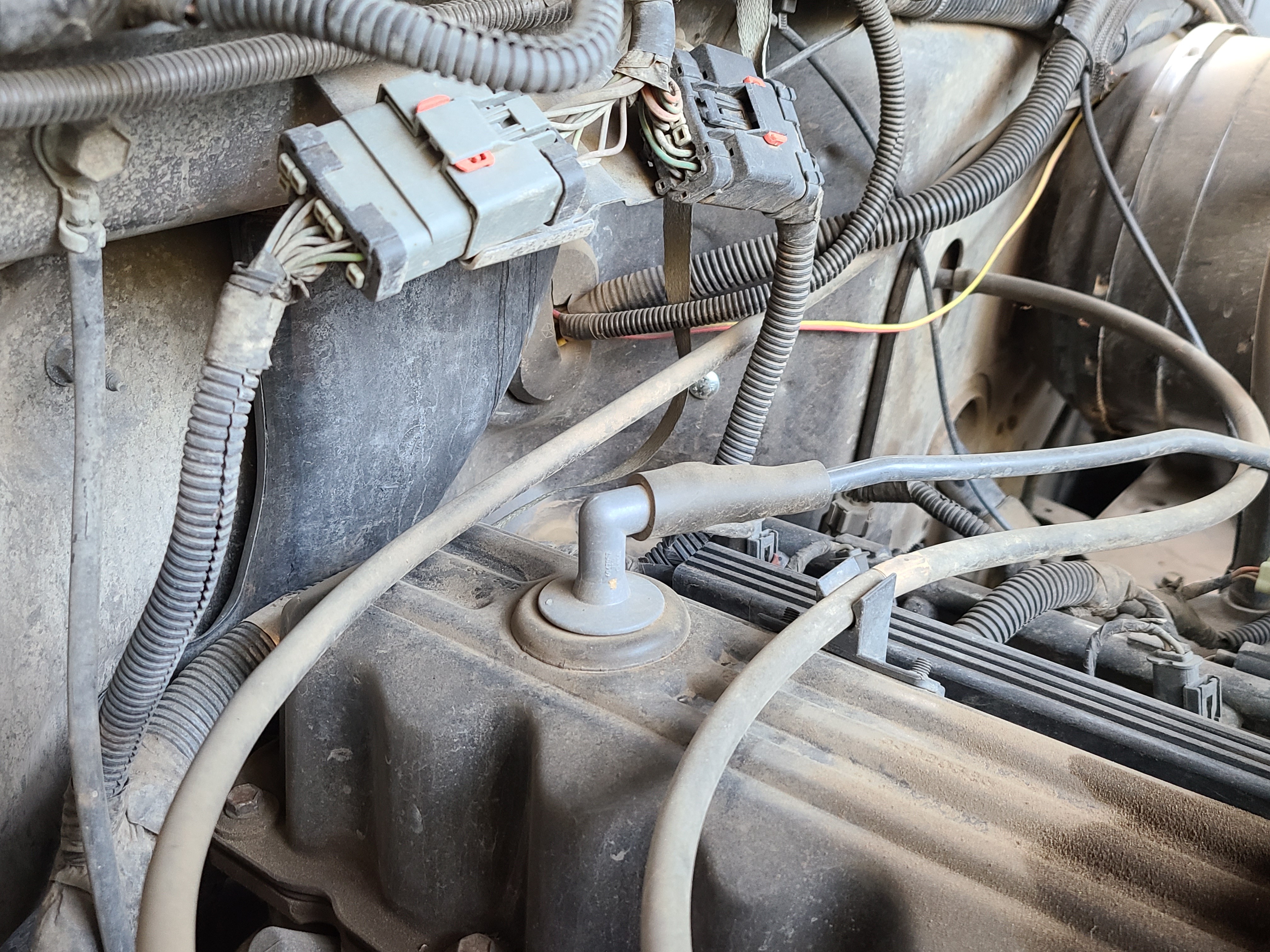

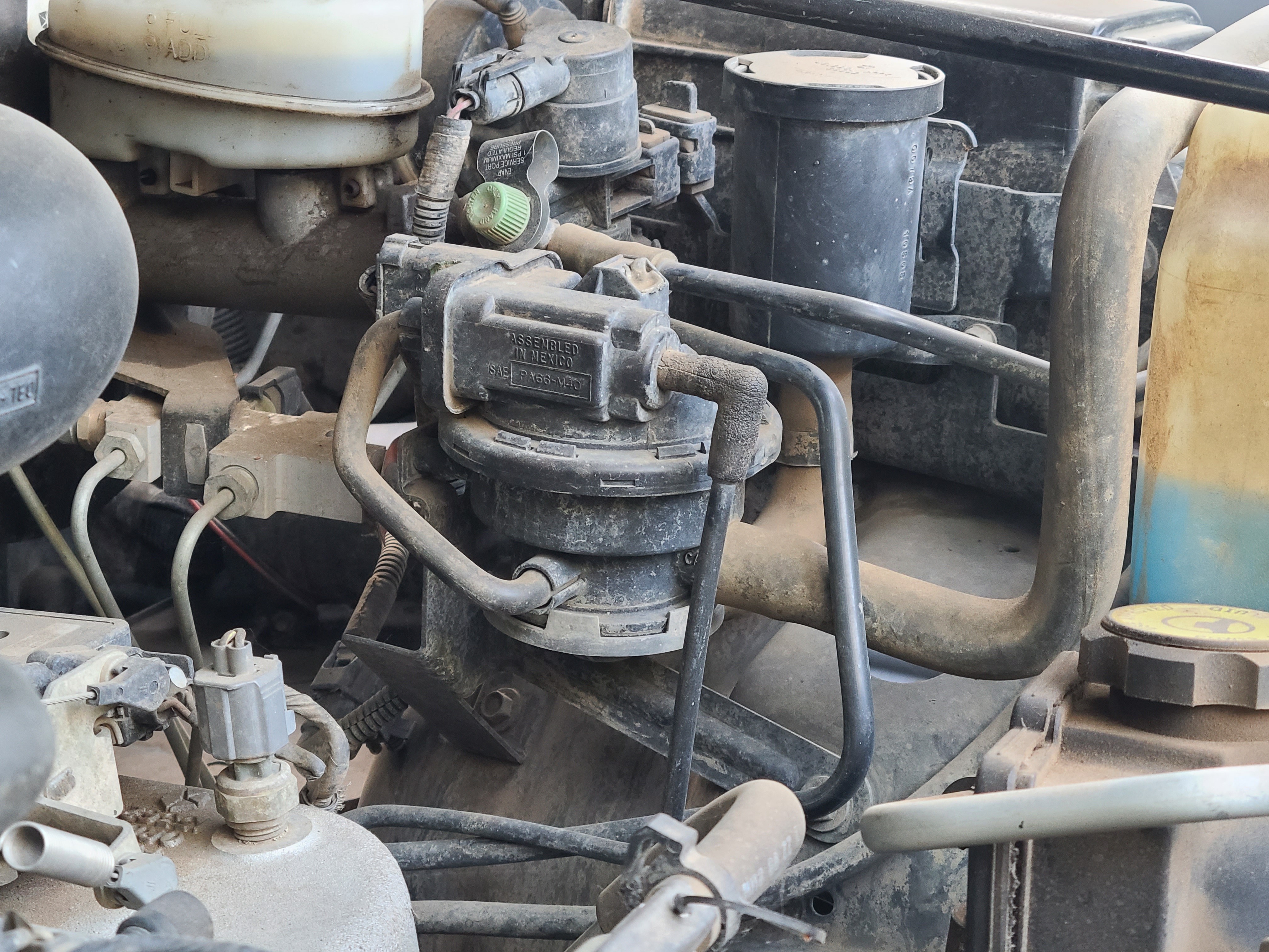

    When I bought my 1999 TJ in 2017 from Nevada it also did not pass smog.  Mine did throw an evap leak code and I changed out the Leak Detection Pump rubber elbow connector as it showed signs of age as well as the one to the crankcase vent tube on the valve cover. The elbow I think is a 1/4 inch elbow and I don't recall the vent tube connector. I would think you would get either a large leak code P0455 or small leak code P0456 but it sounds like you are not even getting that far.
    John
    Looking around the web I saw that if the TJ has had a dead battery for an extended period it may take 30 to 50 "Cold Starts" to go through the evap cycle. Hope this helps.
    https://www.jeepforum.com/forum/f9/tj-drive-cycle-reset-monitors-smog-test-1164903/
