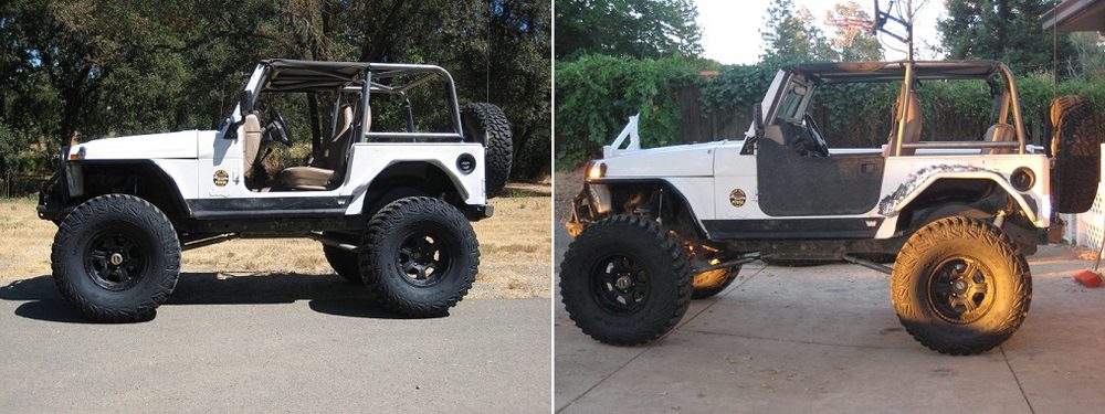

    Here is a comparison of the before and after. You can see the front axle moved forward to give more clearance. You can also see how much we opened up the rear wheel well to give more room to stuff the tires. Sorry about the rough looking paint and finish, but that will all be finished next week.

    If we high-line those front fenders, we could drop you down to 4 inch springs!!
    "JohnDF" wrote: Here is a comparison of the before and after. You can see the front axle moved forward to give more clearance. You can also see how much we opened up the rear wheel well to give more room to stuff the tires. Sorry about the rough looking paint and finish, but that will all be finished next week.
    #622 Aug 2010, 7:56 AM
    "RobD" wrote: If we high-line those front fenders, we could drop you down to 4 inch springs!!
    [quote="JohnDF"]Here is a comparison of the before and after. You can see the front axle moved forward to give more clearance. You can also see how much we opened up the rear wheel well to give more room to stuff the tires. Sorry about the rough looking paint and finish, but that will all be finished next week.
    But then I'd want to high0line my rear fenders to match. You want to cut them off again? 😈

    All finished up...
    #695 Aug 2010, 11:05 AM
    Great job guys. The jeep looks ready to go! See you tomorrow.

    Looks great!
    #717 Aug 2010, 6:42 AM
    Trip report...
    The Fordicon run was my first chance to test out the new tires. Measurement wise, they were right in the middle between Brad's 37s and Rob's 40s. I had very minimal rubbing on one fender, which can be easily adjusted. Otherwise they stuffed well and steering was not effected at all. The extra ground clearance was helpful and I was able to make it over stuff that used to be more difficult. I still can't drive straight down "Diff Hanger Alley" like Rob, but it is MUCH better. The tires hooked up on the rocks better than my old style MTRs and I was very impressed with how the sidewalls flexed. I am very happy with the new tires and I think it was the right choice. I got more ground clearance, better traction, more sidehill stability, and I didn't have to do any expensive mods to get them to work. Two thumbs up... 😎
