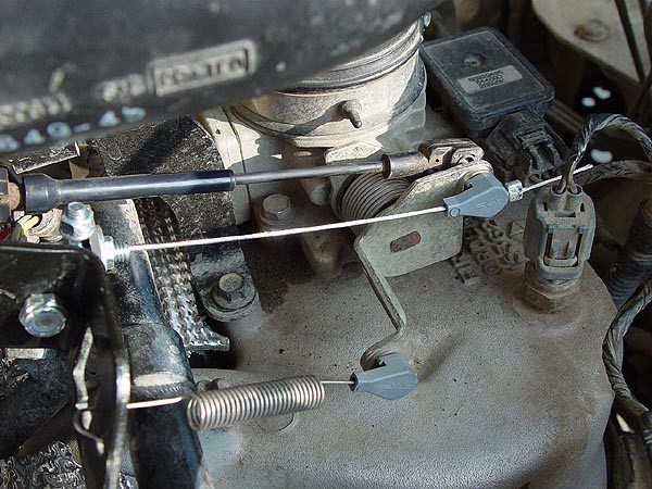

    Thanks for the help. It appears that I'm missing the throttle return spring. When I manually open the throttle I seem to get good return so I wasn't expecting it to be a spring problem. After doing some research it looks like I'm completely missing the throttle return spring shown at the bottom of this picture which I found on the internet:
    I couldn't get the part locally so I called the dealership and they have it for about $7.00, a reasonable price since one company wanted $14 just to ship the part. The dealer told me that the part is discontinued but they have some back east so it will take a week to get here. I guess if it breaks in the future you just have to use some other type of spring and not the stock one. Hopefully this will solve the problem!
