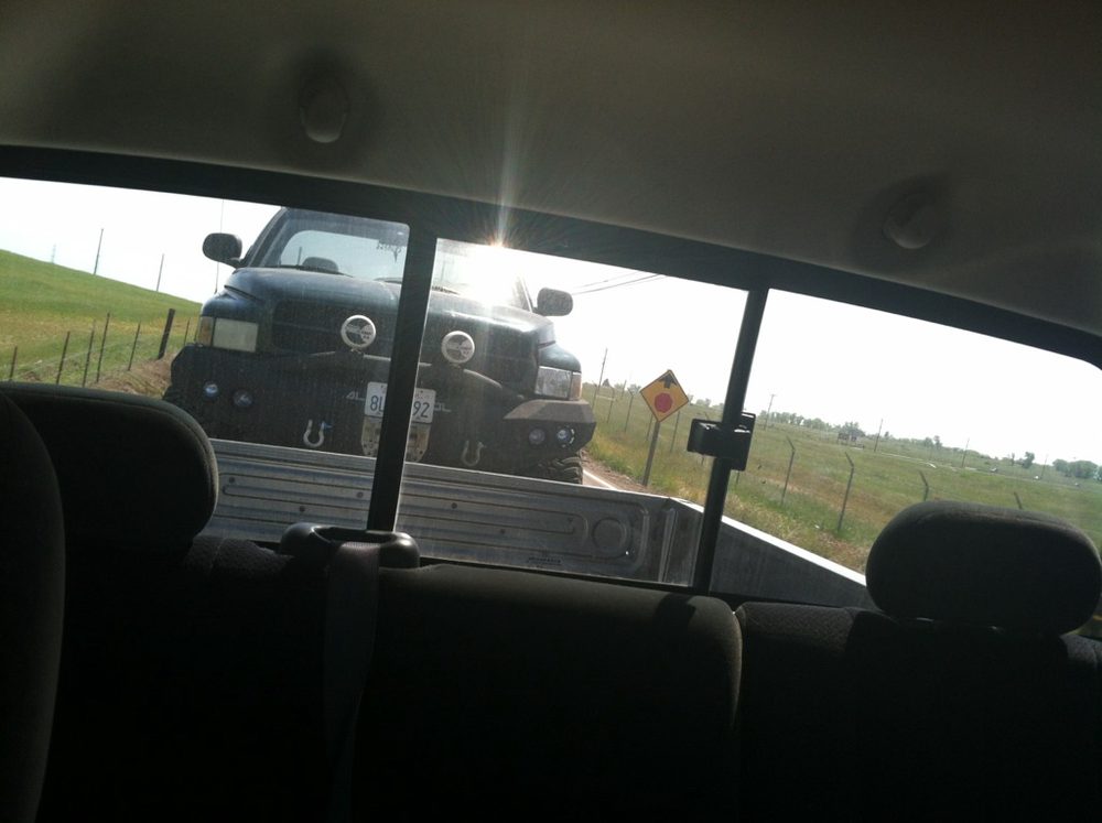

Uh oh...
    #113 Apr 2013, 3:33 PM
    #213 Apr 2013, 5:23 PM
    That guy follows too close. πŸ˜€
  3. Jeff- that guy with the foolsize Subscriber
    #313 Apr 2013, 6:38 PM
    What happened?
    #413 Apr 2013, 6:42 PM
    He's not THAT tall is he?
    #513 Apr 2013, 7:44 PM
    No, he's on a trailer with a boo boo.
