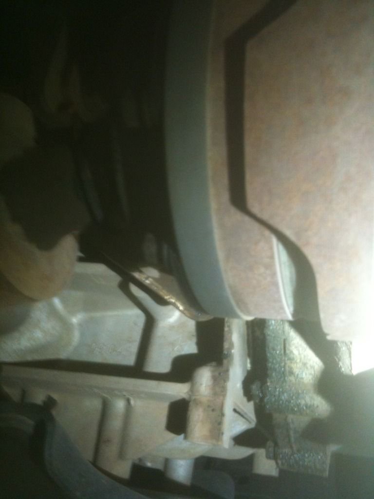

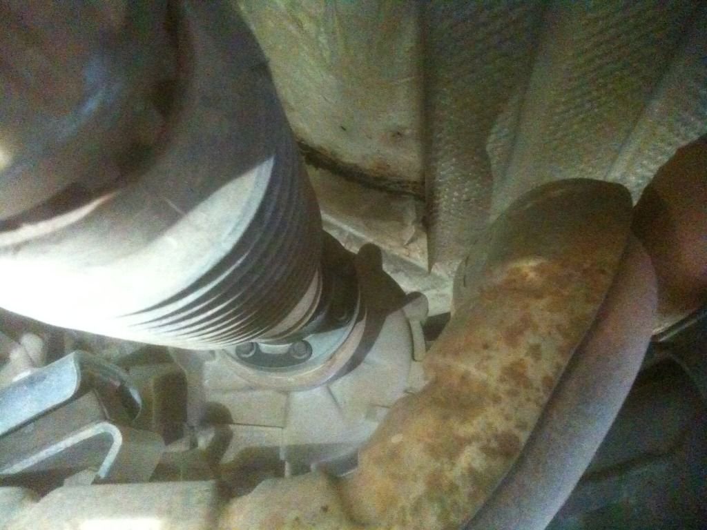

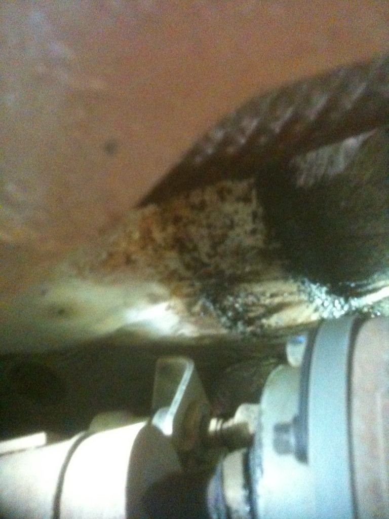

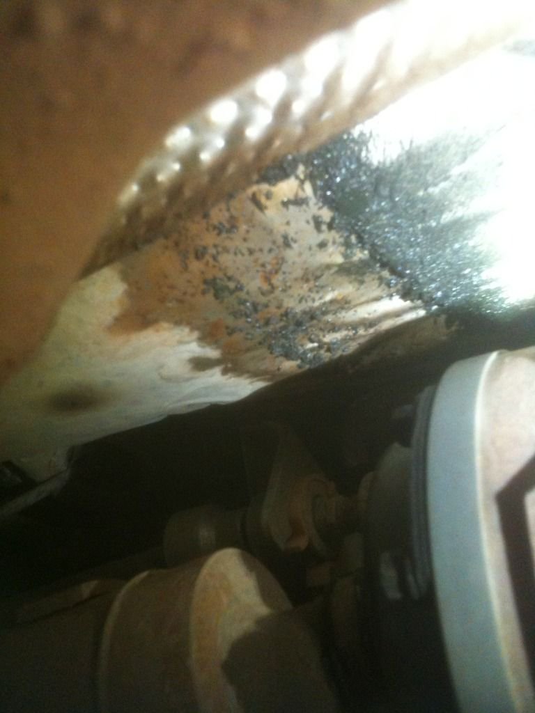

    All That black stuff is grease - I know ive needed a new front drive shaft since forever but I guess now it has to happen. My question is with all these grease (and to me it seems to be a large amount - did I screw anything on the transfer case as well or is it an easy throw a new drive shaft in and all should be good?

    It's hard to see what is going on in the photos. Can you explain it? Is there a lot of grease on the tcase? Is the driveshaft bone dry? Does it look like its seeping from the tcase? Or is it splatter from the driveshaft?

    It looks like the angle at the driveshaft to t case is way too much and it is grease that looks to have been flung from the tcase/drive shaft meeting point by the drive shaft

    These tcases carry oil. It appears to me, but not complete sure, but possibly you have some weeping of tcase fluid up there. It comes out and onto the driveshaft and gets flung. To me that appears to be small amount. I'd wipe it down clean as best as you can and monitor it.

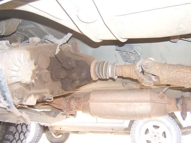

    im pretty sure 241 sounds familiar - and my drive shaft looks nothing like that it hs no u joints at the transfer case. It just drops down to a real small shaft and goes into the transfer case - there is one boot in the middle of the driveshaft that covers some part that looks like a spline drive
    ok i just looked at the link and my transfer case is fixed flange with expandable spline driven drive shaft. about half way down the page from the link it shows a Rzeppa Joint - thats what i have and mine also looks maxed out like that. Mine must be leaking form that boot where the shaft enters the flange - Hopefully i can just replace the drive shaft, that boot, and figure out if that section just needs to be repacked with grease or just refill the T Case with oil if thats how its lubed.
