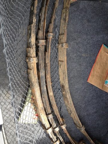

Specialsoundman Member Joined: January 2013Specialsoundman started this Member Joined: January 2013Found a full set of YJ springs over in Fremont. Picked them up today. Now to build the relocation brackets. Pics when I get back to a desk top
