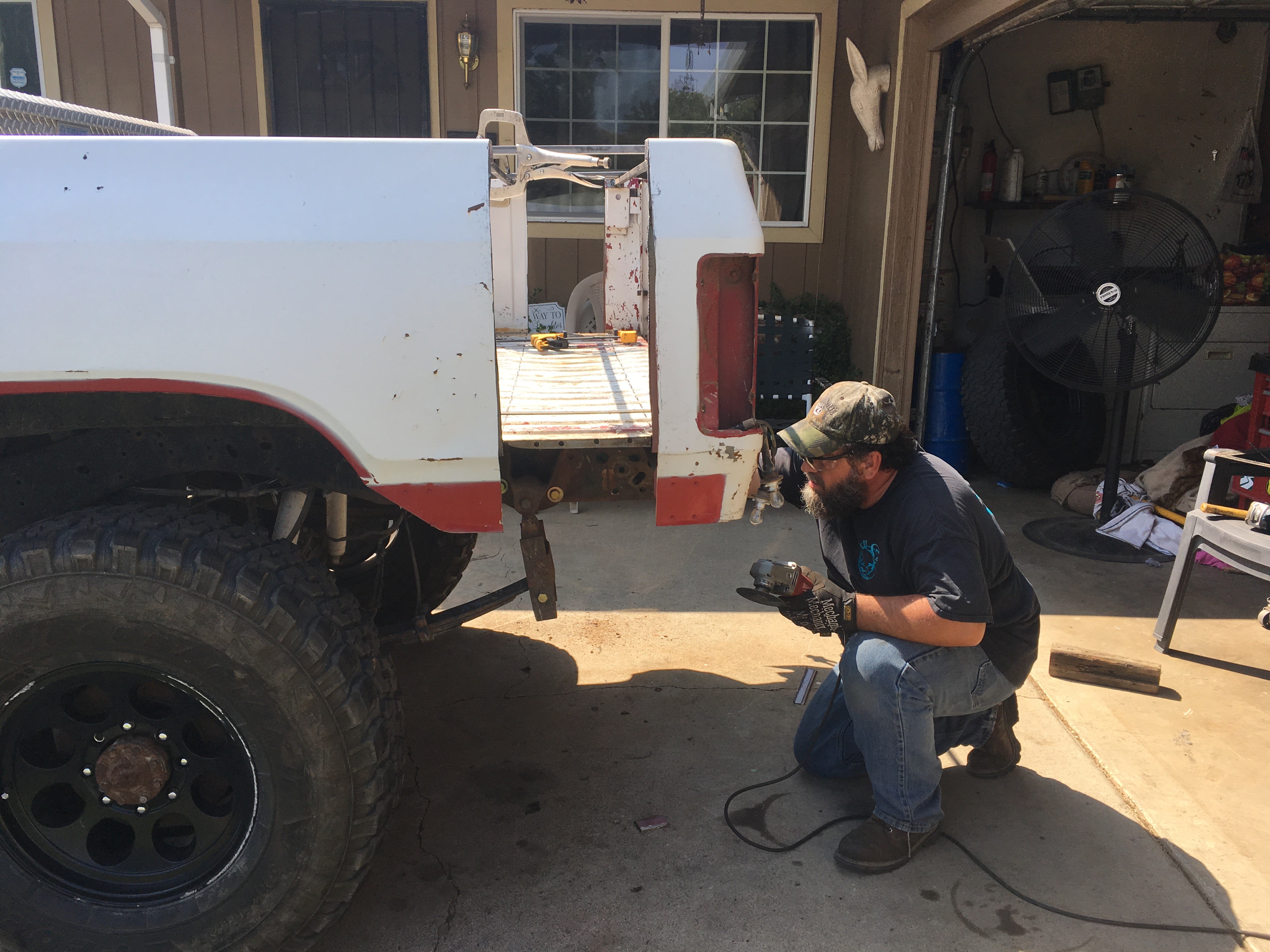

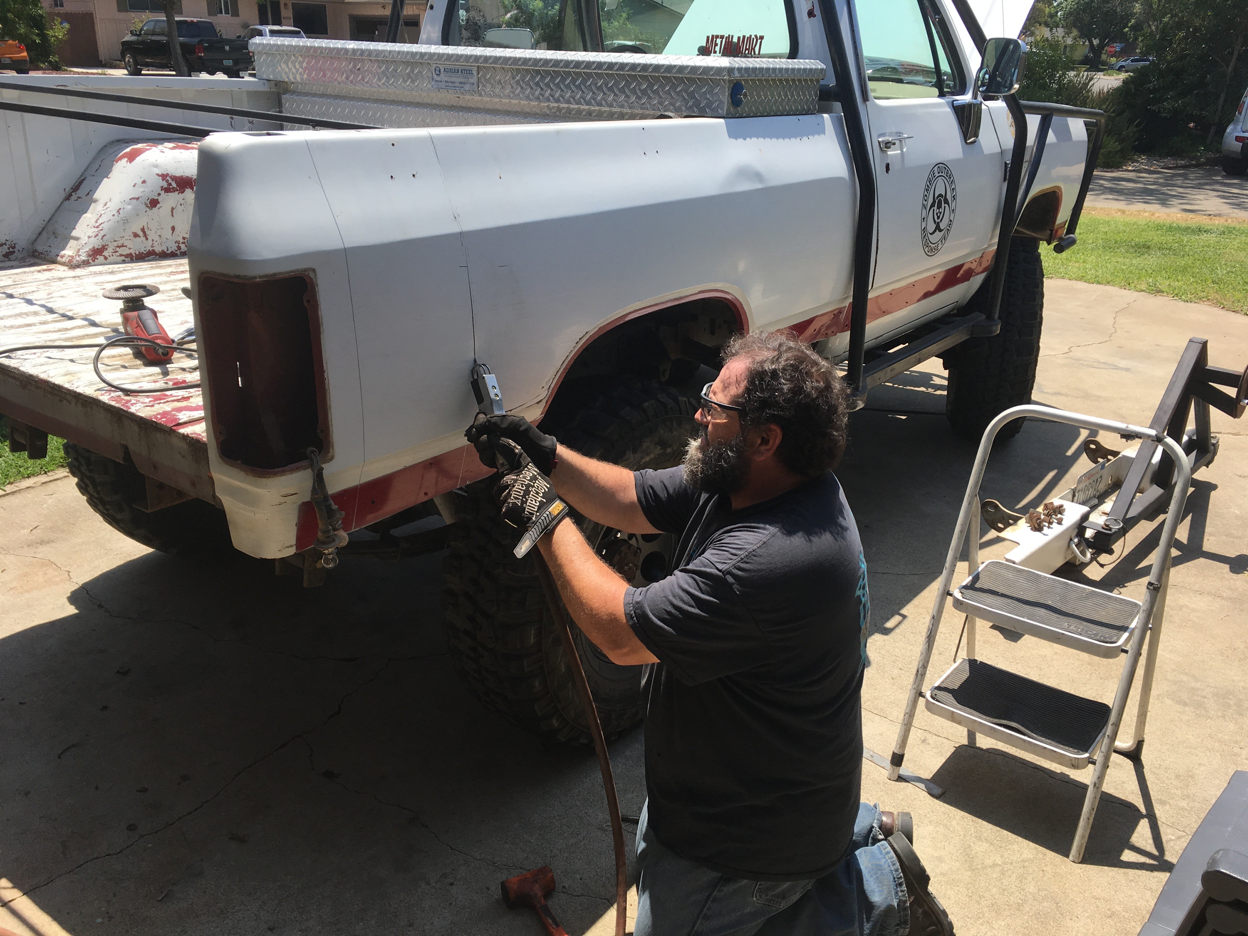

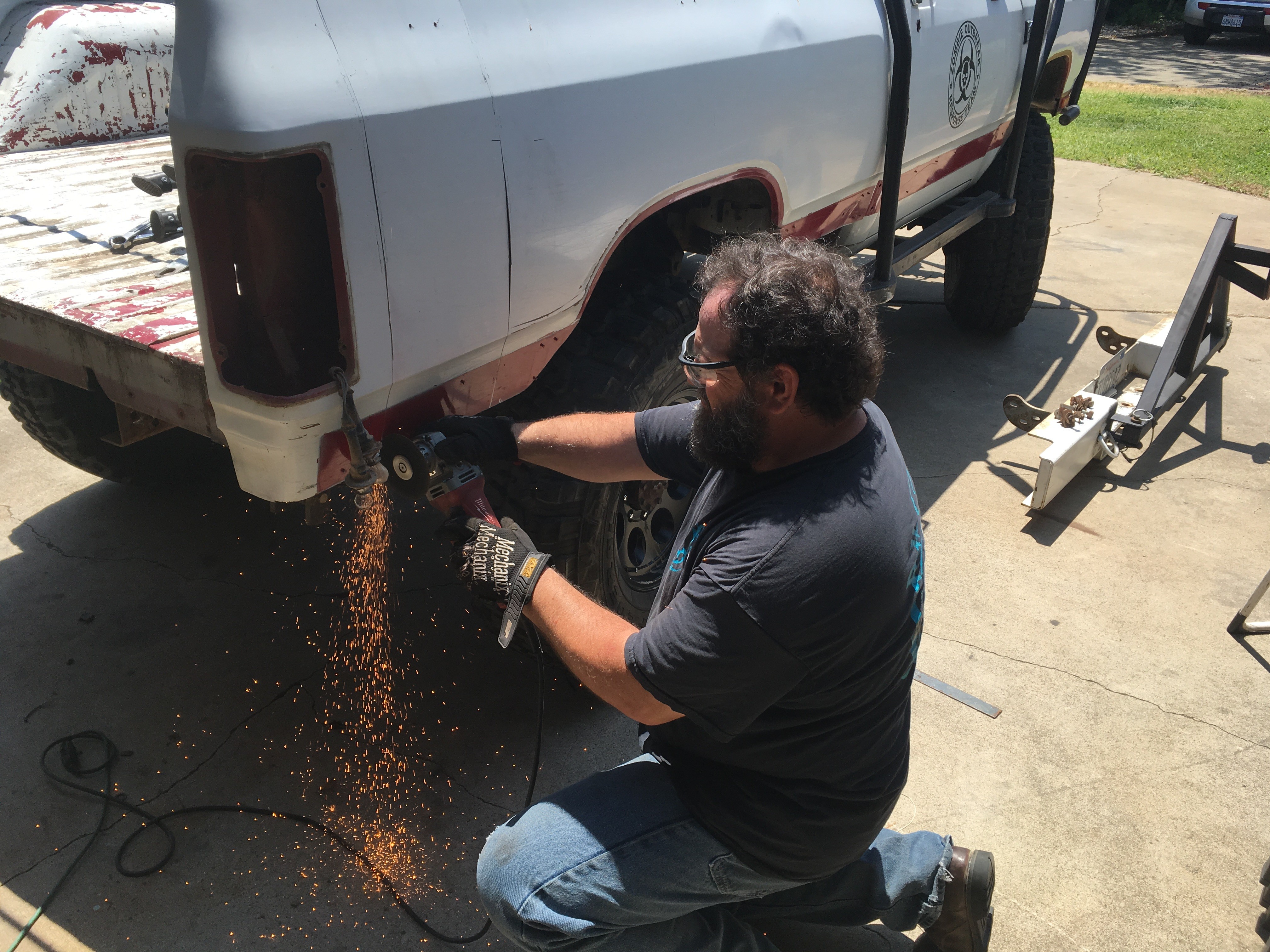

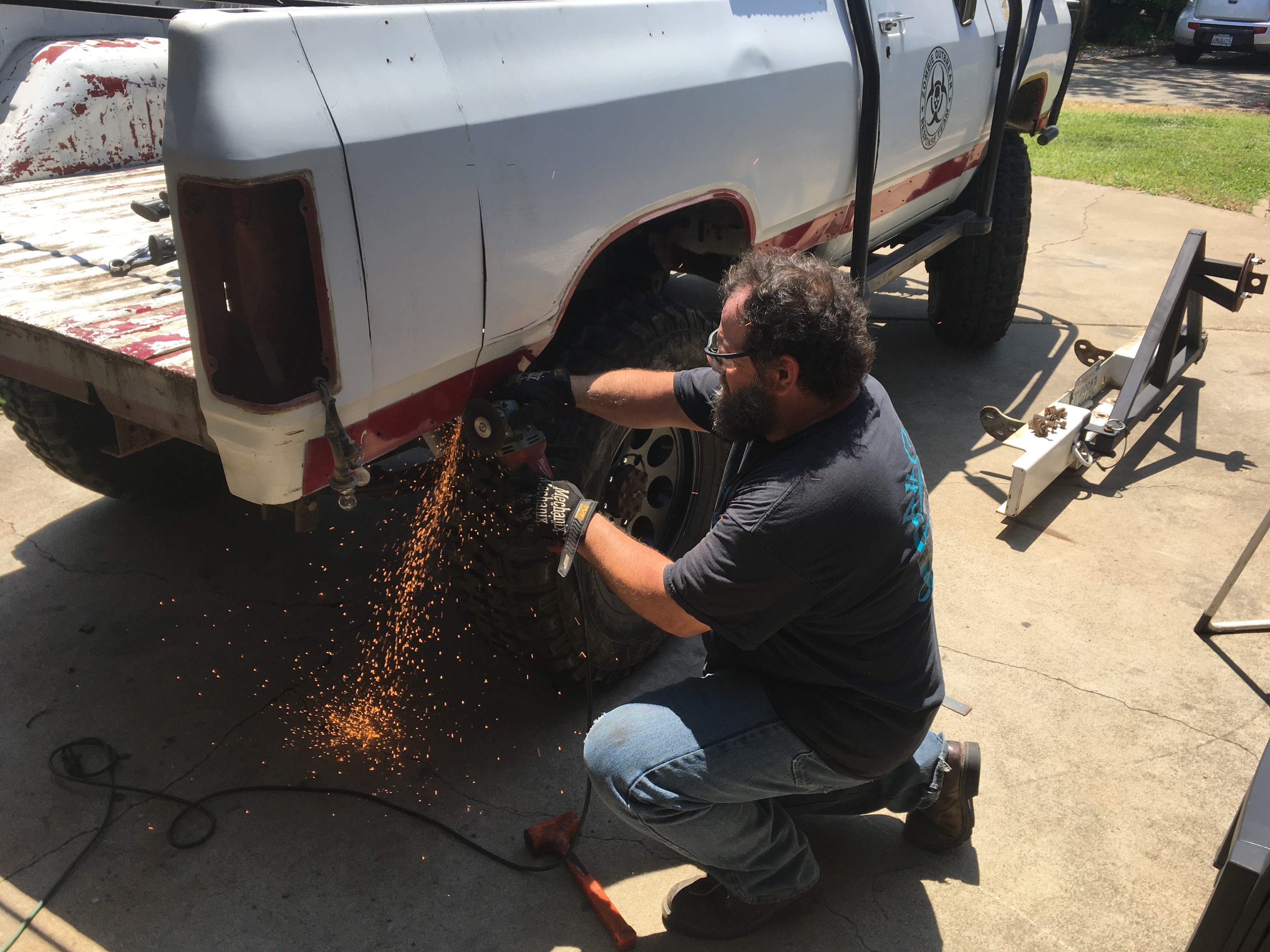

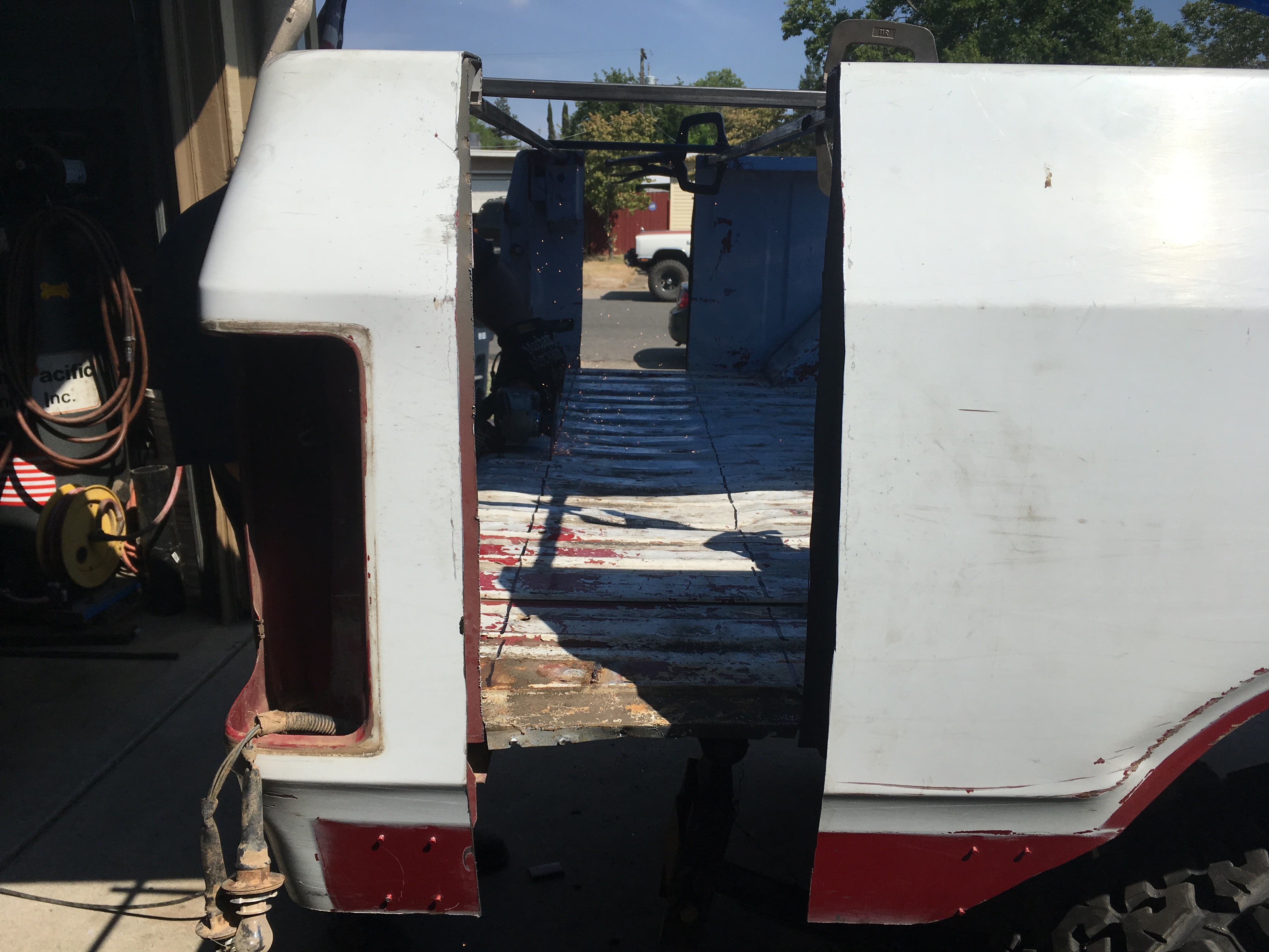

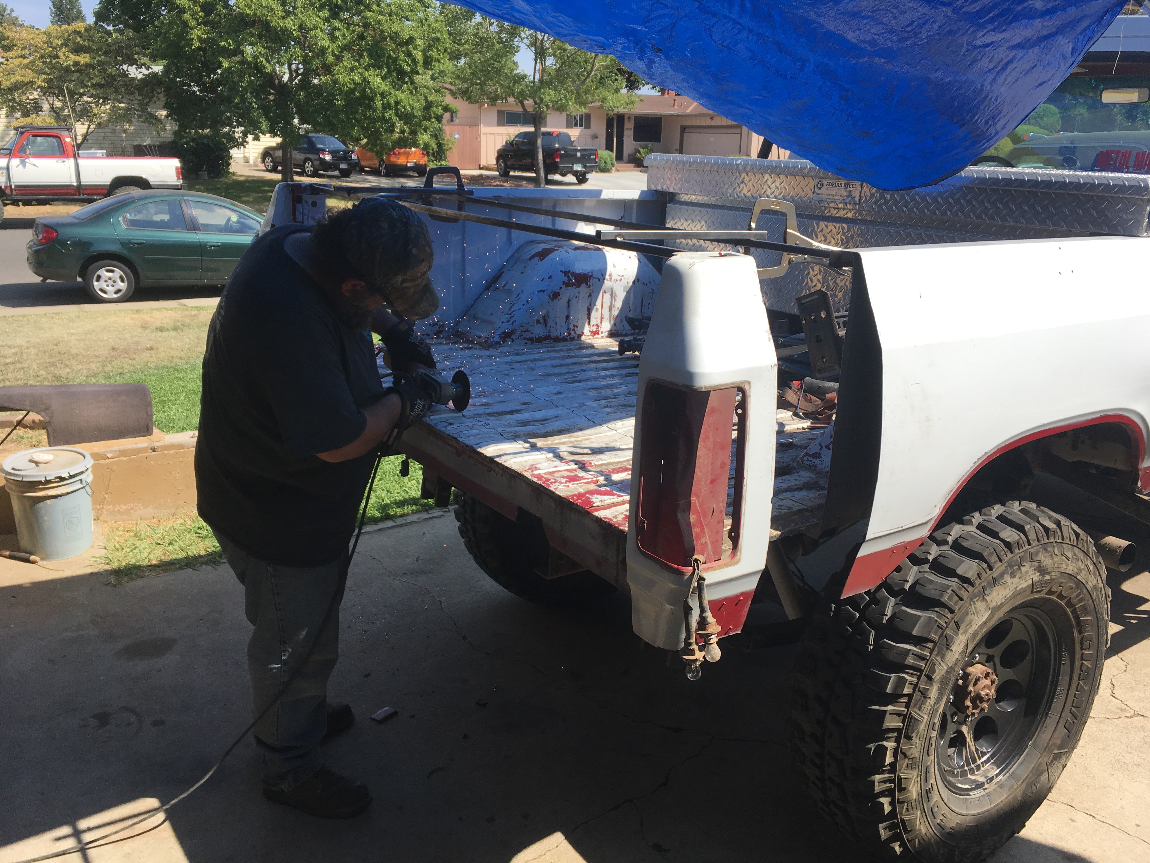

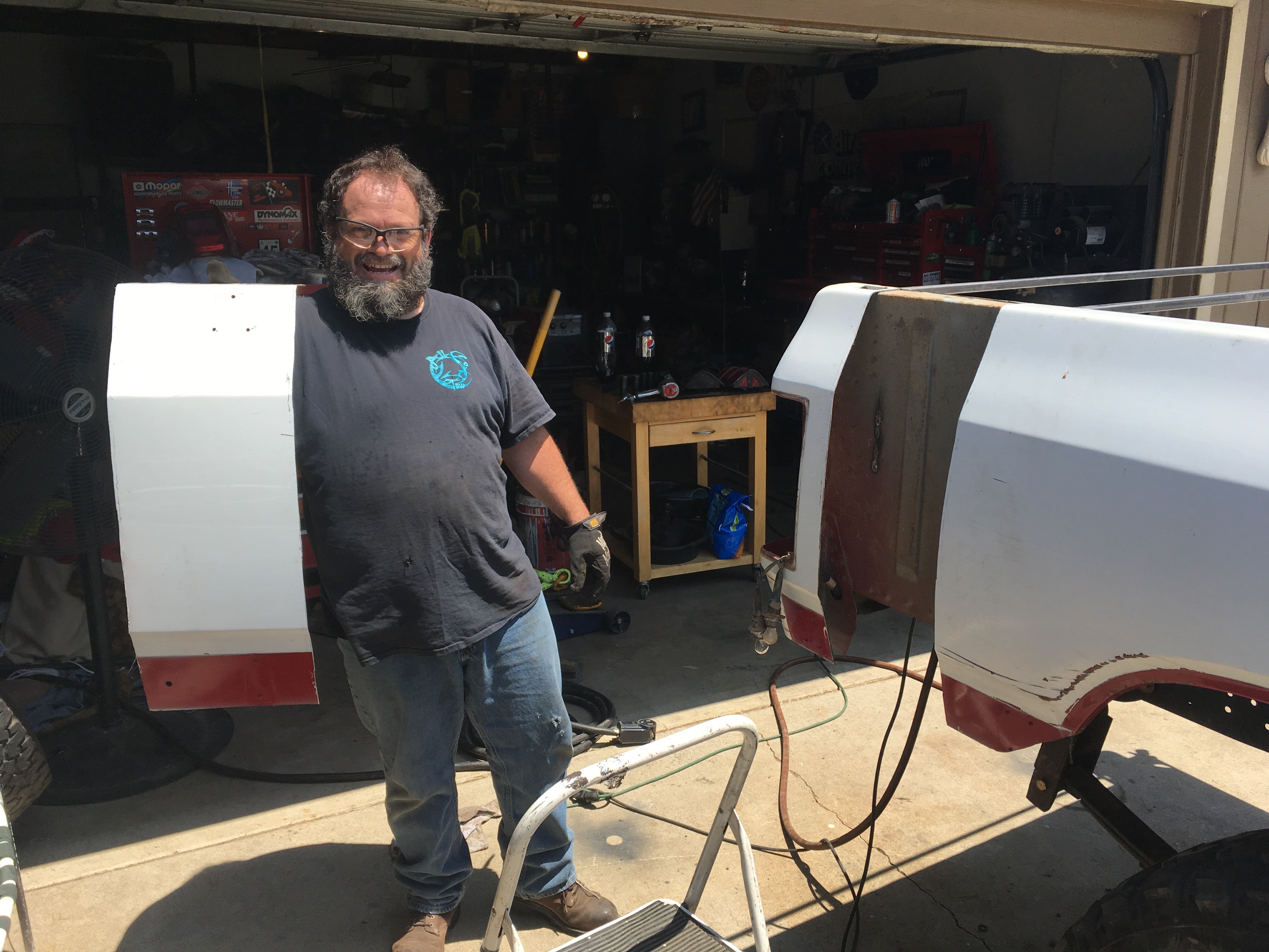

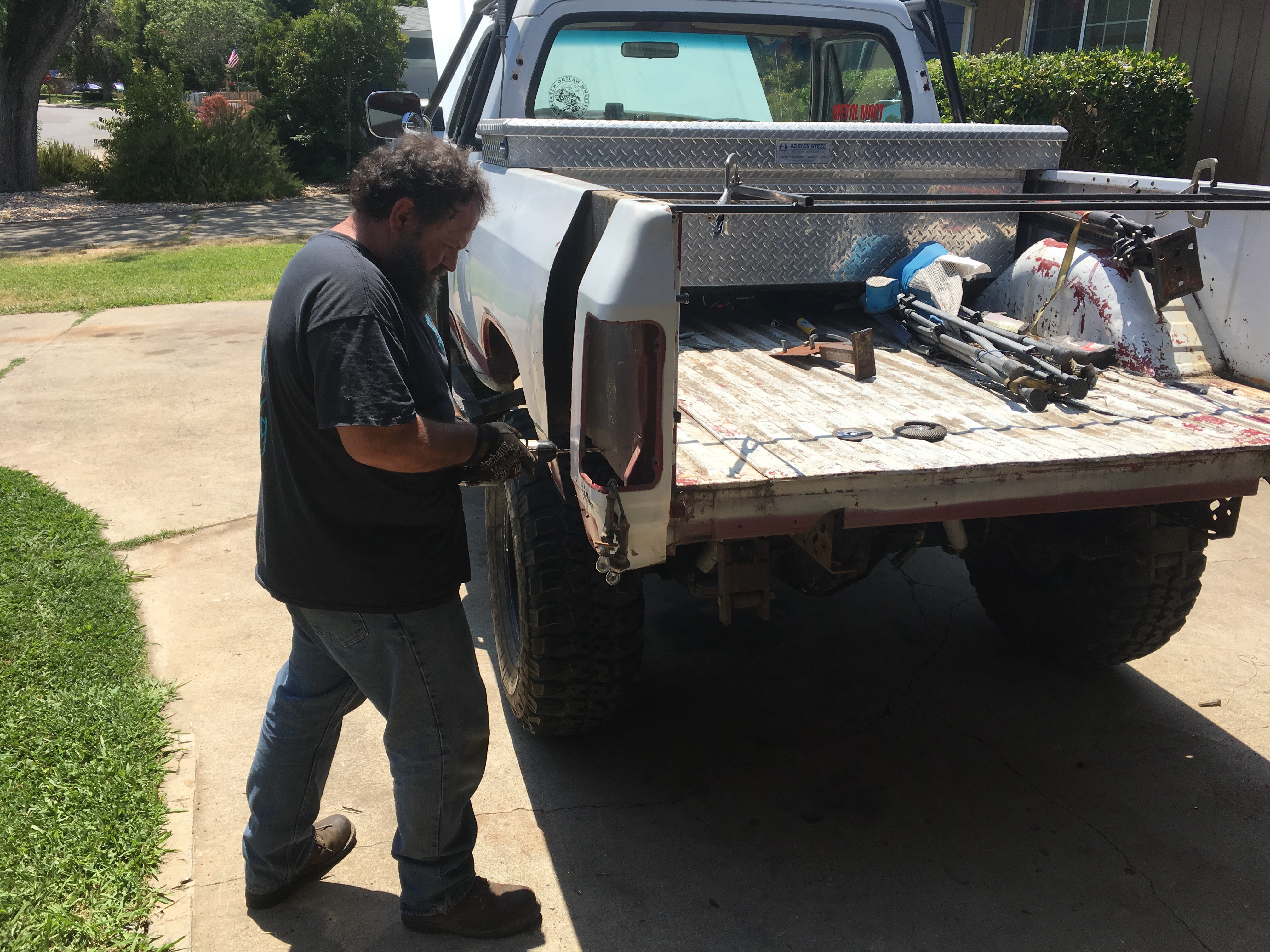

    Today Brent and me started the process of shorting the bed on his truck by ten inches. Here are some pictures of day 1.brents-truck-050.JPGbrents-truck-051.JPGbrents-truck-052.JPG This is Brent making the first and there is no going back lol cutbrents-truck-053.JPG SUCCESS! brents-truck-054.JPGbrents-truck-055.JPGThe right side is done. brents-truck-056.JPGbrents-truck-057.JPG now the left side brents-truck-058.JPGbrents-truck-059.JPGcutting out the floor. brents-truck-061.JPG

    Great pics Dale. Looks like you and Brent had fun! Good mod Brent!

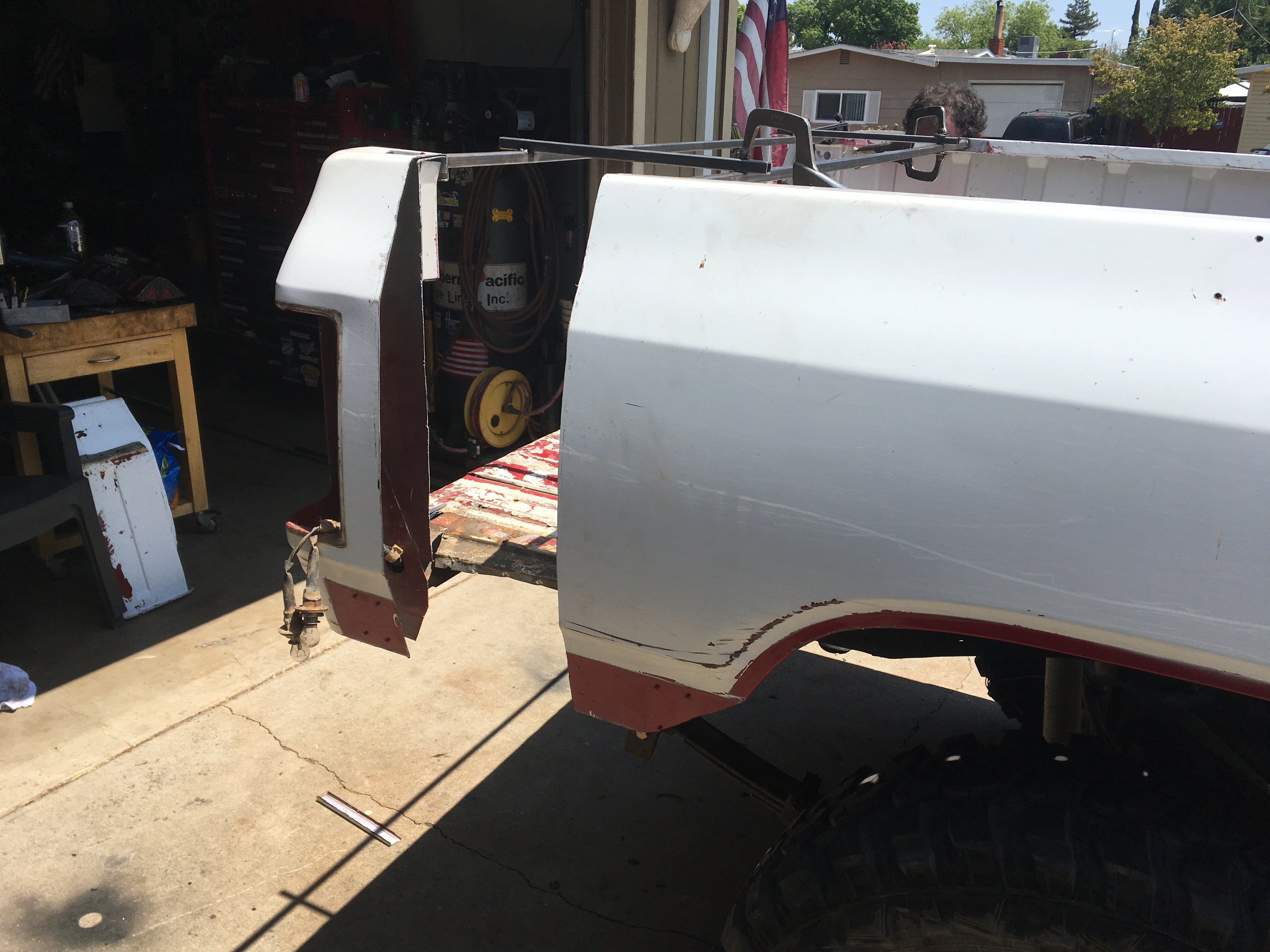

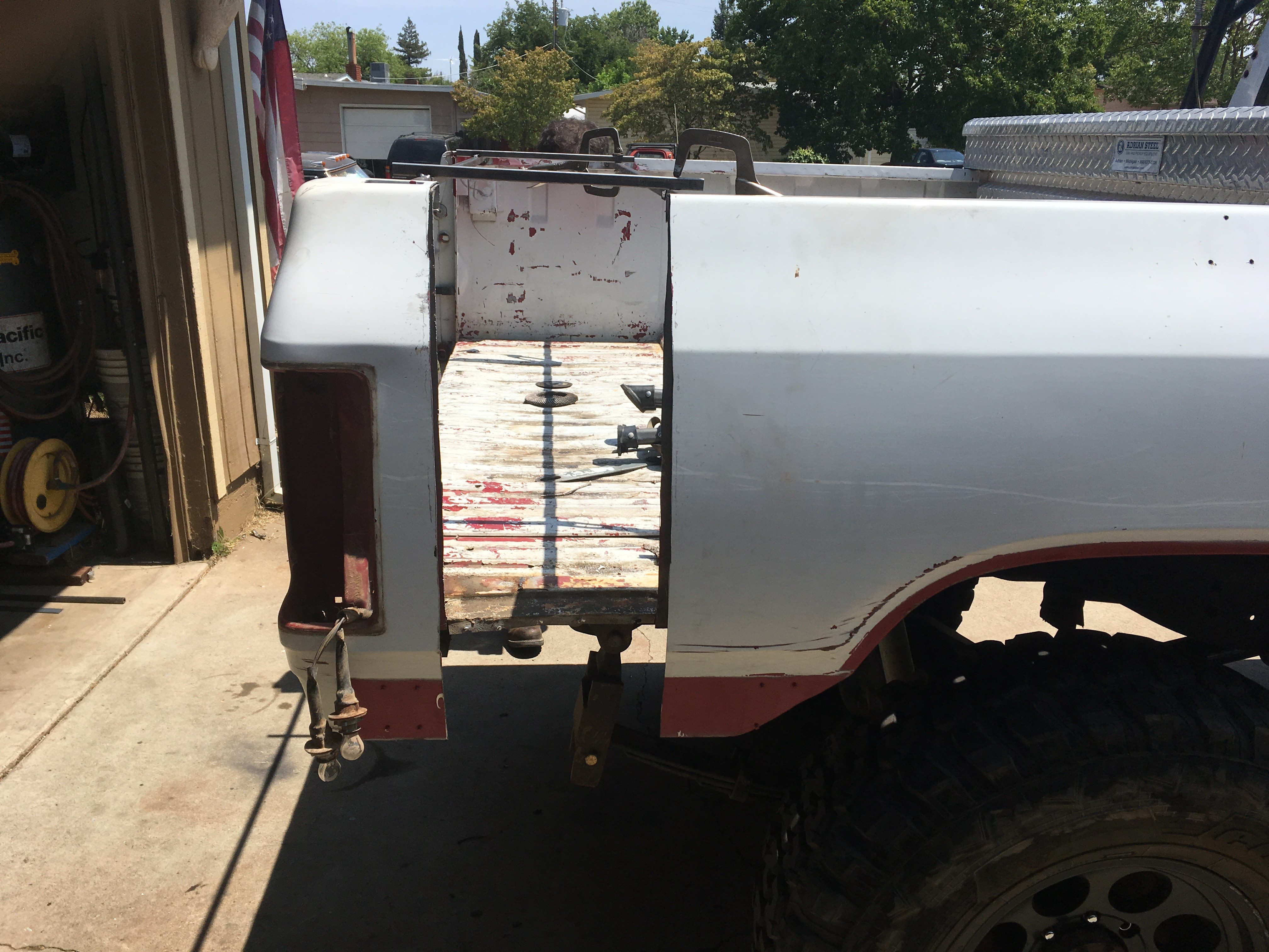

    I ran out of space in the first post here are couple of more pics.  This is what it will look like when it is welded back togetherbrents-truck-065.JPGbrents-truck-068.JPG

    I had fun, Brent had to do all the work and figure out what he was doing. It will be a lot easier  when we do my truck because he will be an expert😀

    Tomorrow we will get the cuts cleaned up and get it welded back together. Then start on the new rear bumper.

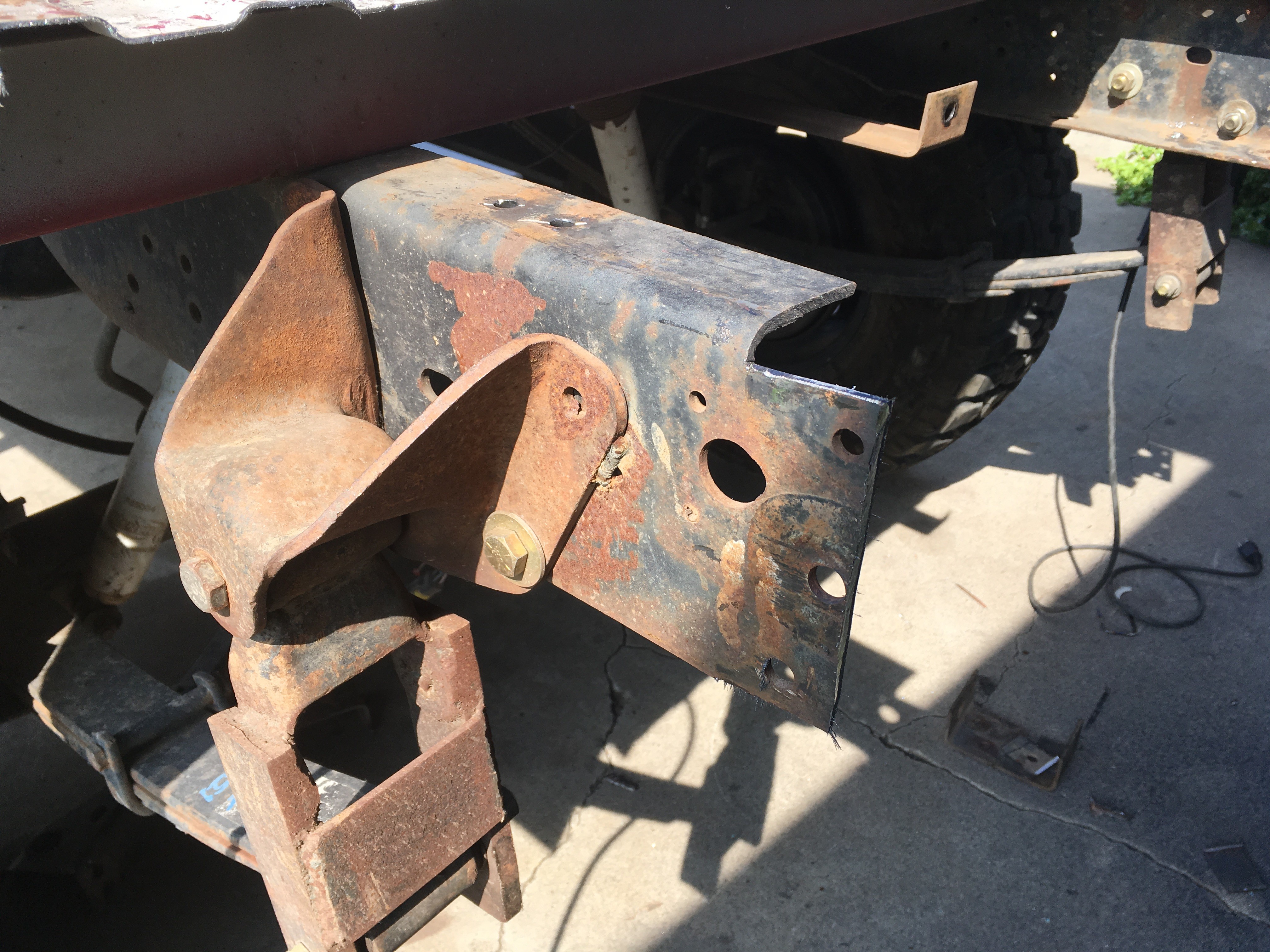

    Day 2 of shorting the bed on the zombie truck.

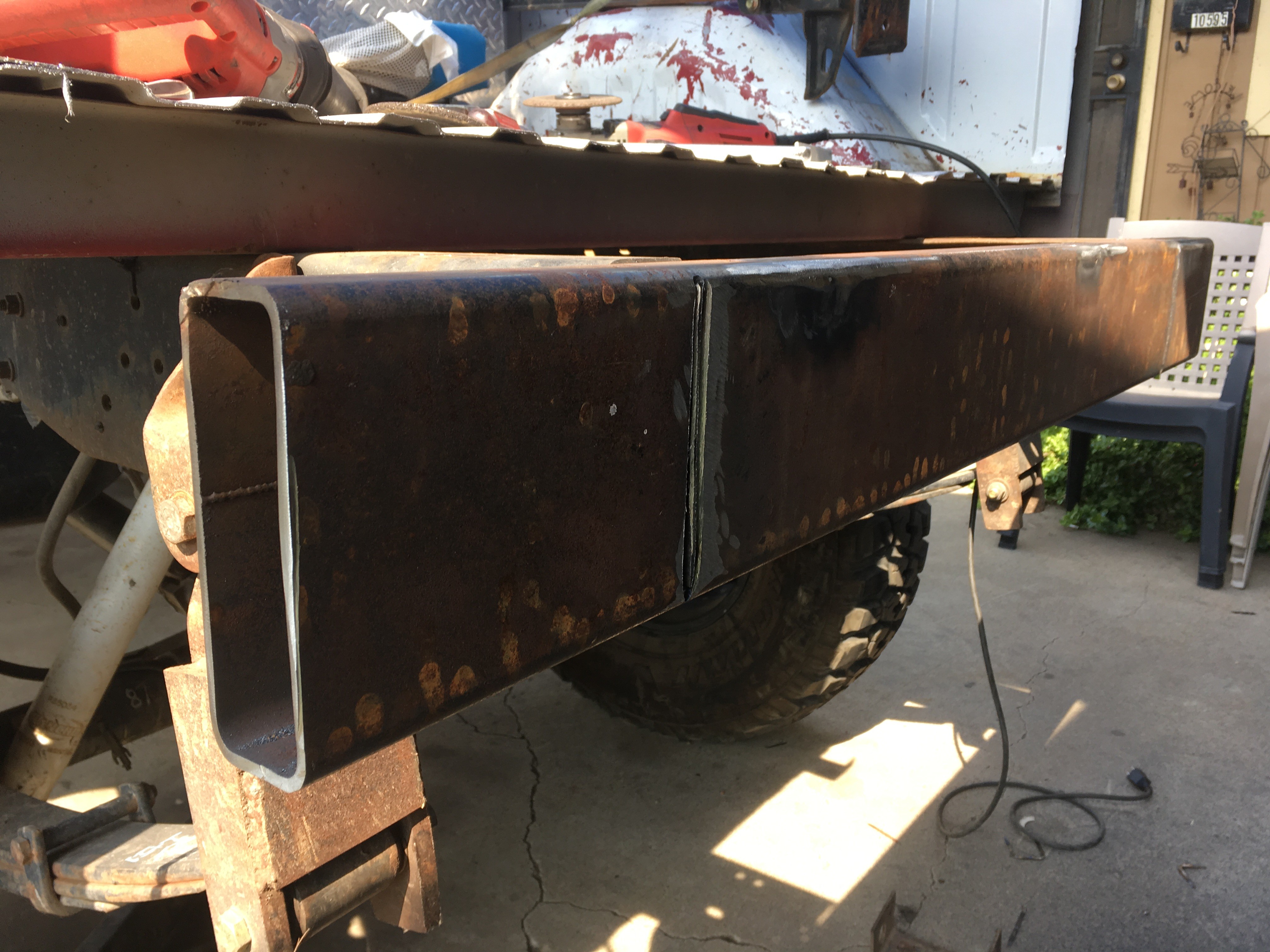

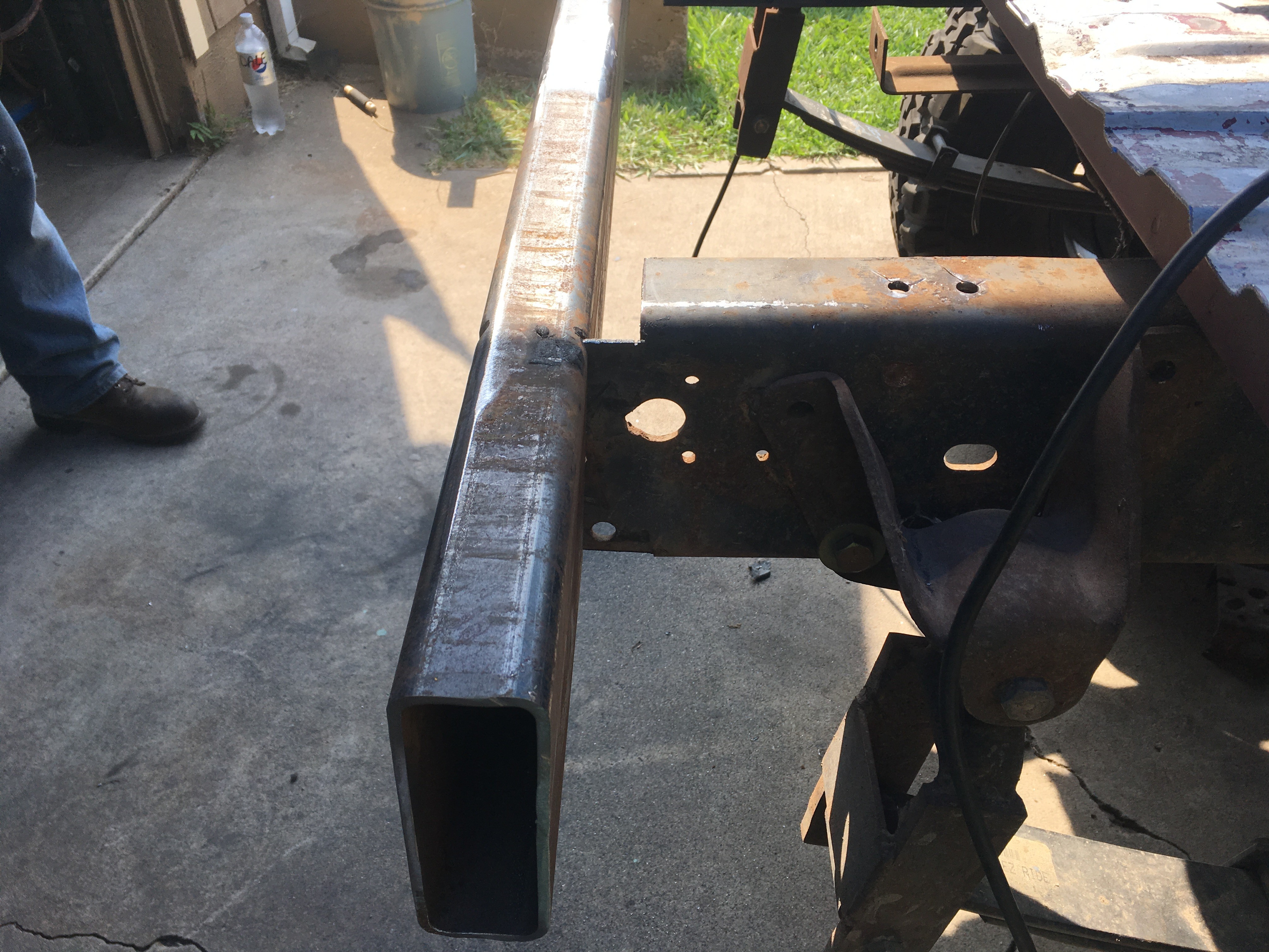

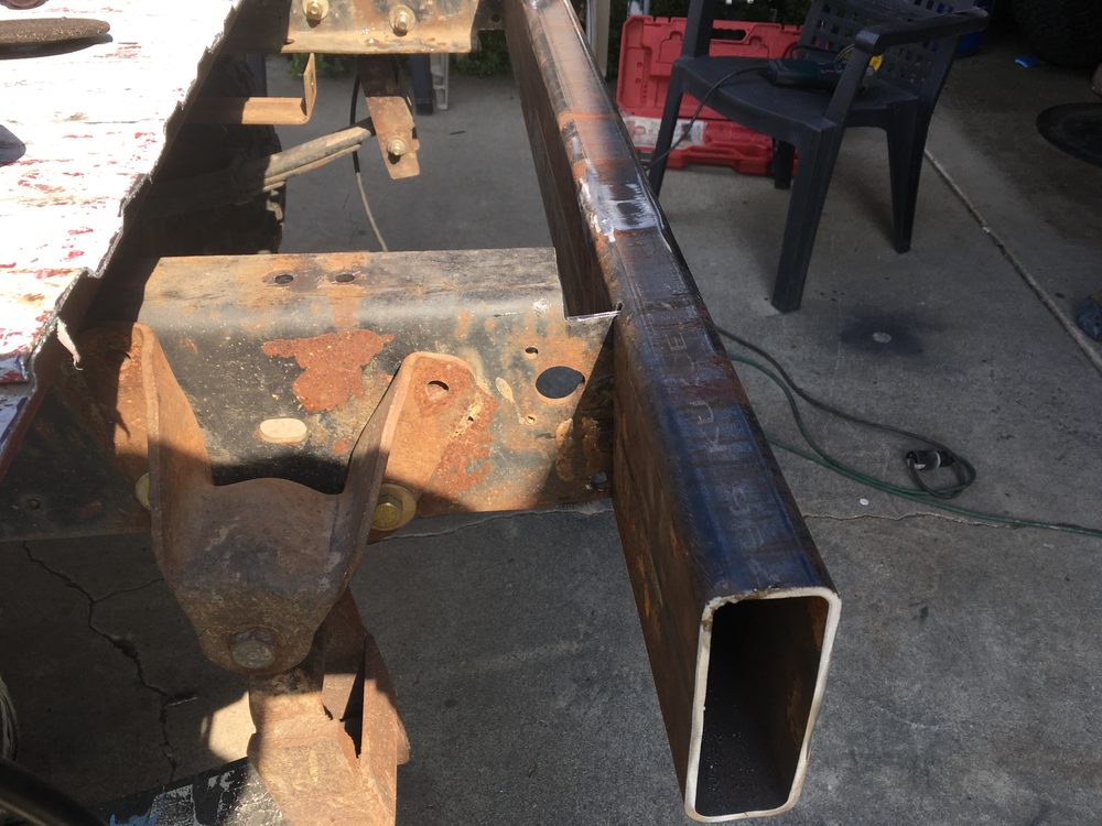

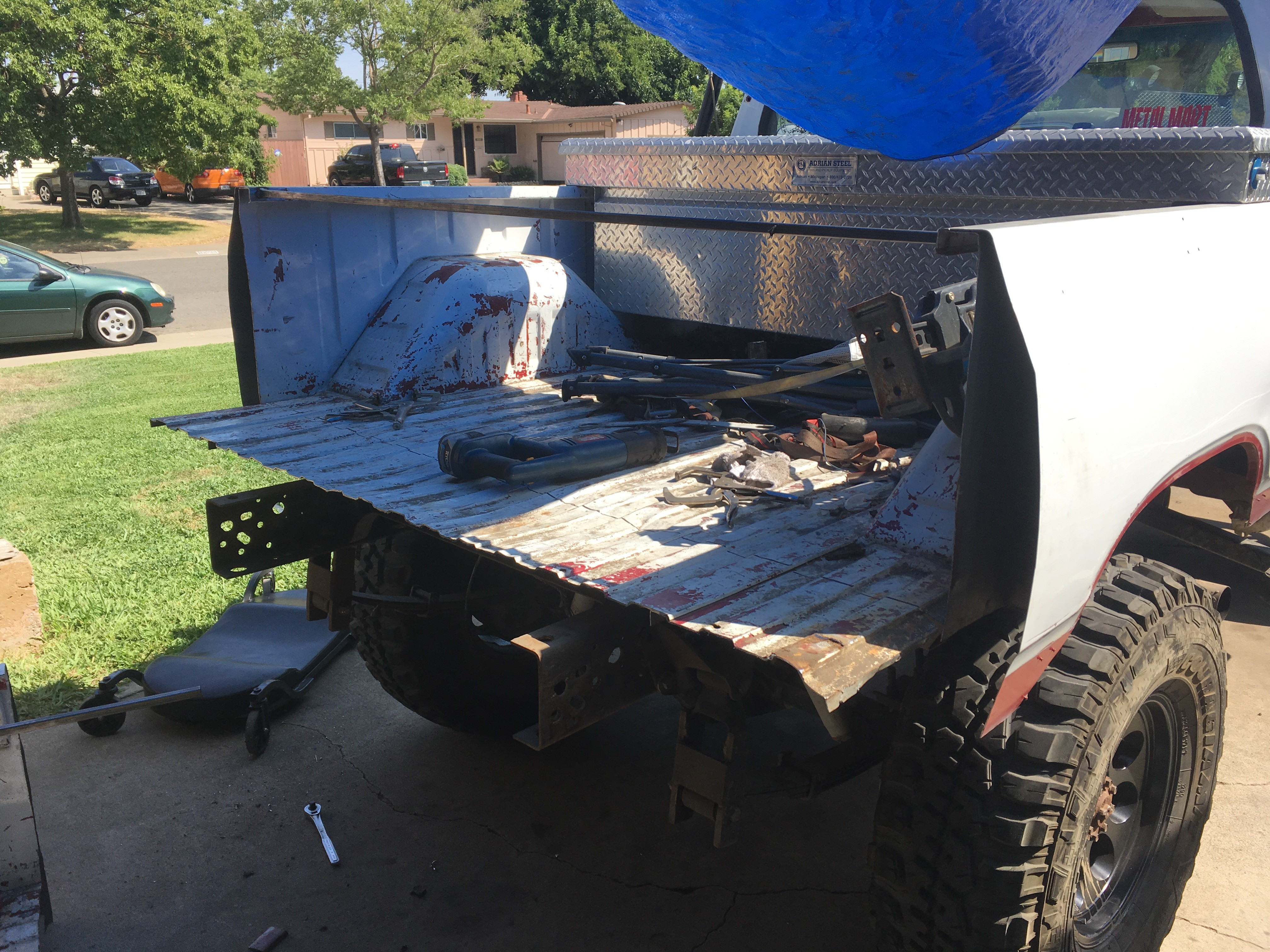

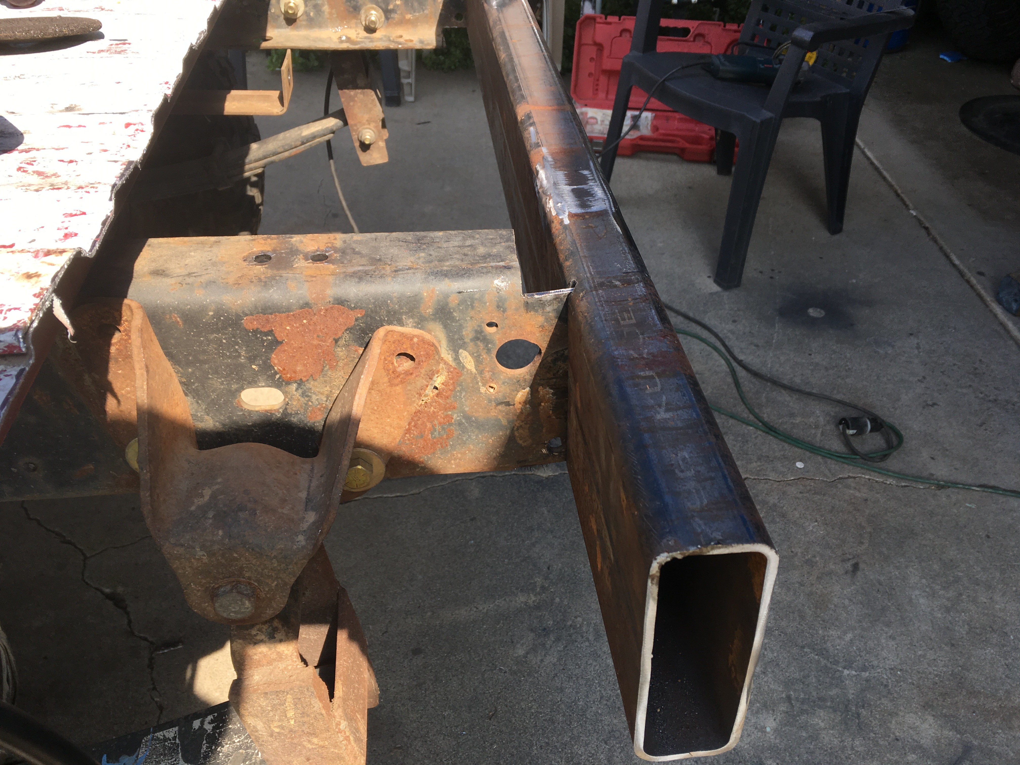

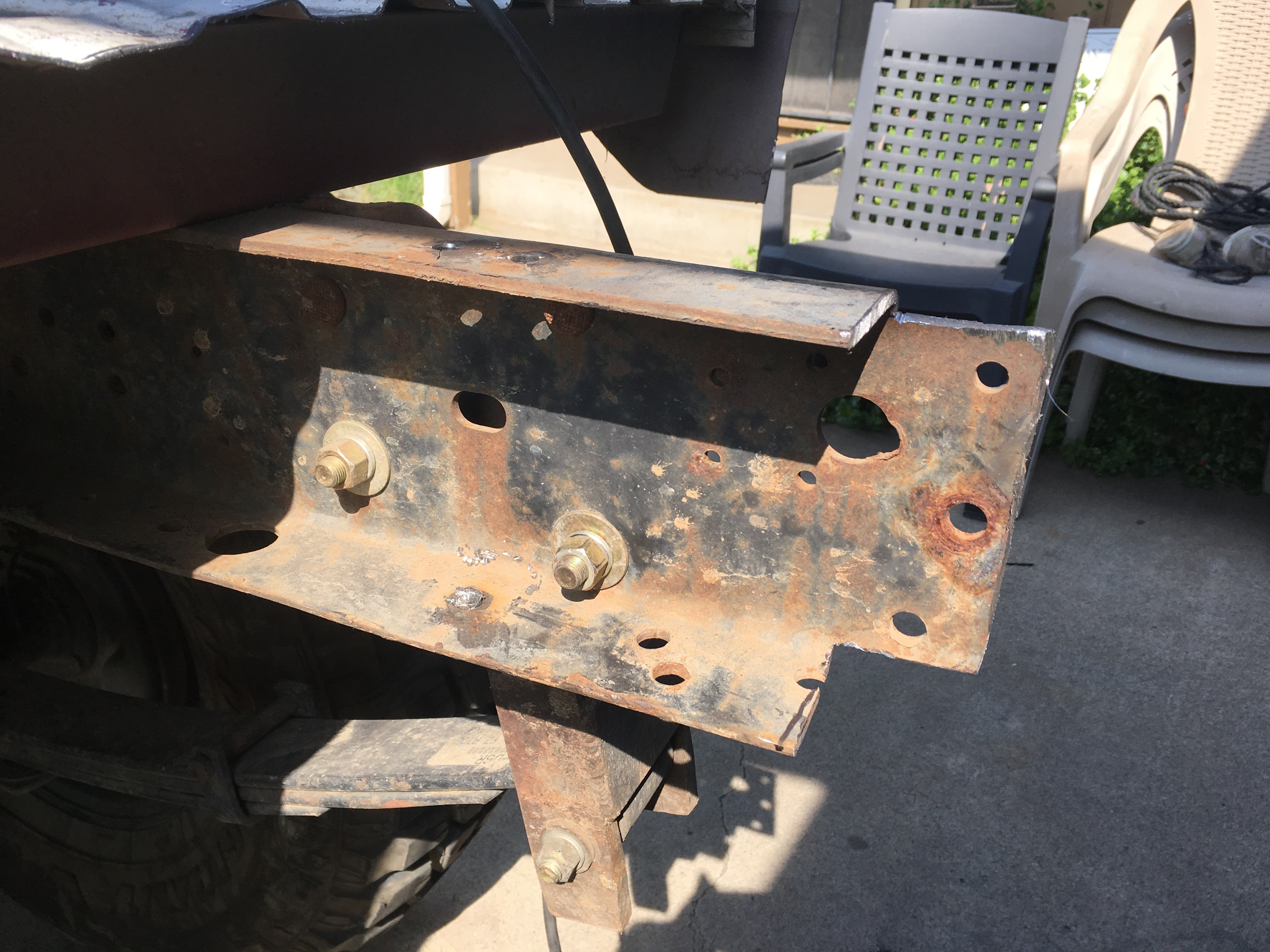

    Brent cut off the excess frame then notched it so the bumper could slide over it and be welded at the back.brents-truck-2-009.JPGbrents-truck-2-010.JPG
    brents-truck-2-006.JPGbrents-truck-2-007.JPG You can see how the bumper slides over the frame so it can be welded.
    This is the slots on the back of the bumper that alow for welding the bumper to the frame on both side of the bumper.brents-truck-2-002.JPGbrents-truck-2-003.JPG

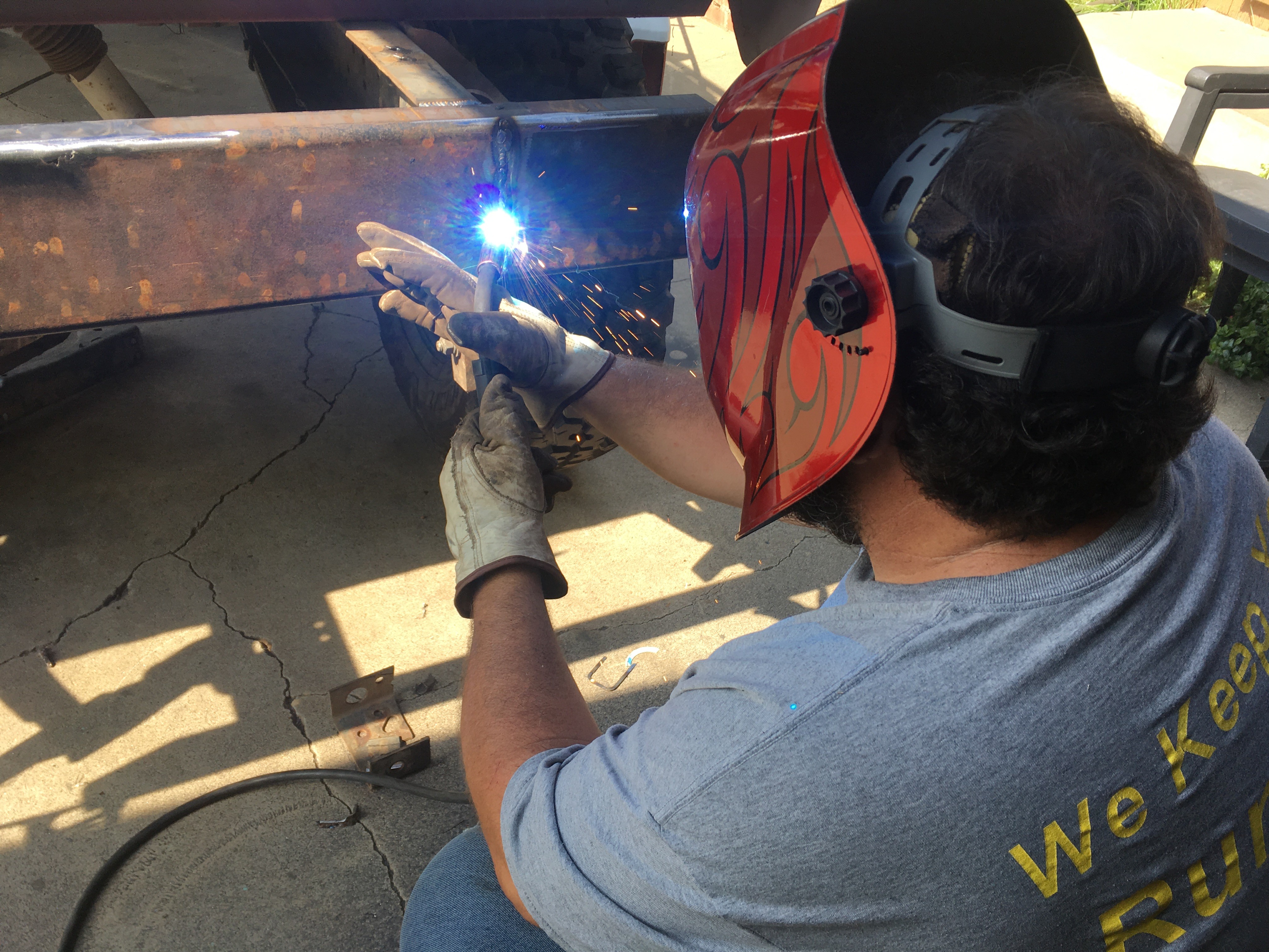

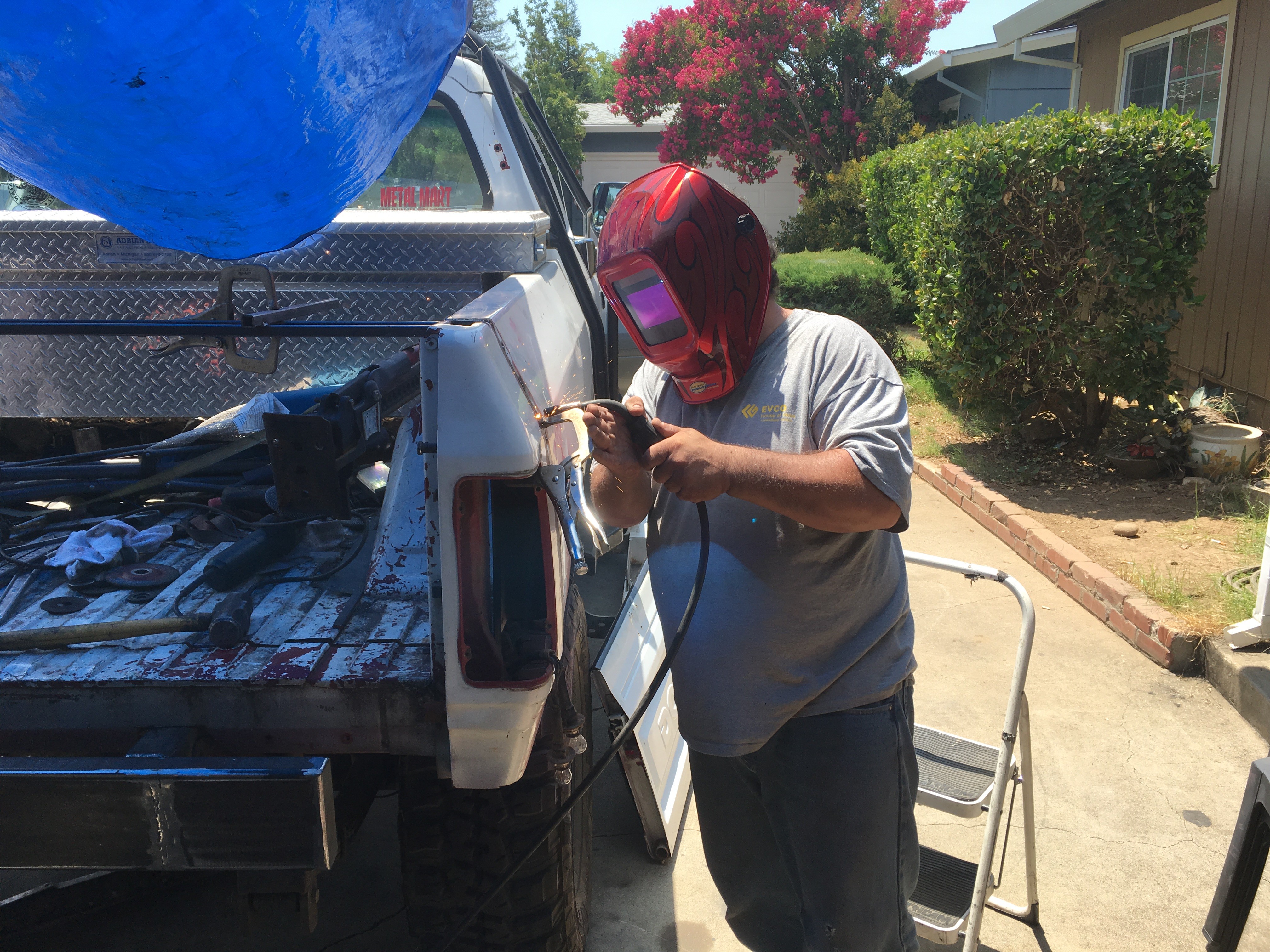

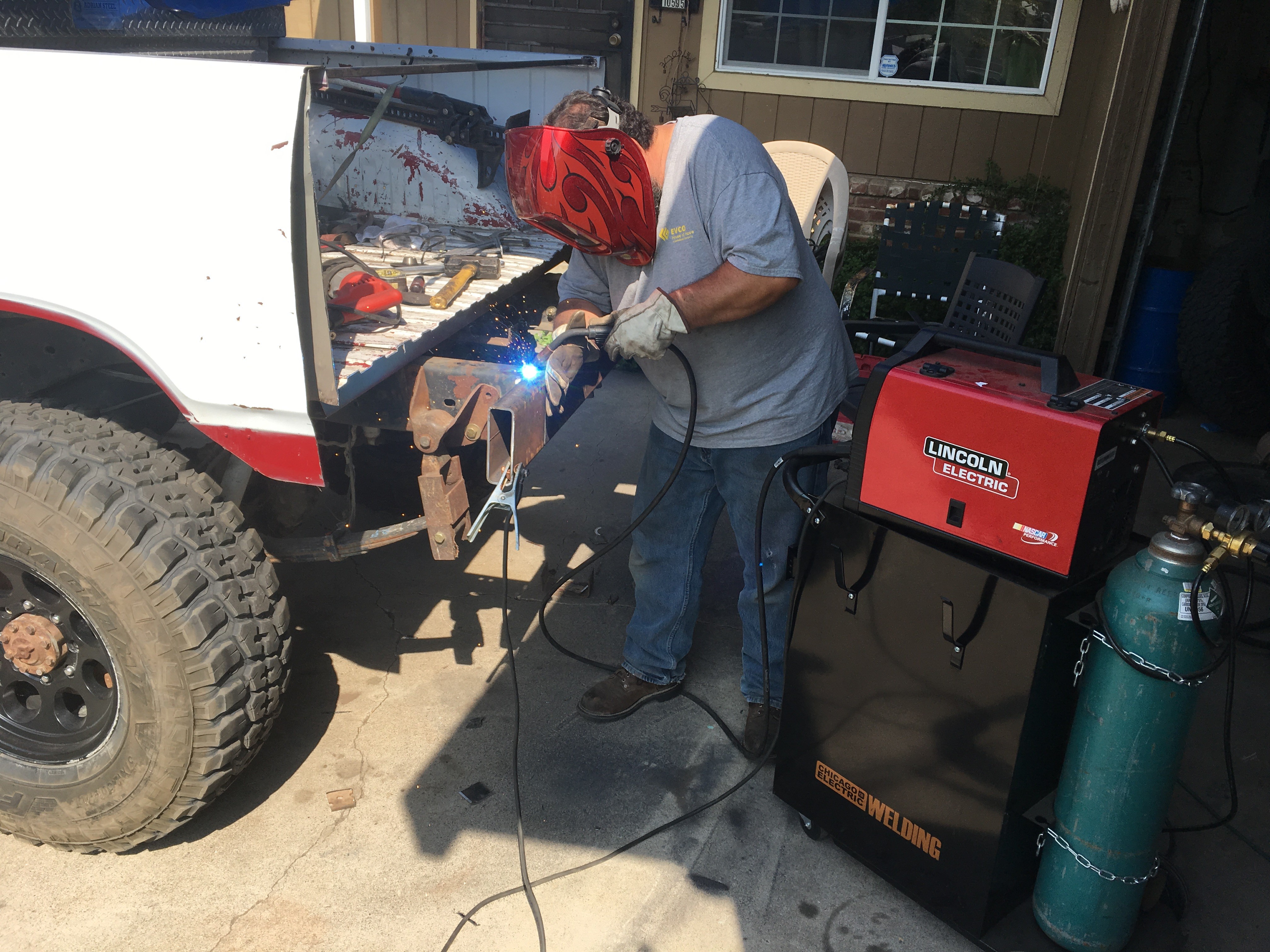

    Brent welding the bumper. We had to remove a cross member this bumper is  also  a cross member to strengthen the frame. brents-truck-2-015.JPGbrents-truck-2-013.JPG

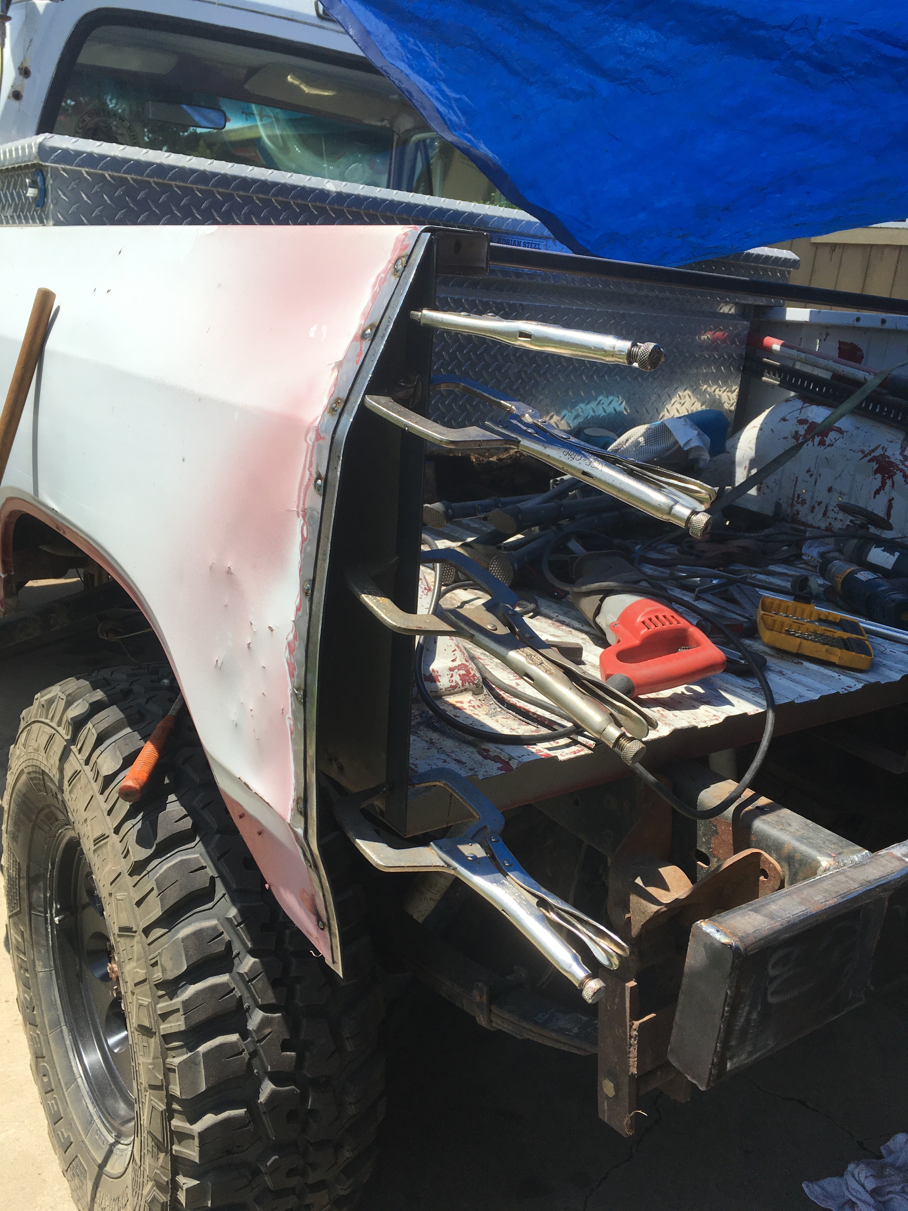

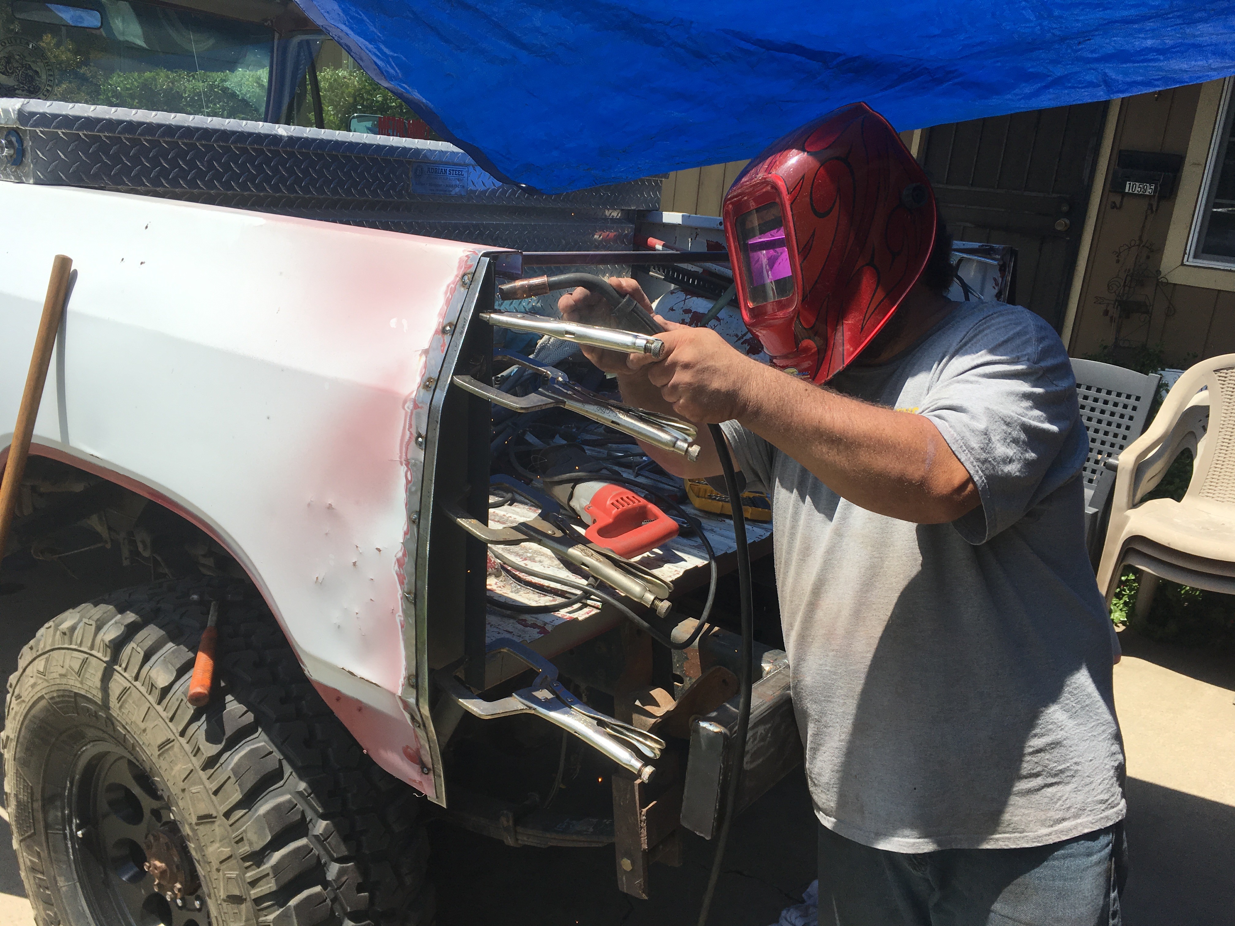

    Brent welding in the strip metal to help fill the gaps in the sheet metal when he welds it back together again.brents-truck-2-020.JPGbrents-truck-2-021.JPG

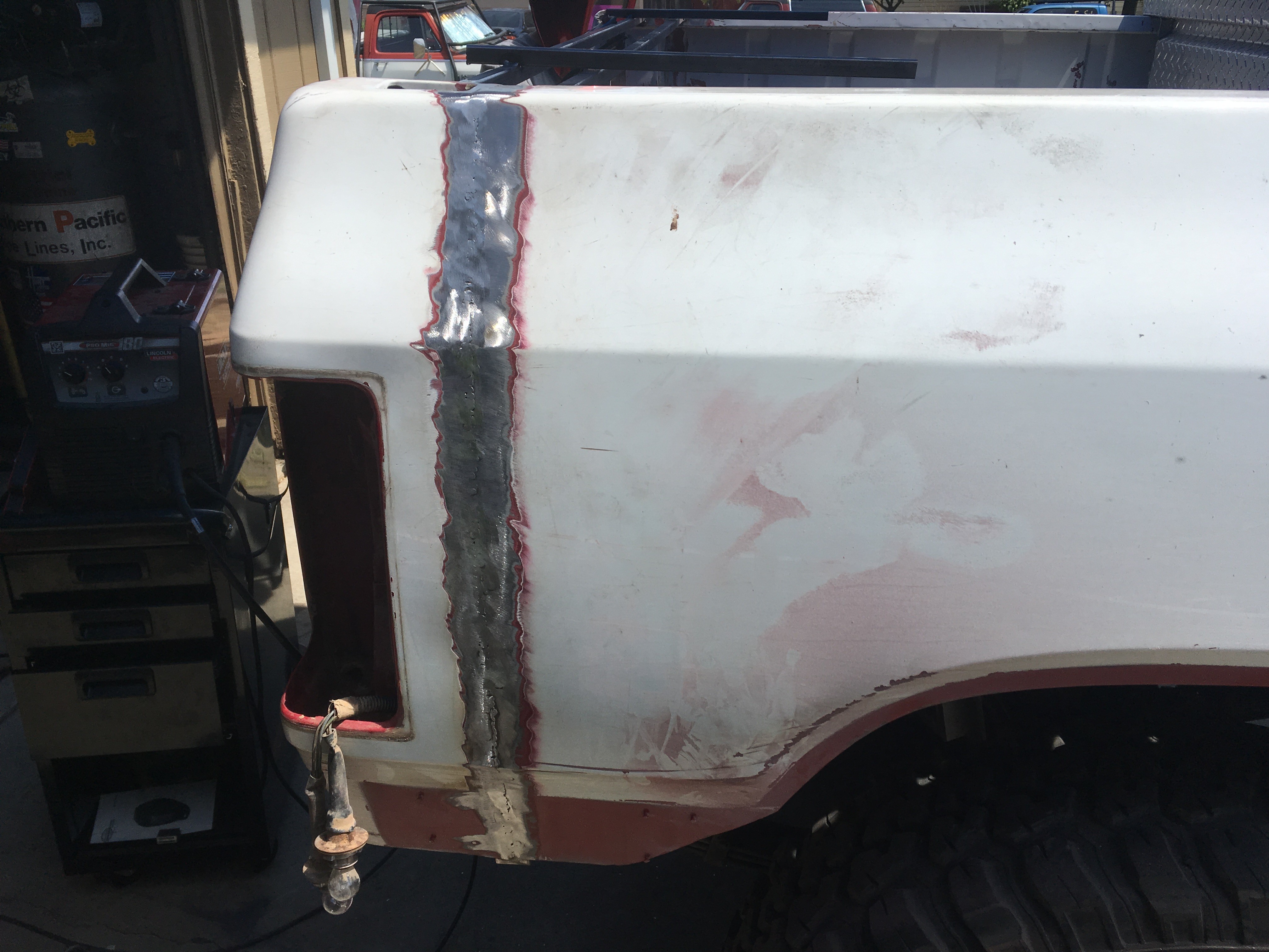

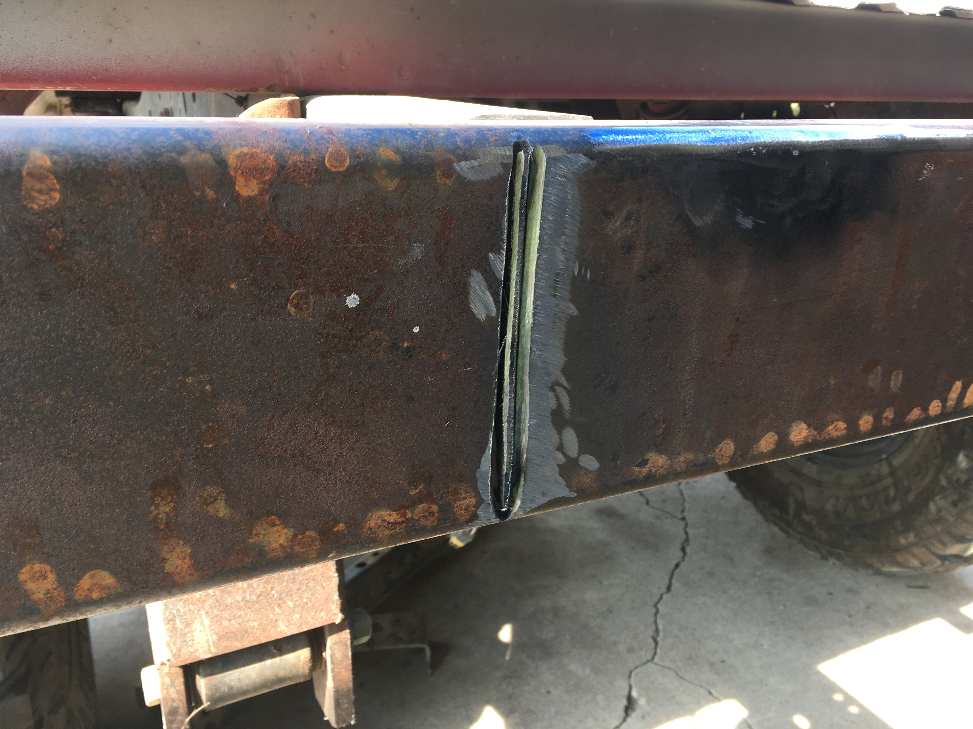

    Stitch welding the side of the bed and the finished weld.brents-truck-2-025.JPGbrents-truck-2-026.JPG

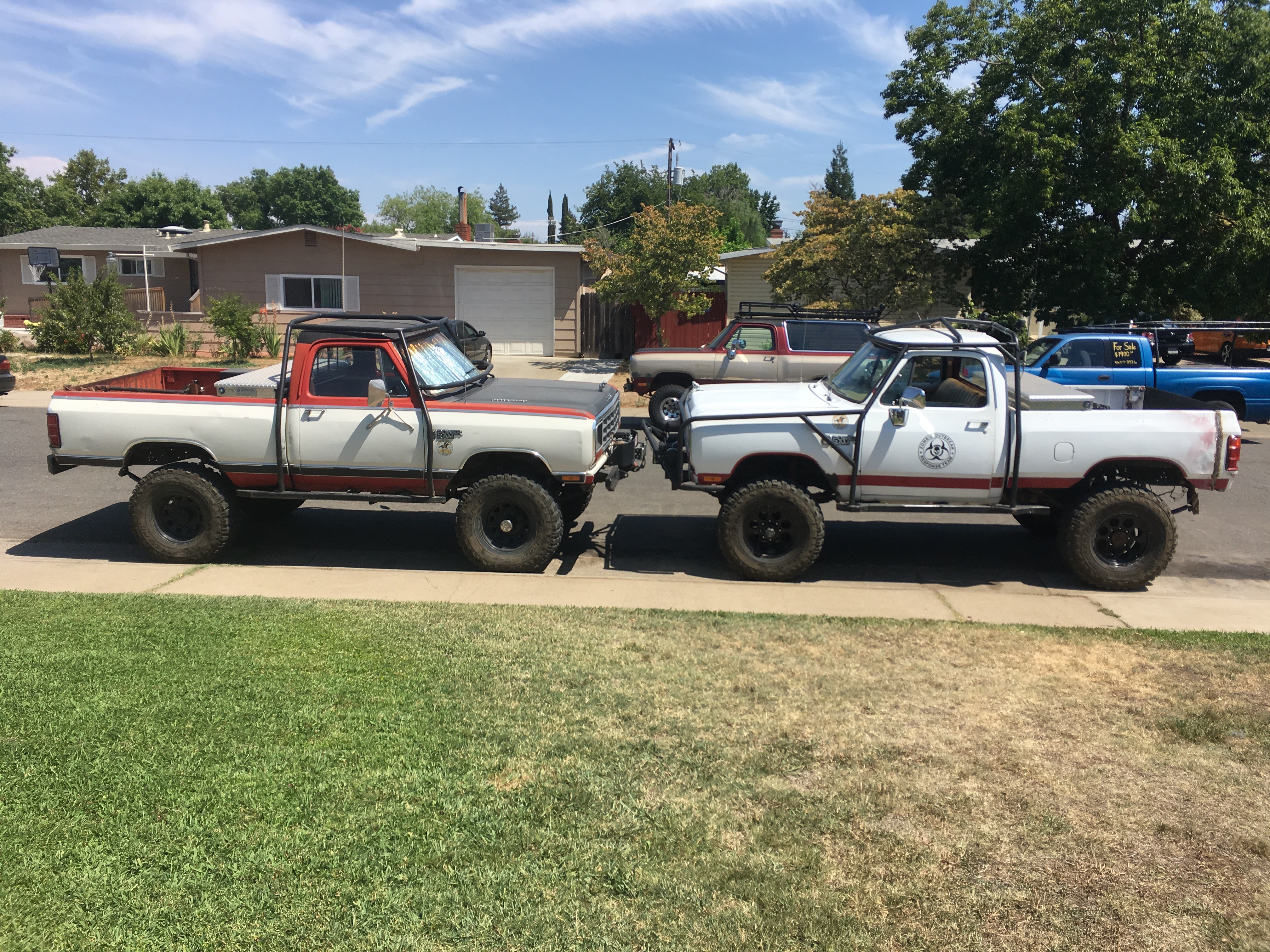

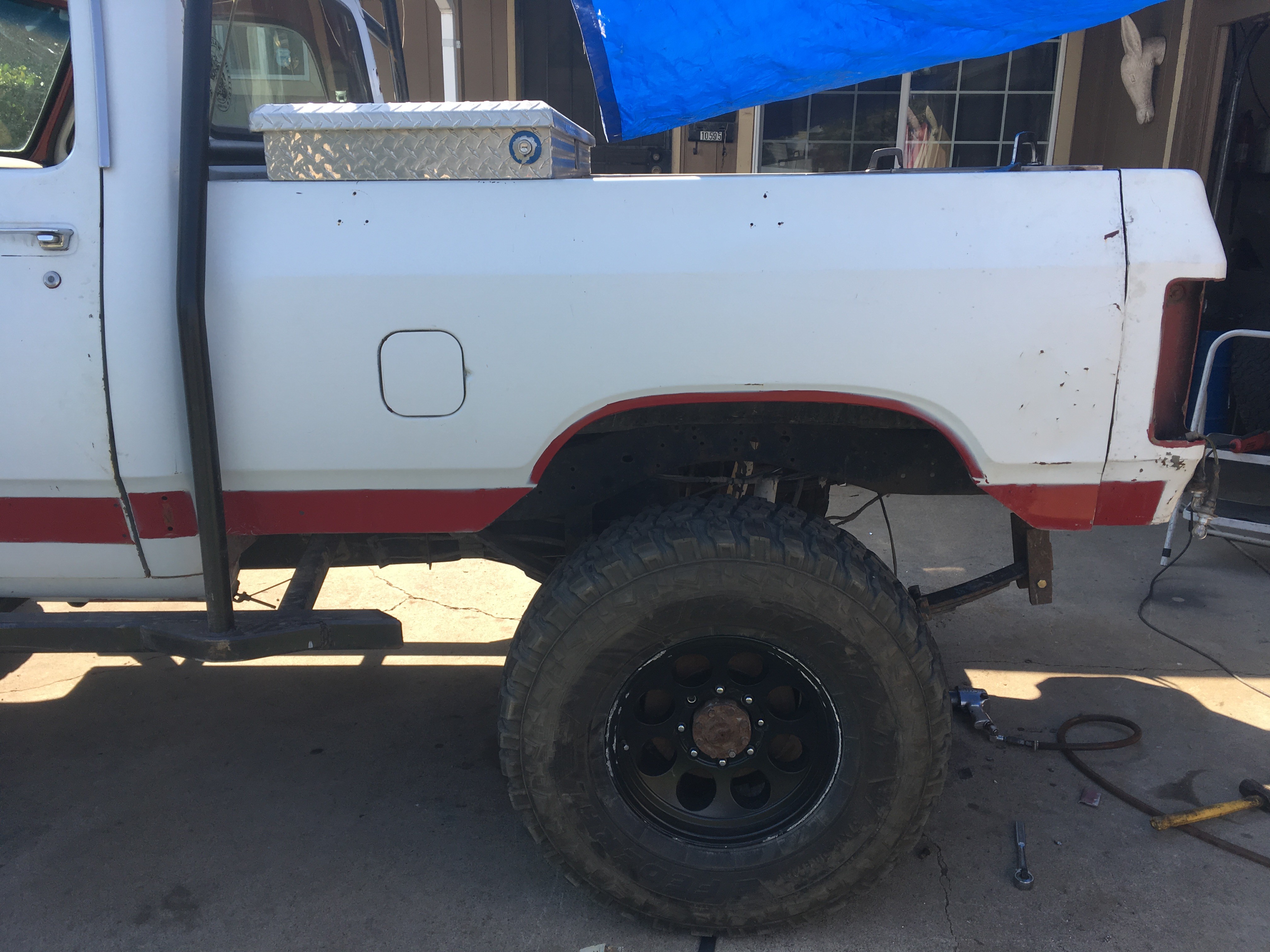

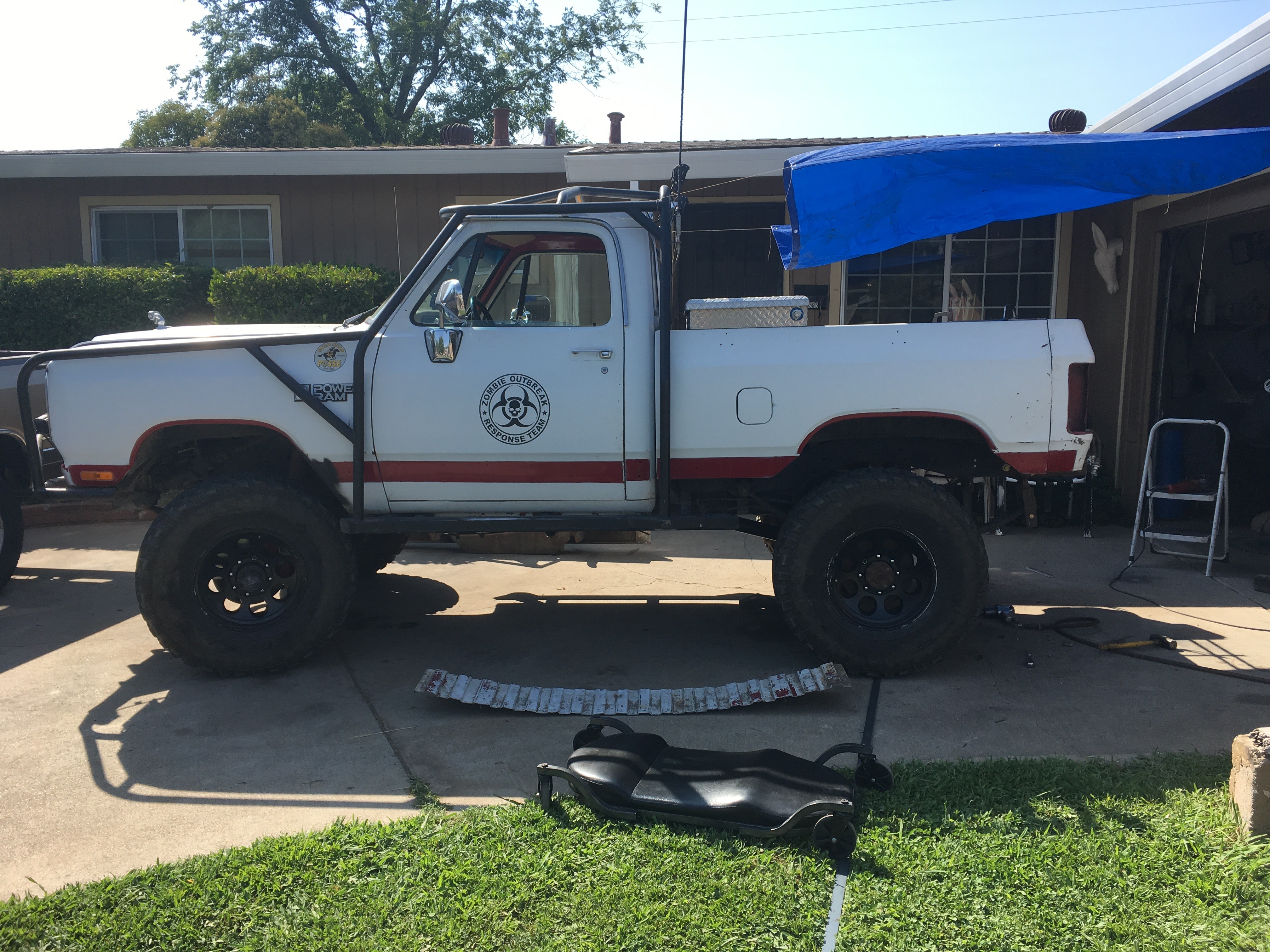

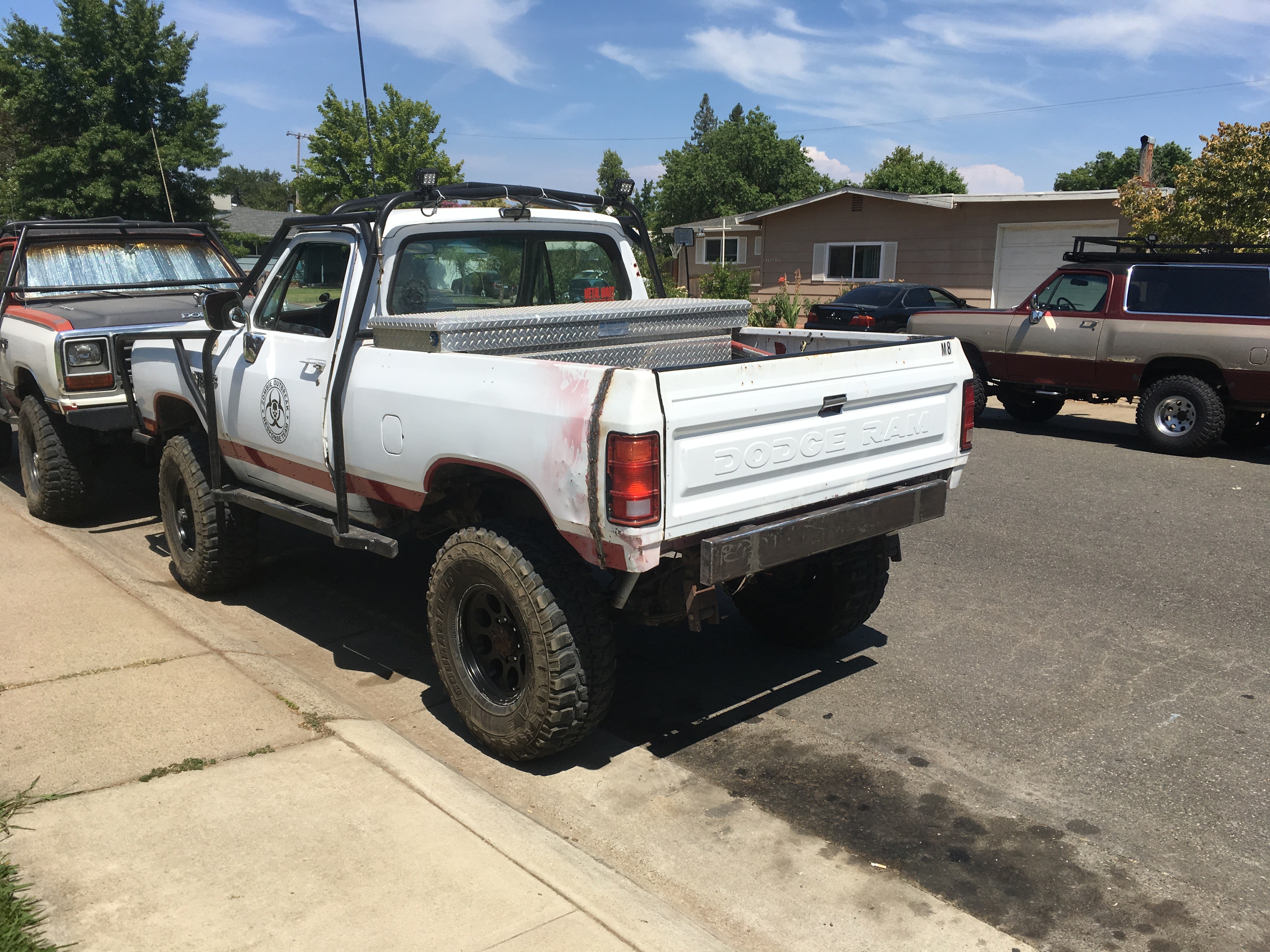

    Here is the finished bed with a little comparison of my stock short bed dodge and Brent's bed that has been shortened 10"s.brents-truck-2-032.JPGbrents-truck-2-033.JPG
    There is still work to be done but the hard part is finished.

    #1522 Jul 2018, 10:59 AM
    When are you going to fix that truck on the left? 👍
