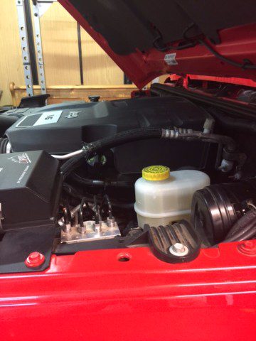

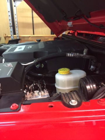

  11. JohnDF Subscriber
    #117 Apr 2017, 10:13 PM
    Hmmm... Not sure if that bracket will work with my upgraded master cylinder...
