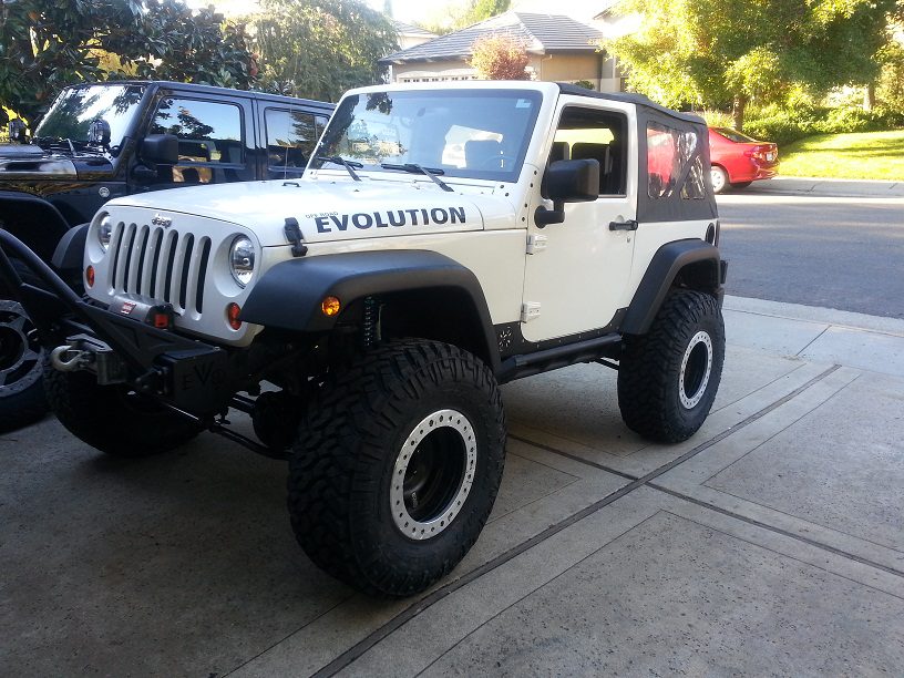

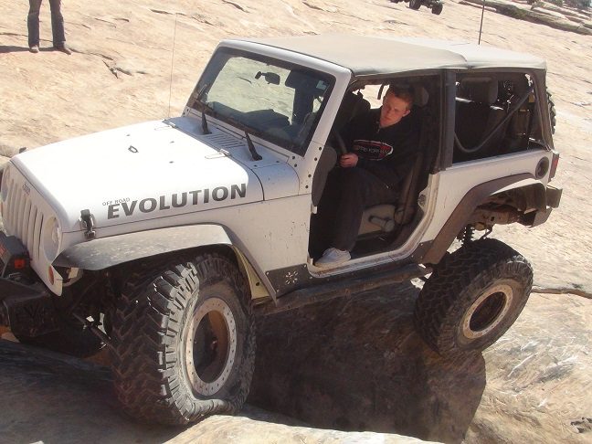

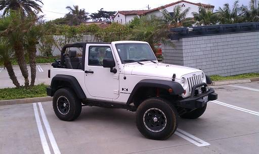

    This was my bone stock 2 door Jk sport. The only option it came with was A/C and and an Automatic Transmission. The list of mods to be done to this little guy is pretty lengthy. The goal is a very capable trail rig but a good daily driver. My son Reed and I will be doing the wrenching on this one as much as possible.
    ***EDIT 5-10-13***
    List of Upgrades/Projects left to do
    Half Doors (in progress)
    Install Rear Air Bumps (I have the air bumps need the bracket to weld)
    Rear Antirock Swaybar
    Roll Cage
    Off-road lights
    Rock Lights
    Better Stereo with Navigation - Still Looking
    Rubicon Transfer Case or RubiCrawler
    Completed Projects..
    Got some replacement Roll-bar covers the others were faded from being left in the Sun
    Got some replacement visors - the others were chewed up
    Offroad Evolution Hood Stickers - Going for that sporty, agressive look!
    37" Nittos on 17" Beadlocks
    Offroad Evolution Bolt on Coilover Kit
    Rebuild Rear Dana 44 with beefed up axle shafts
    Used Rubicon Dana 44 in the front LCA skids
    Front and Rear Drive Shafts
    Front EVO Bumpers
    Rear LOD Bumper with attached tire carrier and Rotopax carrier
    EVO sliders and skid plates
    Cruise Control
    ARB HO air compressor under the hood.
    Wired up switches for Front and Rear lockers
    Cut the fenders for more clearance
    Starting Point
    Currently
