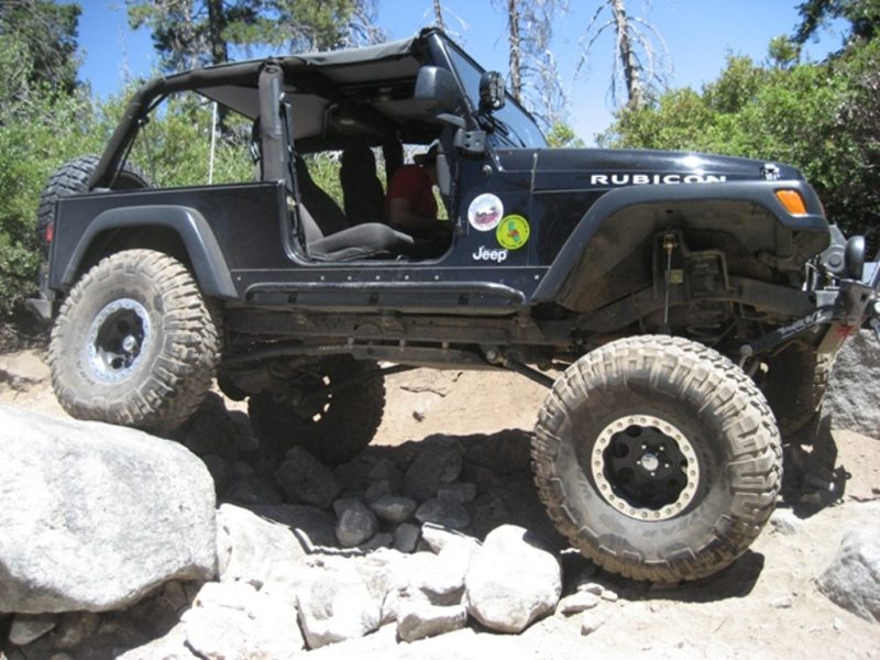

2005 Jeep Wrangler Rubicon Unlimited purchased used in 2007
DRIVETRANE:
~4.0L I-6 ~4 speed Automatic
~Airaid Intake system
~Banks Power Exhaust Manifold Headers
~Banks Power Full exhaust system
~Yellow Top Optima Battery
AXLES:
~Front HP Dana 60 89 F350 Full Float 5.38’s with ARB Locker 3 linked with captured coils WFO Diff Guard
~Rear Corp 14 Bolt 79 Chevy shaved 1.5” Trussed 4 link with captured coils and ARB locker WFO Diff Guard
~Upgraded ¾ - 1 ton brakes
SUSPENSION:
~Tera Flex 6” MAX lift with anti rock sway bar in front. Genright Sway bar in rearRedone 3 link front from WFO Rear 4 link.
~High Steer with PSE Hydro Assist.
~Full yoke and driveshaft CV conversions done
~Fox Shocks in front and Tera Flex in rear
~Daystar 1 Body Lift in black
~Warn Rock Crawler Front Bumper ~Warn XD9000i Winch
~40/13.50R17 MT/R Kevlar
~17x9 Raceline Beadlocks
~430P Portable Viair pump with hose
~Hi Lift 48 Jack w/ Isolator
~Rock hard tire carrier
~Shrockworks Rock Sliders
